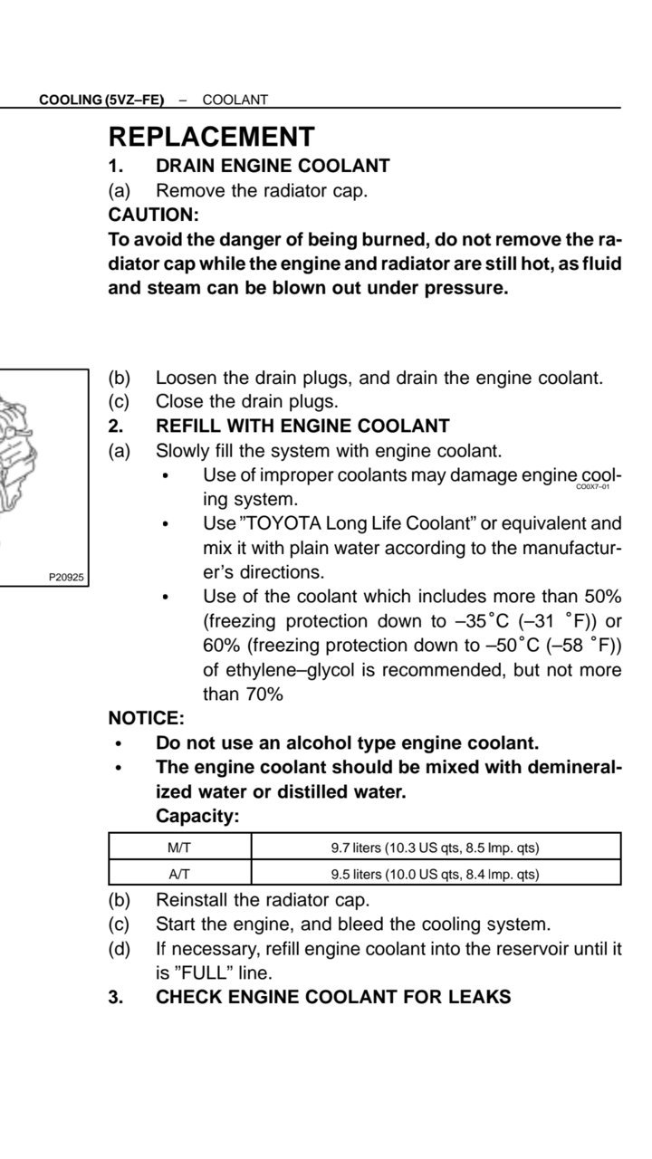

    Hmm. Do i trust some company blog ...or Toyota?
    I see an issue with distilled water alone, but when you mix it with a coolant designed to go with distilled water, then that changes the situation.

    Considering it says mix it with plain water which is different than distilled, then says demineralized or distilled that's contradictory. By the way if you read the blog post it talks about using demineralized as compared to distilled but you do you. I'll go on my experience and what I've seen and read from being in the industry. I'll never use and never have used distilled in my vehicles yet have seen radiators, engines, water pumps, etc. eaten apart from distilled water being mixed.

    I'd love to see more of what you've read in the industry, especially since you think Toyota, world renowned for their reliability, is wrong. :laughing:
    Besides, once you mix the antifreeze concentrate with the distilled water, whatever minerals that were in the antifreeze are now in the mixture. It is no longer distilled water at that point. Starting from a baseline of zero minerals and adding the right ones, versus starting with whatever minerals comes out of my tap, is a far more reliable strategy in my book.

    Aw come on, we're not clogging up anything and I'm genuinely curious. This isn't about me, this is about figuring out what is the right thing to do.
    My experience with tap water in radiators has never been positive, there's just too much crap in it in a lot of places. When you post up a link saying NEVER USE DISTILLED WATER, and it *directly* contradicts what the manufacturer states, I get curious. Besides, you said you could post more links....so do that.
