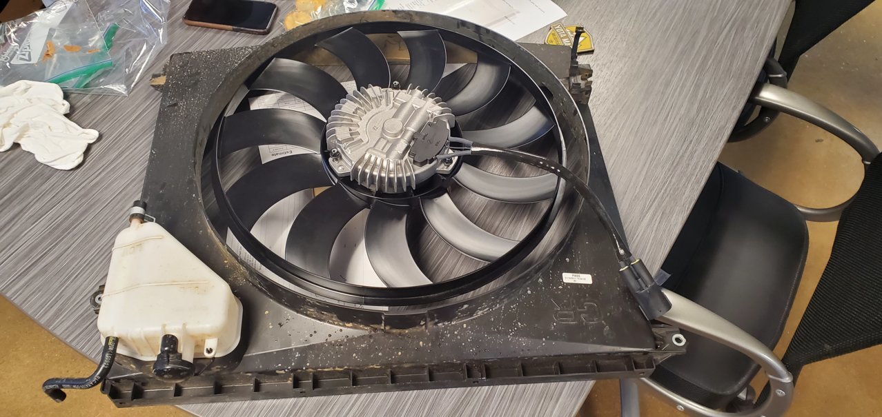

    hey guys. Wanted to show you what we are working on. We got a spal 830w 18in fan setup and are working on custom brackets to hold it in the factory shroud hole. This will be run by a controller unit with customer set 40% start command temp. And 100% command temp along with user override on command. This fan is the most powerful pwm fan in existence and will fix all cooling issues on 2nd and 3rd gen tacomas. This will also free up horsepower and torque through the curve and more mpgs. Stay tuned for more

    stay tuned for kit install testing and pricing. This will be available to buy once finished

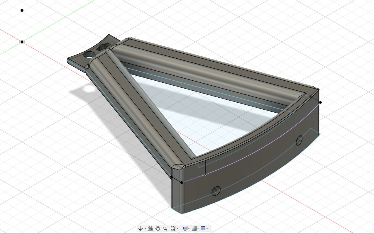

    Version 2 for the fan support headed to the 3d printer

    well the unit im using is a OEM validated fan. the controller is from lingenfelter and is epoxy filled. i will be running it on my truck. and im an ex engineer for chevy performance who fixed the corvette overheating issues. prob not going to get that level of knowledge from any other aftermarket parts

    ya no offense to toyota but thats trash. 1 its a pusher fan blocks air flow. 2 its a small fan, 3 its not a variable speed PWM fan. and its a huge splice in job.

    Yes it is, but while under warranty its a good deal. Plus its covered under the rest of your warranty. I had it done the other week, I redid most of the wiring they did so its less hacky. I do intend to build a duct to channel the air a little better too.
    I think replacing the engine driven fan has some positives as you pointed out (throttle response, slight bump in power, slight bump in MPG)
