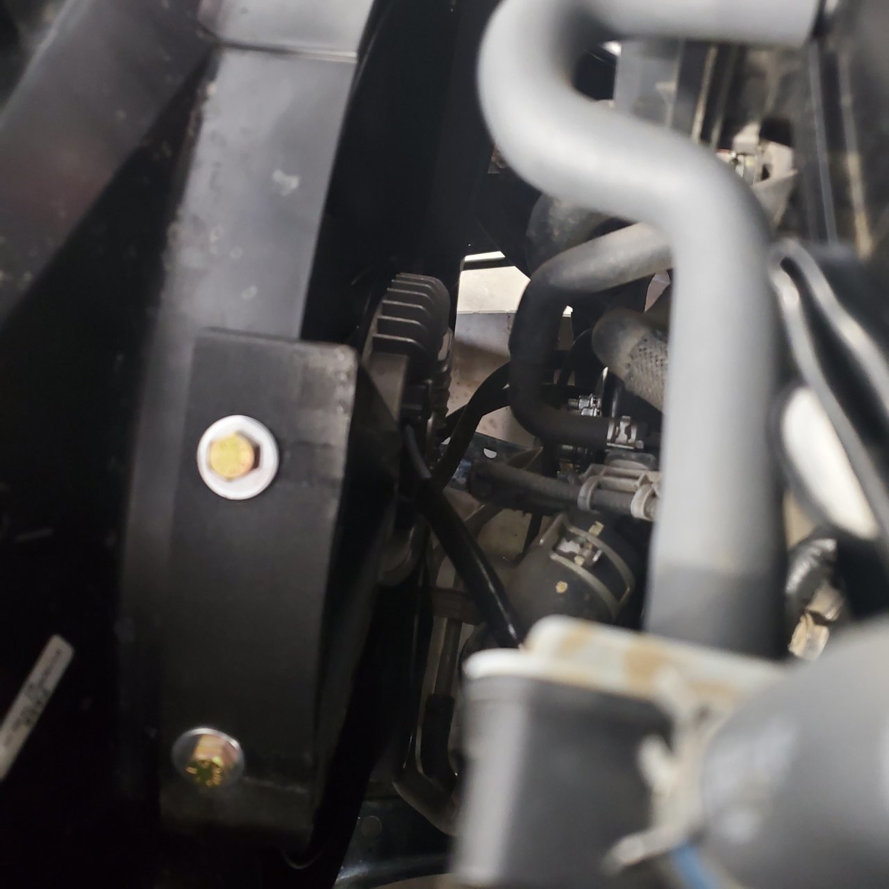

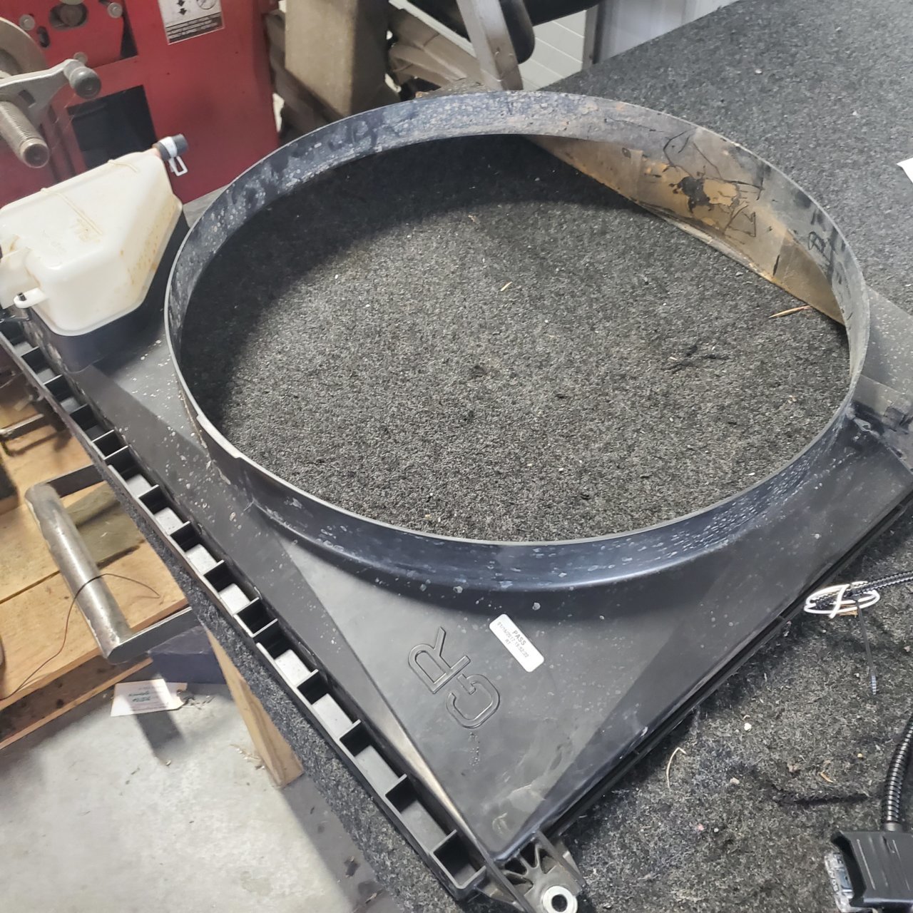

    I'm not trying to be too critical.... But it looks like you need longer bolts, it appears there isn't any thread engagement in the nylon of the nylon locking nuts.

    Thanks. I cranked them down after this pic they are about flush with the end of the nylock.
    Sorry I am not selling anything, just showing for anyone else that wants to DIY

    Ahhh, got it! Curious what the plan is for controlling the fan as well. It may have already been covered but there is already quite a bit of info to look through.

    have spoken with daryll from the auto cool guy about their PWM controllers.
    he recommends the HF-125 to be used with this fan. PWM controller needs to be rated at least 7khz

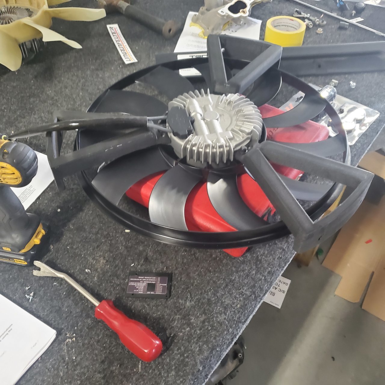

    Hey guys. Got the kit finally installed. Working nice. Got to do some testing and further vetting of the Setup but things look good so far. I will say as of today in my daily driving I average 12.7 mpg. We will see how that changes going forward from here. Also our kit will come terminated and have set instructions specifically for installing into the tacoma so you don't have to deal with the controller instructions

    Well unless you have the ability to create the fan arms its not going to be a piece together yourself kit

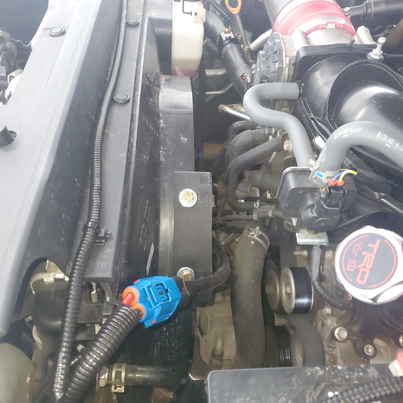

    Interesting you spliced in a new ECT sensor. I was going to do a Bosch/AEM type. But then I dug a little deeper and the factory Toyota coolant temp sensor is VERY close to the Type 4 as far as resistance VS temp. I purchased the factory connectors(male +female). Going to just make a T harness and use the stock one so I don't have to cut a radiator hose. Any particular reason why you did a stand alone sensor?

    Closed loop system. Completely independent of the factory setup and only monitors the required fields.

    Also per Toyota the coolant temp sensor is located under the intake manifold and didn't want to deal with that

    I see. Wouldn't using the stock sensor essentially be the same thing?(almost closed loop I guess). I don't think the ECU has any output to the temp sensor. It's just a big variable resistor??

    That one is on the cold side. Not a fan of taking cold side temp.......
