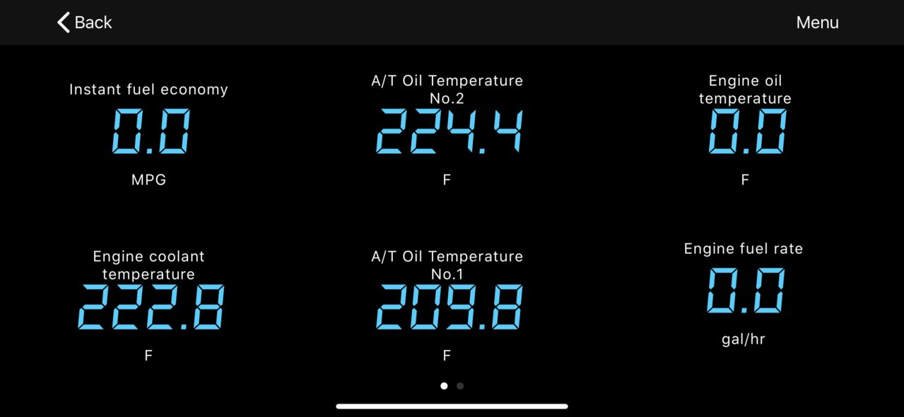

    TireFire
    TireFire Superunknown Member
    Feb 6, 2016
    #177349
    7,666
    Olympic Peninsula
    That trans is overheating

  9. Aug 25, 2020 at 12:35 PM
    #29
    TenBeers
    TenBeers Well-Known Member
    Jun 5, 2009
    #18067
    7,740
    Rich
    Bentonville, AR
    2018 TRD Pro Cavalry Blue
    Yeah.
    Beat me to it, I was like $h!t that is hot for a tranny. Mine peaked at around 210 pulling a car on a trailer up a hill in summer but only stayed there briefly.

    Skydvrr
    Skydvrr IG: @kalopsianick
    Sep 13, 2017
    #229889
    12,652
    Nick
    YMH
    Black '17 OR
    Stop and go kills me. None of this is towing. Also the reason I've had two drain and fills already @53k

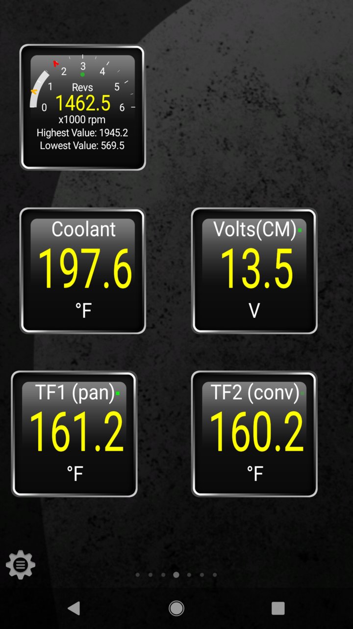

    scotkw
    scotkw Well-Known Member
    Mar 30, 2019
    #288508
    456
    A free State
    '17 DCSB V6 2wd Sr5
    Was about to say the same. :eek:
    Here's mine after about an hour hwy driving in 90 deg weather. 160ish temps. Goes to 180ish sitting in traffic. Never been to 200F since pinning trans and putting fan on the trans cooler.
