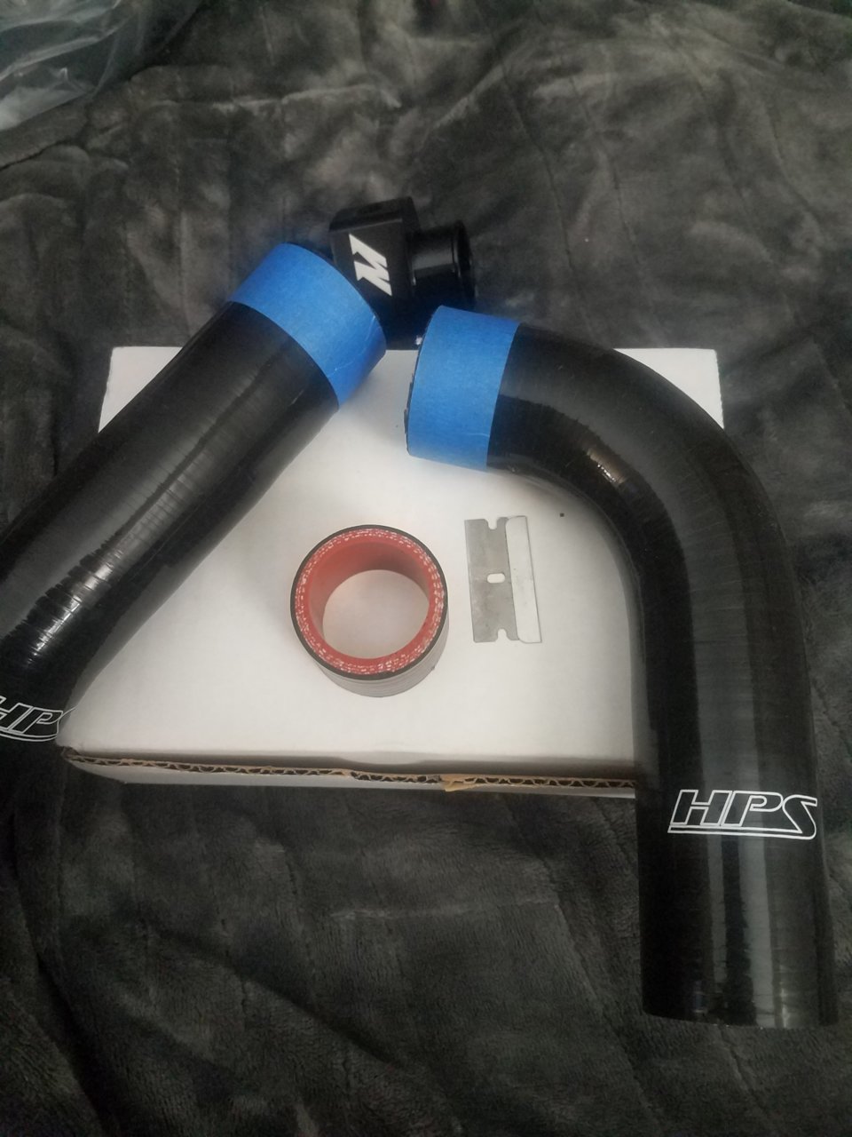

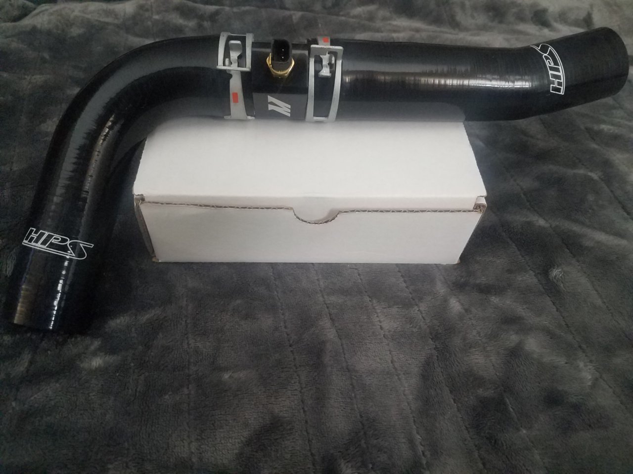

    Got some HPS hoses for the Supercharger fan conversion project some OE spring loaded constant tension clamps and the install goes down Tuesday.
    Who else is running the kit or has it on hand already? Post up your Lingenfelter VSFM and the temperature thermostat you are running, as I believe mine is set to 140 and I think it's a touch low to begin running the fan for my 160* thermostat.
    Has anyone posted what the nominal amp draw is of the fan while it's running at X duty? Maybe I missed it when it was posted, I can't imagine it's running at 100% duty the entire time.

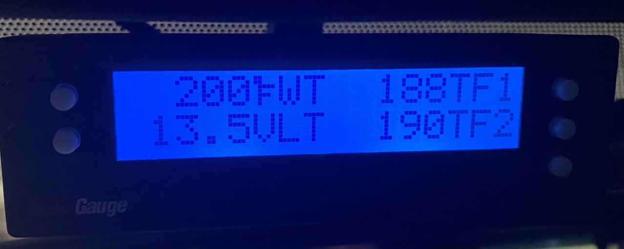

    78AACEB7-179A-4E00-B649-438B37F05032.jpg Guess I better do that also, this is my reading at IDLE :confused:

    Isn't that where u want it?

    Just thought at idle it would be lower 190-195?

    the only way to lower idle is to change thermostats. the issue is you cant be near thermostat temp or else you will have your thermostat opening and closing to much and can cause the thermostat to fail. the kit will tho maintain that 195-200 in all conditions with no creep due to weather. these trucks are designed to operate from ~200 to 250. anything 250+ is where i would start to worry about temp. too cold also has issues. like running at 160 isnt great bc your oil isnt up to full temp and can cause it not to flow everywhere you want it.

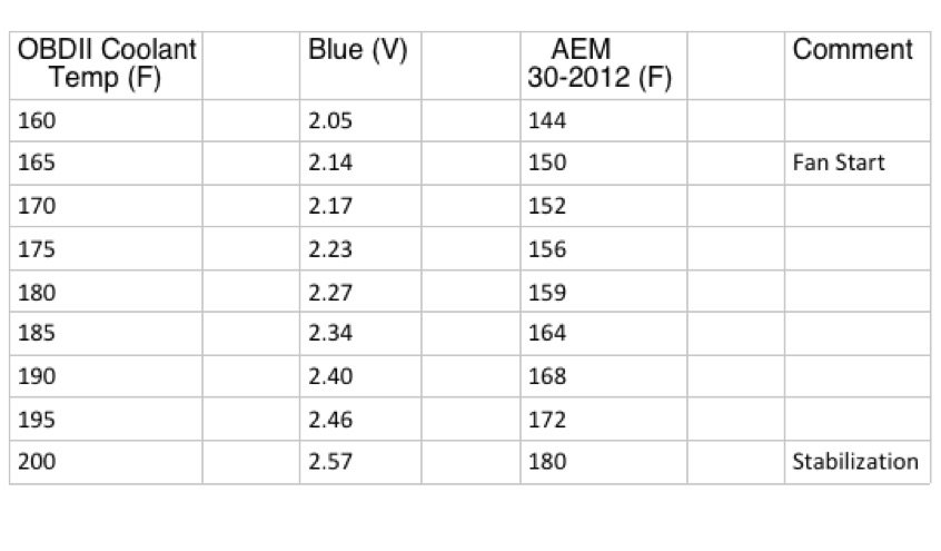

    I left my settings at the factory default 150F/240F. Similar to you, the fan doesn't kick on until 165F as measured on the OBDII connector using OBD Fusion. As a test, I let the engine warm up during idle from a cold start and monitored the engine coolant temperature using OBDII and, using a Fluke, logged the AEM sensor temperature (the kit upper radiator hose temperature sensor) using the Lingenfelter analog output (blue) wire programmed for temperature.
    Per the manual, for an AEM sensor analog output 0.02V = 1.4F. My measurements indicate the upper radiator temperature is consistently 15 - 23F cooler than the stock temperature sensor.
    @Deo taco, given the temperature differences do you still recommend the 150F/240F default settings on the LF?

    This is interesting on the comparison. i do know that the stock temp sensor is buried under the intake manifold on one of the heads so that might account for the Delta between the 2. per that you have 2 choices if you want a stabilization temps cooler. one bring the upper limit down so that it ramps faster or the lower limit down so it comes on sooner. i like the latter as it helps with continuous air flow thought the ac condenser and rad. but 200-205 is a perfect stabilizing temp on these trucks. as i said before this kit will help keep it there as usage and outside air temps get more aggressive. lowering the idle temp requires a new thermostat as you dont want to get stabilization too close to breach temp.
