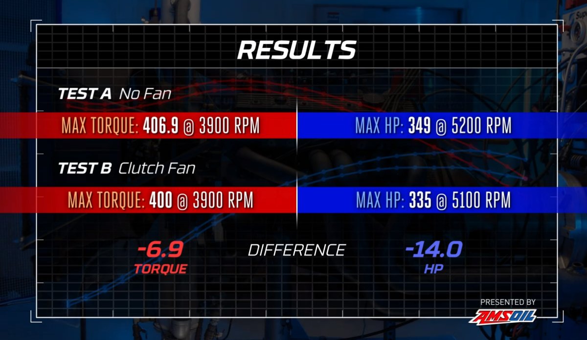

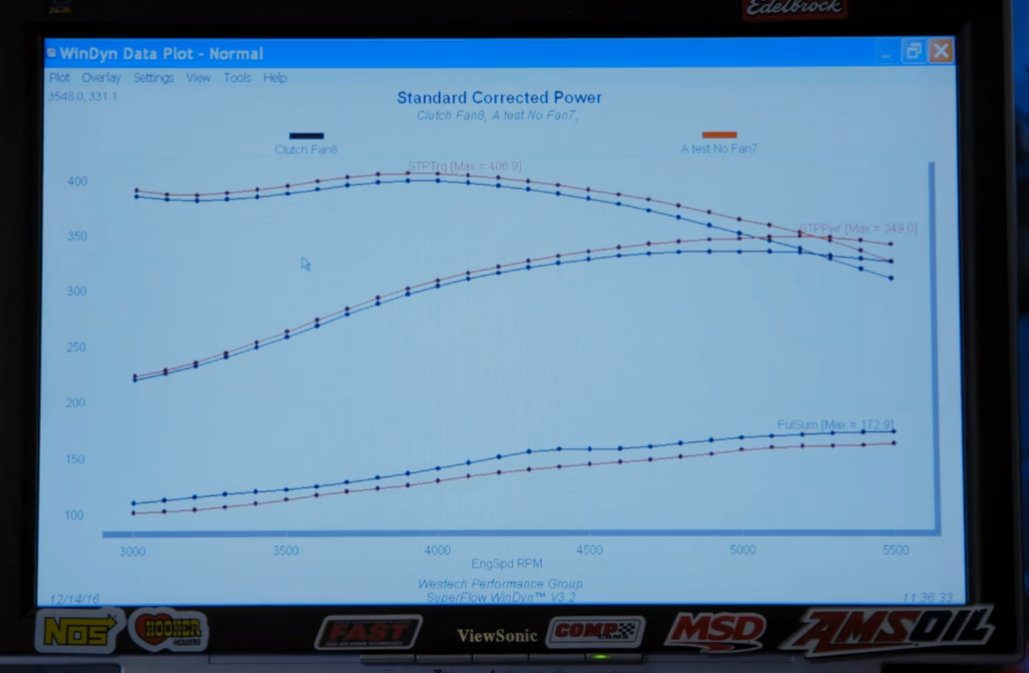

    here is the clutch fan dyno test results they did. remember the motor doesnt matter bs its just being used to spin the fan thru an rpm sweep. there might be slight variation due to blade pitch, fluid viscosity and diameter but over all a good base line to show how much power these rob

    Did that motor use a modern-style mechanical fan clutch? Or was the fan just bolted to the water pump like most cars from the ‘60s were?

    they tested 4 fans. this one was a modern fluid clutch fan bolted to the water pump.

    I think the Toyota engineers know the truck better than you . Another “performance “ item ... so u say will do some magical thing to give u more power and torque. Only thing this item will do is Put more money in your pocket .

    Lol Jesus. He provided a data point. What more do u want? Anything specifically u have to refute their Dyno data?
