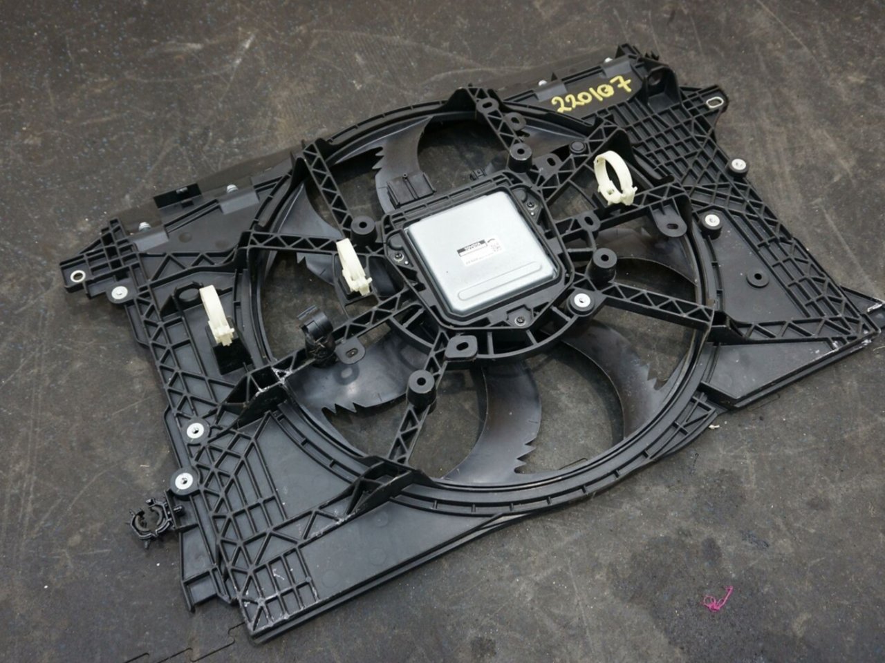

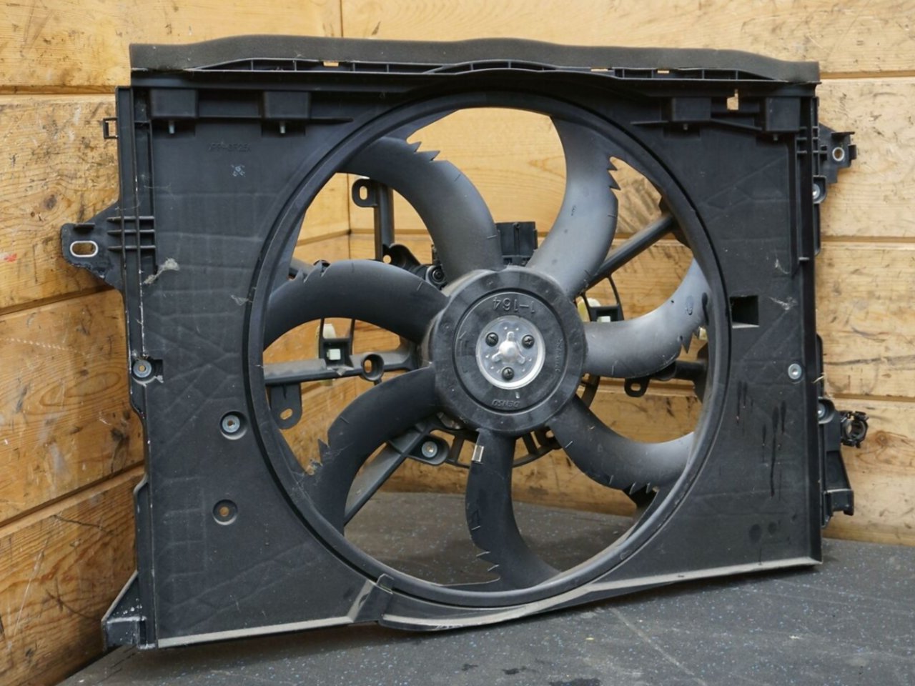

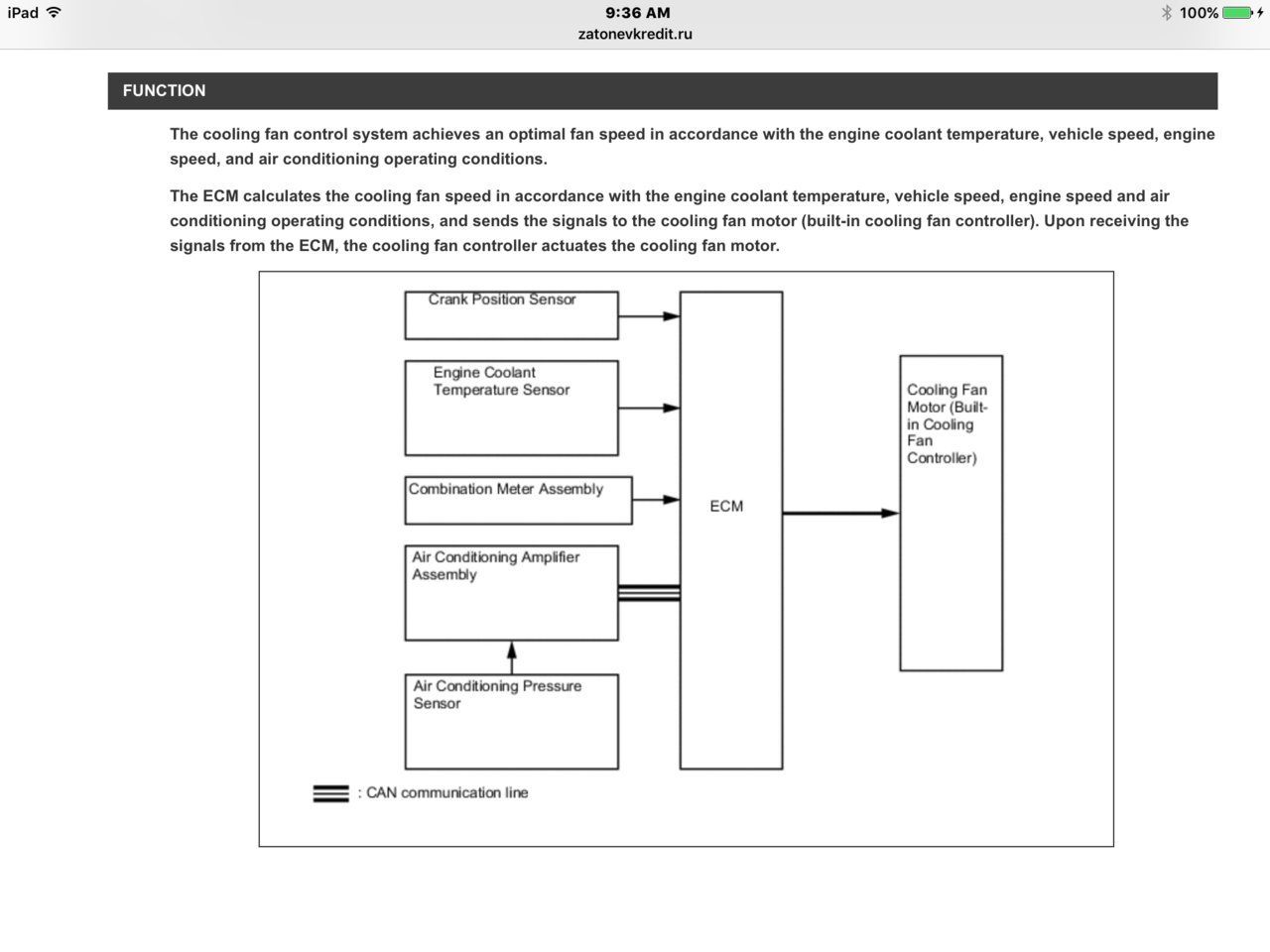

    How about a factory Lexus PWM electric fan? It is installed on various V8 and V6 cars(including 2GR and 8GR equipped vehicles).... ECU controlled. It would be crazy if the Taco ECU had the ability... I'll give it a 50/50 chance of existing. Where are the tuners? We need a flash for electric fans!
