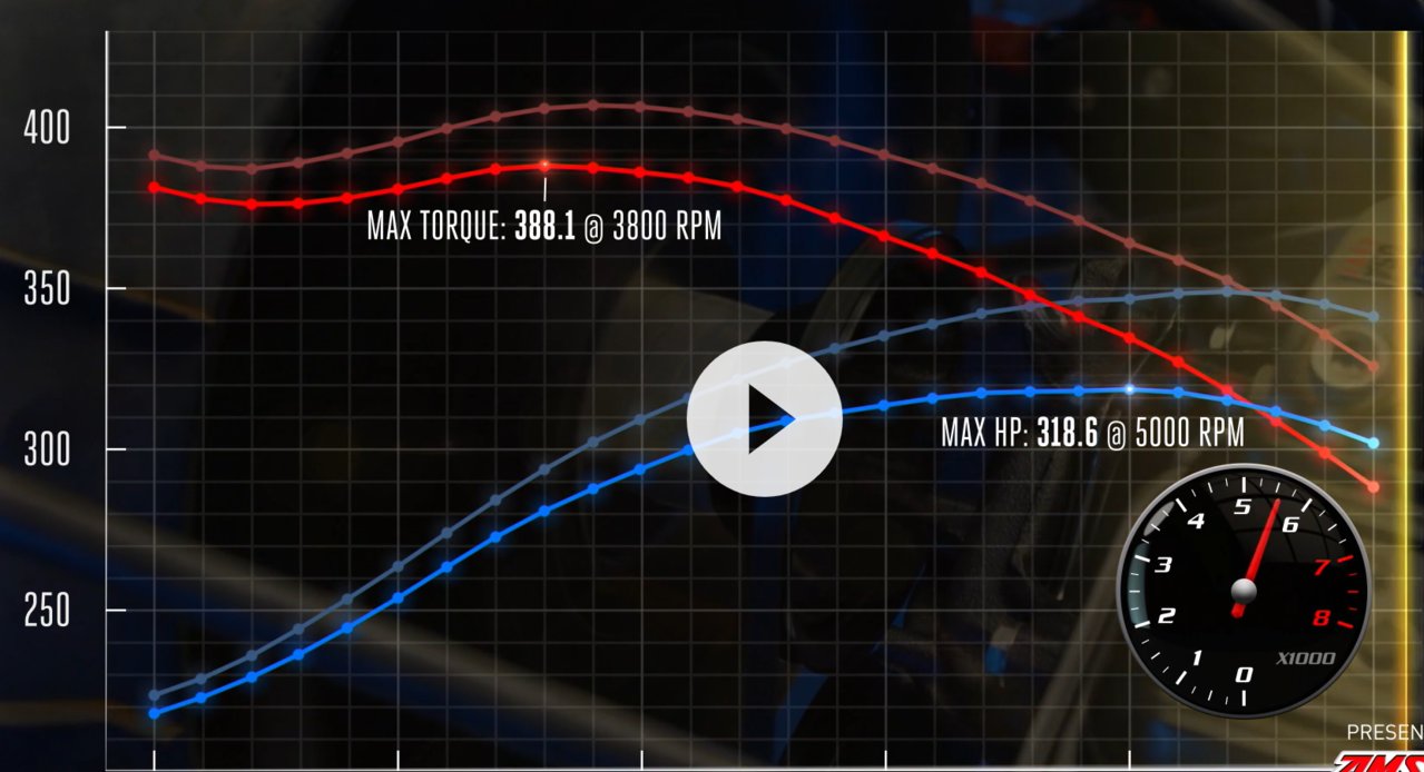

    Toyota has a TSB for inadequate airflow at idle and shockingly their fix is an E fan. Another data point to drive those home further (previous was a clutch fan but not locked)... when that fan is fully locked its taking 30+ HP to turn. I'd like 30 extra HP and almost 20 ft pounds and better cooling.
    If you've never watch Engine Masters you should. It's a great show and they're really good at showing what does and doesn't make power. Worth the Motor Trend subscription for that alone.
