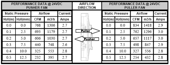

    So something else here, not automotive related, but includes temperature numbers. PC water cooling!
    https://www.ekwb.com/blog/push-pull-or-push-pull-on-radiators/
    Push provides good cooling, pull provides better cooling, push and pull provides the best cooling.
    Im running push and pull with the OEM tsb solution.
    push = good, pull is best, push pull is best only in static air aka no motion of the vehicle
    12TRDTacoma likes this.

    So like offroading at low speeds, or sitting in traffic?

    both but its a give and take. best option large puller. adding a push will help down low but hurt at speed due to the dead zone

    here is some data on static ability alone
