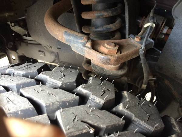

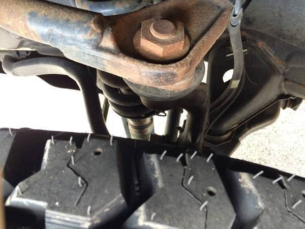

    We had this discussion...
    I think it's a combination of how my LR UCA's are set and the fact that when I had my 275's they were at least half worn, so about 1" shorter. My 275's fit by a C hair so I think full tread they may have rubbed. I'll post a pic of my UCA.
    The only place I rub is my mud flaps. I have to run them in the winter so it's something I'll have to deal with. I'm going to look for some aftermarket flaps that aren't so damn thick and protrude into the wheel well so much.
    I do like the stance better though with the spacers and think they may have looked to set in without them.

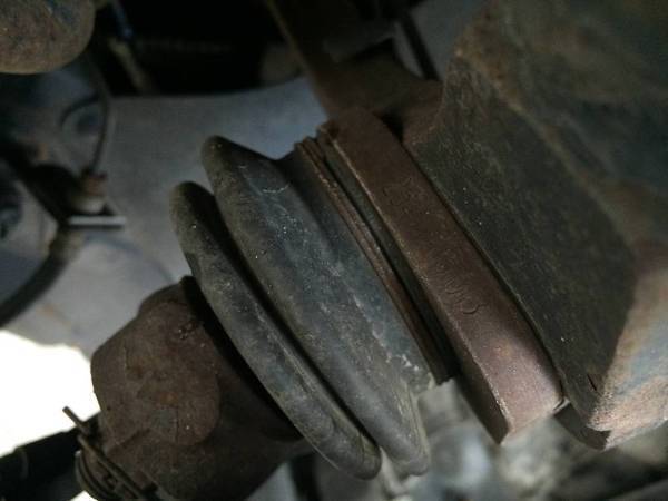

    See the overhang of the arm over the ball joint mount? Not sure if that's normal.

    Looks like your camber slide adjustment is inward quite a bit too
    What caster setting do you have the arms set at ?

    They were supposed to have been set at 2. I bought them lightly used.

    Is the SPC logo facing the tire ? Hard to see amongst teh rust

    Lol... I know.. Yes they are, so that's +2 setting correct?
  19. Feb 24, 2015 at 8:45 AM
    #19
    OZ-T
    OZ-T I hate my neighbour
    Dec 15, 2009
    #27584
    50,587
    Peter North
    British Columbia
    Yes
    My arms look the same too ;)
