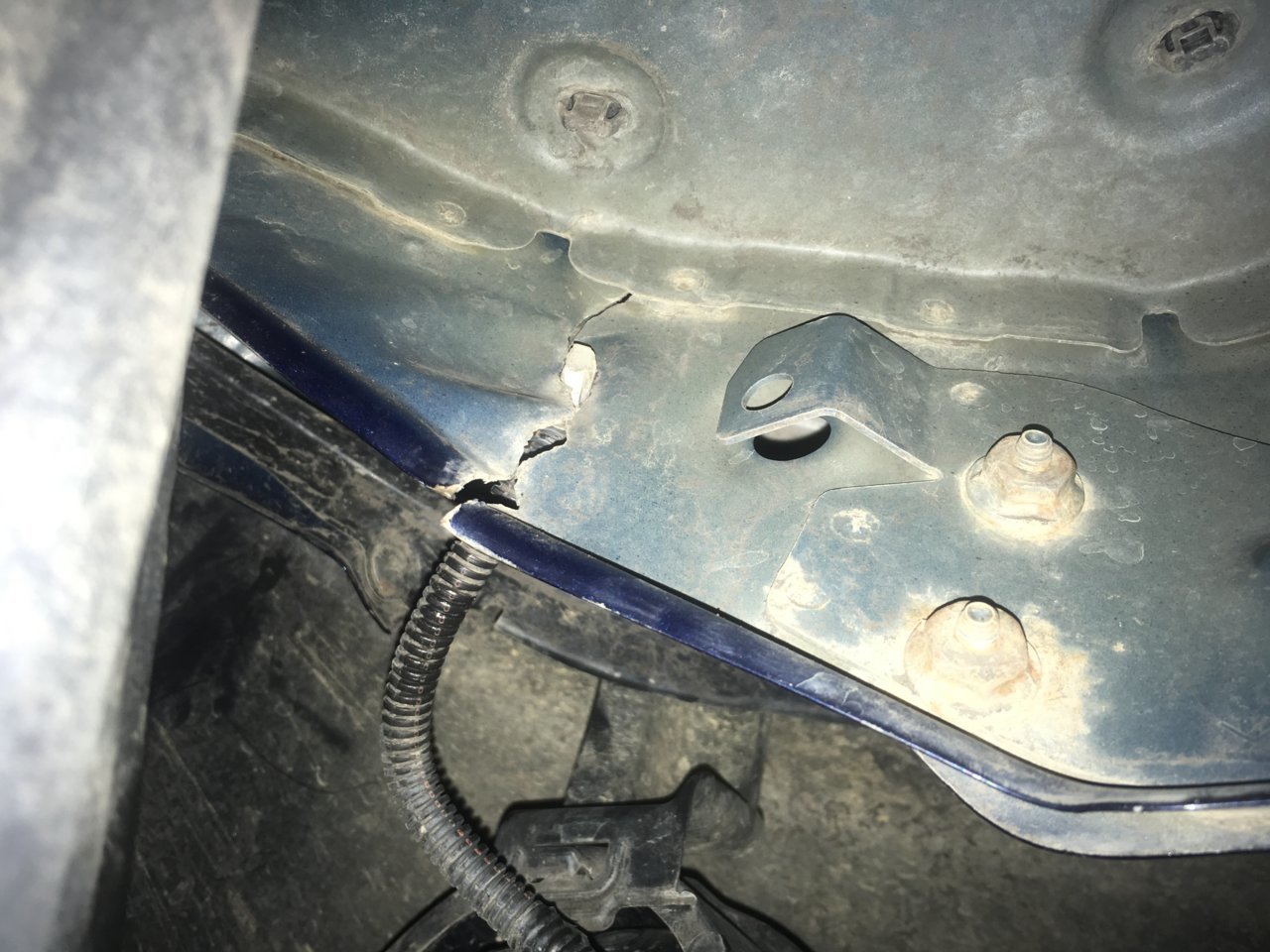

    After some inspection about a month ago I'm now a proud member of this club.
    12TRDTacoma, YumaTRD and whatstcp like this.

    I have to fix mine now too... :pout:
    fatfurious2 and 12TRDTacoma like this.

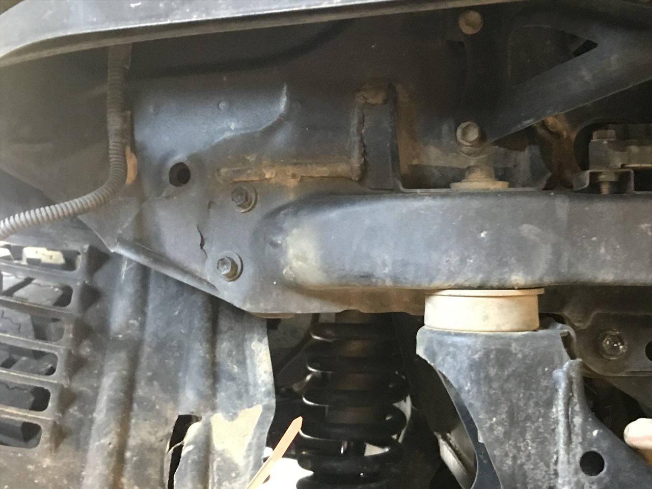

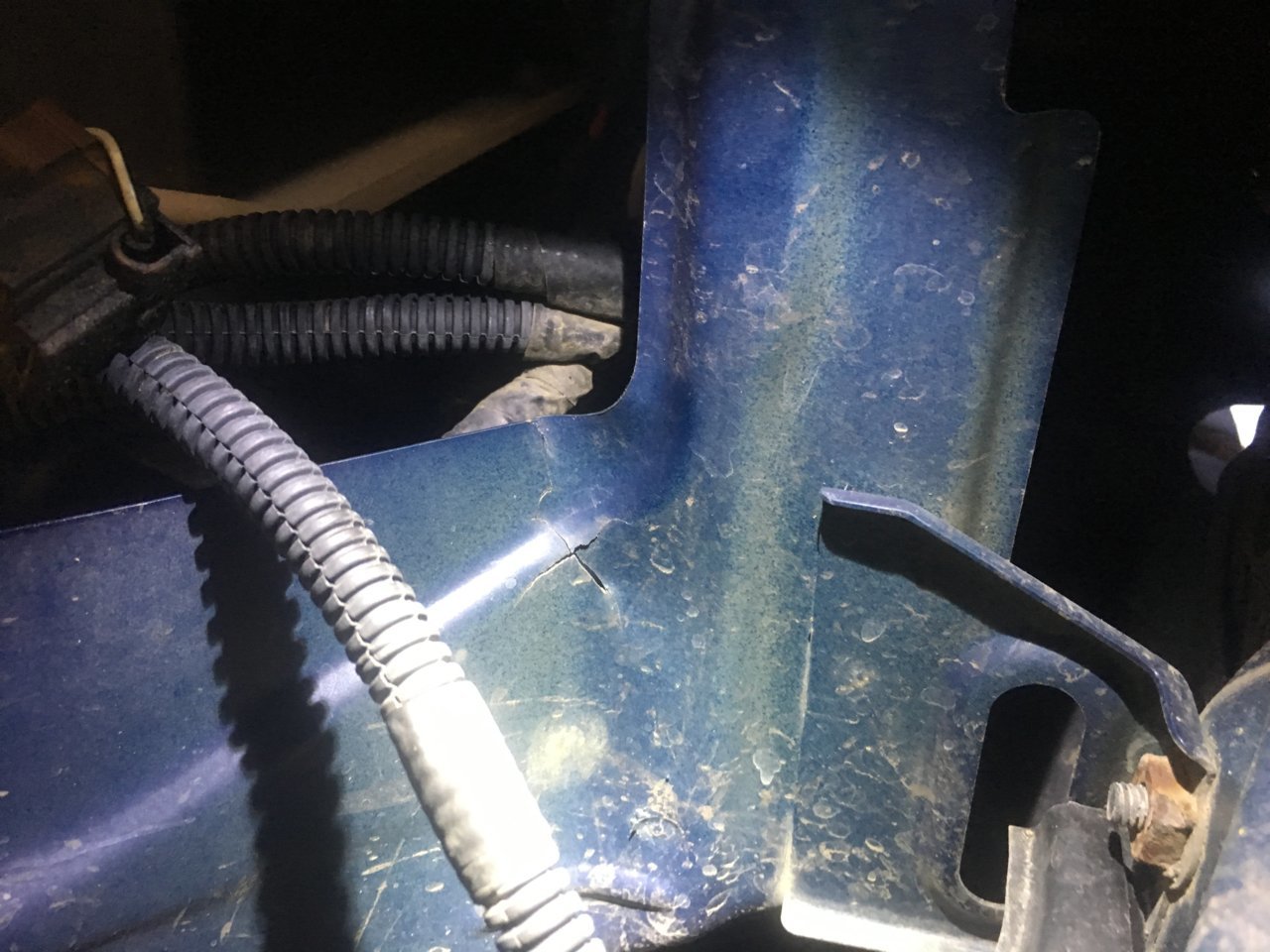

    Did anyone with this issue do a radiator bushing swap with a flip? I just found both sides of mine cracked pretty bad. I replaced my radiator support bushing with the energy suspension bushings and flipped it for the larger puck to be on top. I have a Demello front bumper, but I can’t see that it stressed that area.
    AR15xAR10 likes this.

    Love my truck but wish Toyota didn't cut costs using tin metal.

    I know your troubles well. TIG welding that thin metal is such a pain.

    Yes i have the bushings. Can’t tell if they made the problem worse or better.

    Oh, there is a solution. It requires a tube bender, welder, CAD would be ideal, and lots of 1.75" DOM tube.

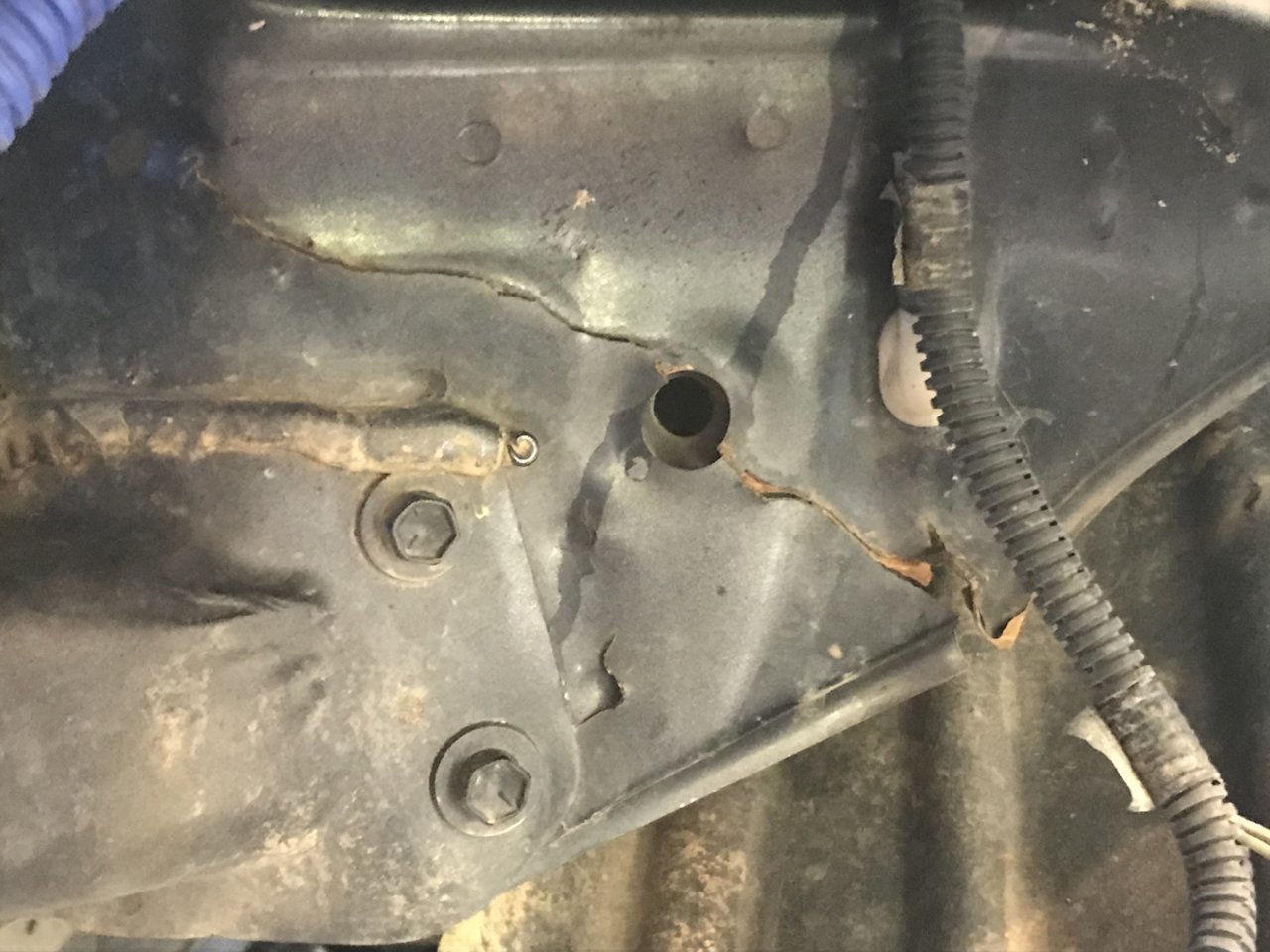

    Well, mine is 12 years old and it only started to get really bad when i started jumping the truck over the past year or two. Needless to say, there will be no more of that :(

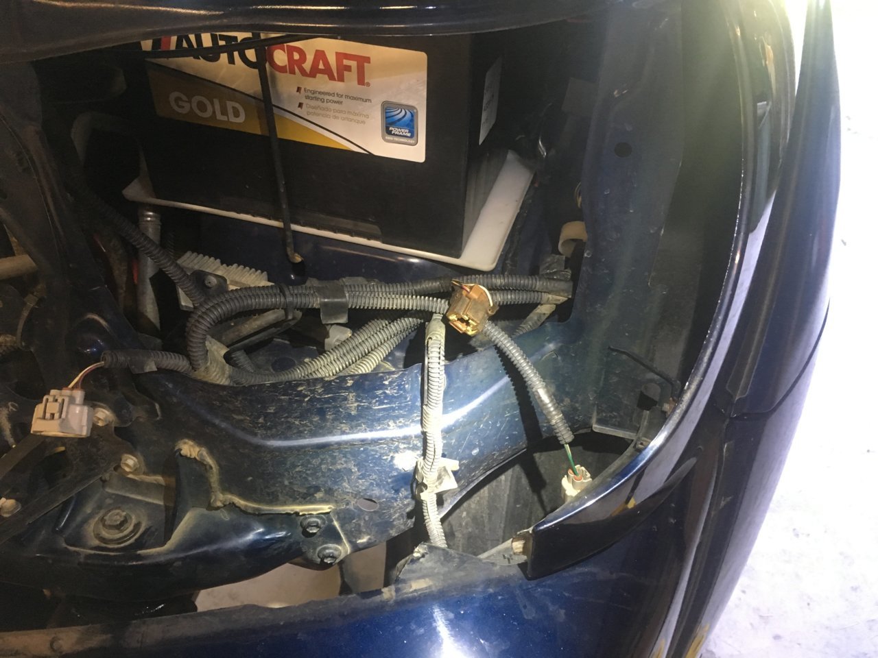

    I hit a pedestrian and fence and mine doesn't even look that bad. Lol.
    That part connects to where you hood latch is mounted so if I had to guess there is a lot of wind force trying to push your hood open..

    I've come to the realization that the only real solution for this issue is to cut the core support out and build a new one that isn't 20/22 ga sheet metal. I've got things in the works for my truck and I'll fabricate a core support.

    You got to just start cutting, 1.25” square tube worked great on mine, no bender reqd. Pretty easy to mount all of the bits n pieces, just takes some time.
    Yep, cut n rebuild.

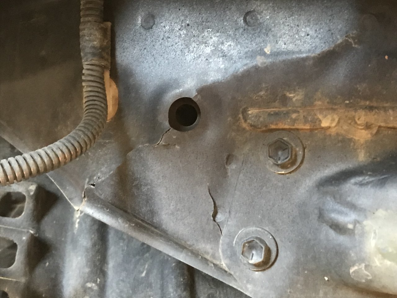

    i replaced my radiator support with a cheap ebay one. before i replaced it i added support to everything that needed support. including the radiator mounts. i basically boxed in the radiator mounting points. then i drilled out the spot welds and replaced the support using 1/4" bolts. that was at least 8 years and many dirt miles ago. no movement yet.

    Seriously? Even the cab implodes on itself? I'm afraid to look now.
    You did the work yourself? I tagged you a while ago asking more info about it but you never replied back. :(
    I still need to do this to mine!
    Fuck Toyota for doing this.
    In all truth they do it for crumple zone reasons, but the problem is that they advertise the truck to be able to be taken off road. Like, they push it HARD off road in the commercials too. Don't do that if you design your inner metal like shit. It's basically like false advertising.
    I remember that issue with the F150s!
    Now if Toyota would step up to the plate and design something to reinforce everything that would be fantastic, as they have the body design files to do so.
    That would be most ideal, or like Wishbone's and Sytfu's square design.
    What about the fender aprons? Those start cracking as well!
