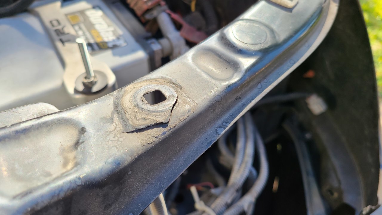

    No welding! Definitely MIG! It will weaken the structure. TIG is allowable, but if you kig you are inviting that support for even further future failure and weakening of it.
    That's crazy man. I have one coming right out of the corner of my fuel tank door. :mad:

    I've had that door crack for years. Small drill hole and silicone. Hasn't moved.

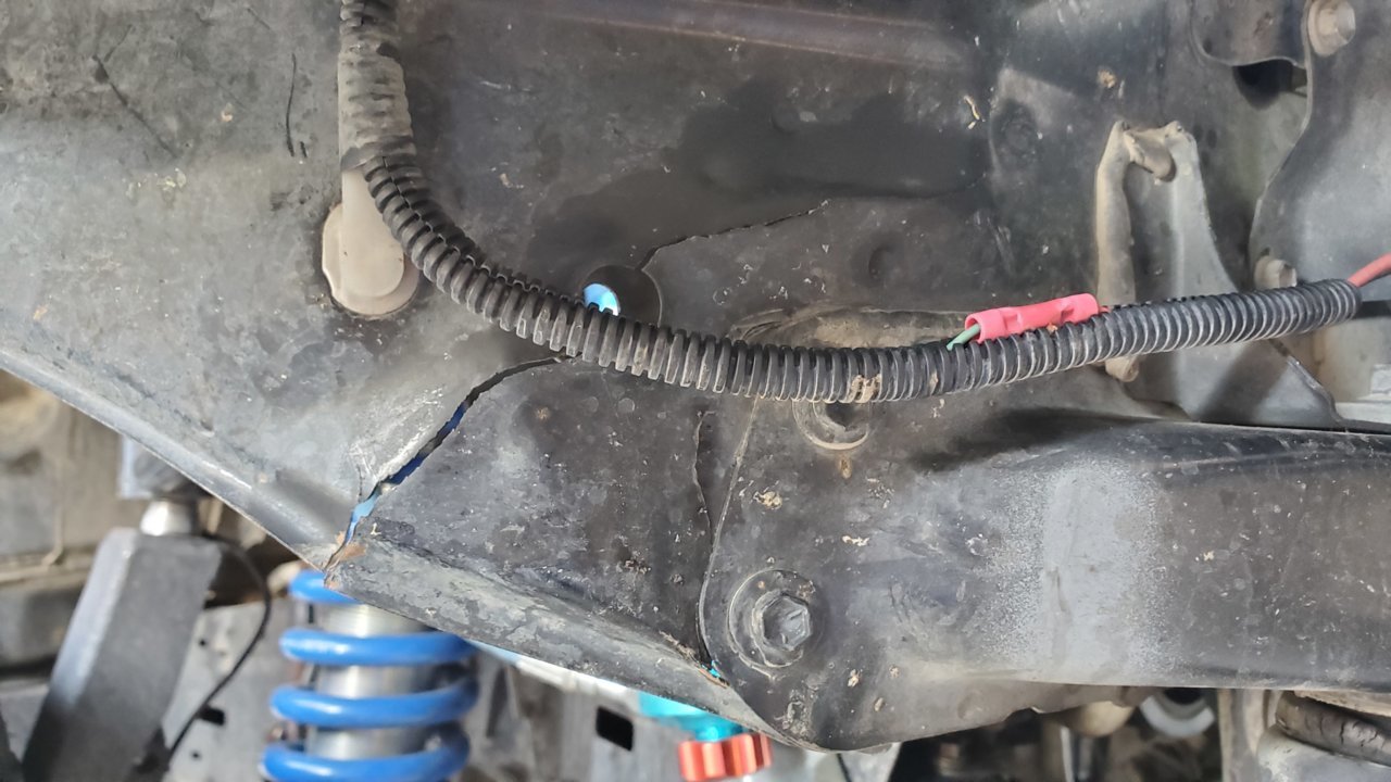

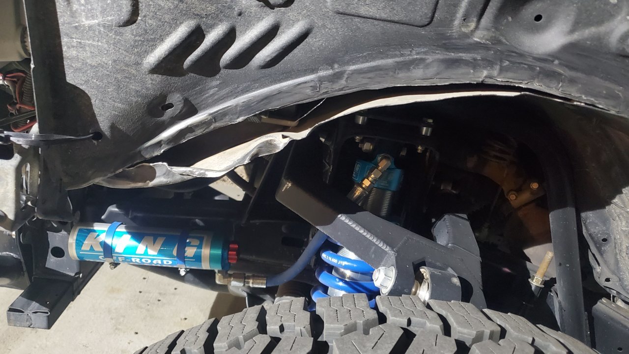

    Mine just started i assume this weekend [​IMG]

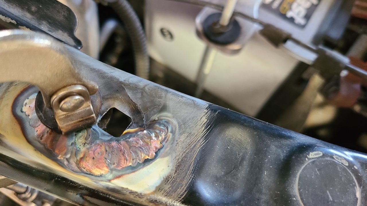

    Due to being ~18 gauge, I clamped a washer underneath to act as a heatsink. 40 amps on the TIG and it welded nicely, after the coating was ground off.
    A heat sink backing is the moral here. For those without a MIG.

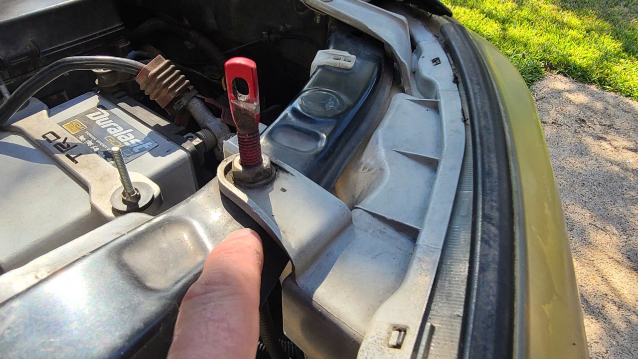

    Has anybody done this with round tubing?

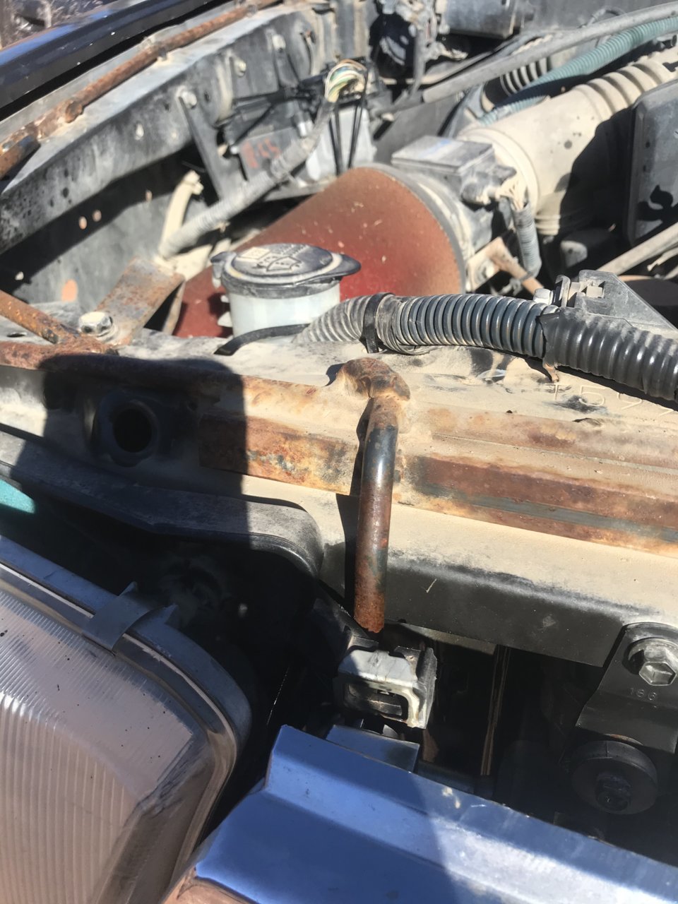

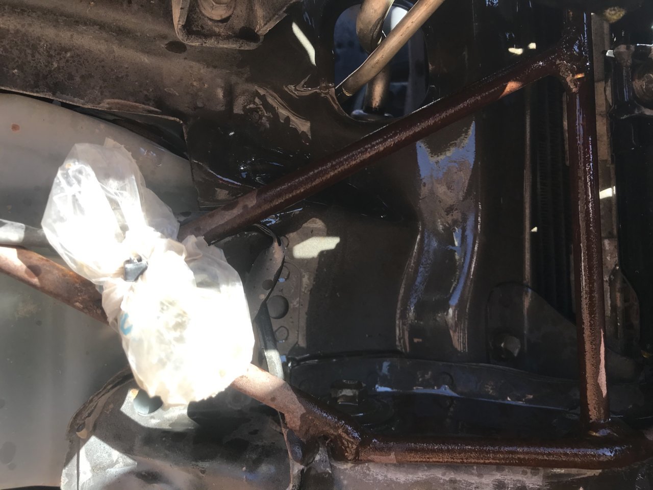

    I was just looking at my buddy’s 3rd gen 4 runner and he tied it all together with 1/2” round. Easy to bend and weld. Tied hood hinges all the way to the lower core supports. I’ll get pictures if he has the hood off today.

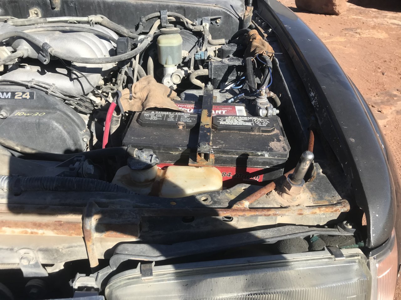

    Exactly what I did. Drilled out the spot welds and used 1/4” bolts to put it back together. Before I did I plated all the important stuff. Boxed the lower section and tied it all together with the radiato mounts.

    Here is my buddy’s 4Runner. It may not be pretty but it’s solid. Now he’ll fix the ac condenser mounts.
