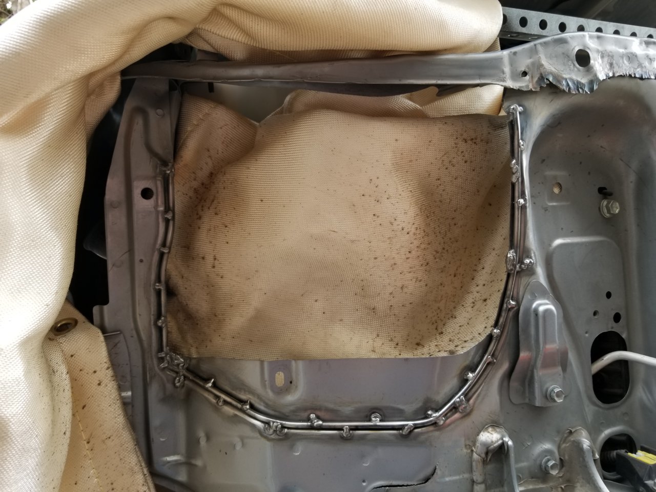

    I'm not sure what to say about the insurance route, but for what it's worth, my above fixes are holding up really well 1 year in (post quoted from the other thread on this topic).
    It was a ton of work last year, but I just pulled the front end back apart to check and do some very minor clearancing in a couple spots, and didn't see any further tearing - in those same spots or anywhere else.
    In my opinion, this is the best compromise I've come across for stopping it while still keeping everything as factory as possible.

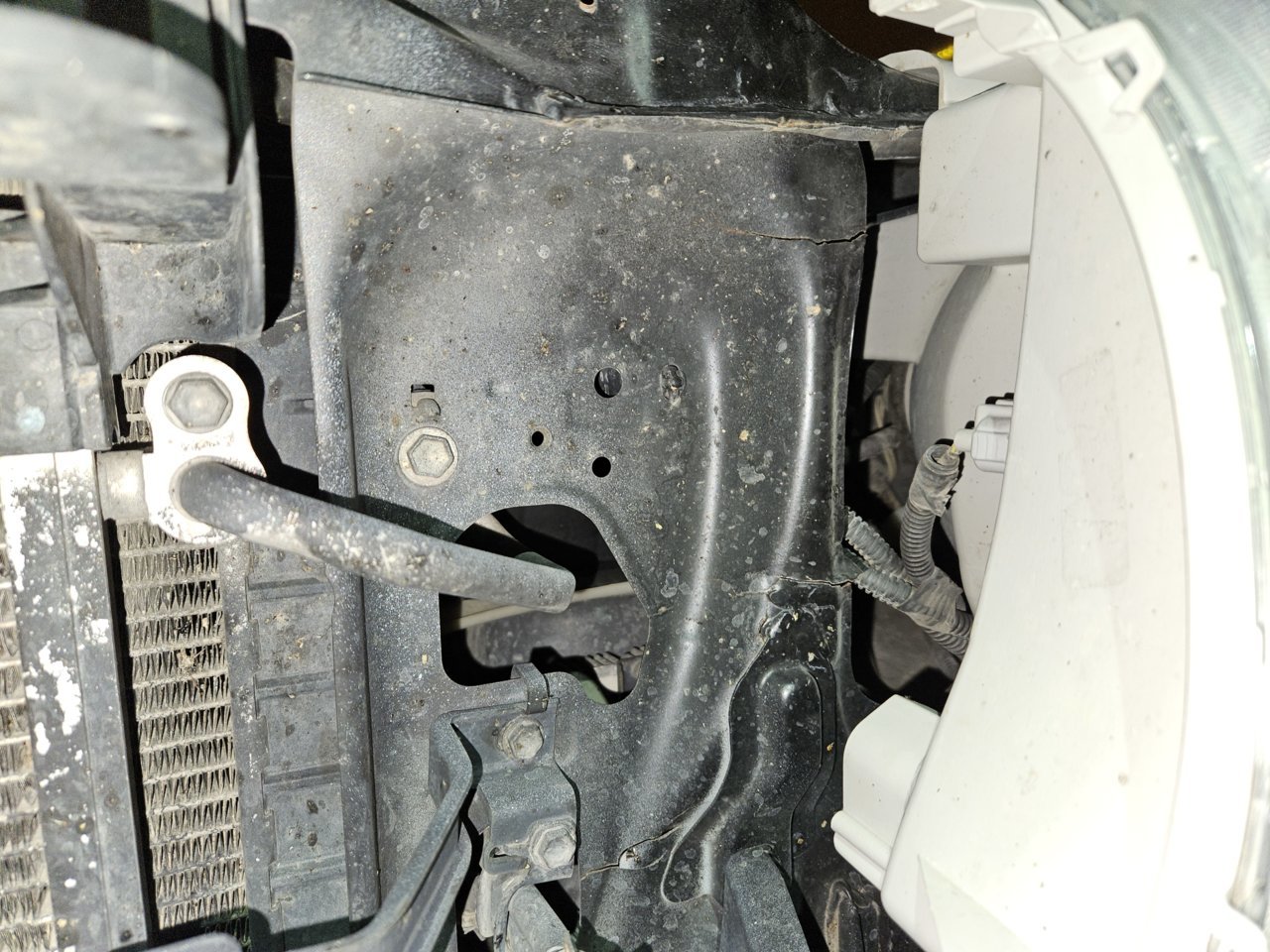

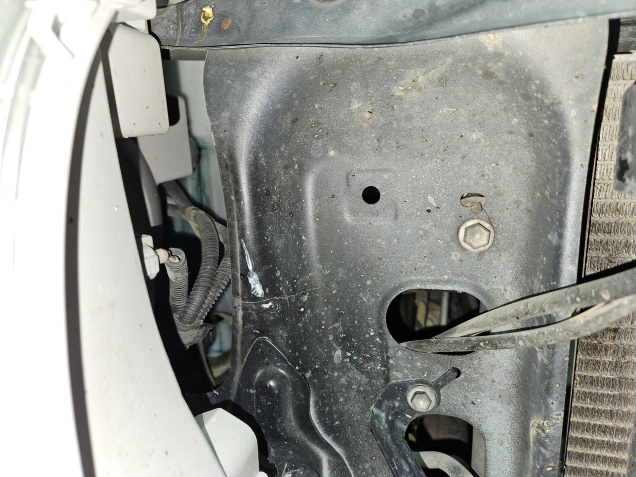

  17. Jun 20, 2023 at 9:31 PM
    #117
    ETAV8R
    ETAV8R Out DERP'n
    Feb 20, 2008
    #4832
    4,927
    MGM 09 AC 4WD V6 TRD-OR w/ Tradesman Shell
    Just the basics

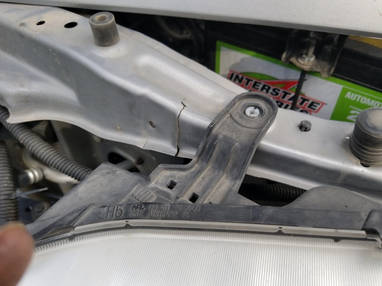

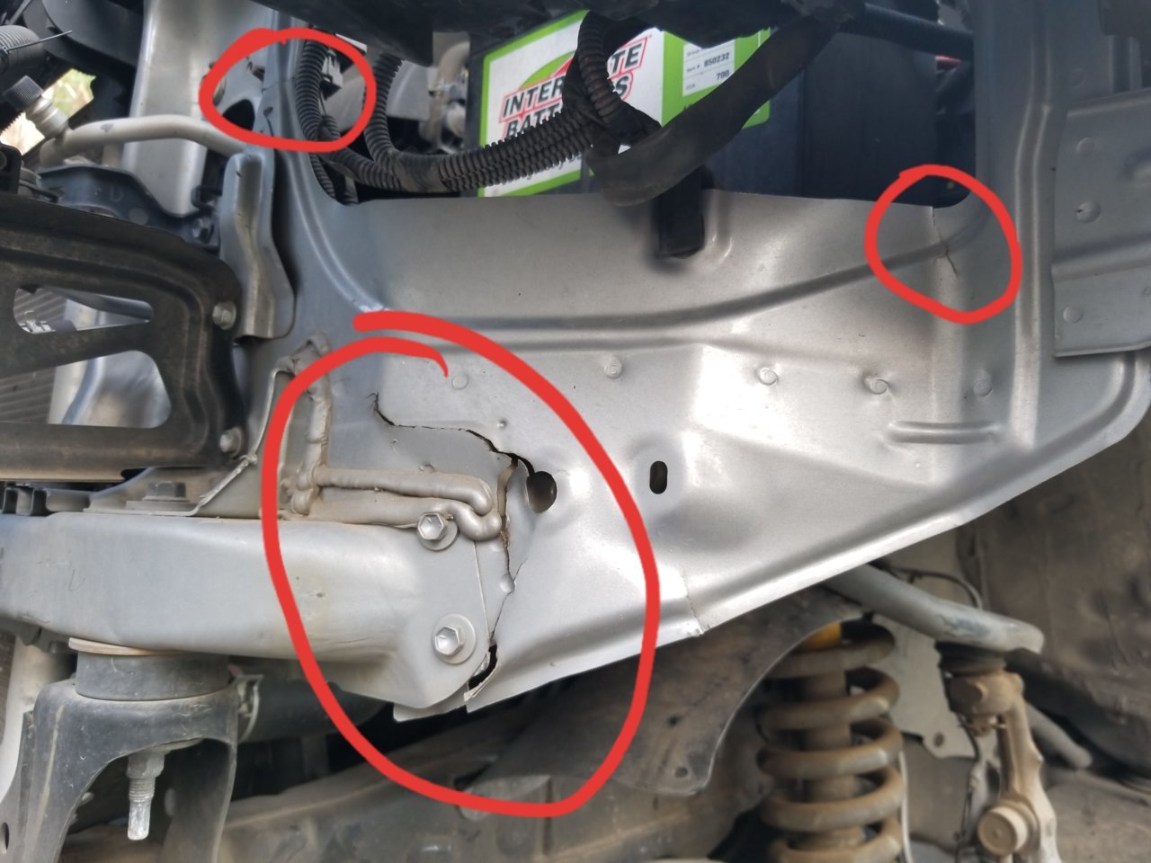

    I love my truck but hate the core support. Went to put in new spot lights and am seeing horrible cracks in the core support. Need to get the battery in the back seat with the aux battery.
