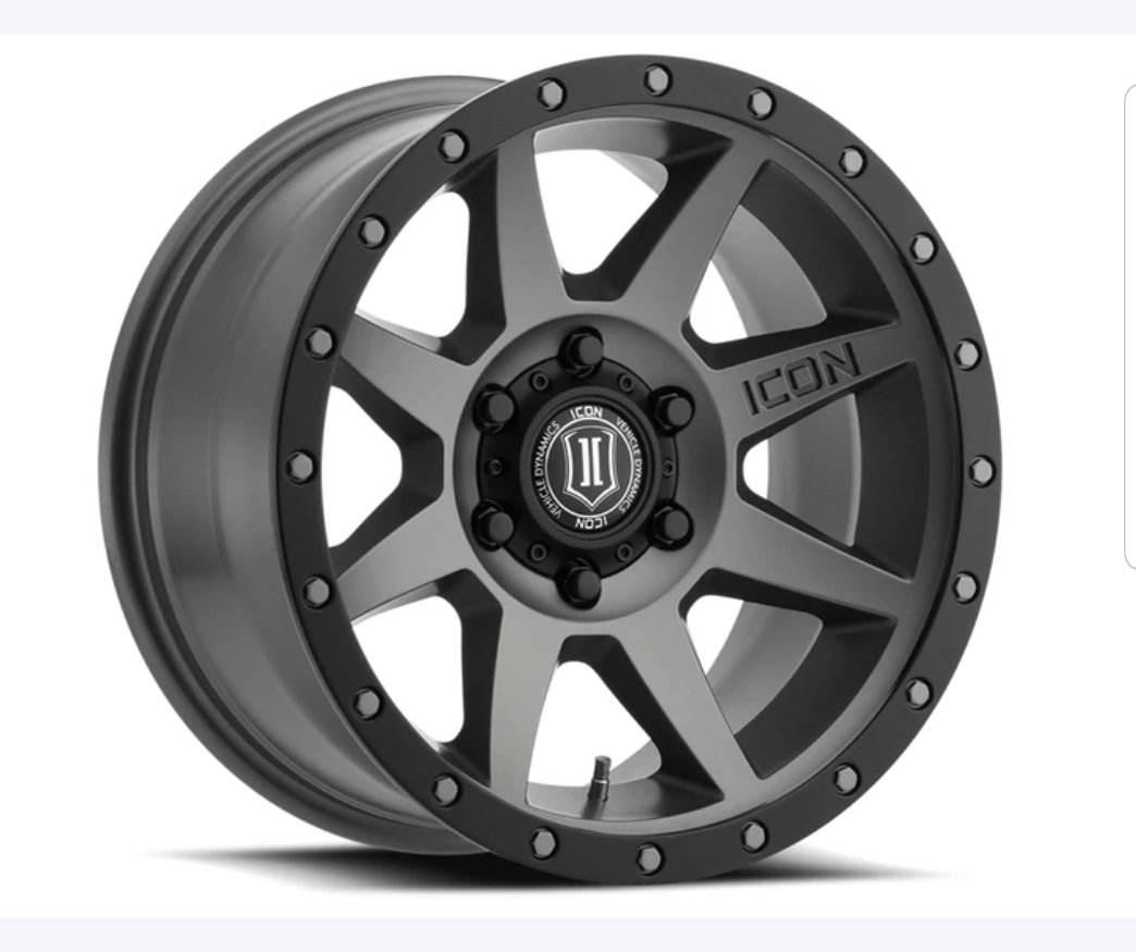

    Just picked up a set of Rebounds on sale, and want to make sure I have the correct lugs to get them mounted up on my '17. I can't find any info on Icon's website, and a quick search here didn't reveal much either. Hoping to order a black set to arrive around the same time as the wheels. Thanks in advance!

    You need 60 degree conical seat lugnuts.

    Anyone know the correct lug nuts to get for these wheels? They are going on my '19 TRD sport. The link above does not work. I would also like black ones.

    I have same question about lug nuts. Ordered a set of Rebounds a couple weeks ago.

    I will answer this. Just finished ..
    get :
    Lugs :
    DPAccessories D5246P-2308/24 24 Black 12x1.5 Closed End Spline Tuner Lug Nuts for Aftermarket Wheels Wheel Lug Nut
    Amazon link :
    https://www.amazon.com/gp/aw/d/B00JH1HODY?psc=1&ref=ppx_pop_mob_b_asin_title
    locks :
    Gorilla Automotive 71631NBC Acorn Black Chrome Wheel Locks (12mm x 1.50 Thread Size) Pack of 4
    Amazon link :
    https://www.amazon.com/gp/aw/d/B002809QXW?psc=1&ref=ppx_pop_mob_b_asin_title
    the splines worked out better because the tool that comes with them fits in nicely and allows you to hook on your t-bar
    locks come with a tool as well (adapter) that just barely works out
    Note*** the normal lugs (not spline) will not allow your crossbar to gain access for a grip on the lugs unless you have some adapter that is skinny that can fit in there and grip onto the lugs. The splines work out perfect
