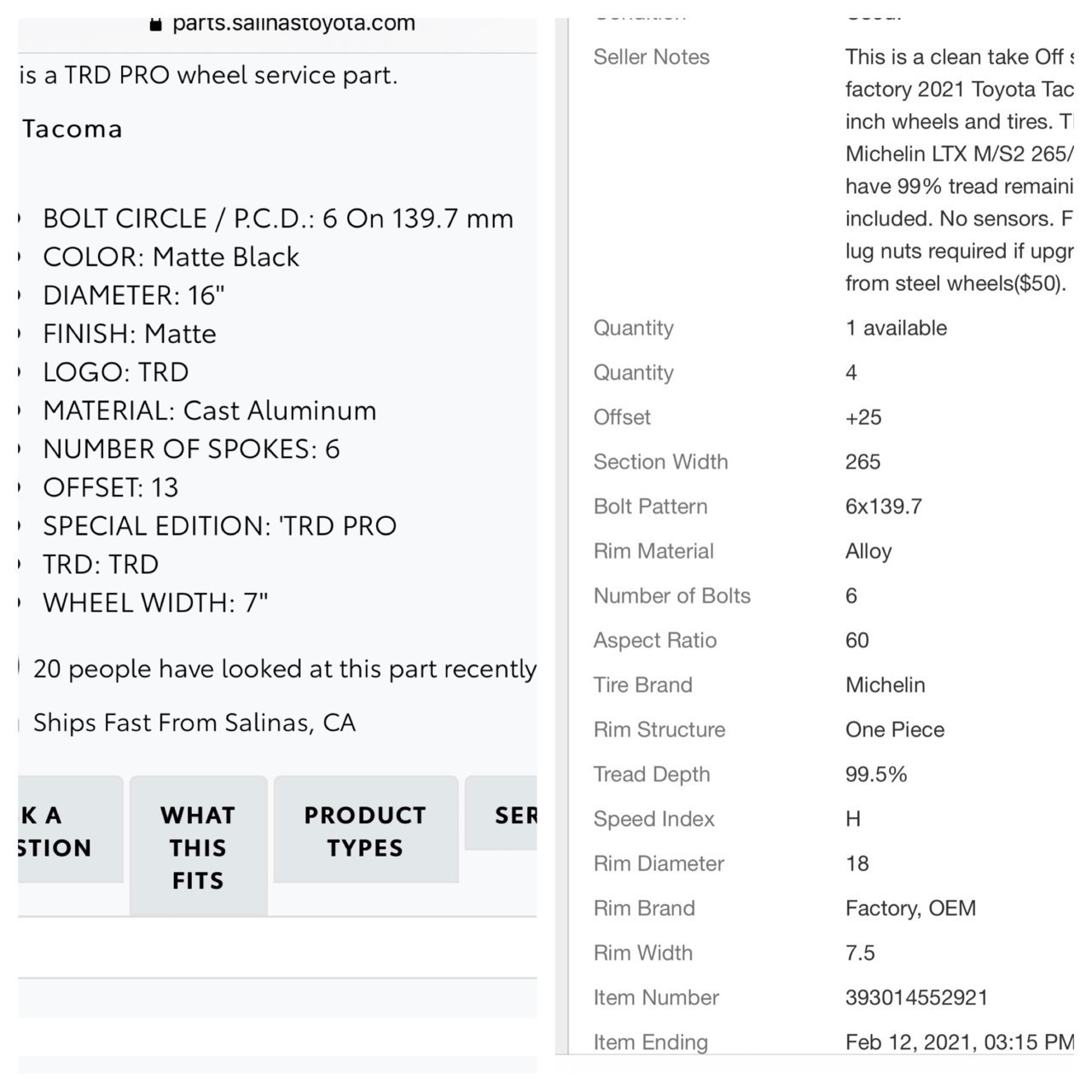

    I currently have 265/60/18R smoke wheels in my 2021 Limited
    **For which I can’t find the Part Number and detailed specs. If someone knows I’d really appreciate it.**

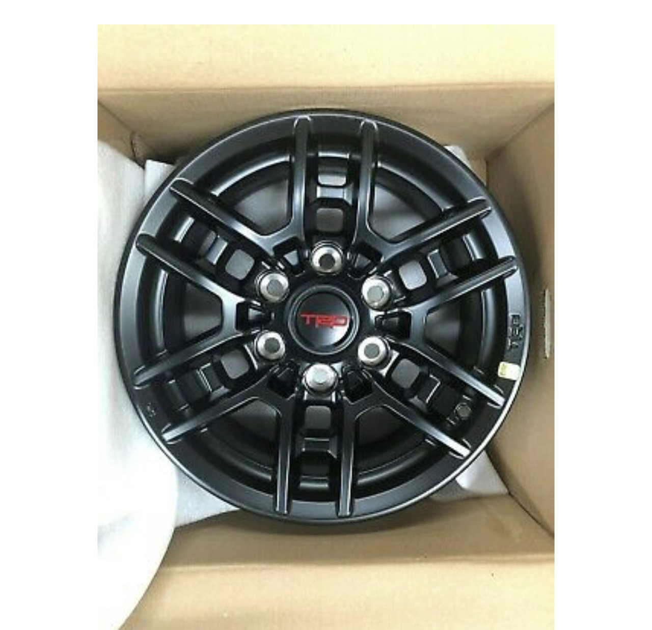

    I was thinking of putting TRD PRO 16” wheels on with a 265/70/R16
    Part # PT9463520002
    Supersession(s): PT946-35200-02
    • BOLT CIRCLE / P.C.D.: 6 On 139.7 mm
    • COLOR: Matte Black
    • DIAMETER: 16"
    • FINISH: Matte
    • LOGO: TRD
    • MATERIAL: Cast Aluminum
    • NUMBER OF SPOKES: 6
    • OFFSET: 13
    • SPECIAL EDITION: 'TRD PRO
    • WHEEL WIDTH: 7".
    • I’m just wondering if these wheels will fit my 2021 Limited. When I go on Toyota parts and search, it says they won’t. But I have been buying parts for this truck and I am noticing that they say a lot of things won’t fit a 2021 yet they do. I just don’t know if the websites have caught up with all the new models and specifications/Parts. Please advise. Thank You.

    I believe the bolt patterns haven’t changed on any third gen models/years. They should fit. Just out of curiosity, did you notice the picture and part link are two different wheels?

    My bad, yeah let me get the right pic up. Apologies.
    I see the Bolt Circle and PCD are the same in both wheels.

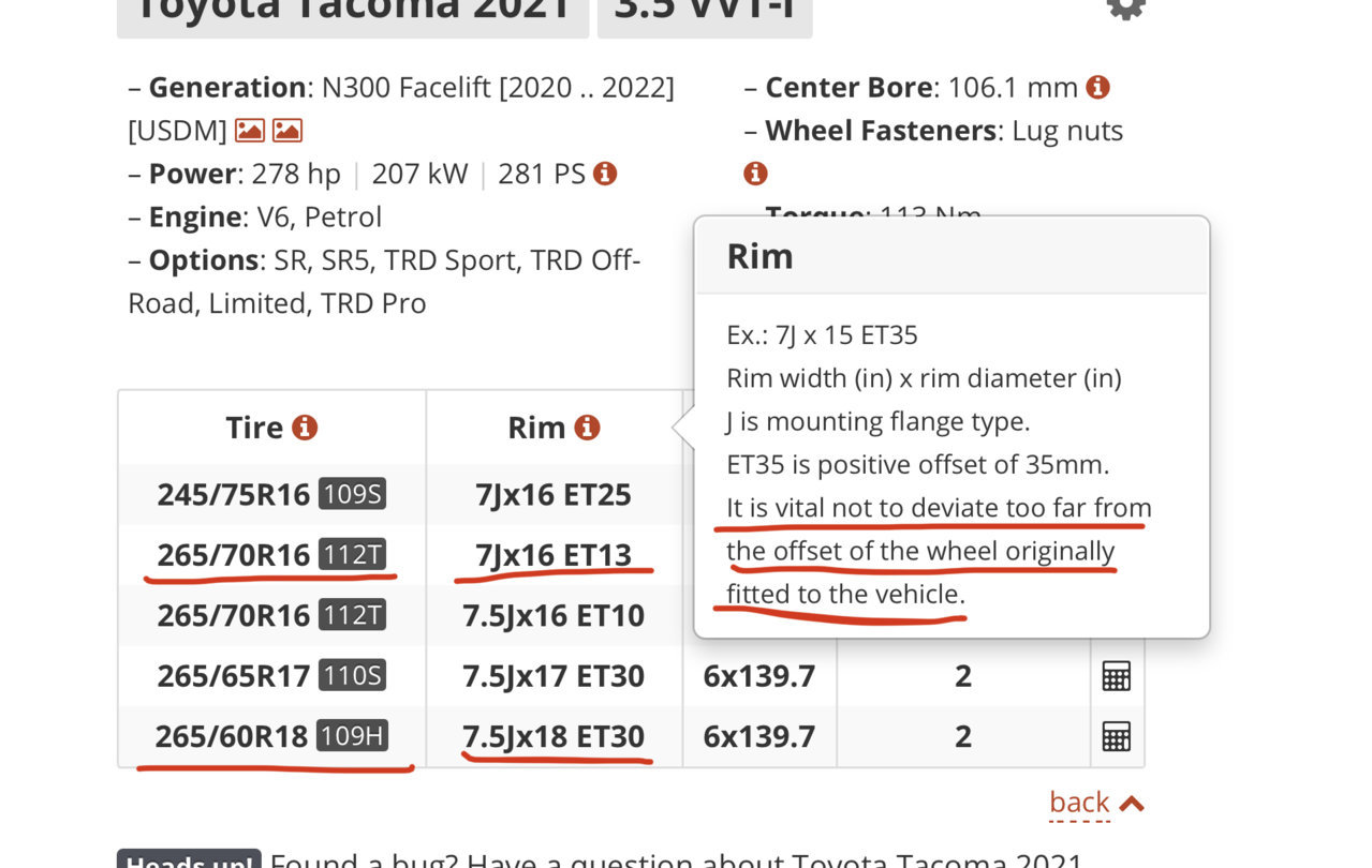

    But new one has a width of 7.0 and an offset of 13. And my current wheel is 7.5 and offset of 25/30.
    Will the difference in offset be a problem?
    Sorry if these questions seem trivial but I am new to this. This is my first Tacoma.
    I found a guy online selling my same stock wheels and tires and I screen shotted his specs. I still can’t find that darn part number of the 18-inch Nightshade smoke alloy wheels for the life of me.

    The wheels your are looking to purchase will fit perfectly fine. Pretty much any wheel from any 4x4 Toyota will fit actually. With some exceptions to clear brake calipers or some outliers you can choose from about any OEM Toyota wheel that came off another Tacoma, Tundra, 4Runner, GX470, whatehaveyou.
    I have 3rd Gen 4Runner wheels on my 1999 Toyota Pickup and they also fit on a Tacoma.
    Hope that clears up and opens up options for you, sir. Have a good one.

    You can also run a plus one size tire just fine on your Tacoma.
    If you get the 16” wheels you can run 265/75-16 tires if you’d like for an extra inch of rubber without any fitment issues. Good luck!
