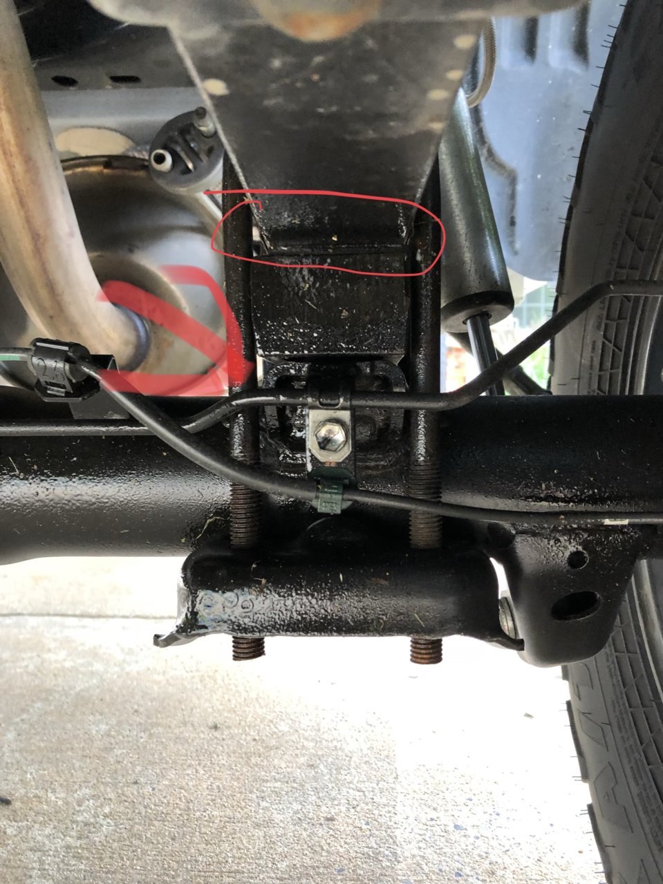

    You should have 3 degree shims from the factory (see red circle in pic) that should be sitting on top of the spring perch and under the spring (see red arrow) I’m running 1.5 blocks in the photo so you won’t have that. I can tell you when I added the blocks I left the shims out and had what you described...put the shims back in no issues. The shims are small maybe 1/4 inch tall at the rear and taper to nothing towards the front of the truck at first glance they look like they are part of the spring

    Just checked. Doesn't appear to have it. That normal to come from factory that way?

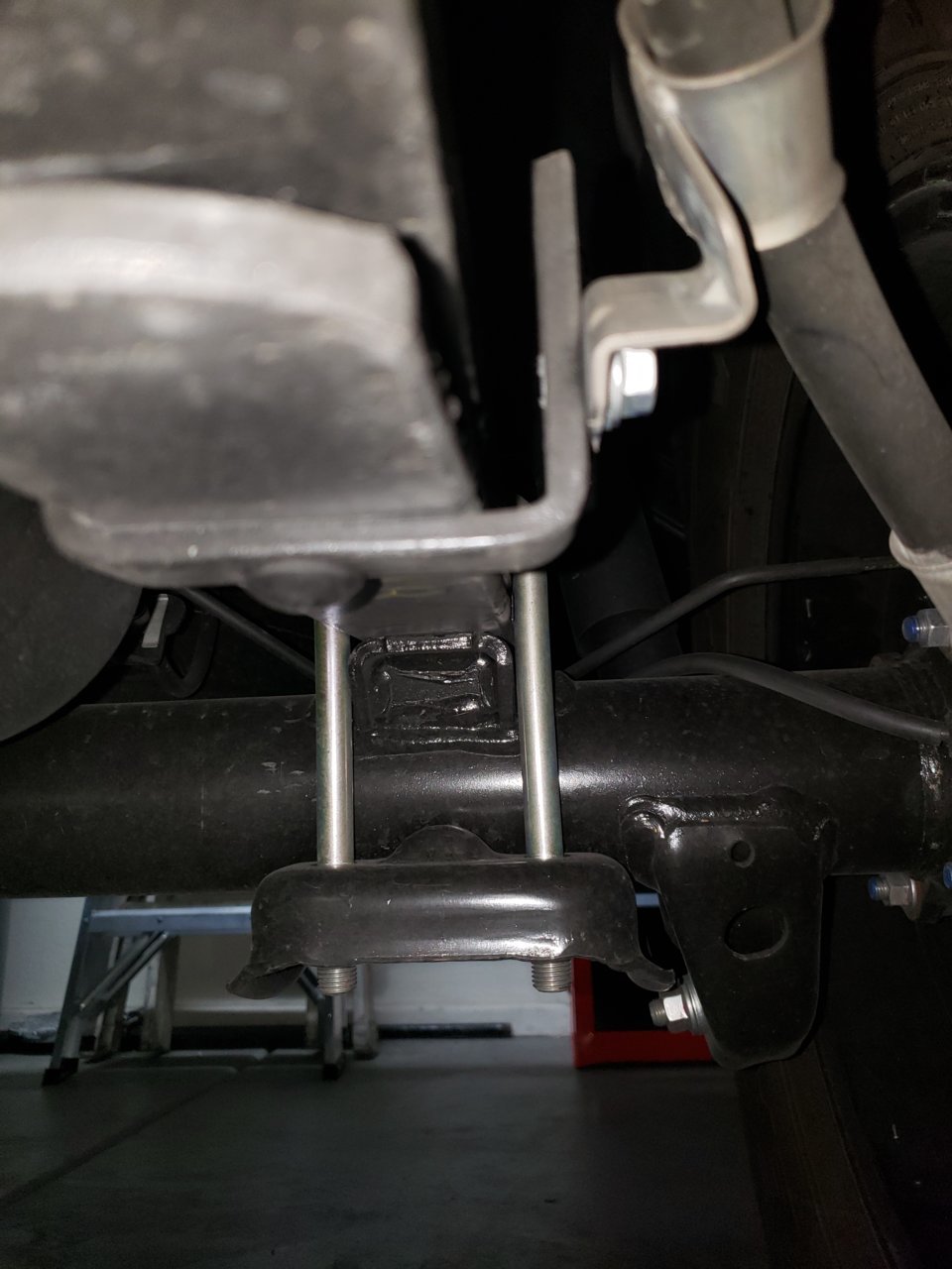

    Sin City

  16. Apr 27, 2019 at 11:39 PM

    Mine is an SR5 also.

    Sorry. I thought I saw sport somewhere in your description of the problem. Must have been the other thread I am giving advice in.
