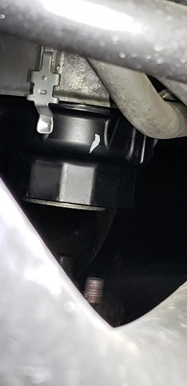

    Wait till it cools down a bit. Can you take a picture of how far past the retainer tab your cannister is? Mine ended up between the three tabs and following single tab at 18 ft-lbs.
    I have not bothered with toyotacare changes and mine has come off without issues. At first change, taking off the filter drain plug started to rotate the cannister so was not torqued tight from factory.
    Edit: bad shot but gives you an idea:
