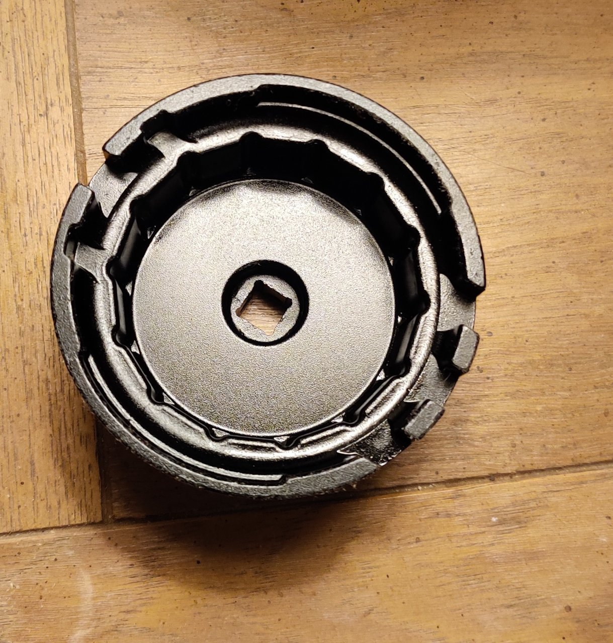

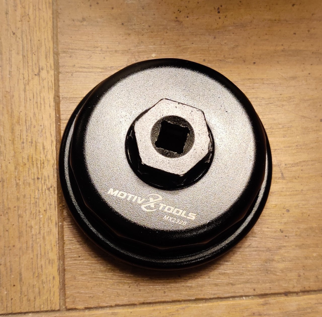

    At least I'm good and have no leaks. I'm going to have to work at this another day now at this point. With out a garage to work in and bad weather coming in a few days it's going to wait but ill be checking the oil level.
    Good to know I won't loose that much oil. A quart or two is fine considering. This is the wrench I used and it was well talked up here a year or so ago
    Looks like I'm going to need a breaker bar which I should have a 24" long one.

    I find they loosen easier when hot. The o-ring is more pliable.
    And yes, as was already said, slow and steady pull on a long-handle ratchet or breaker bar is the ticket.

    I have gotten the motivx tool on there but not really on there like it needed to be. I mention this just to share my experience. You also mentioned losing daylight so it could be a similar factor, in my situation on my son's Scion that has the same housing and less clearance to see. Bottom line is make sure the slots are correctly aligned, and push up on it to hold it squarely.
    As far as draining and not losing all the oil, I would believe it should work, and you'll know how much is going to come out when draining the housing.

    I use the Motrivx tool. Works great. I found the tool can be too tight and hard to get the hosing out of the tool when you put it on all the way. I found putting a light coat of oil on the inside of the tool makes it easy to get the canister housing out and you can put it on very snug which makes it easier to get the housing off. I hope this helps.

    This is the filter wrench I've been using and works great. Your problem isn't with the wrench, it's that you took it to a dealer to have your last oil change.
