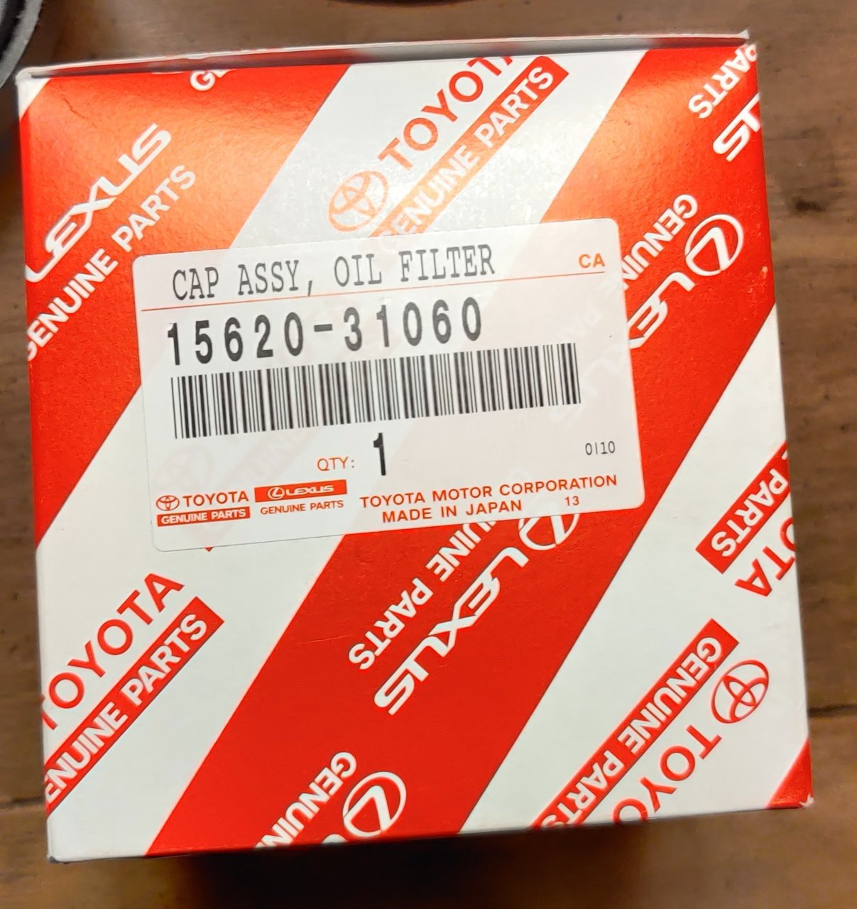

    This one?
    It's most likely going on when that one comes off.
    I bought it to have in case. Would have been on now but didn't have enough time to continue the struggle to get the plastic one off.
    Edit.
    The cap didn't come with the plug thing, so you can't use the one off the plastic one???

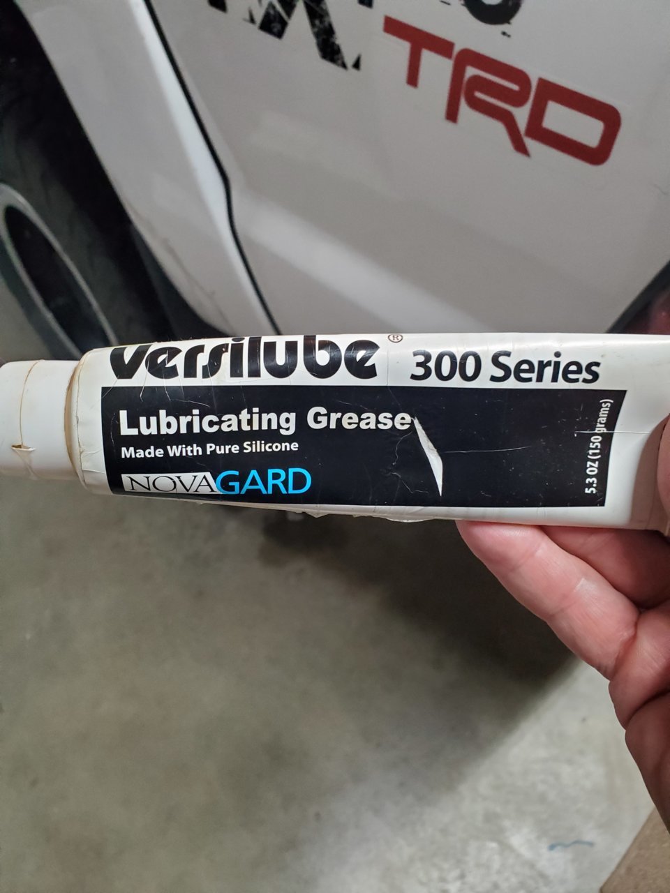

    I don't know if it helps but I get this stuff free from work when the expiration date is up. I lube those o-rings with it. Oil should work fine though.
    Wife gobs it on the two filter housings o-rings on swimming pool too. Just a basic o ring lubricant. 20220114_195941.jpg

    That's the one. I believe the plastic plug has the same three pitch but am not 100% sure.
