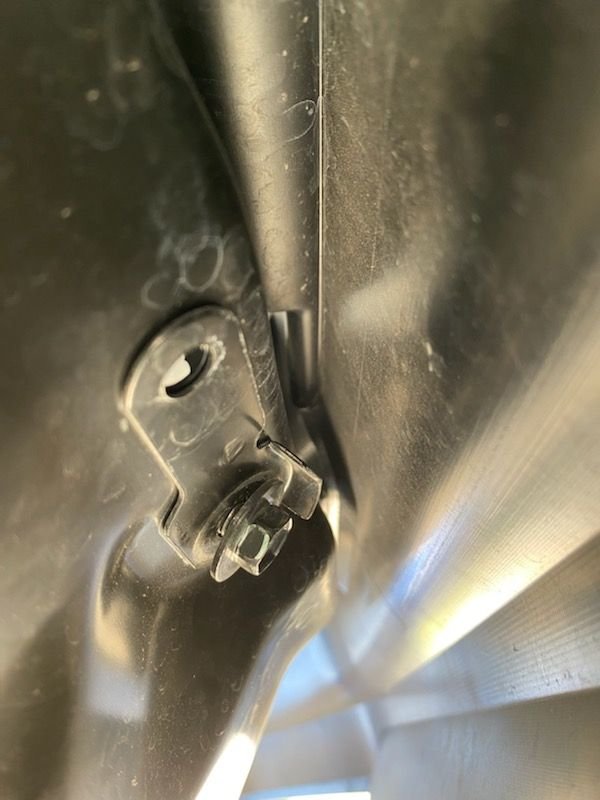

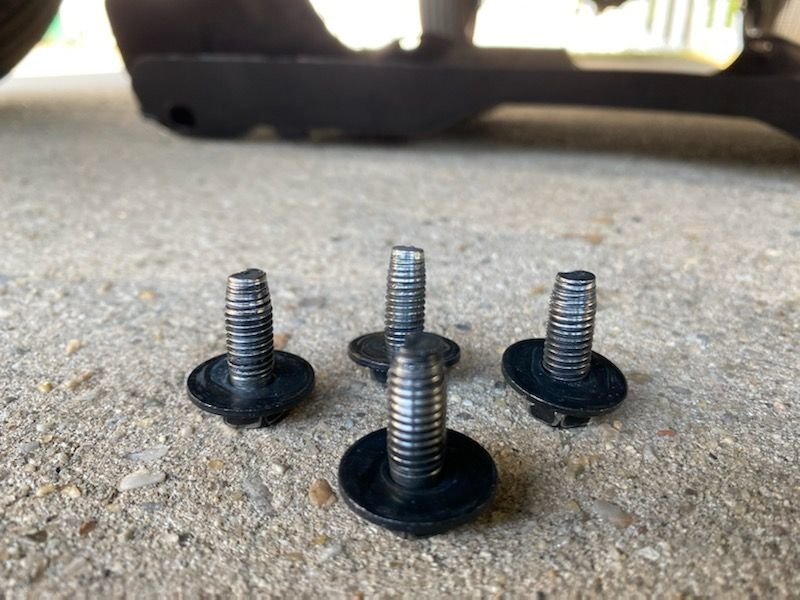

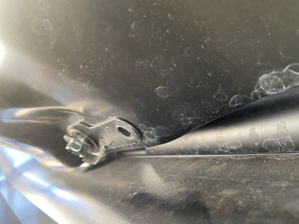

    Photos of said action from dealership:
    The Air Dam created a cumbersome task for the technician to properly bolt the front of the skid plate.
    These came from the previous skid plate.
    I'm glad the TRD Skid plate does not need the use of the threaded holes the previous skid plate seated in.

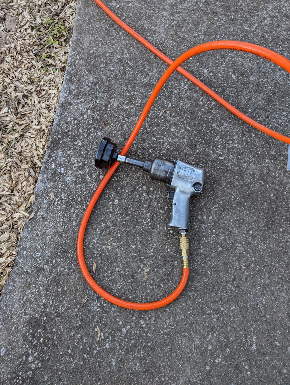

    Couldnt find my breaker bar but this worked.

    Shouldn't have to do that but did that break the plastic?

    nope plastic is fine. i replaced it with the lexus metal housing so i had a spare incase SHTF
