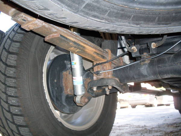

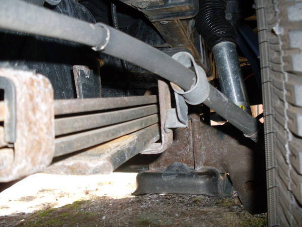

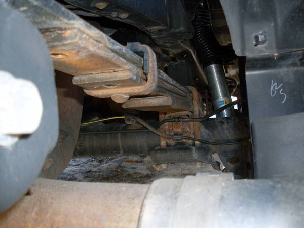

    I've got a few questions for the experts regarding the leaf pack for a 2007 Double Cab SR5. When I first bought it new, it would bottom out with a very light load so I took it in and got the TSB completed. Now, a couple years later, it's starting to ride like crap again and bottoms out lightly just going over speed bumps (unloaded). I crawled under to see whats what and found the leaf pack is sitting on the overload. The TSB pack temporarily fixed the problem but they settled out quick and I'm now riding on that thick overload leaf so it rides like crap. I rarely tow or haul and never anything overly heavy, how the hell have I flatened out a leaf pack already?!?! I'm not even at 50,000 miles! The everyday load is about 200 lbs since I have a shell and a plywood platform in the rear. This was just installed in November, it's been an open back up until then.
    Here are my questions, is this even worth taking back to Toyota (my guess is no)? Can I fix this with an AAL or are the leafs too far gone? Any other options? I've got Eibach coils in the front and would like to stay close to what was stock height in the rear. I've heard Dakar leafs are great, but I don't want that much lift in the rear.
    Here are some pics of what my leaf pack looks like today.
    Open to suggestions!
