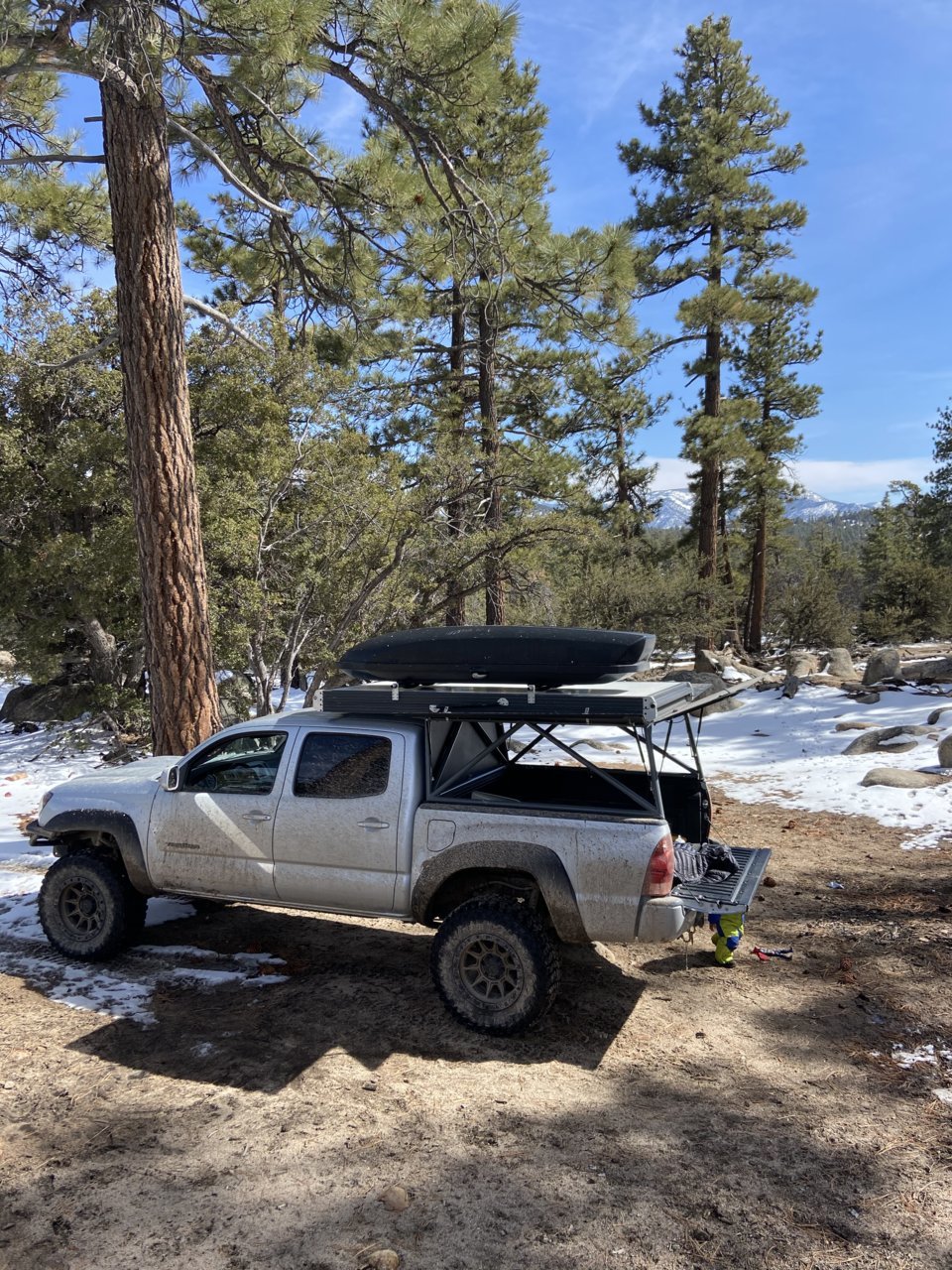

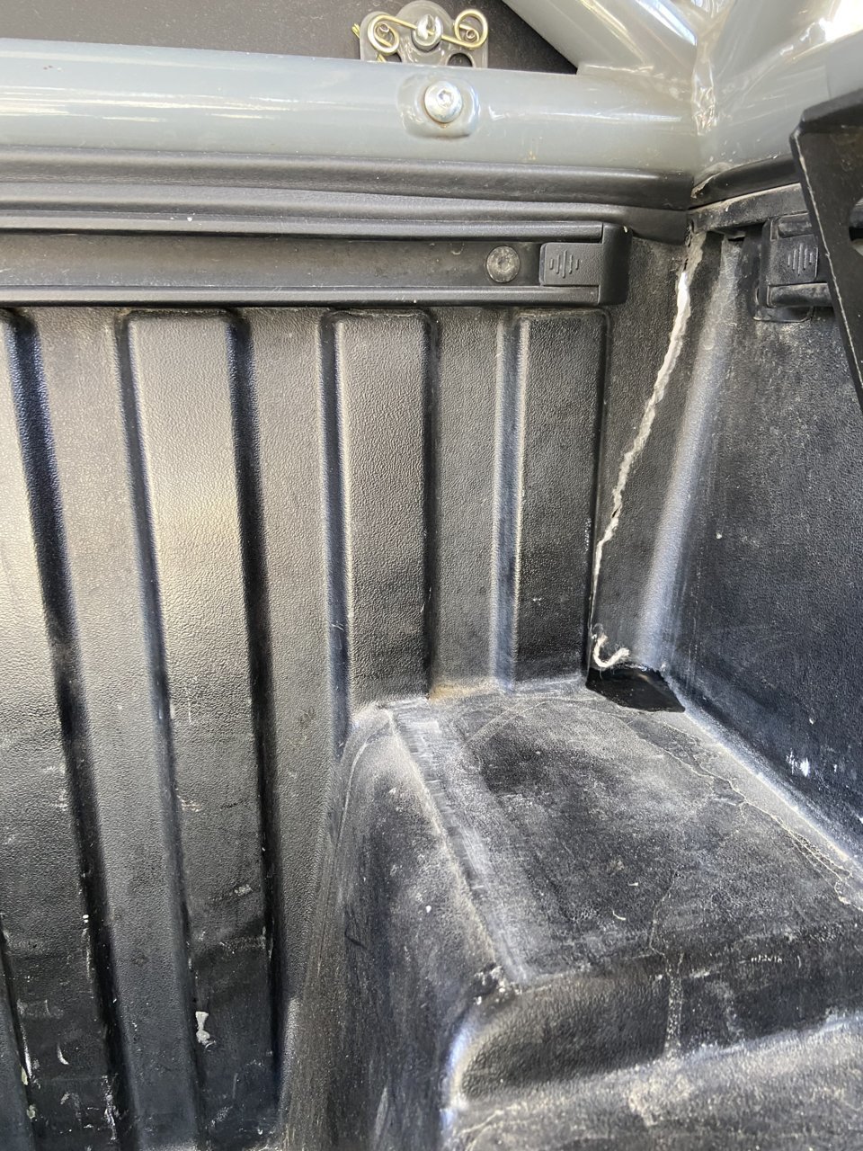

    976F0CB5-A1F7-4F10-BFDE-C05D7259A11D.jpg 3523C53D-67FF-402F-89D9-F1F73841BCF7.jpg I should have bought bed stiffeners. Too late now. What are my best options. Did the bed lose all integrity now that it’s cracked? I have a GFC and a cargo box on top. Maybe 350lbs dry. Way heavier when camping. I’m off-road multiple times a week, the truck definitely goes through a lot of flexing and vibrating. Should I just put the bed stiffeners on and seal the crack and call it good?

    I can’t say I’ve ever seen one crack on the cab side of the truck?

    Looks like the tire well, so cab side.

    That’s where I was confused. I figured the bed stiffeners would help by the tailgate because there is less structure.

    At the helm makes corner brackets or a piece that goes all the way across the front of the bed and ties in the corners that would be your best bet for support. The rear bed stiffeners wouldn't be a bad idea either. But you're bed is definitely compromised. I'd also go scrolling through big mike's (from marlin crawler) build thread in there they bobbed the bed and used some sort of epoxy on the bed to connect it back I'd look at doing something like that.

    Yep, you're done for. You could get the ATH front bed stiffeners to buy you some time, but your bed is done for.
    You sent it too hard.
    What is your suspension in the rear? It may be time to find a replacement bed tub like another linked above and then get some air bumps and address the rear suspension while the bed is off.

    Stiffeners will help prevent flex in the sides which could also eliminate what you just saw.
    To be honest, this is only the 2nd failure I've ever seen from one of these beds. The other appeared to have been caused by some sort of impact. I'd recommend trying to find one in a junkyard, personally. 2nd and 3rd gen ones should be the same, or very similar (minus a few cubbies on some).

    I have a buddy that’s gonna fab some support for the front of the bed, and I’ll buy the total chaos stiffeners for the rear.
    Suspension wise in the rear I’m running the icon RXT leaf pack with 2.0 resi’s.
