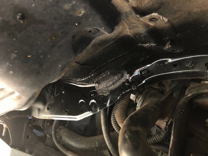

  9. Apr 30, 2024 at 10:21 AM
    #29
    DaveInDenver
    DaveInDenver Not Actually in Denver
    May 18, 2013
    #104390
    3,618
    David
    Grand Junction
    2008 Super White TRDOR AC 6MT
    Unexceptional
    Yup. Drill the ends of the crack, weld the crack between the holes and reinforce to spread the load. It's not a well done situation by Toyota and eventually will fatigue. The "right" way IMO is to drill a couple of holes through the fender and build a support to the frame to hold the battery. That's my next step if (when) this cracks again. The fender is already done so cutting a hole through it here won't hurt my feelings. This was just a hasty fix and has held so far for a couple of years.
