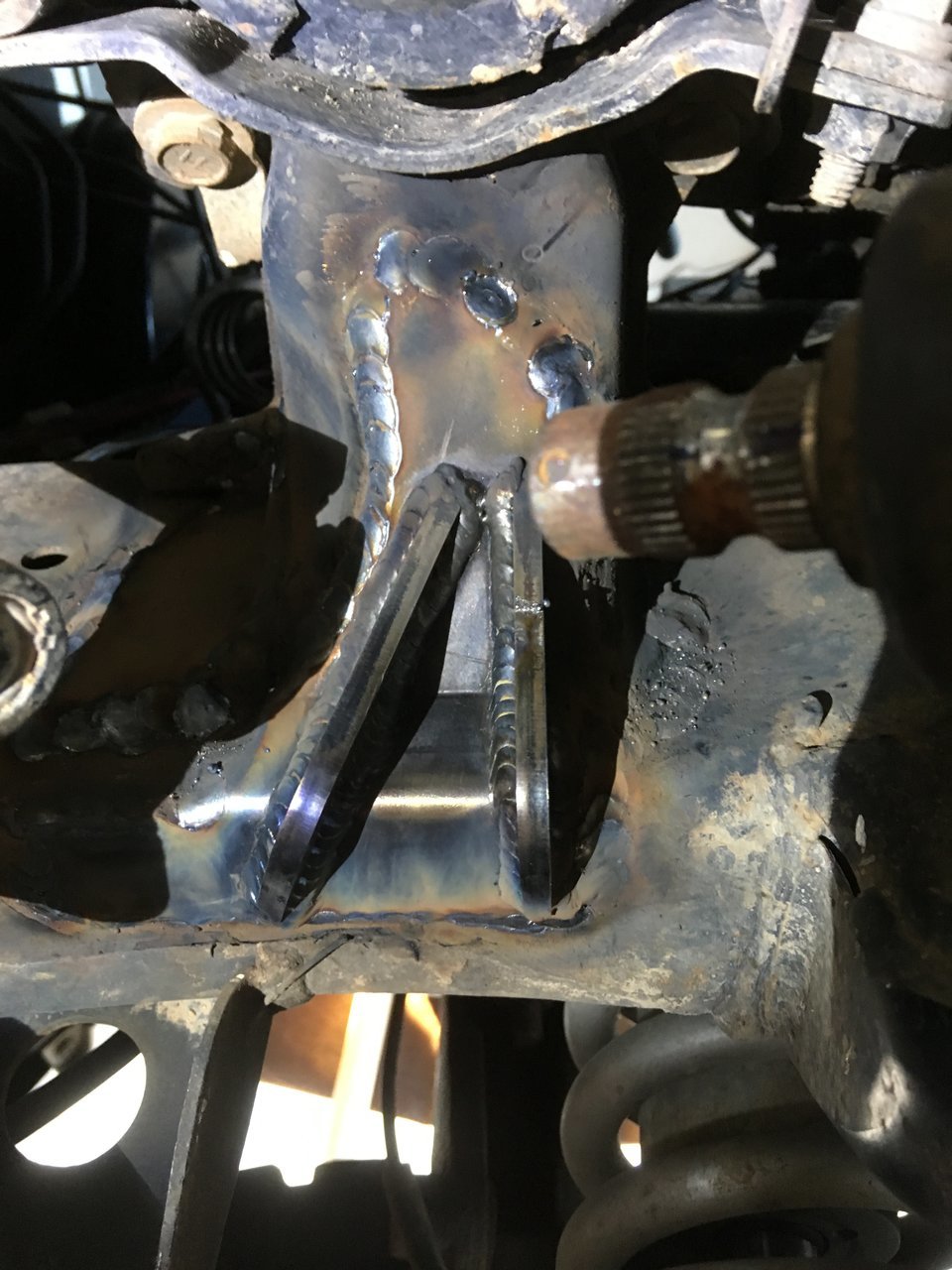

    He is having the crack welded and the dmz motor mount gusset kit welded for added strength.
    http://dmzfab.com/product/tacoma-motor-mount-gusset-kit/
    Toyko Joe likes this.

    I welded the entire crack, all the spiderwebbing, and added the gusset kit.

    I need to do this.....haz welder must weld

    Ive done quite a few, seems to be very common among the 05-06 mounts!

    The kit comes with gussets for both sides, however the drivers side is a 2 piece gusset, much stronger than the passenger, but the drivers side is the one that typically fails. So I did both.
    I was welding on a slider kit last week and noticed it, so we did it for both reasons actually, it reacted my making a clicking noise and we prevented a complete failure by fixing it.
    Now he wont need to worry about the engine perches at least!
