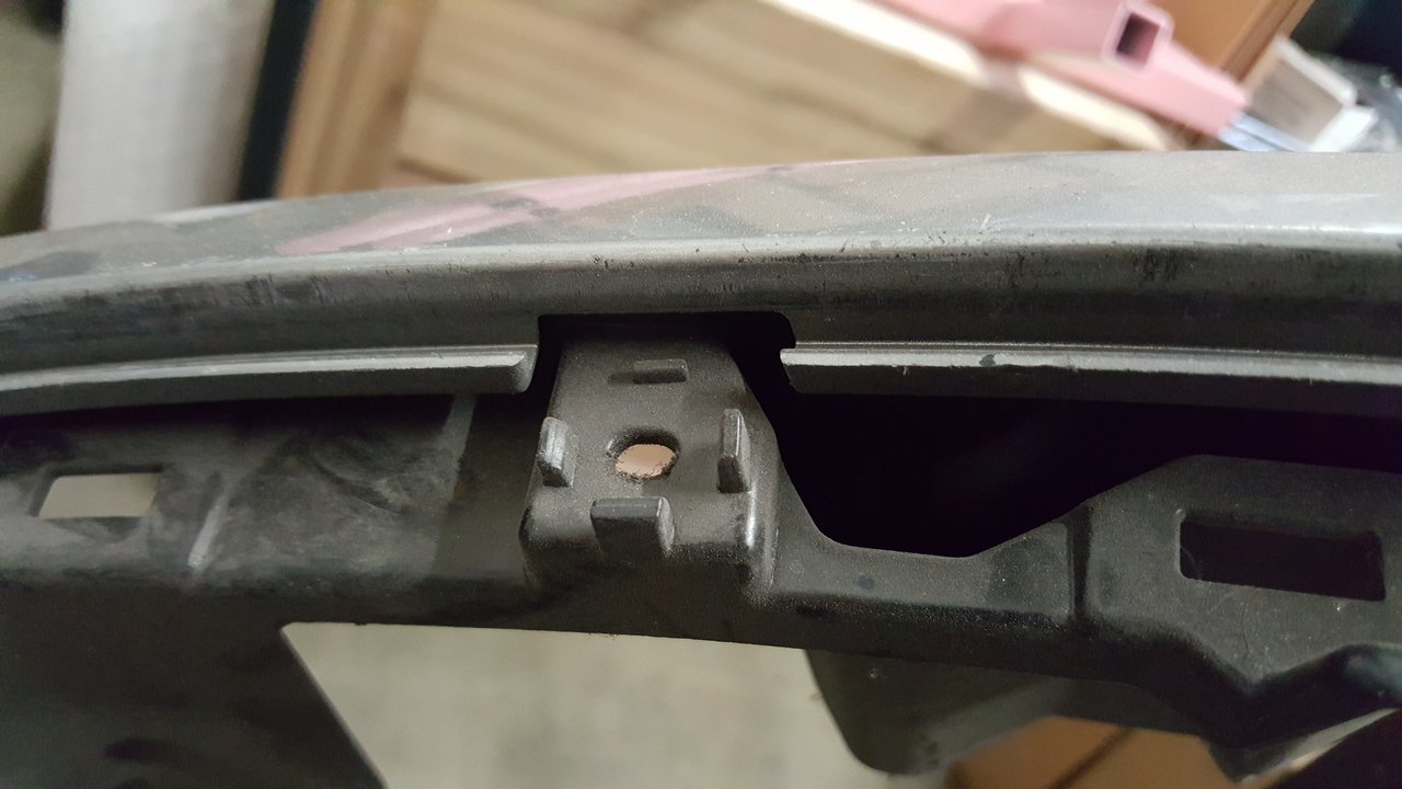

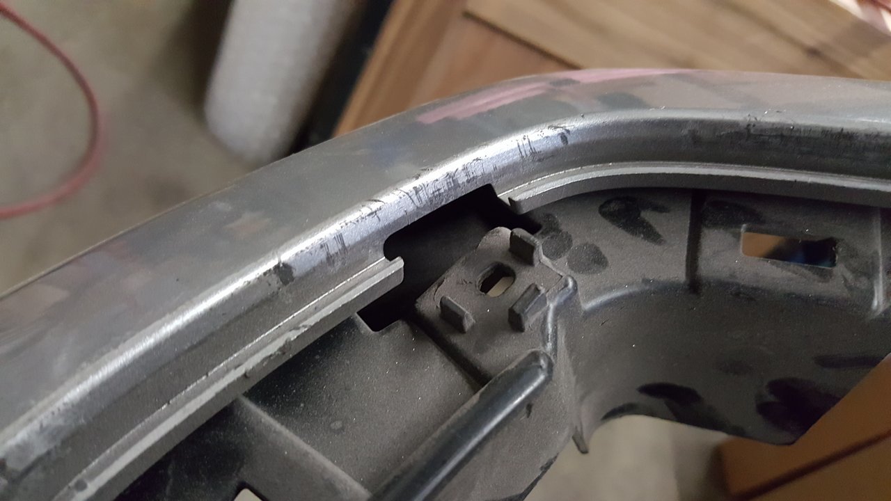

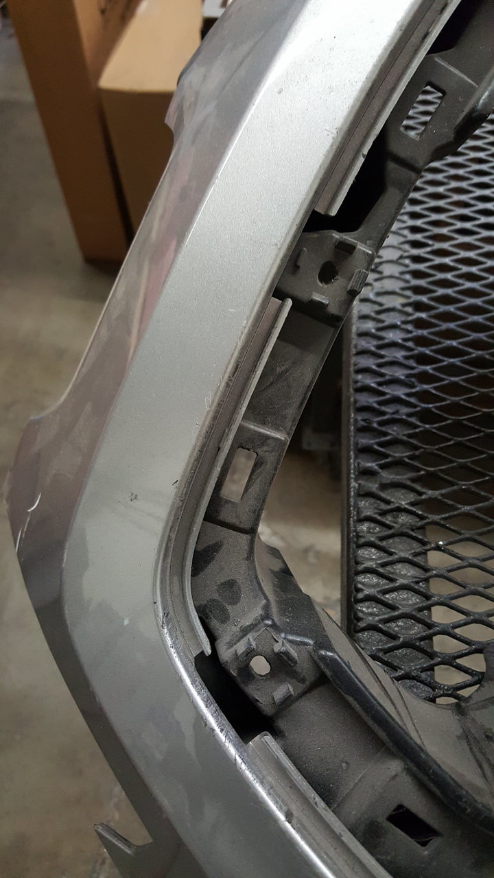

  19. Jan 22, 2018 at 9:20 AM
    #59
    JLee
    JLee The Man! Vendor
    Jul 20, 2010
    #40461
    19,619
    Jerry
    Grass valley CA
    02 Extra cab SAS Linked front and rear
    I lost track thousands of dollars ago.
    It's unfortunate to see it happen in the cold areas of the country but it's physics the plastic surround has two spots on it that can cause it to fail when it shrinks pictured below. The nature of the design of a recessed grille is it will not warp or contract when pressure is applied like a flat sheet. This is why your not seeing this happen on our ECO Grille the same exact frame size at the recessed grille or other grilles on the market and they are flat steel with no structure.
    These sections need a little reinforcement to handle the shrinking surround in bitter cold weather. That is why every cracked grille you see is happening in the same places.
