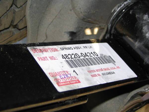

    This is kinda what I am talking about with the #2 being short..
    Pic of TSB leaf:
    Pic of non-tsb leaf.
    Maybe I need another picture, but the 2nd leaf on the top pic does look like it extends further up the main leaf..
