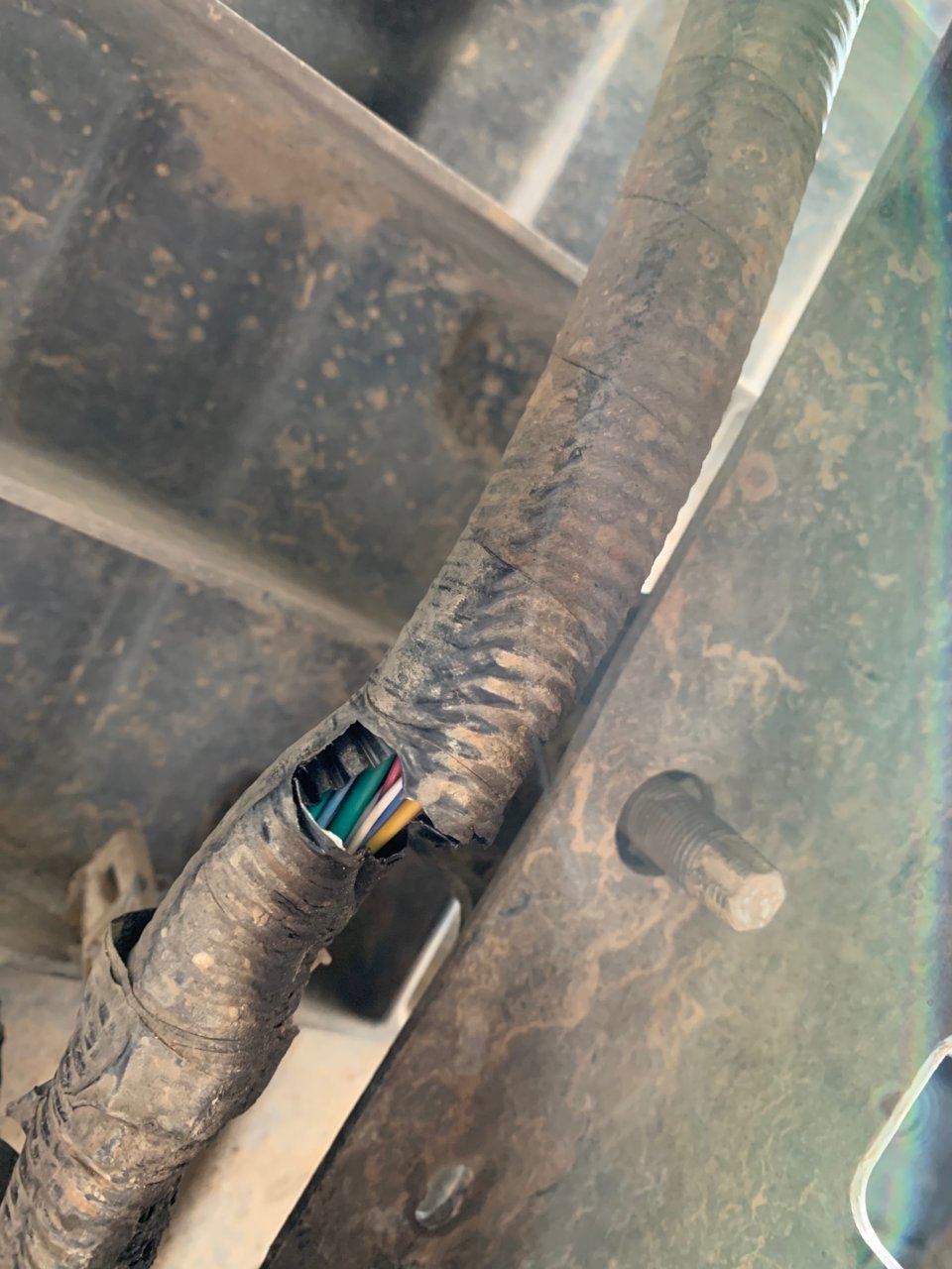

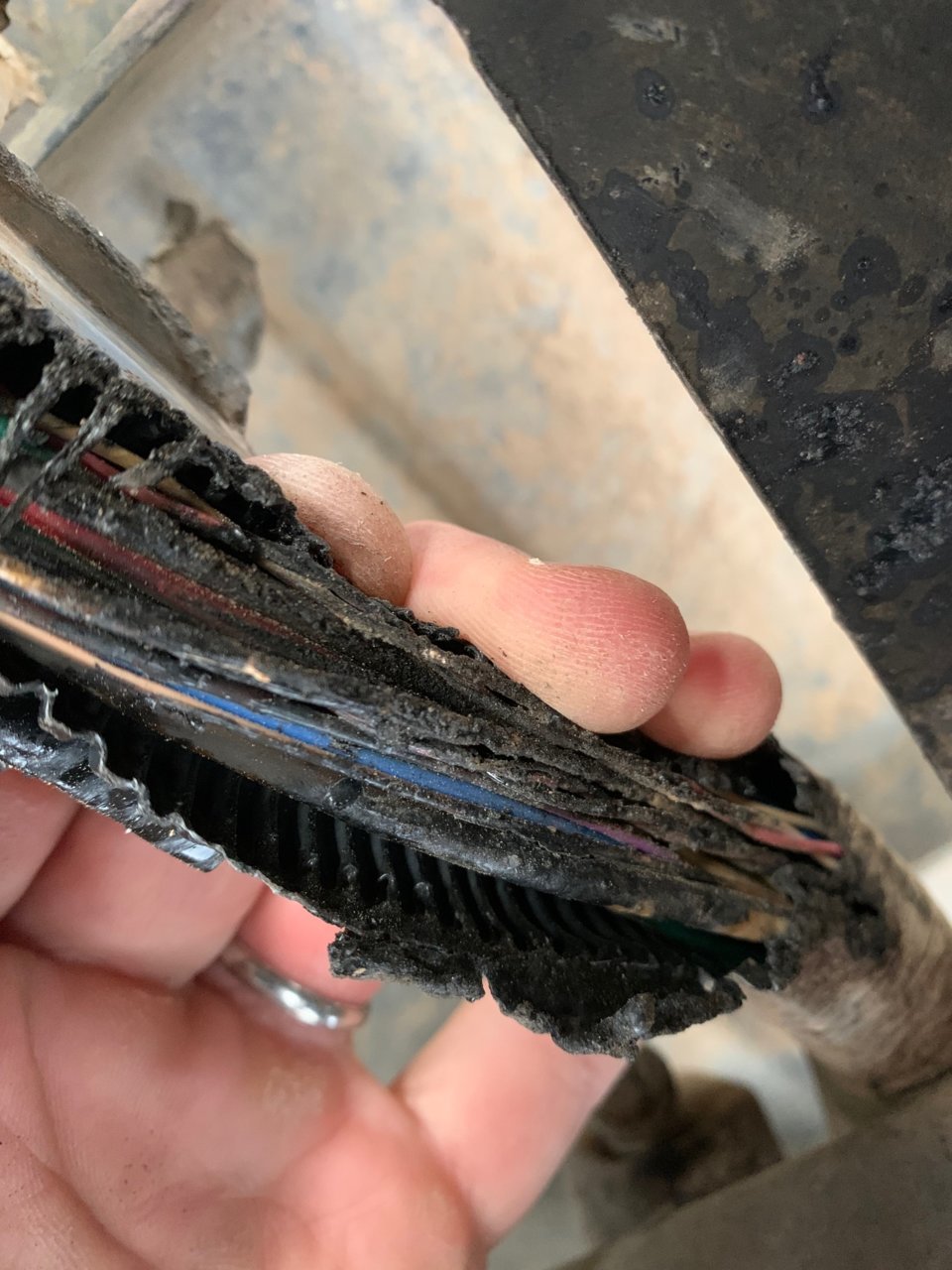

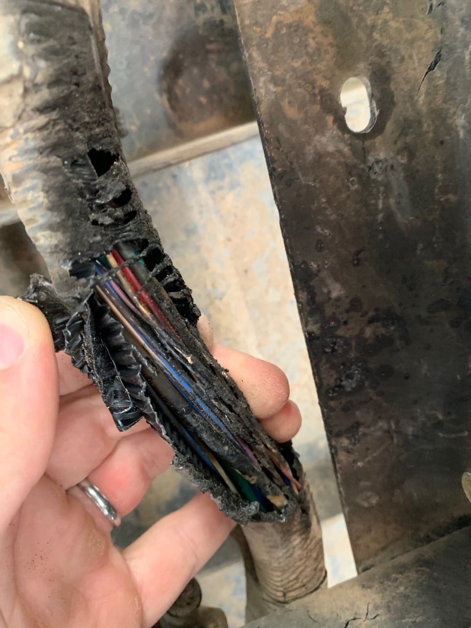

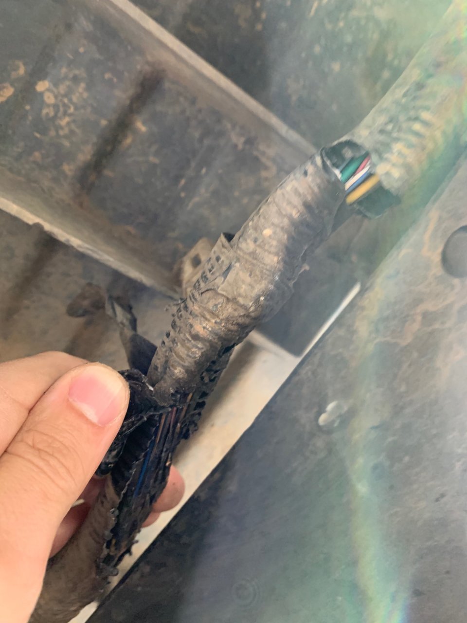

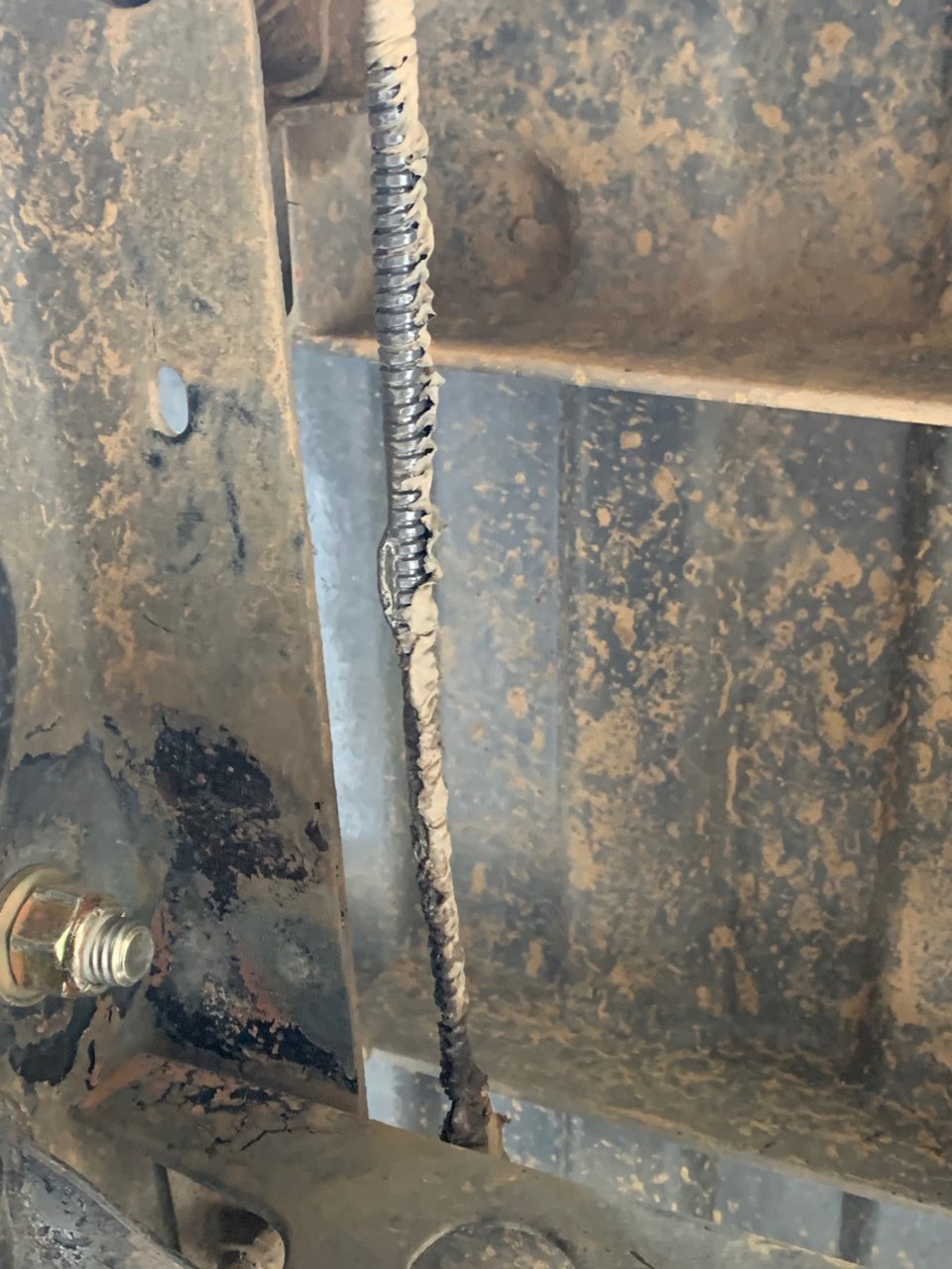

    in the name of saving time i hired a welder off of craigslist to burn out the rivets for my BAMF rear leaf hangers. haha i know everyone is gonna tell me it was a big mistake, and well IT WAS A BIG MISTAKE. He burned my main wiring harness that runs down the drivers side of the bed and he charred the casing on the wiring harness on the other side of the bed. All of the electronics on the truck work and there are only small bits of copper exposed on one or two wires, but im sure when the rain comes the issues will start to show up.
    Im not going to try and put it back on the welder because he was a good guy who needs a break, so now im trying to see what my options are. Ive been speaking with Toyota and it looks to be a 3500 dollar fix and my insurance would cover it. what other options do i have?

    It’s just copper, no sense in replacing a wire harness. Learn to solder if you not already know, cut that chunk of wire out and replace the wires. Be sure to use heat shrink on your work. When it’s all done replace the split wire loom with new stuff, put a little electrical tape across the loom. Doneski.

    Wiring is cooked on the one, loom only by the look on the other.
    On the cooked side, remove be the loom 12" either side of the burn. Working one wire at a time, cut the burned section out at least 1" beyond the charred area and solder in a replacement section. Cover each splice with appropriate sized marine grade heat shrink (with adhesive).
    Try to stagger the splices as not to build too much bulk in the harness by putting them all in one spot.

    I'd grab a Deutsch connector (autosport if you're fancy, DTM or something if you're cheap), cut out the damage, pin everything, and install a connector there. Other than having to work under the truck it wouldn't be that bad unless there's too much to cut out and not enough slack.
