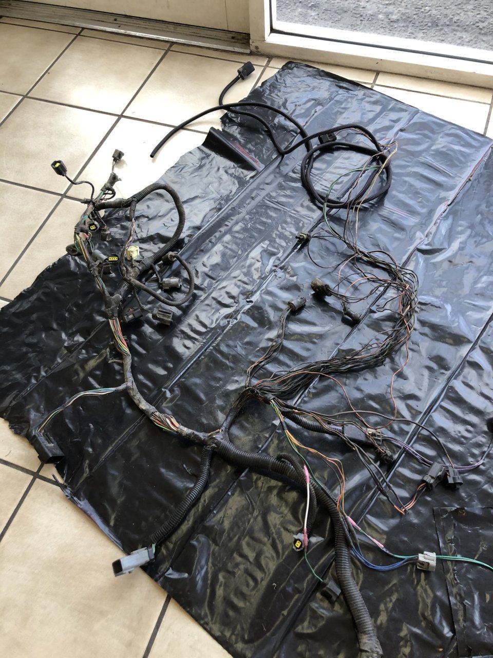

    This is a really simple fix, disconnect the battery and do one wire at a time. Alternate the lengths of each one so you don’t have a bunch of butt connectors in one spot so that the loom will fit back over the wire and it will look professional. Use high quality butt connectors and heat shrink separate, don’t use the butt connectors with adhesive heat shrink on them as they won’t be as soft and pliable. I redid an entire engine wiring harness for a customer of mine that had some serious wiring and electrical issues. I started with one wire traced it until the wire was good and spliced a new wire in. That was hundreds of wires and I’m no electrical expert but I bought high quality made in USA tools, and I tested every single connection I did and didn’t have a single problem.
