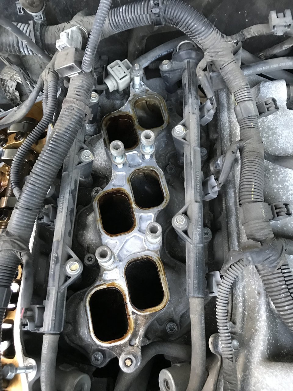

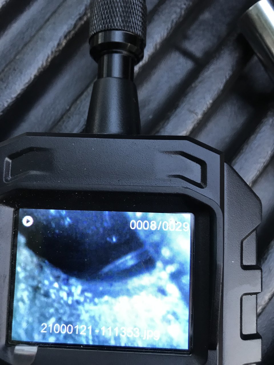

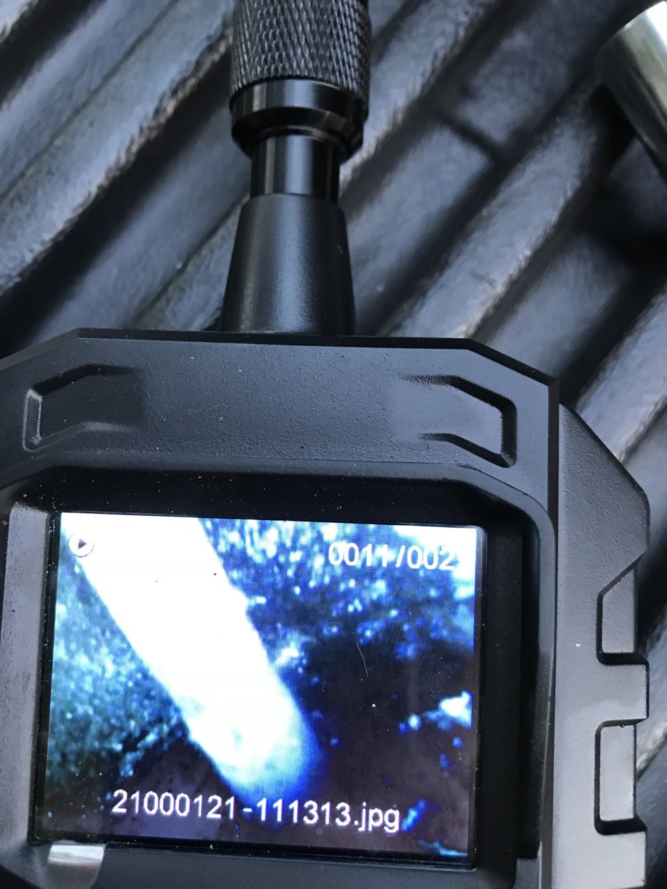

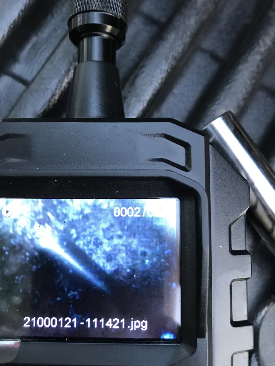

    Other than what I said all in know about the truck is it sat for a bit I’m not sure how long yet still working on that info. I borrowed a scope and took the intake off here are some pics of down inside the intake EB35668D-646A-4045-887C-7AAAF2A3FC70.jpgEB35668D-646A-4045-887C-7AAAF2A3FC70.jpg E2DCA78A-42FC-4A45-BD57-E691BDB2DCEE.jpg D3915D51-3D1E-4F8A-8F77-099403EA0F40.jpg 5FAA6CD9-602A-4268-BAFC-06EF64B02505.jpg E2DCA78A-42FC-4A45-BD57-E691BDB2DCEE.jpgD3915D51-3D1E-4F8A-8F77-099403EA0F40.jpg

    Pull a valve cover. Let's see what mysteries lay beneath.
