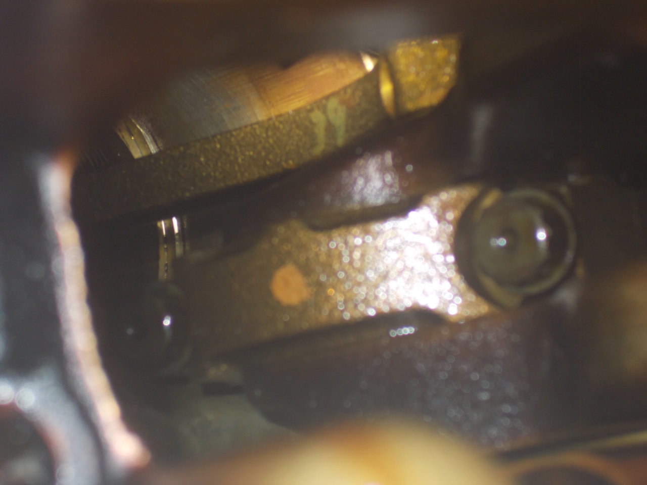

    DSCN0529.jpg Did you ever take the oil pan off and look for bent rods?
    Edit: I found the pics. But this pic looks wrong to me. It looks like a bent rod, but it is hard to tell. The part that has 39 on it, looks like it may be broken to on the end.

    Some
    I thought the same thing about that picture. Something just doesn't look right but its hard to tell.

    Did you clean the oil off, or was everything already that dry?

    yea man that part #39 looks bent and contacting counterweight.
    I've never seen an engine locked that tight w/o that being the case.
    I'm sure a significant enough amount of rust could do it but we just ain't seeing that.
    After pulling heads, you may be able to get by with just a rod.
