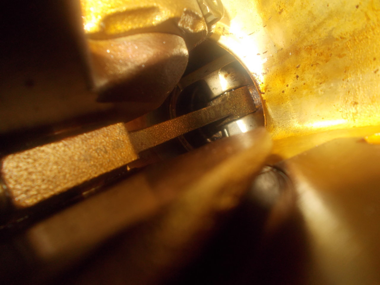

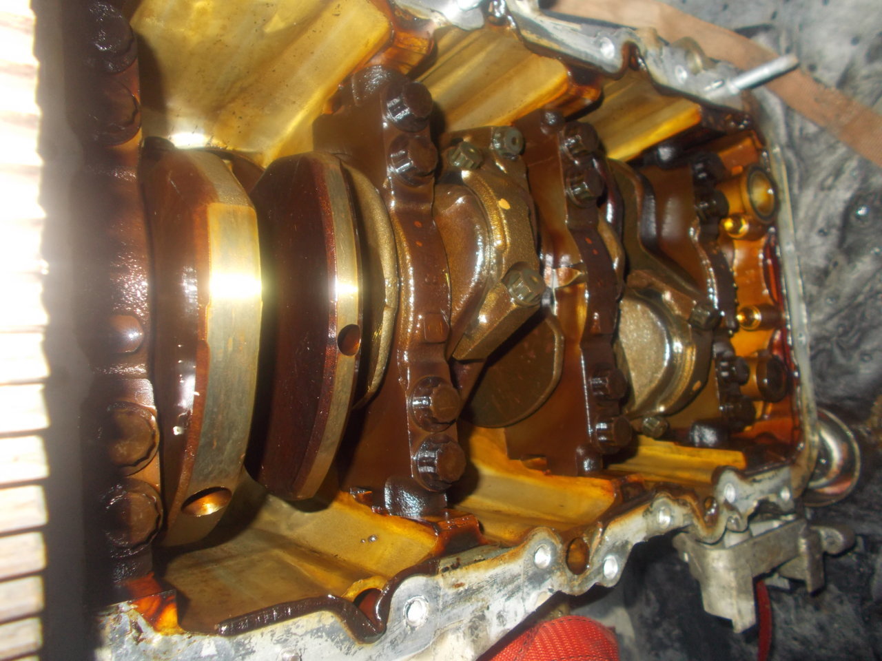

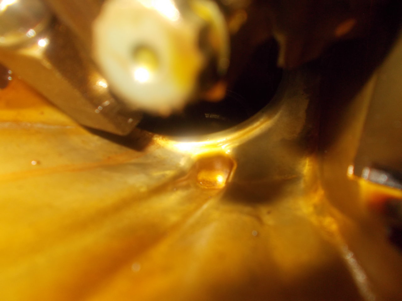

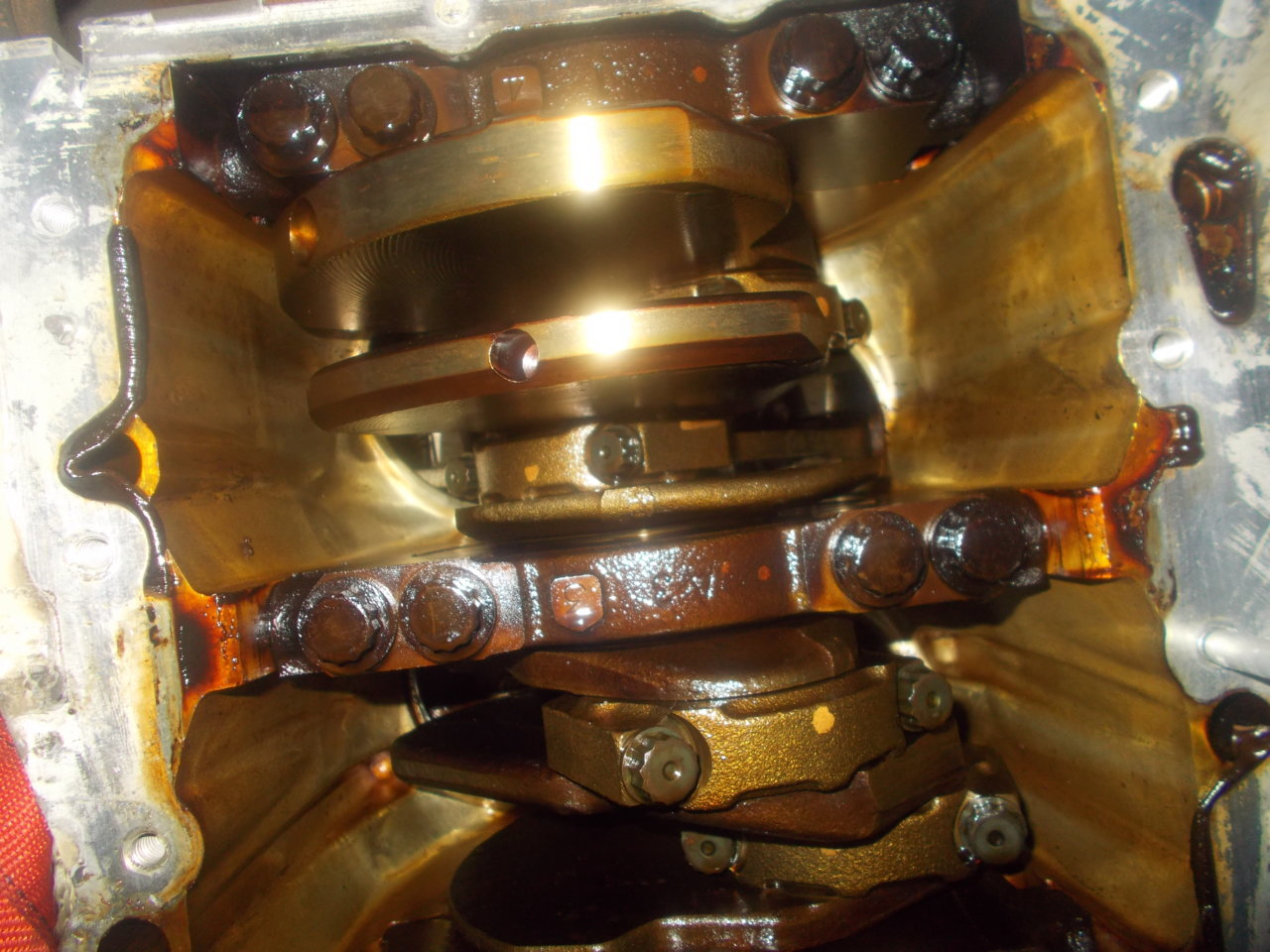

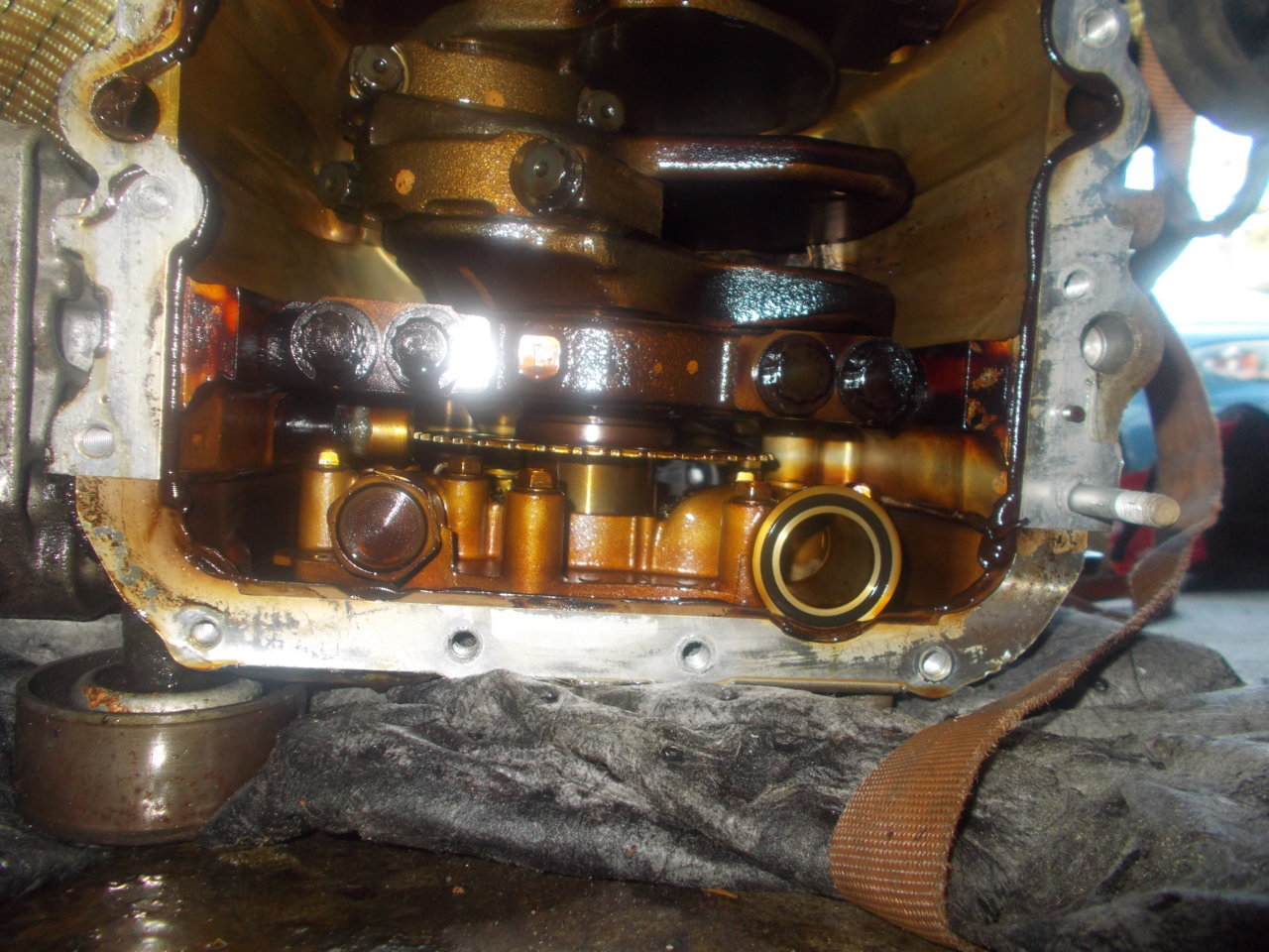

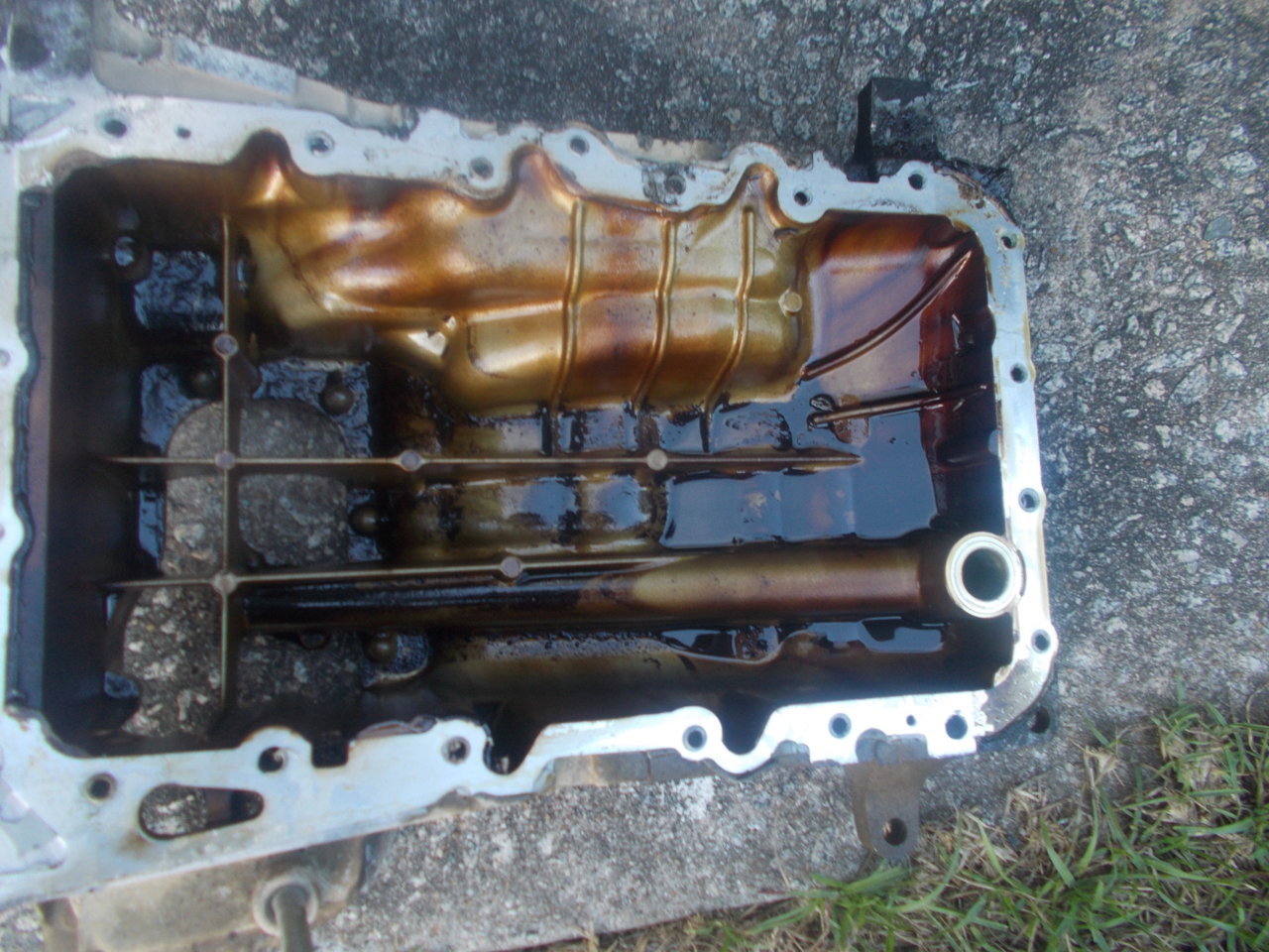

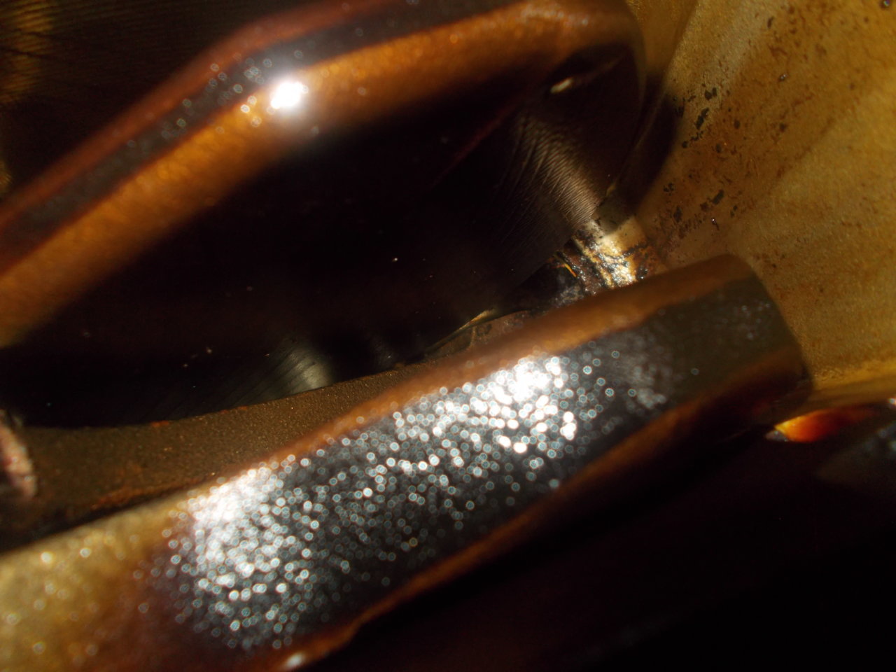

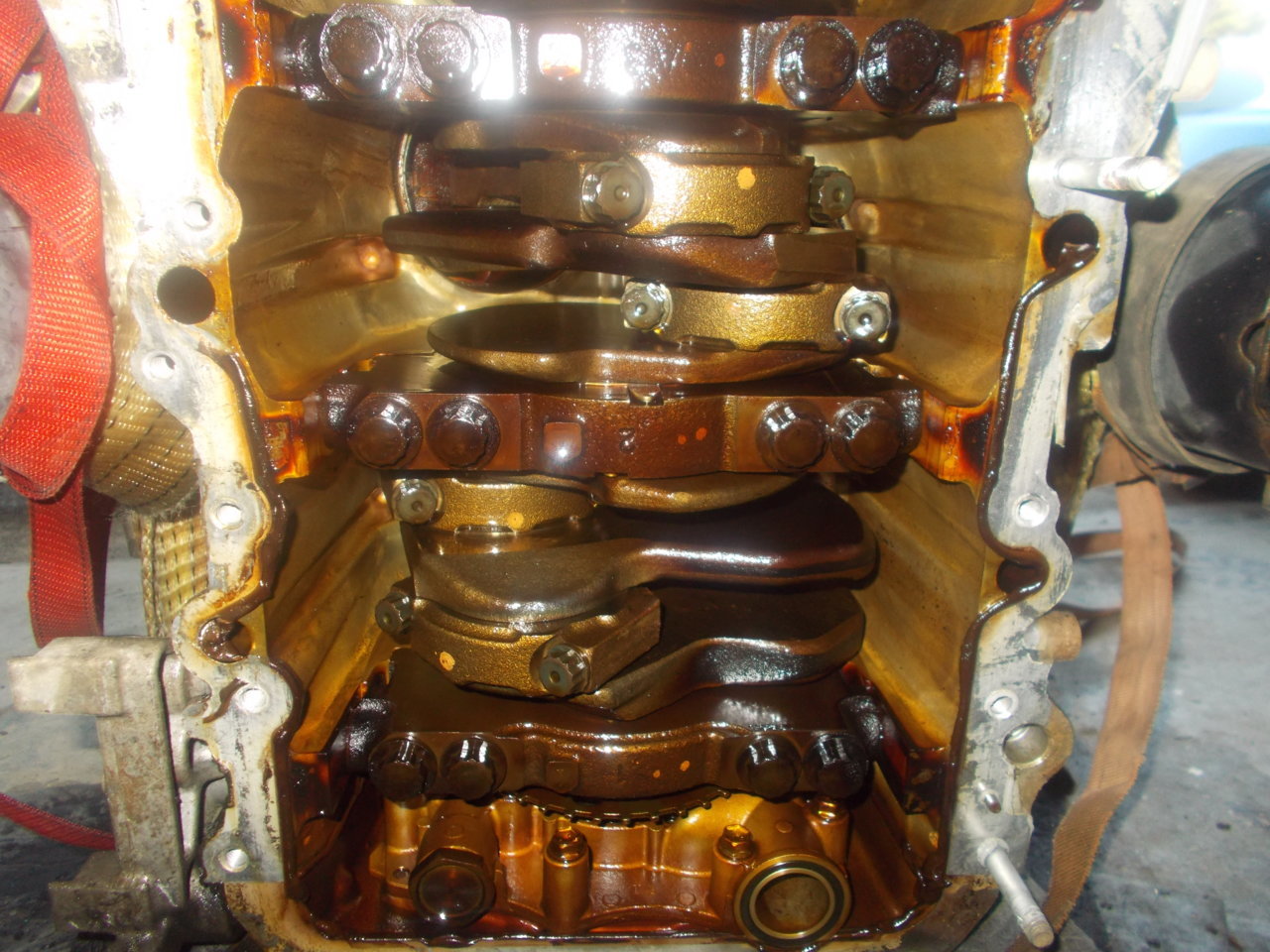

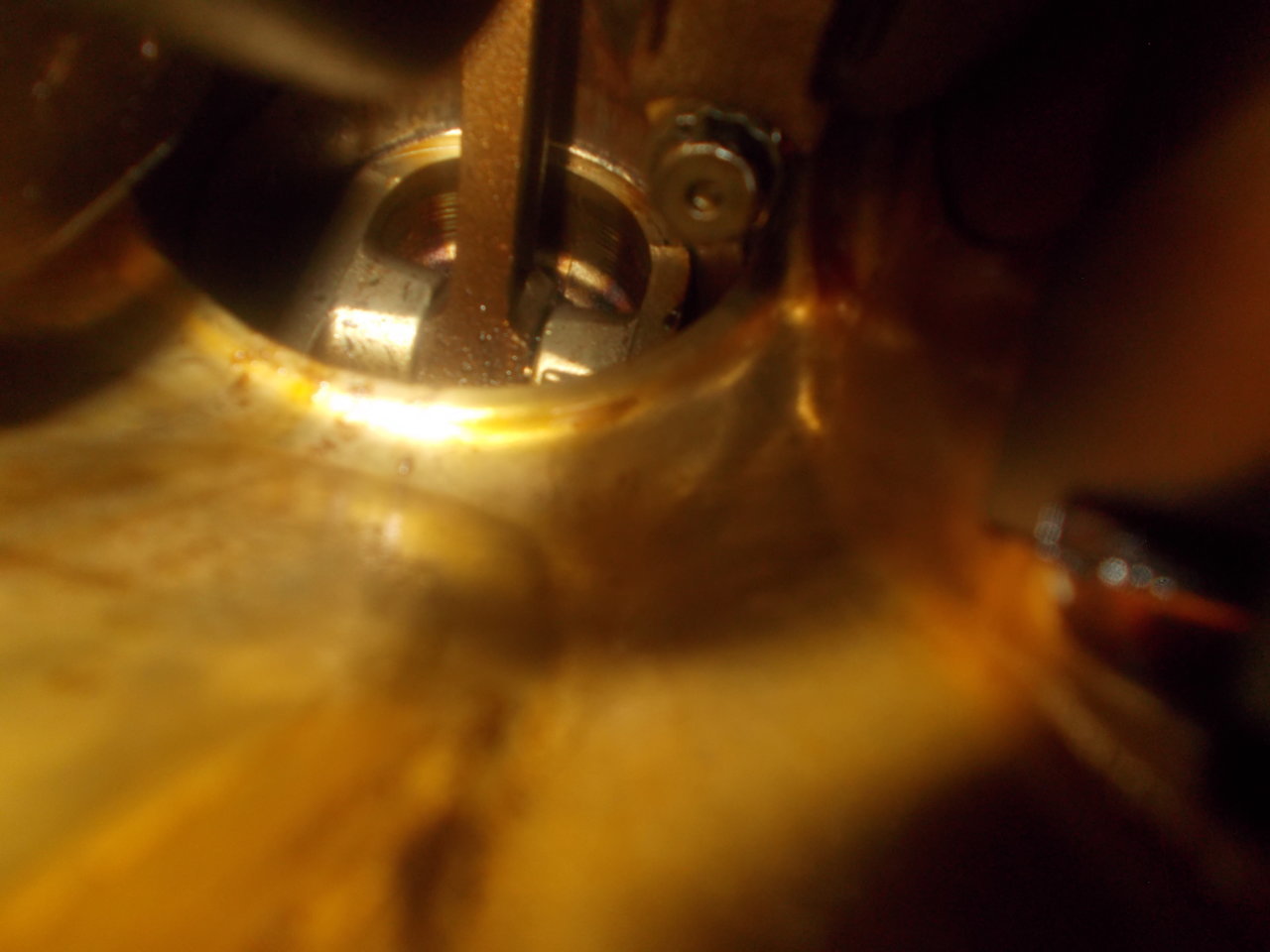

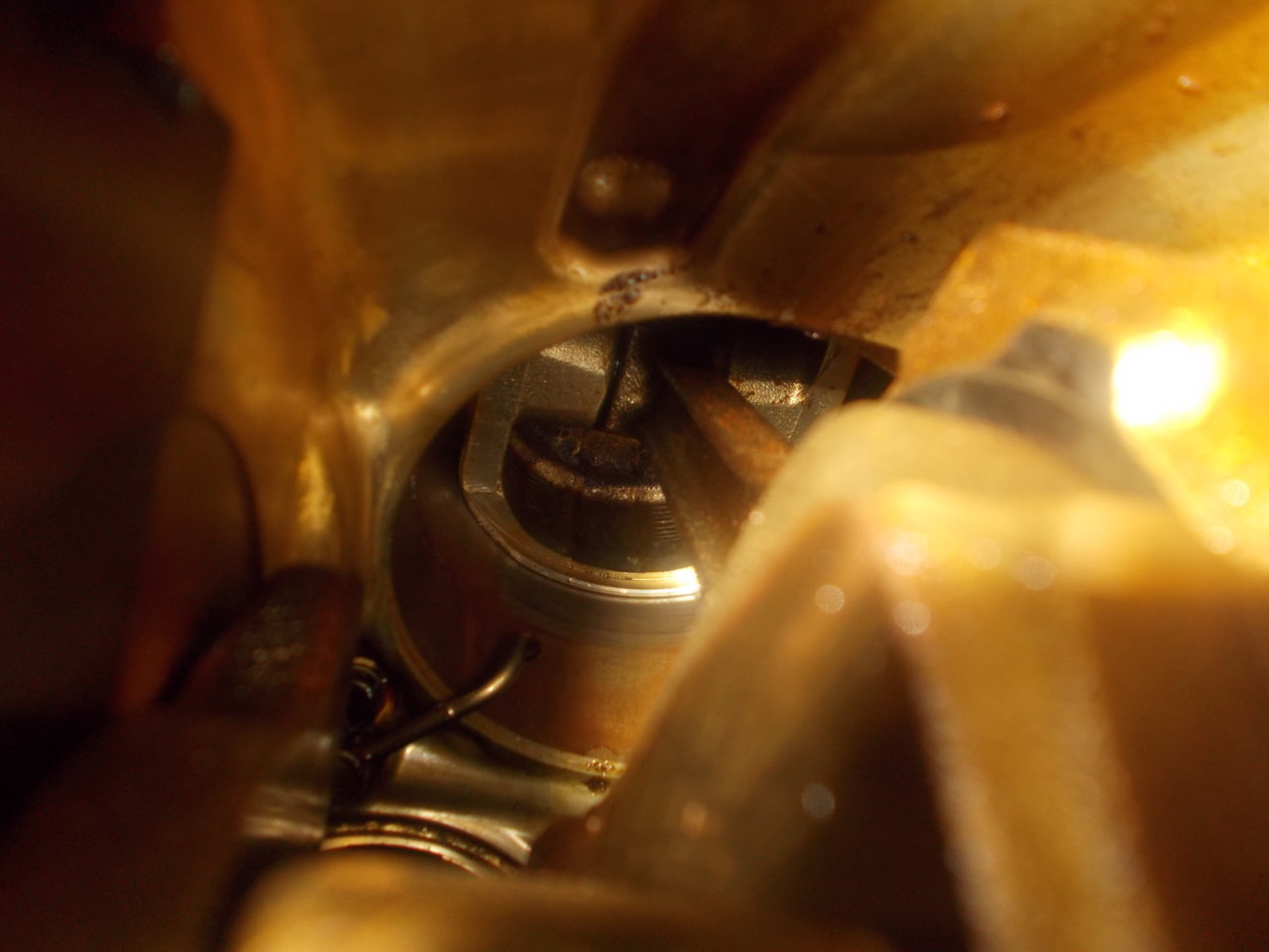

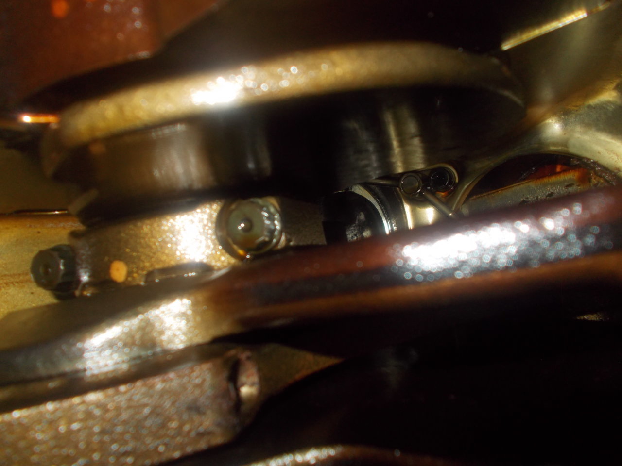

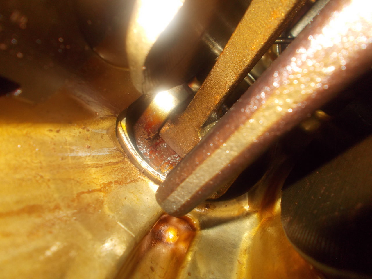

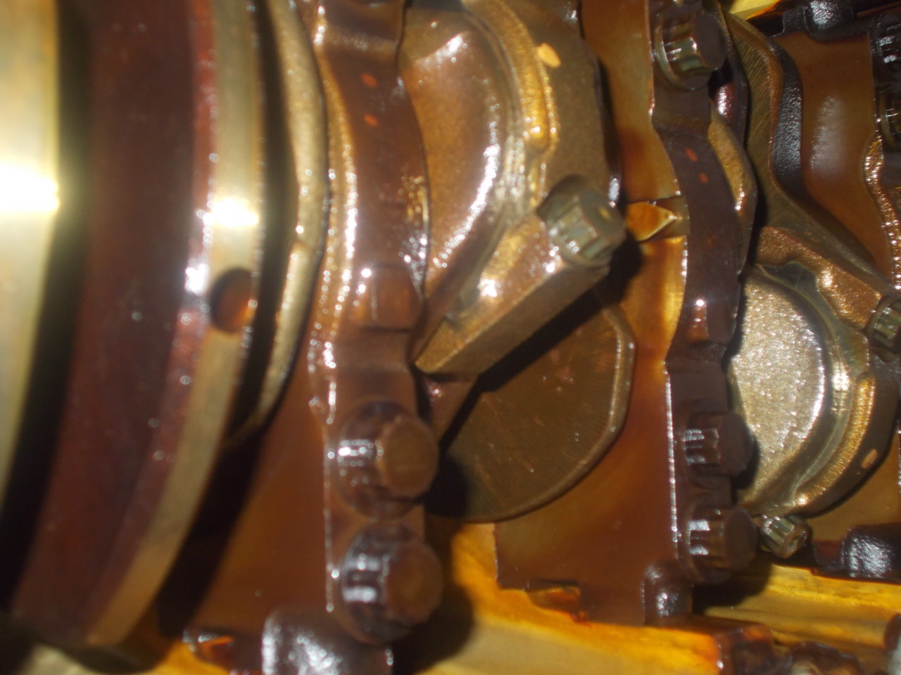

    A real nail bitter I take . I wish I had a 9-5 job mines more like 6am-6:30pm.any way...I get a kick out of all your guys comments its entertaining to read.

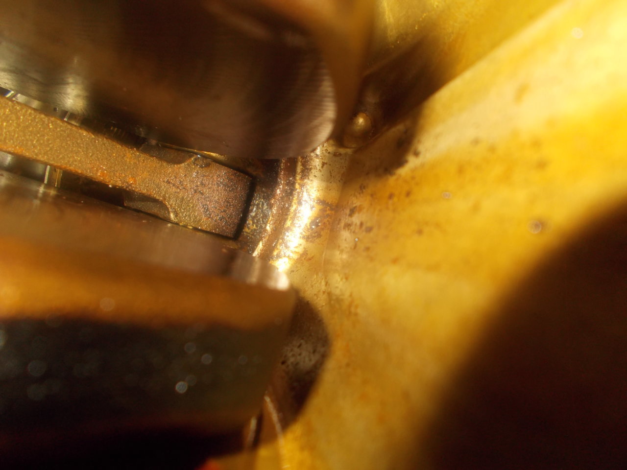

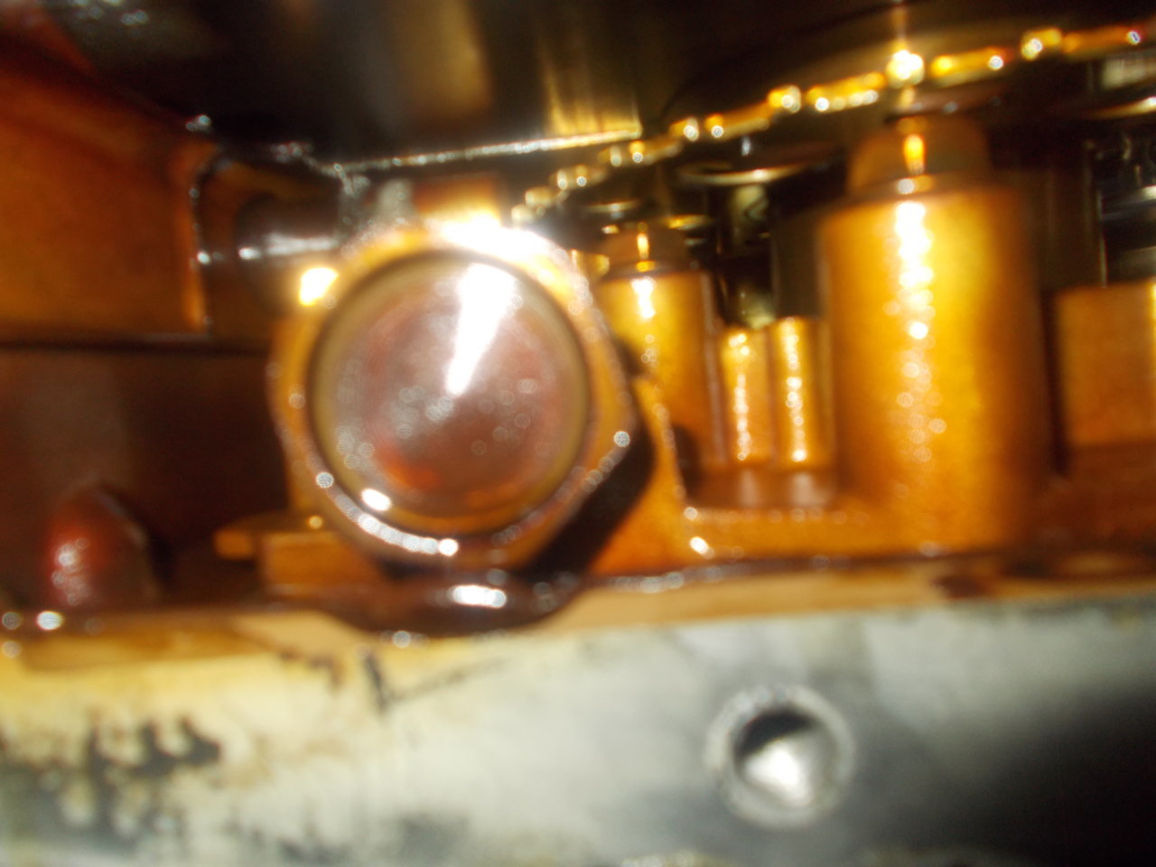

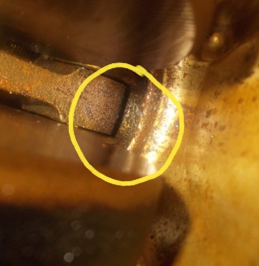

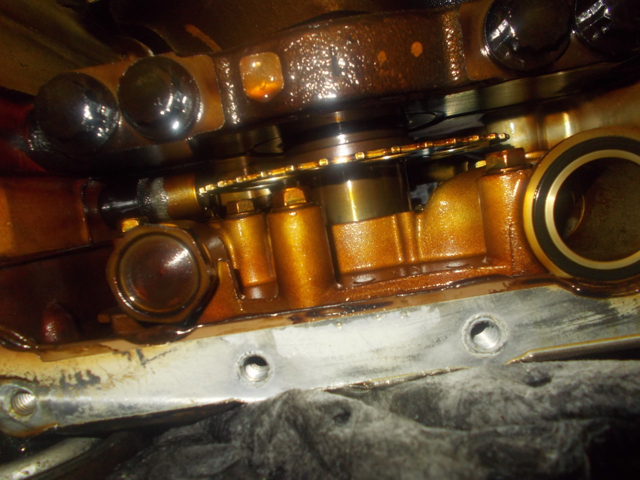

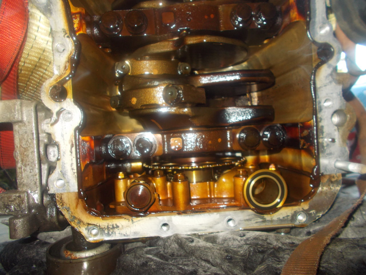

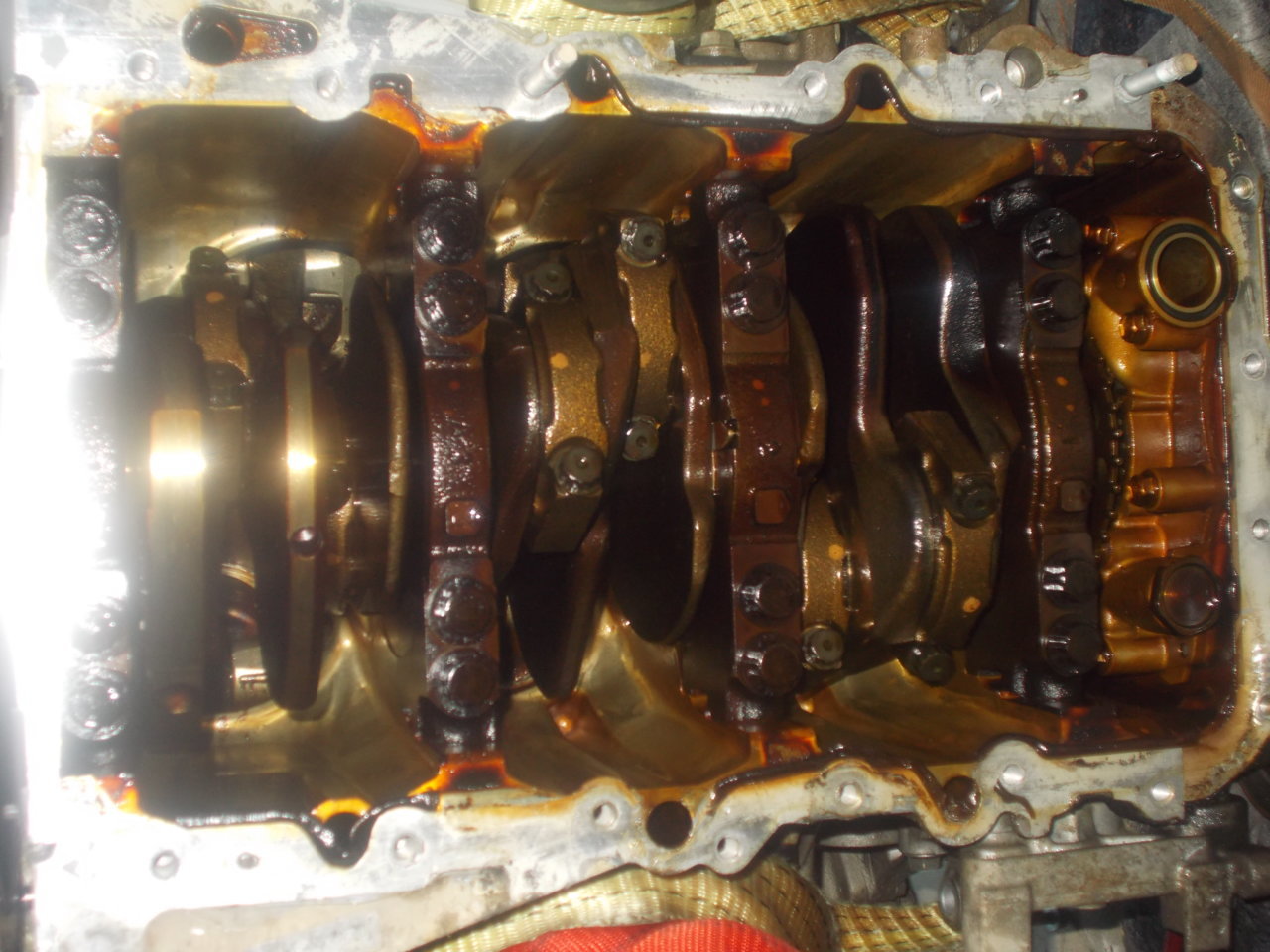

    Got the pan off again no metal in it and nothing looks majorly.Im thinking this maybe a good sign??
    here are some pics and you guys take a look
    DSCN0555.jpg DSCN0554.jpg DSCN0553.jpg DSCN0552.jpg DSCN0551.jpg DSCN0550.jpg DSCN0549.jpg DSCN0547.jpg DSCN0546.jpg DSCN0545.jpg DSCN0544.jpg DSCN0543.jpg DSCN0542.jpg DSCN0541.jpg DSCN0540.jpg DSCN0539.jpg DSCN0538.jpg DSCN0537.jpg

  14. May 22, 2018 at 5:19 PM
    #234
    rheath08
    rheath08 Well-Known Member
    Nov 16, 2016
    #202554
    1,774
    Russell
    Bakersfield, CA
    Frankenstein's Monster
    converted AWD, RC62f swap, Supercharged
    interesting. it looks like there is a lot of gritty sand like material all over the inside. i could be wrong.
    how did the oil pump and pick up tube look?

    They seem fine.

    Now time to pull heads or start pulling caps.
  18. May 22, 2018 at 6:06 PM
    #238
    desertrunner24
    desertrunner24 Well-Known Member
    Oct 30, 2016
    #201101
    3,954
    Jake
    Fresno , CA
    2011 TRD offroad 4x4
    Some
    DSCN0546.jpg could be an optical illusion but something doesn't look right to me in this picture. Looks like the rod is stuck against the block. DSCN0547.jpg this one looks like the piston is galded itself to the sleeve. Definitely something wrong there. Zoom in and look at the bottom of the piston skirt.

    You may be onto something. If you look close it looks like lightly scraped new metal showing on block. 20180522_181213.jpg
