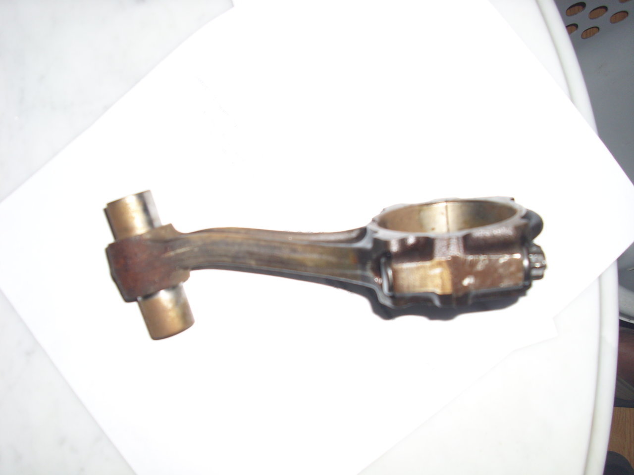

    I saw that but thought it was just imaging trick? But does look like squeezed out bearing??

    It might be an image trick. It could just be the counterweight. But it looks odd on my phone.

    I'm looking at it on a 22" screen. Looks like machining to me. laughs. On the downside, I still have to wear glasses to see anything on here.

    Was hoping you would find this. Hydrolocked.
    Yes, caps are easy to figure out which way is correct orientation, you will have to tap them with a small hammer to release the built in tension when removing.
    See those scratches by the nut? That was where it hit the block. The only thing keeping it from turning over.

    I see what your talkin about. Phone is blurry when I try to zoom in, but it looks like a bearing to me.

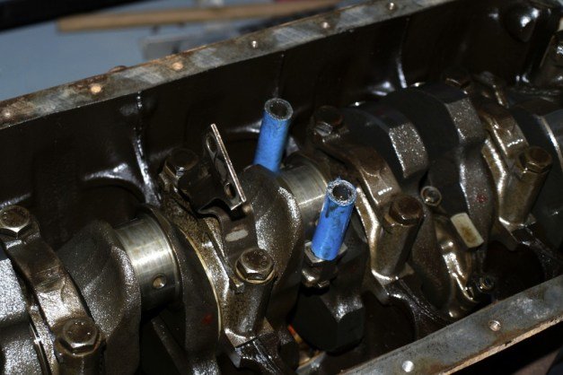

    If/When you pull the caps, as said before, note the order they came off and orientation. I always lay them on a clean part of the bench out of the way and don't mix them up. At this point I like to cover them with a rag so friends or the kids don't come by and pick them up to look at them. Then I put some hose over the bolts and tap them with a rubber hammer to move the pistons away from the crank. The bearing material is very soft and it is very important to make sure that they don't get marked up. They also need to be kept as clean as possible. If the bearings can come out easily, I also take them out( making sure to note the orientation and order.)
    Or if you are just in rip and tear mode, go hard. Bearings, pistons, rods, wrist pins, are not all that much money, most rebuild shops would be able to get you parts very easily.

    Thst from hydro? Go through cylinder wall for that kind of bend?
