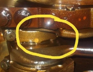

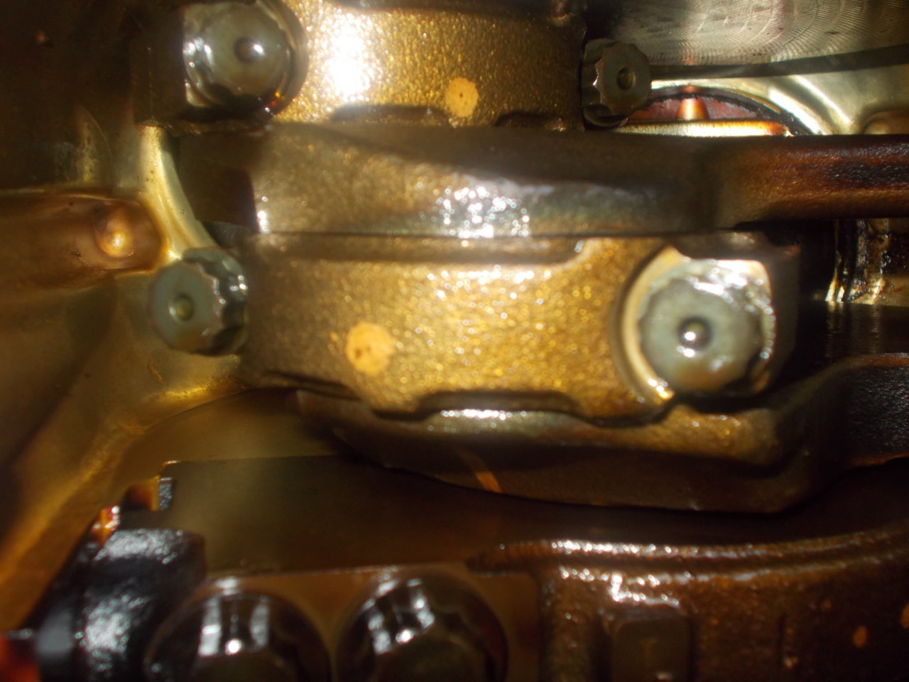

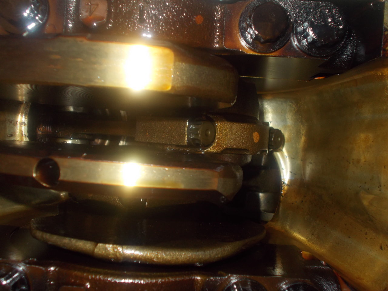

    nope, engine was fine. Does this look right?

    Hard to tell since the crank has so many uneven casting edges thoughout. I was also looking for signs of broken crank.

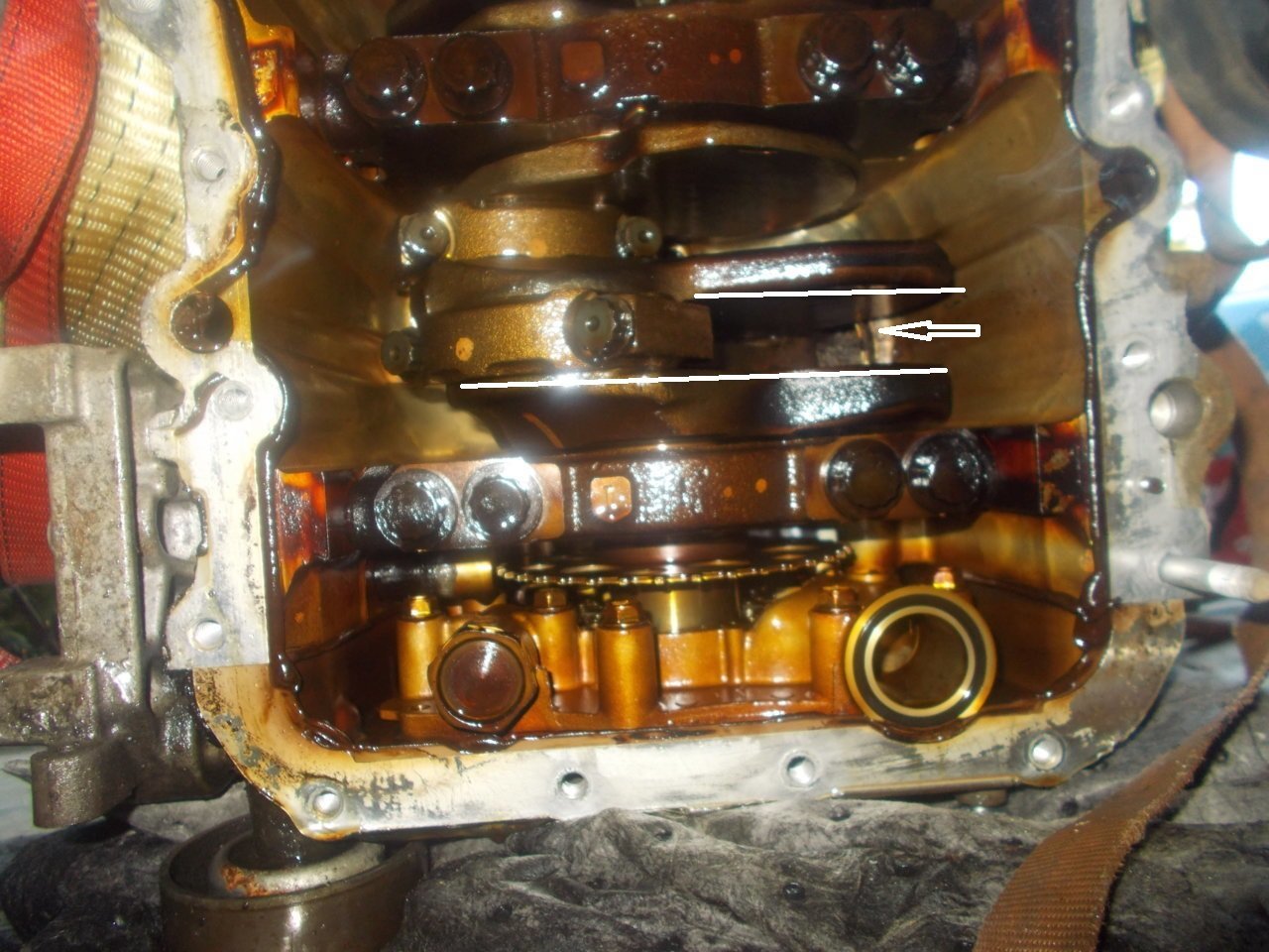

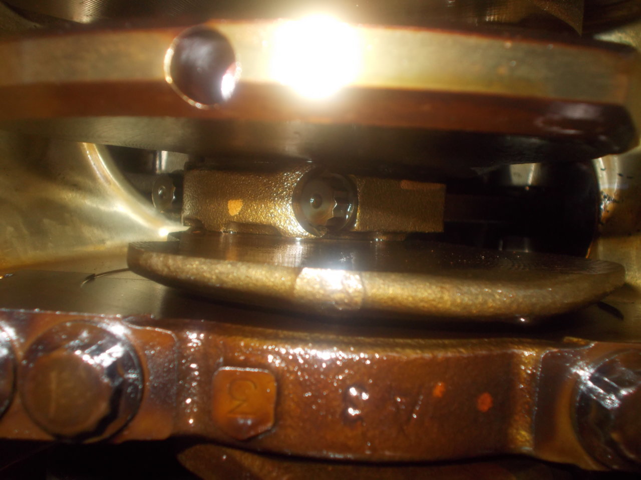

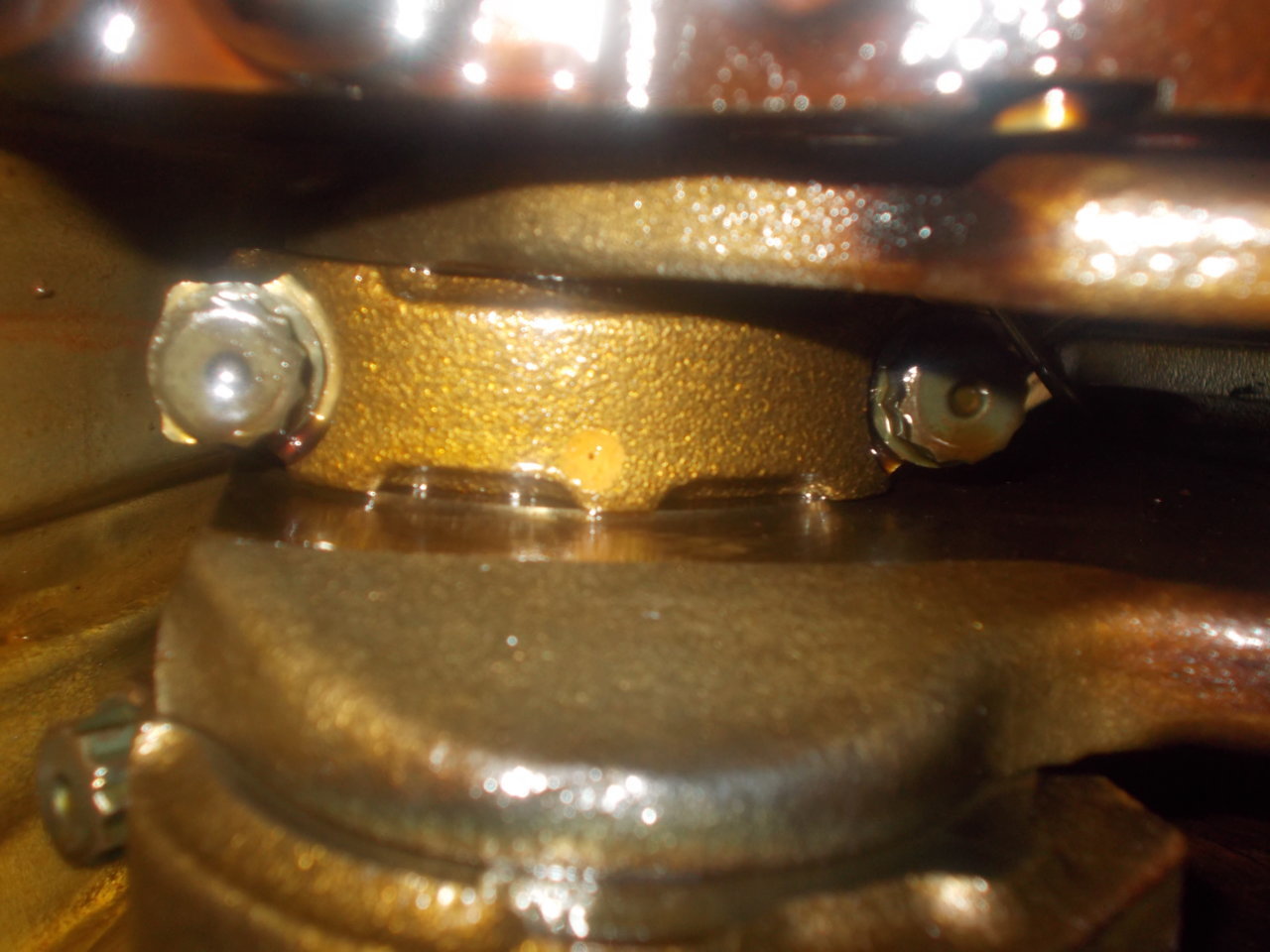

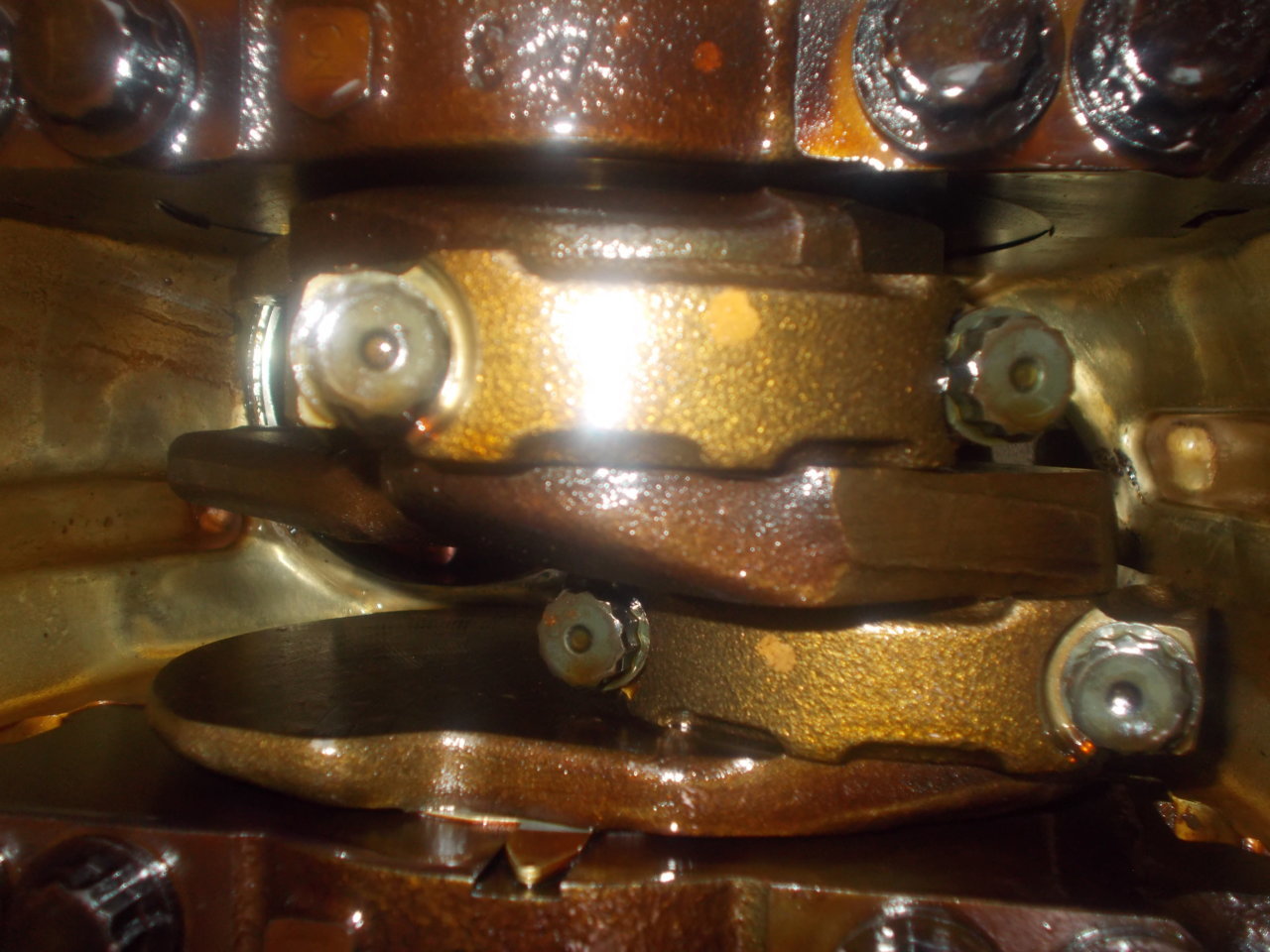

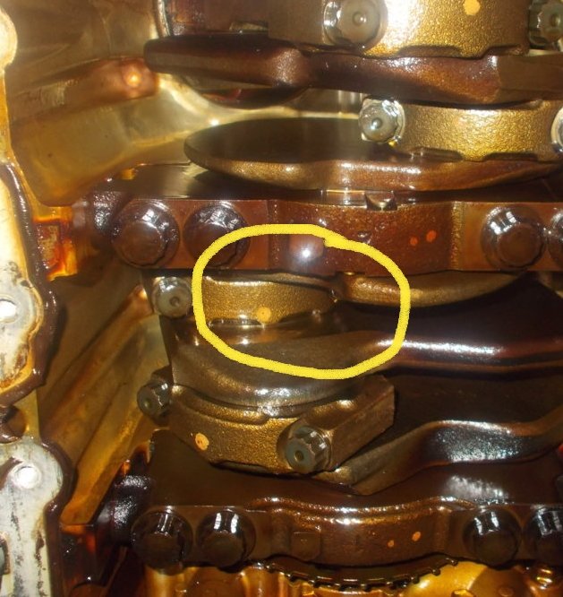

    Well I'm about to call it a night but wish I knew what this is. Another member noticed it too. And is the piston hitting the crank weight??

    I personally would pull the heads next they are going to have to come off no matter what the repair is at this point.

    From another pic posted, looks like it was just an optimal delusion. What I saw was just the edge of the web.

    Still looks off but who knows? Looks like its almost against main cap instead of between the weights :notsure:

    Dah, I should have noticed that. Same area, diff angle.

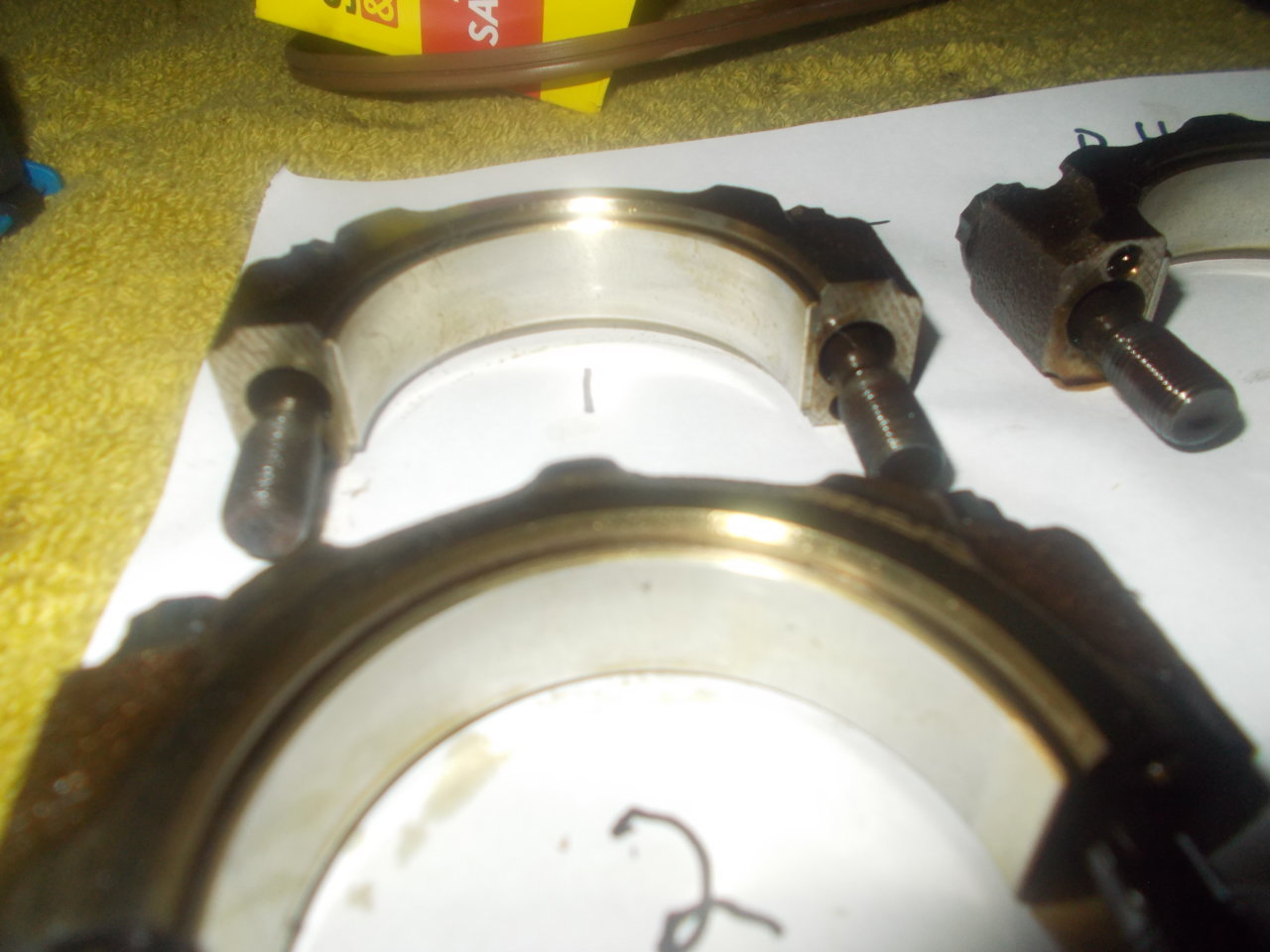

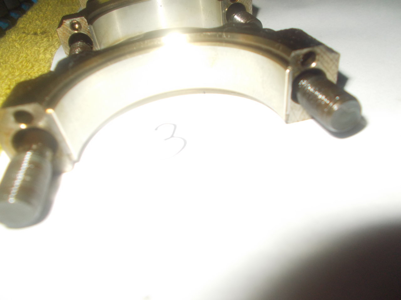

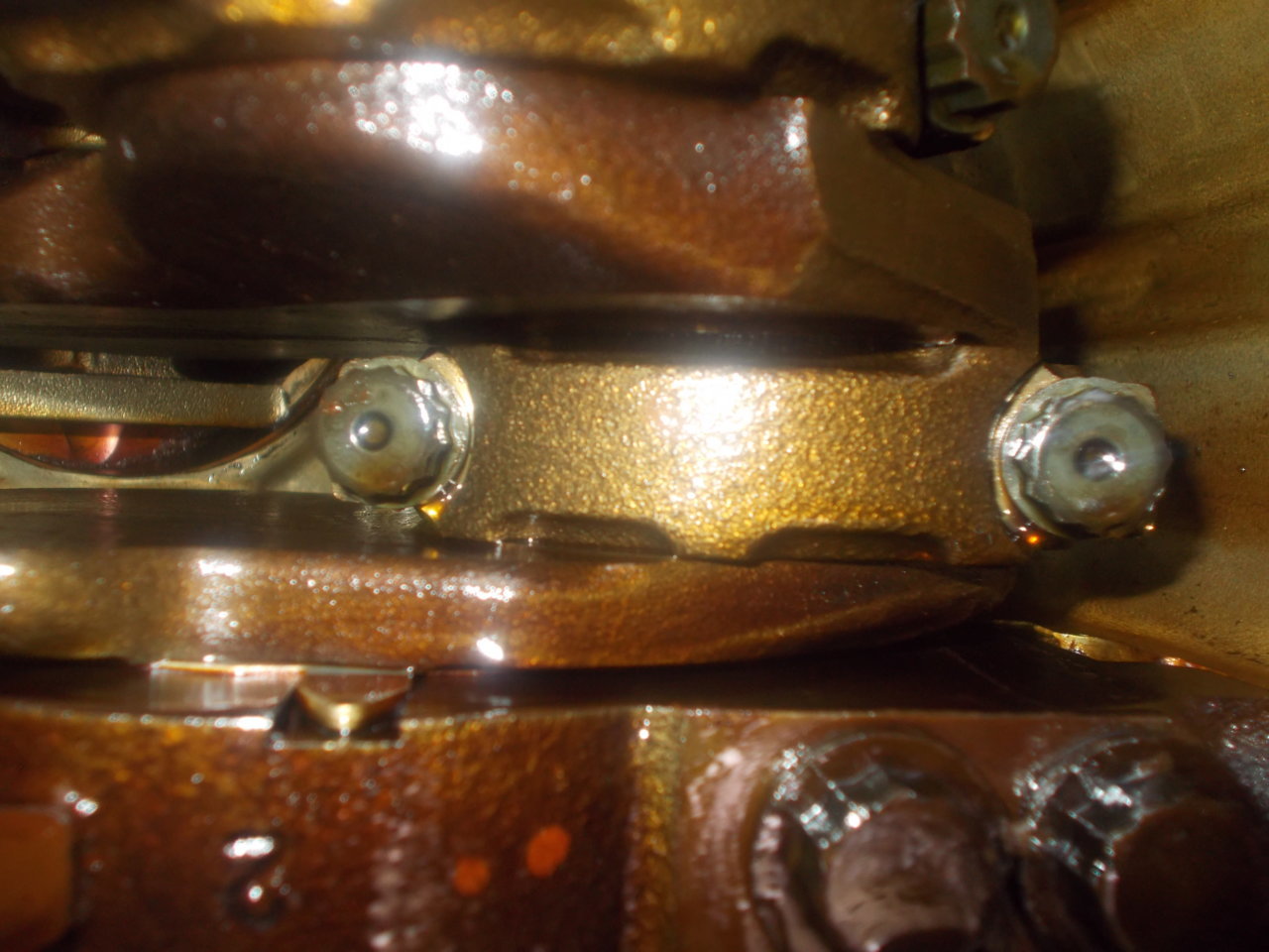

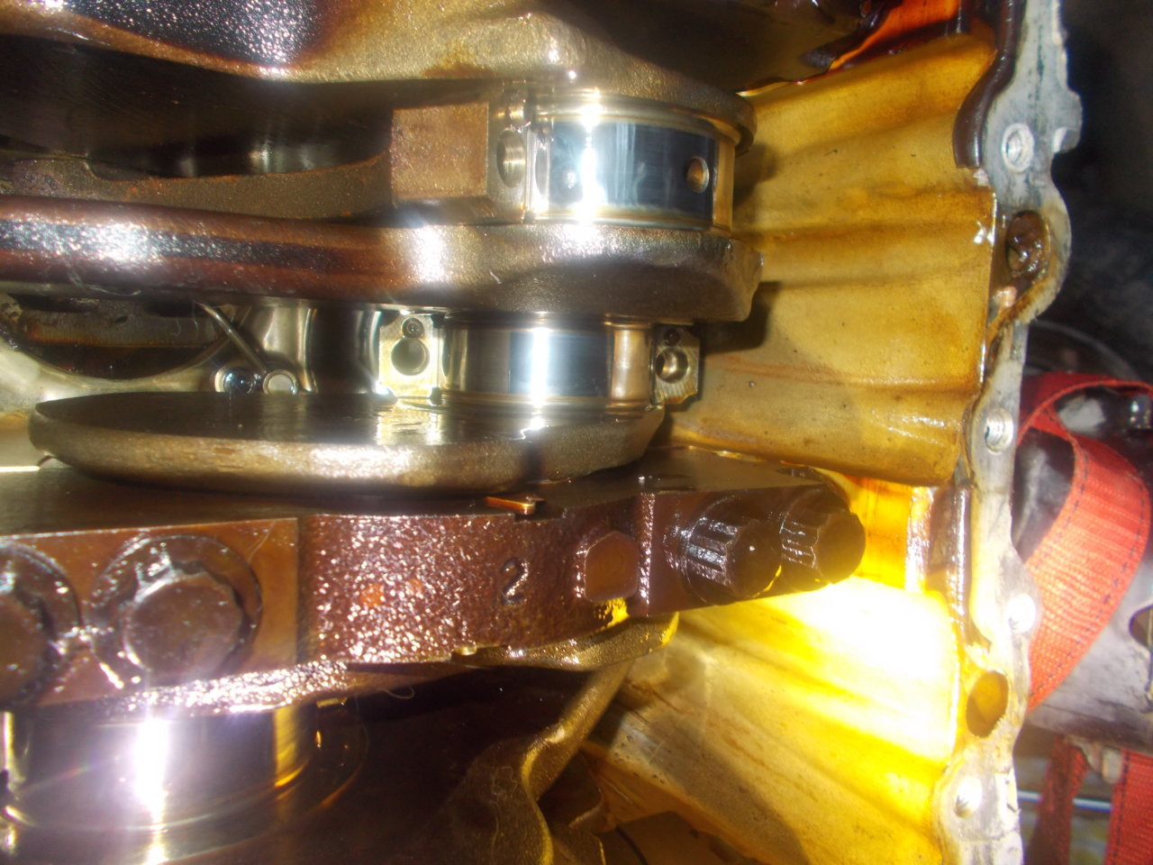

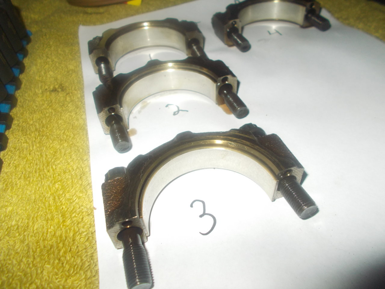

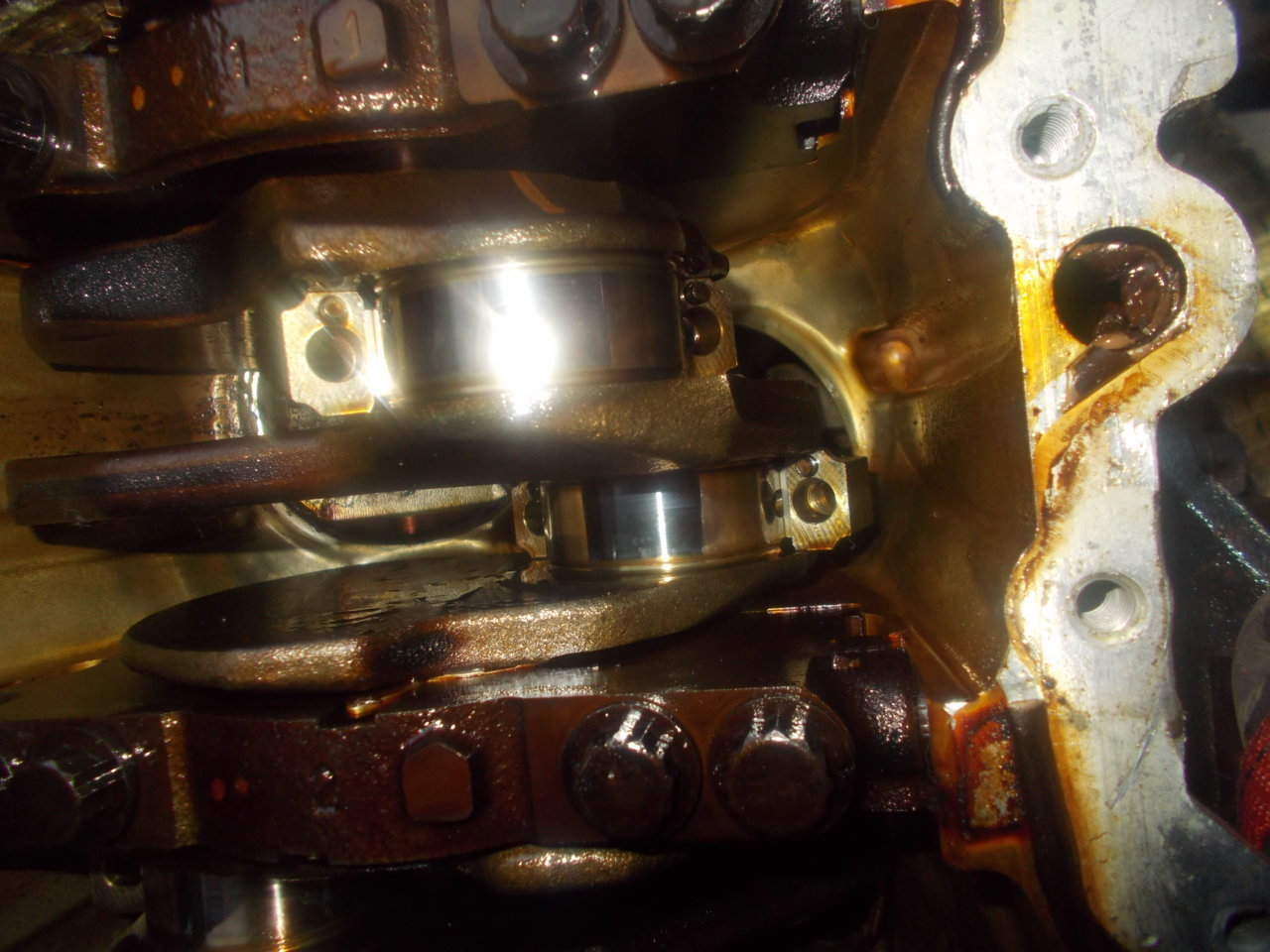

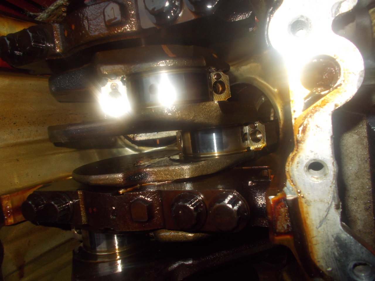

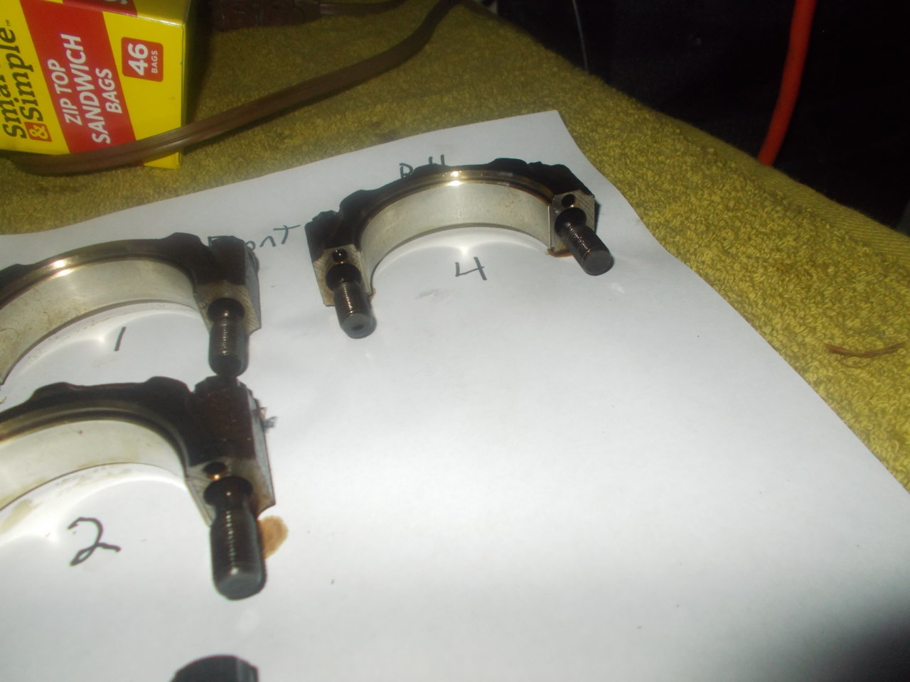

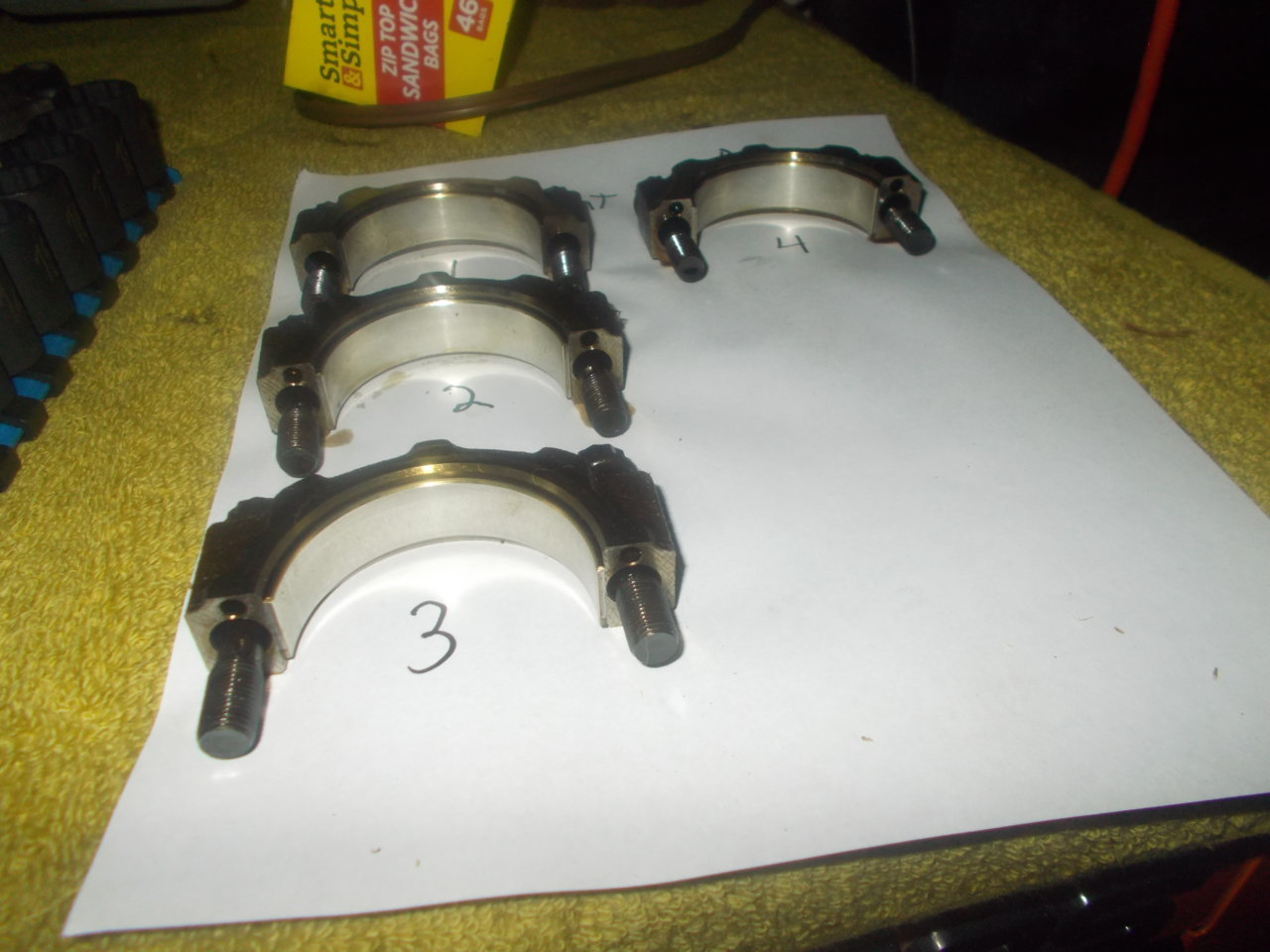

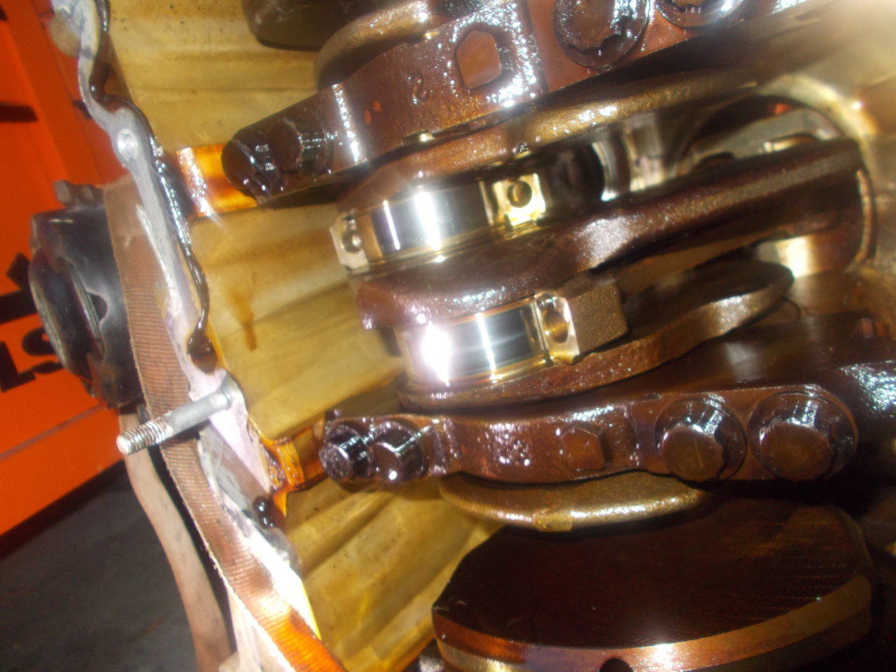

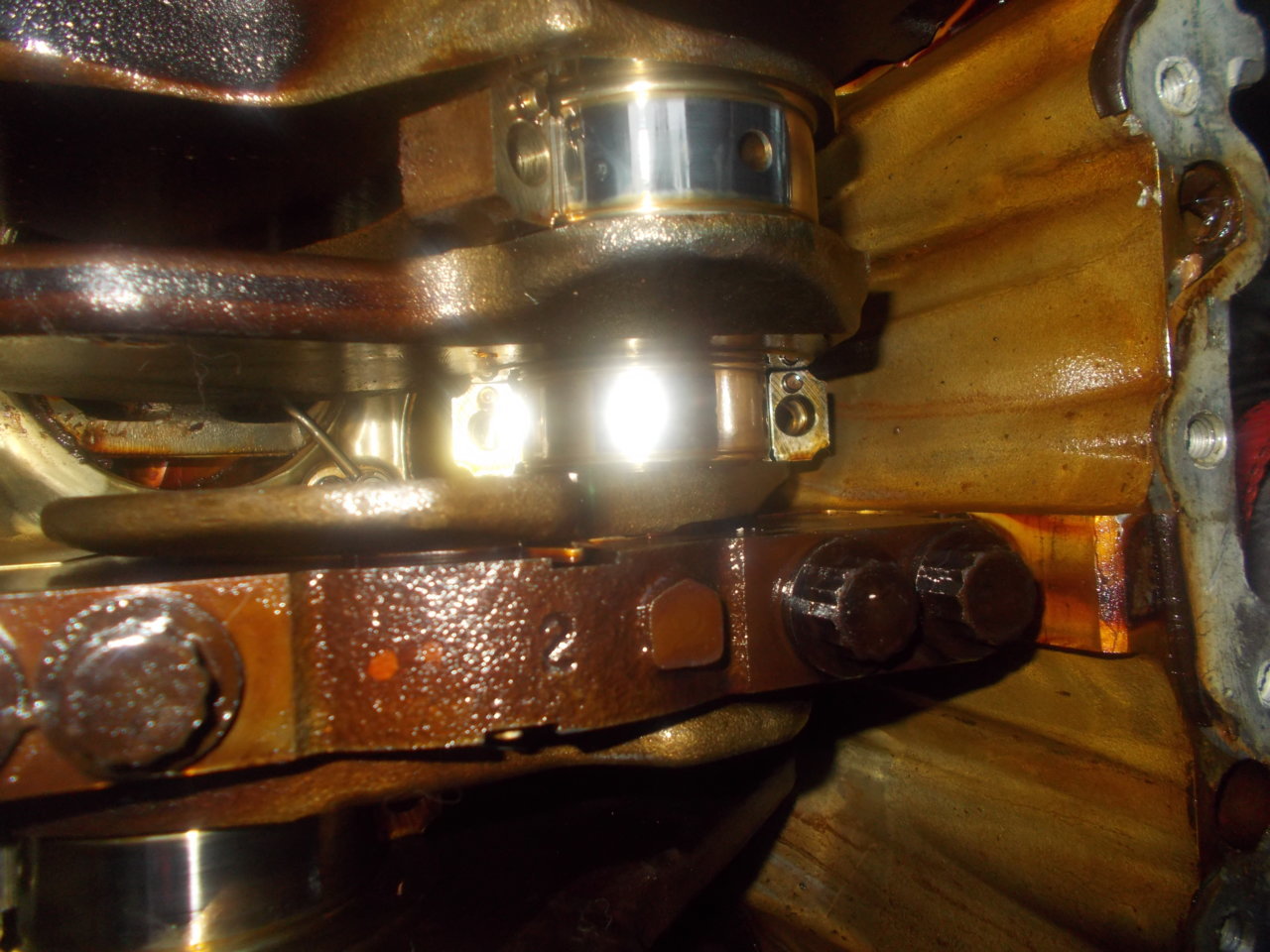

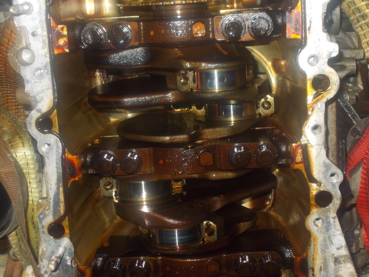

    i got some caps off 5&6 are a bit harder.i didn't tap on the pistons to see if the move.two reasons one what should I put on the piston to hit them with?two I want to pull the heads befor they go up to see what they may have to go through.what size allen head is that to do that?here are more pics of where we are at now.lets see if you guys see anything yet.my caps have guide pins so they will only go one way.is that normal?DSCN0557.jpg DSCN0558.jpg DSCN0559.jpg DSCN0560.jpg DSCN0561.jpg DSCN0562.jpg DSCN0563.jpg DSCN0564.jpg DSCN0565.jpg DSCN0566.jpg DSCN0567.jpg DSCN0568.jpg DSCN0569.jpg DSCN0570.jpg DSCN0571.jpg DSCN0572.jpg DSCN0573.jpg

    This motor is mint i am so excited to see what caused the lock up.

    Will the crank try to turn at ALL yet just a little and then turn it right back? Everything looks good so far.

    not yet but all the rods are still sitting on top of the crank

    Yes, when they are all off, see if the crank is out of it's bind. If it is free, then put that back together snug. No need to push yourself too hard tonight. Unless you come across something bent, that bottom looks great. Bearings also.
    You're about to get an answer or back at square one on what it is.
    I use a broom stick to push pistons.
