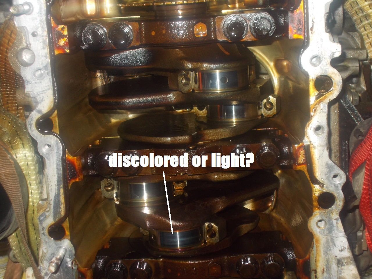

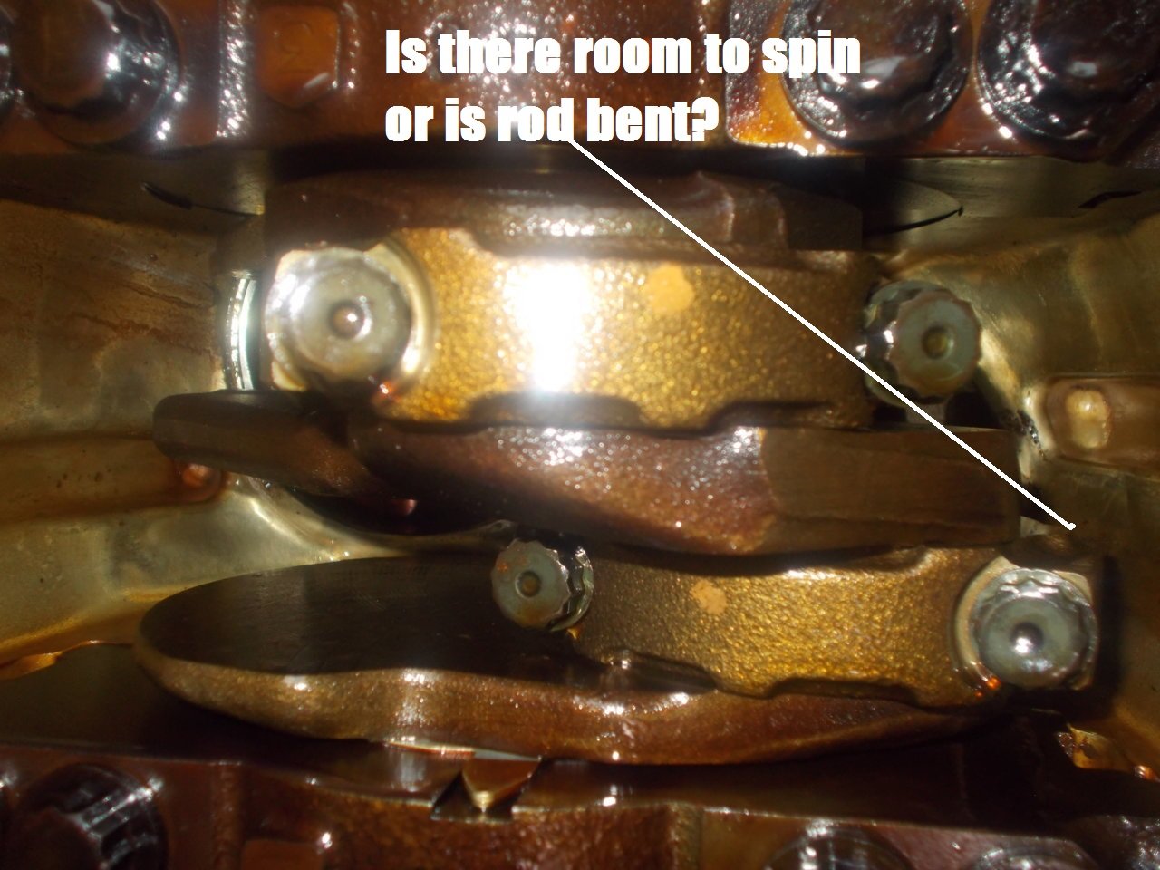

    Agreed, if it's a single piston that's binding you should be able to move the crank one way or the other. Can you see enough to check if all the connecting rods look straight. I can see some in the photos but not all.

    they all look good

    Do you have all the caps off yet? When you do try to turn. If not see if you can light push the pistons to move at all. Not much. Just a little.

    Some engines do, others rely on different methods. It makes it easy. I'm surprised at the rods not having studs. I guess because of low revving engine? Most higher strung ones have nuts on the outside where you're working.
    And then those beefy mains....surprising is all.
    Oh, unfortunately, those bolts are torque to yield...crap.
    If the pistons move easily, you might not have to pull heads.

    Is #1 rod journal blueish?
    That would mean it got hot.
    We also haven't seen anything of #3's rod.
    It could be a pretzel.

    He can look at the valves up top and see if any are stuck down, the cams are out....I think.
    Nick does #3 rod have that #39 painted on it?
    Going back to early pics, that thing sure looked bent.

    i will get that pic for you tomorrow to dark here now.you guys think rod three is bent?
