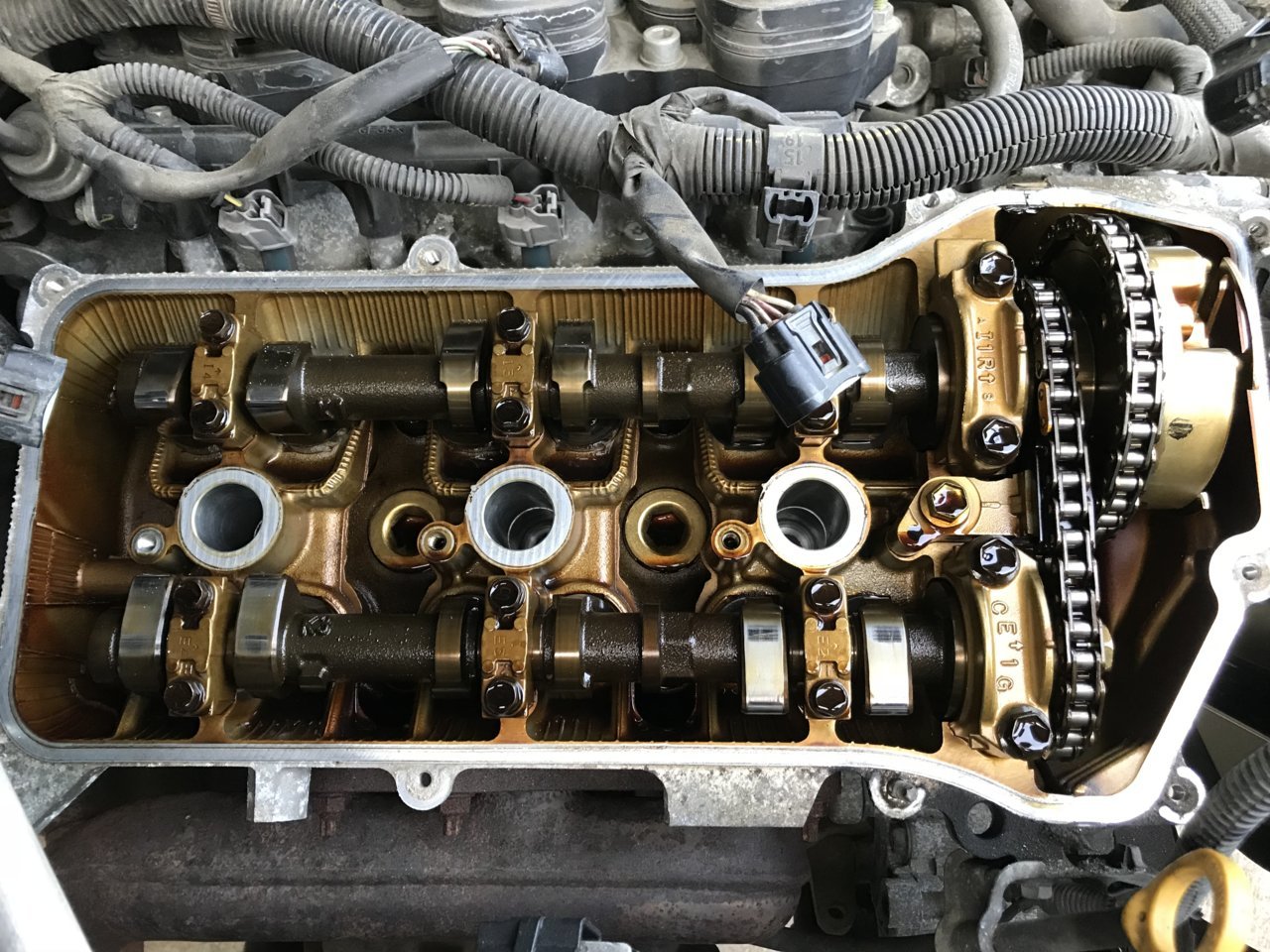

    It actually looks pretty good.
    Moonshine oil makes me wonder if fuel was in it, not water.
    These things are hard to get water in just sitting and i have no idea if your near an ocean.
    I wonder if a timing component is jammed?
    I wouldn't just go bumpstarting it just yet.

    That looks really clean on the top end.

    Look at the bores. You have a camera.
    If that's clean the problem is up front or in back.
    Edit: You still haven't given a location (beach town?) and what condition the engine was in when you got it.
    Were the plugs pulled? Manifold off?
    It's hard for an engine to seize from just sitting. (Unless it had been flooded) so I'm betting the engine's fine and something ancillary is binding up.

    When you changed the starter, what did it look like? Inside the flywheel area of the engine and the starter itself. Anything rusty looking?)
    A previous poster mentioned looking at the trans. fluid. You could or just drain enough to see if there's water in there. (flood question still)
    That engine just looks too clean to say it's junked.
    back to the oil smell, do you think it may have been gassy? Was it above normal level? Fuel will hydrolock an engine and bend a rod. Are you SURE when you looked from the bottom, all the rods were straight?
    edit: I did pull apart a Camry engine once that had ran into a ditch full of water, hydrolocking it, it looked as clean as yours but had a bent rod and a broken one also. Actually changing those two out made a great engine once again (but the heads had to come off)

    this is what I got.I do collision work that's why the body is no big deal.one of my old writers was leaving tow moving away.it was his kids truck.I sat on it till it had to leave the property.so i gave him $800 for the truck.younger kid didn't know that much about stuff.he thought it was the fuel pump then maybe the starter.I towed it to my place in neutral. turned it over starter was shot.put a new starter in it turns but wont turn the motor.as for stuff being of the truck i will say no it was all on when i got it and when i took it apart you can tell the bolts haven't been touched.as for flooded i don't think so it was back in on a up hill drive way.they live about 10 mins from me and we haven't gotten any floods that would be that high at there place.I live in summerville SC about 35 min to the coast
    The oil smell didn't smell gassy.I took it to work my helper said it smelled like moonshine.as for me I that it smelled like southern comfort .he smells like hard liqueur.the old starter look fine it was all inside it.the flywheel i can see some rust in the hole I kinda think that might be the problem. from the bottom of the oil pan i could only see the rods they looked good didn't look bent and where not broken. the old owner said it ran like a champ.
    yes its in neutral

    Put an ounce of Kroil [Eds Red will evaporate all the acetone out of the mix used like this] in each cylinder and let it sit a couple of days. If that doesn't free the pistons up then you have a true mechanical failure.

    Have you, with the breaker bar, moved it back and forth, CW and CCW and still get absolutely no movement? Even a seized engine will eventually give a fraction of a turn. If not, I'd watch everything as someone else put pressure, timing chain, crank from underneath. Watch for wherever the force is getting stopped.

    Put a little auto trans fluid in each cylinder via the spark lug hole and let it sit overnight. I used to do this for seized motors all the time, it'll free it up. It'll smoke like he'll, but it works.

    yes like alcohol.the oil smelled like that right out of the pan before i put any thing in the block.the starter turns then locks up like it cant turn the motor.i have tried both cw and ccw with the top end off no plugs no oil pan and the crank still wont move.

    Well, the oil smell is a quandary. I'm assuming it didn't look strange and wasn't over the fill mark?
    The transmission has to be working if you pulled it home. If the clutch were seized you could still start it in neutral so don't worry about rusty looking in there. Pretty normal anyway for some.
    I dunno, man. I've never seen one not get ANY movement whatsoever after some oil in there.
    And the bores from underneath that you can see are all clean and shiny?
    If it's rusted up above the pistons it would be below them also.
    If you're pulling it back and forth from your house to work, I don't think I could have resisted NOT trying to bump start it, laughs.
    edit: How about a pic from underneath tomorrow.
    edit 2: I see you have 2 pics of the same head, have you pulled the other valve cover?
