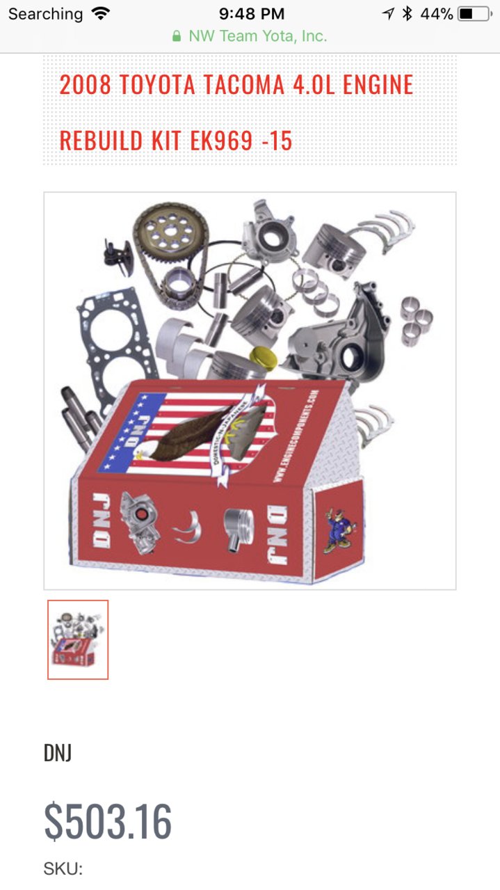

    500 for the rebuild kit, maybe a little cheaper at a shop, maybe a few bucks more. Probably another 500ish for them to clean, test, deck the heads and install. After that you will have an almost brand new engine, good for another 100 thou.

    You don't know yet if you need pistons. I doubt those are of great quality. A good set of pistons cost more than that.
