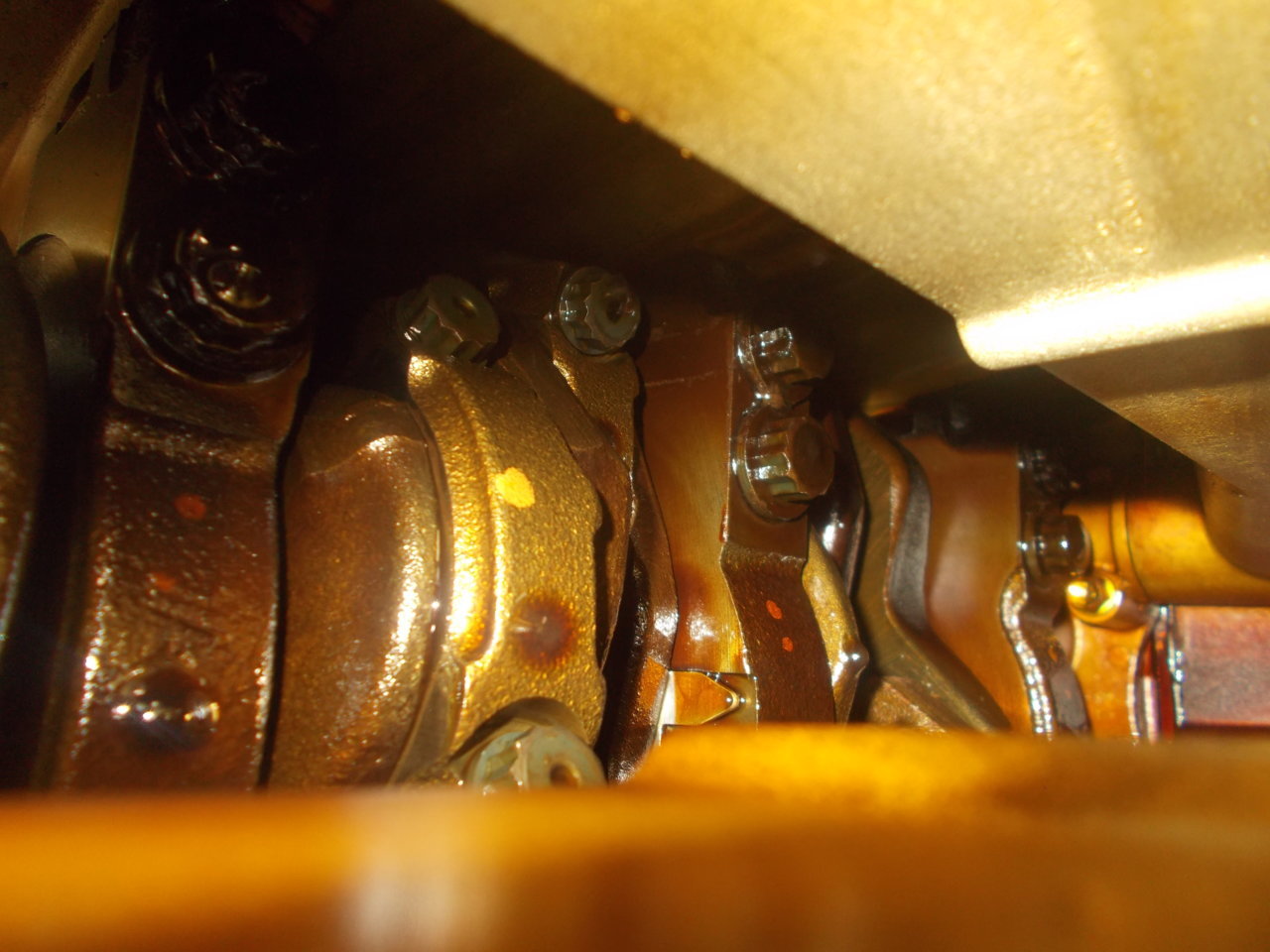

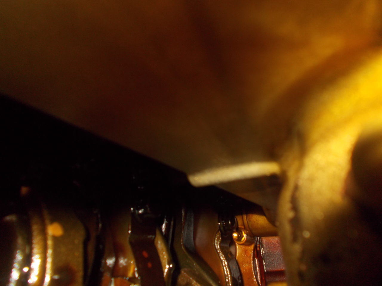

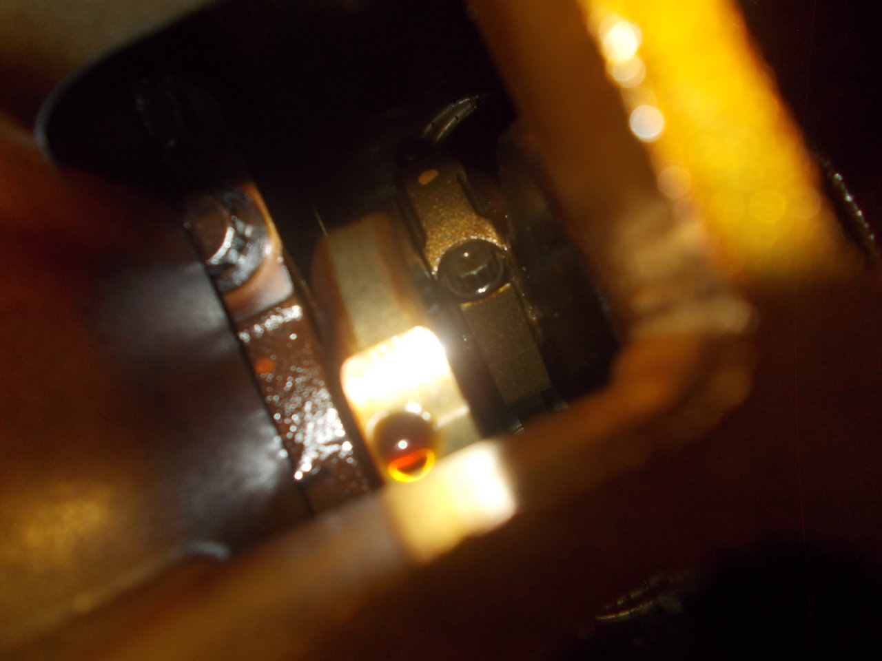

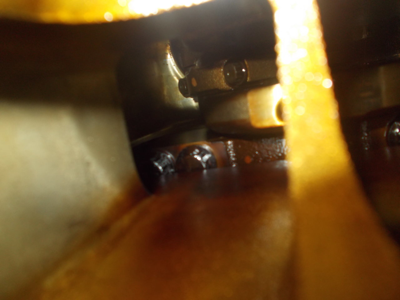

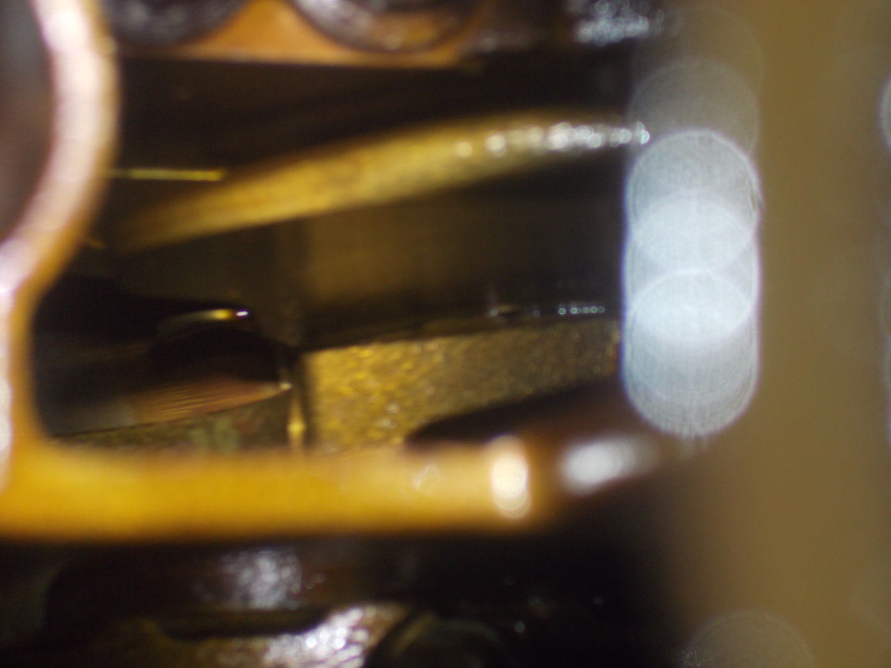

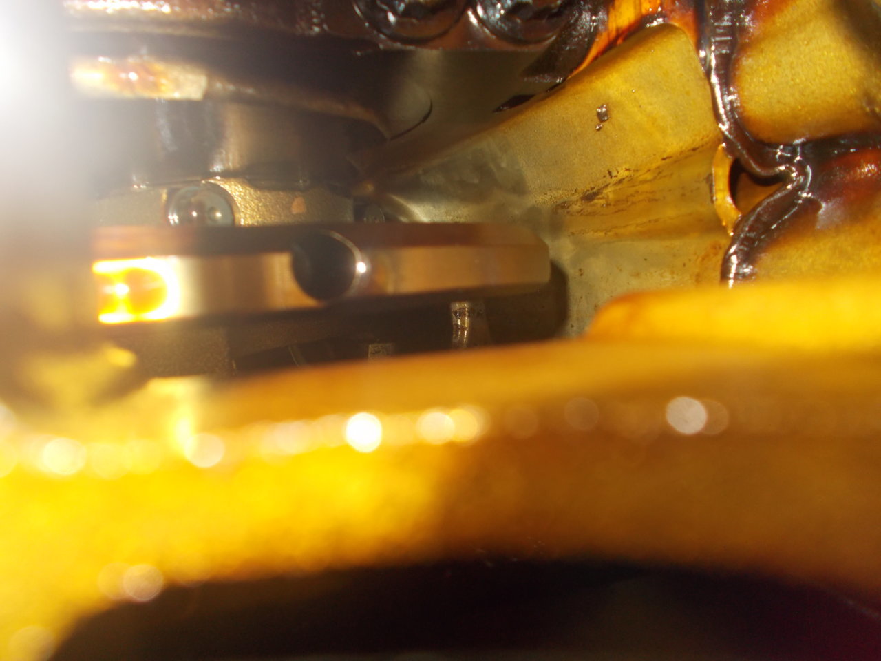

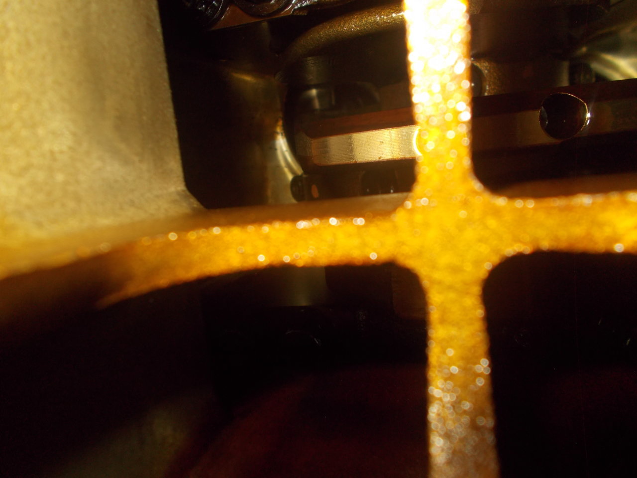

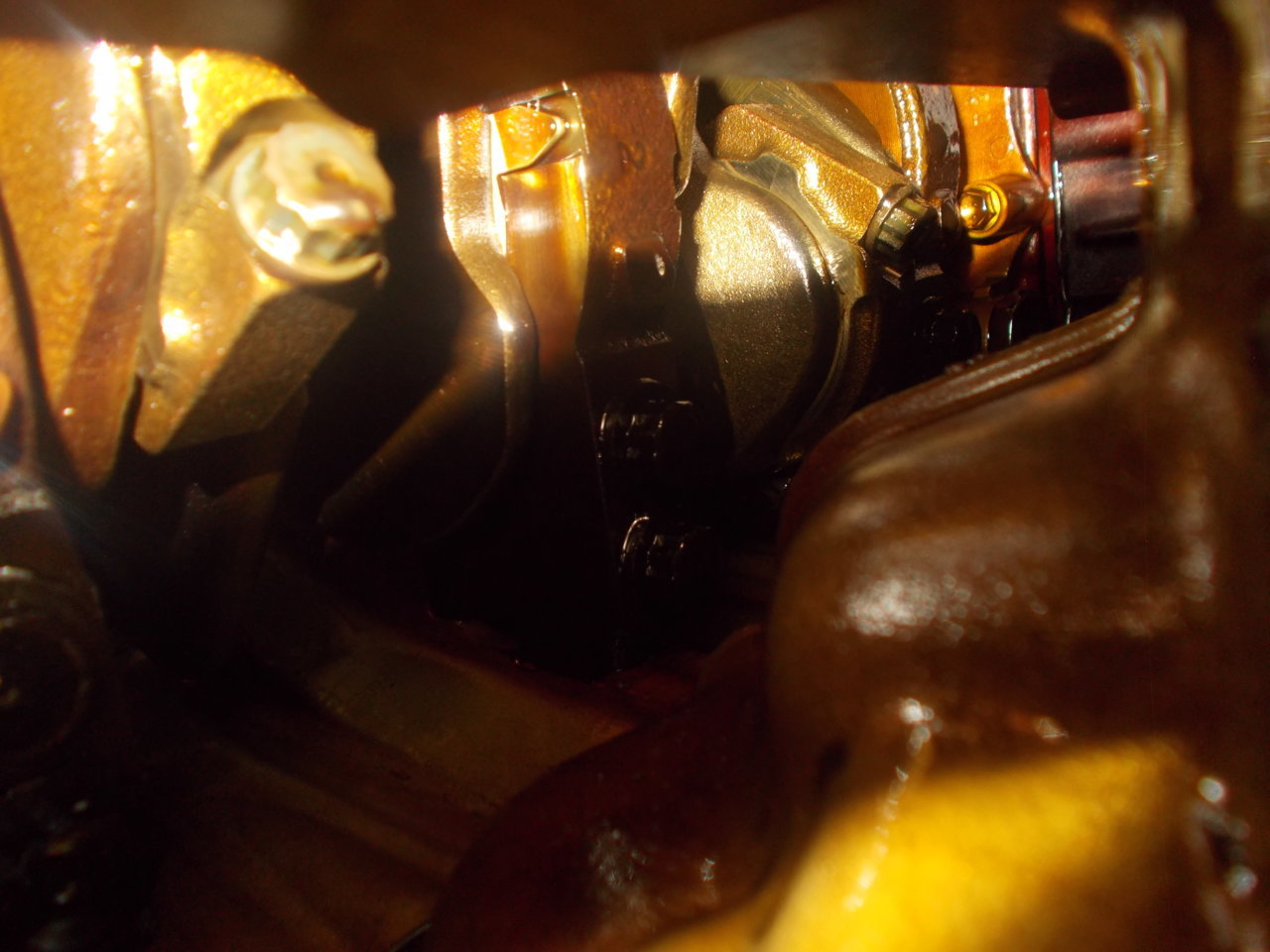

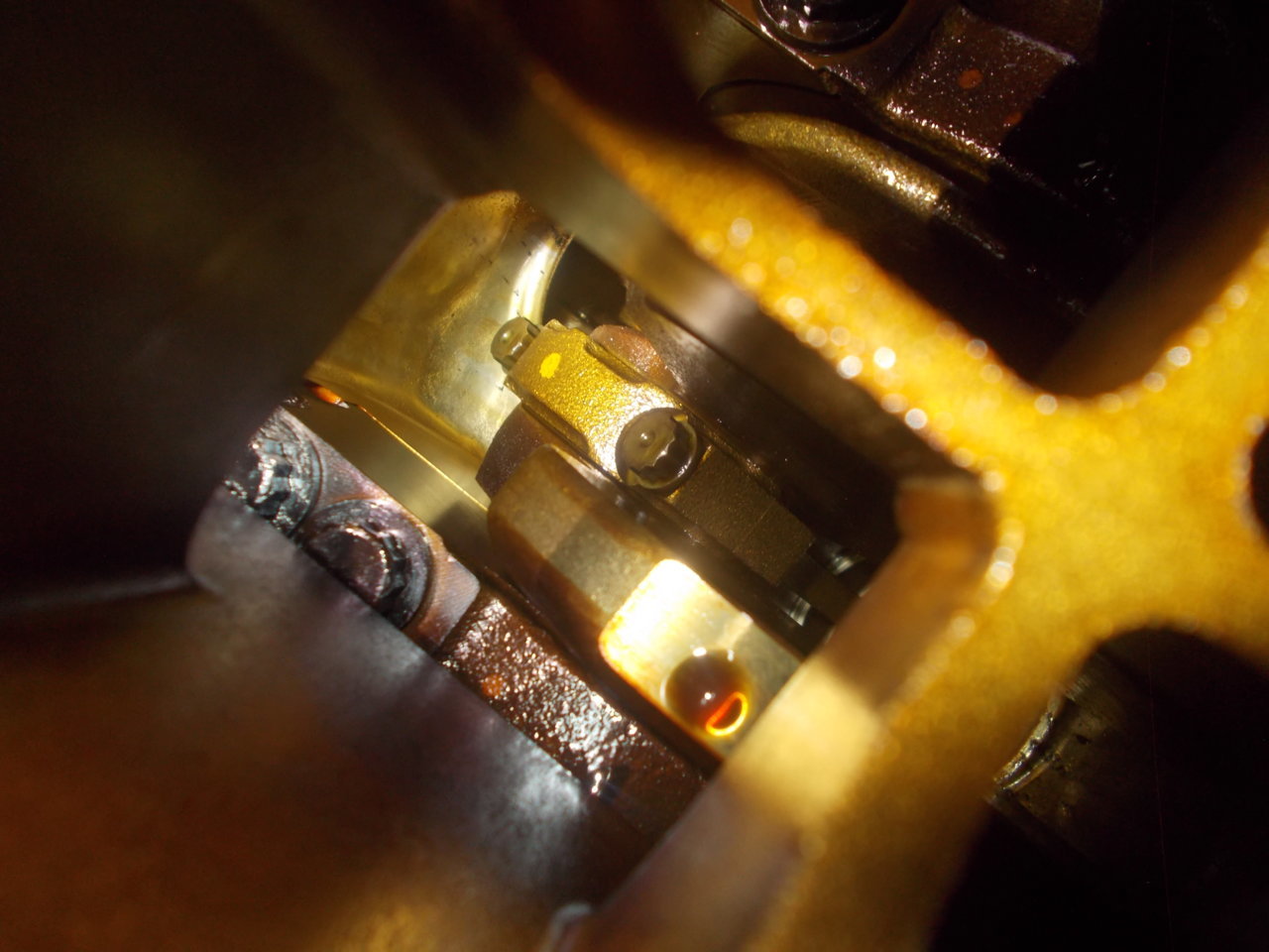

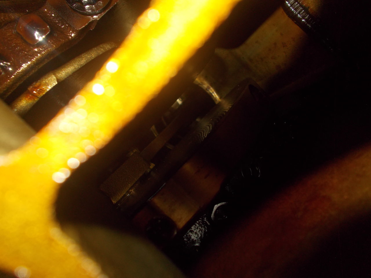

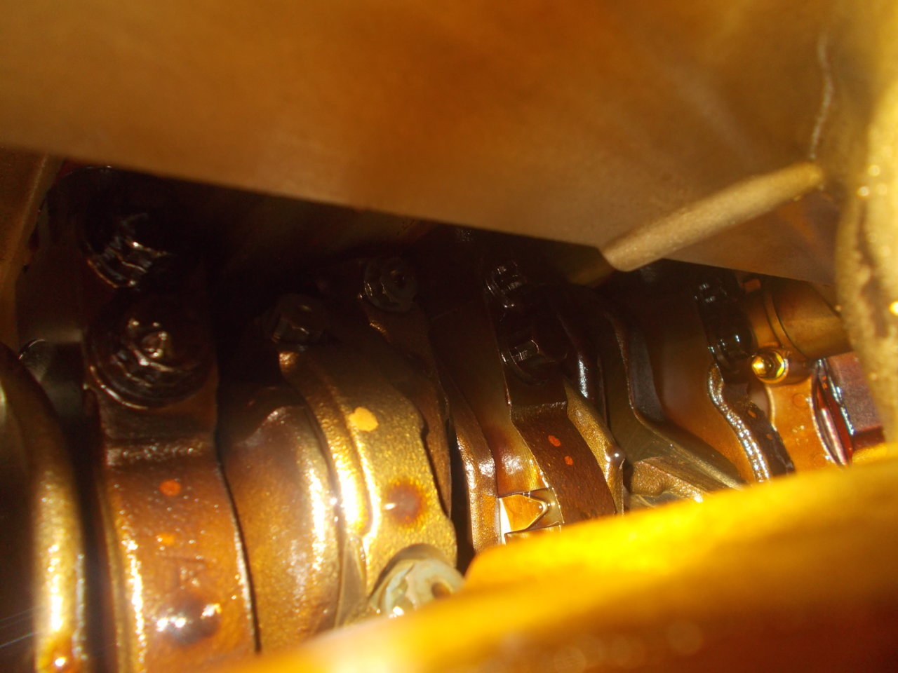

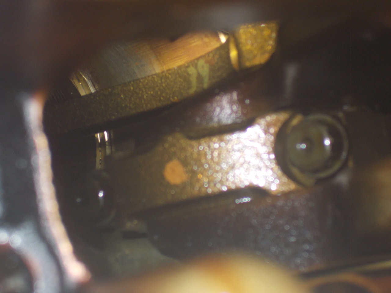

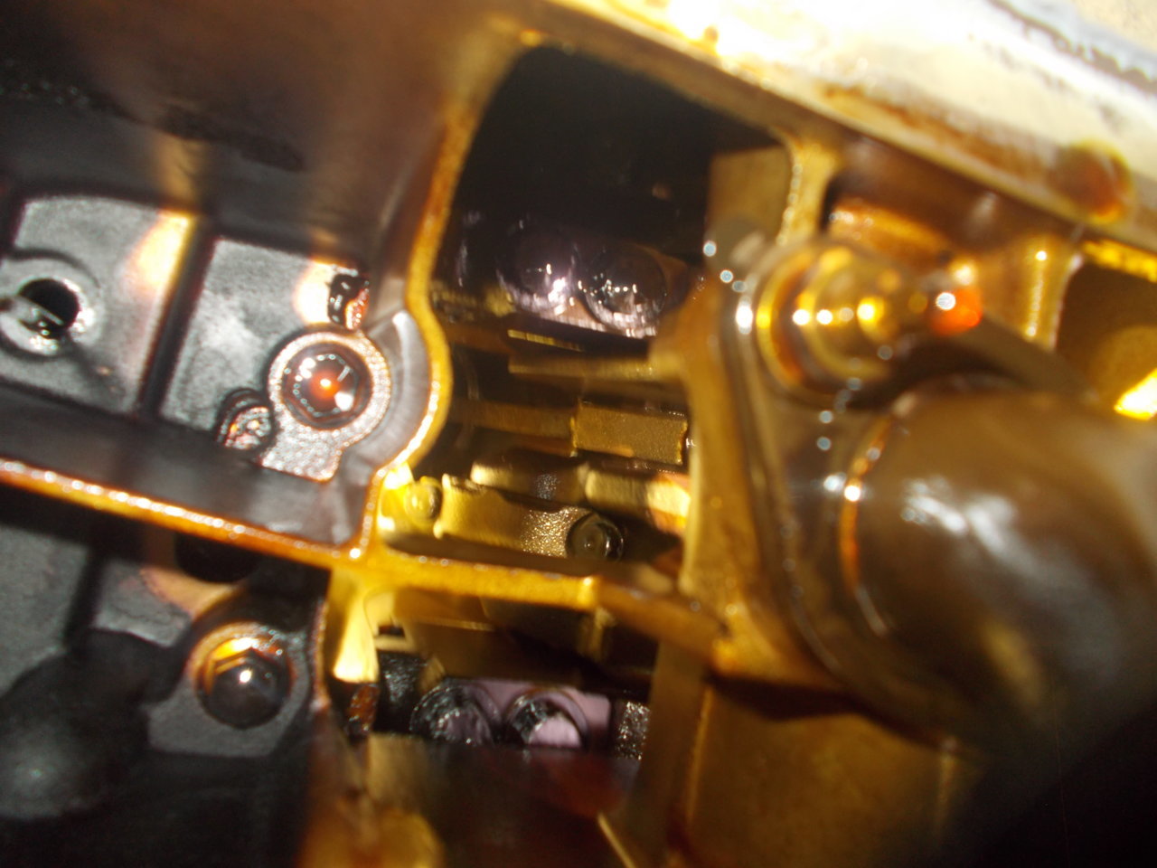

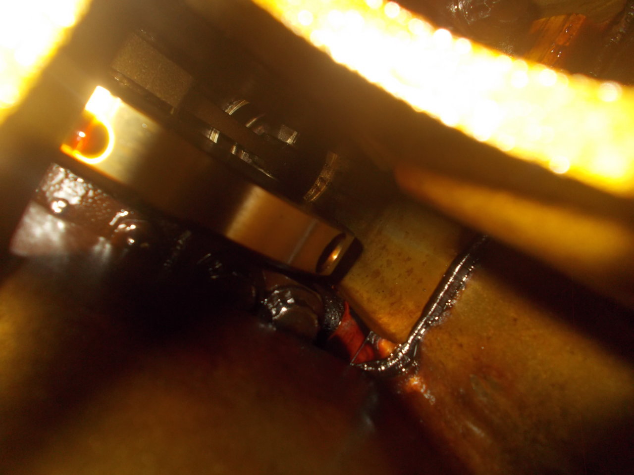

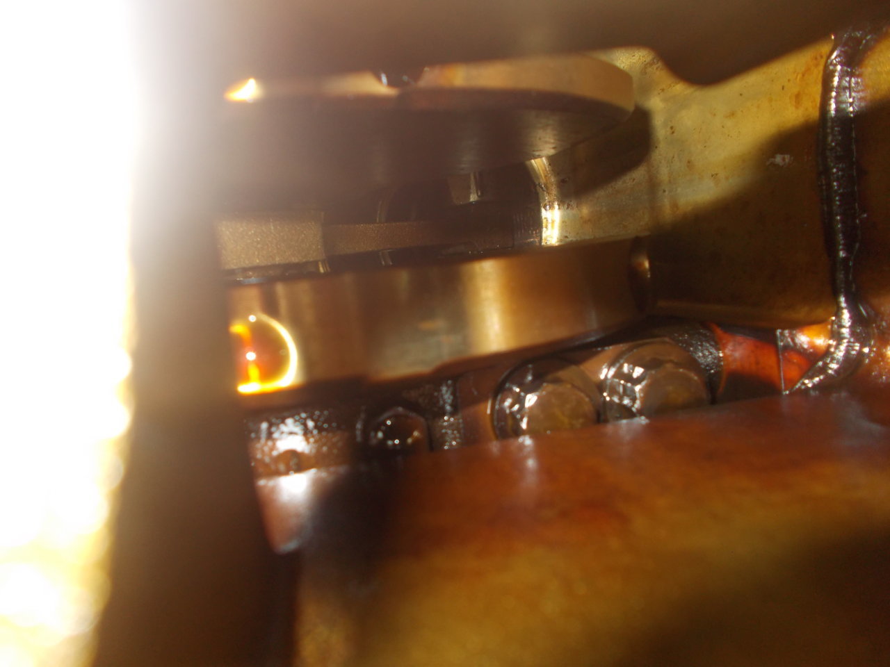

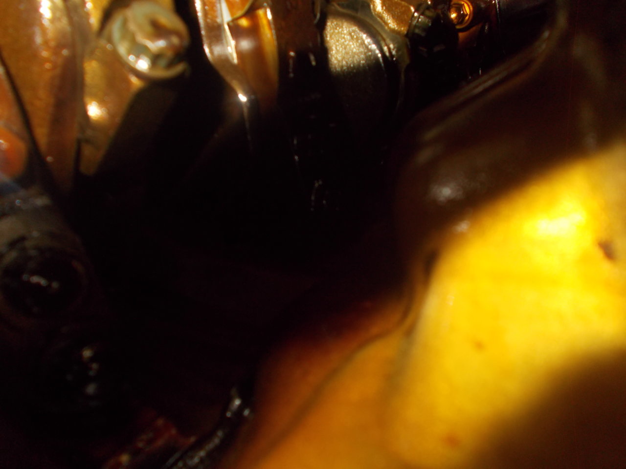

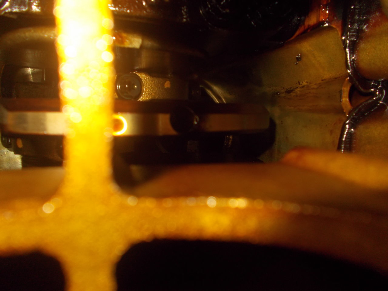

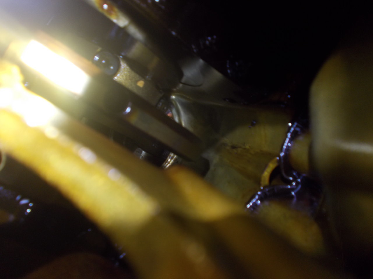

    sorry guys my internet went down and the just ran a new line to my house.all my pictures where on my laptop.ok so they may be bad picture i took them with a digital camera.the are all taken from where the oil pan is up in to the bottom of the block.no i didnt fill the cylinder with the oil.here are the pics sorry if they are to many

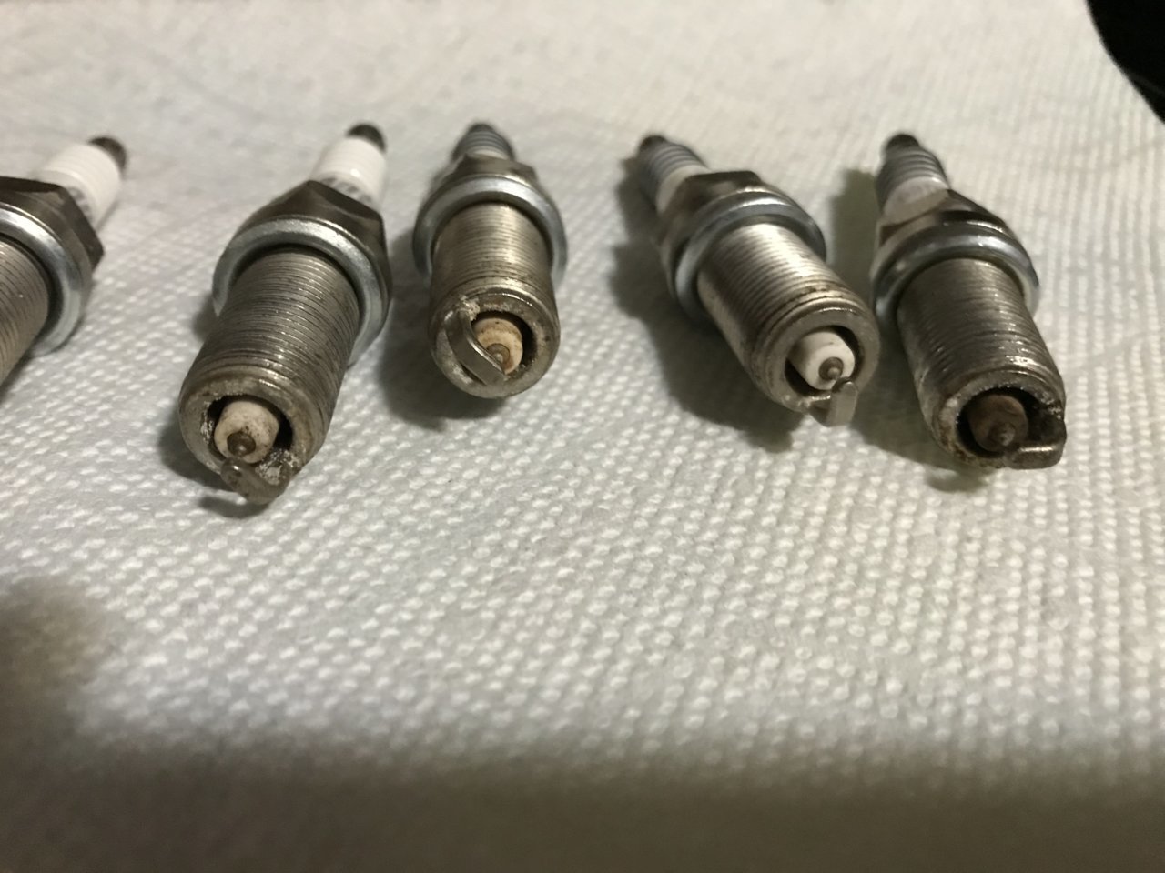

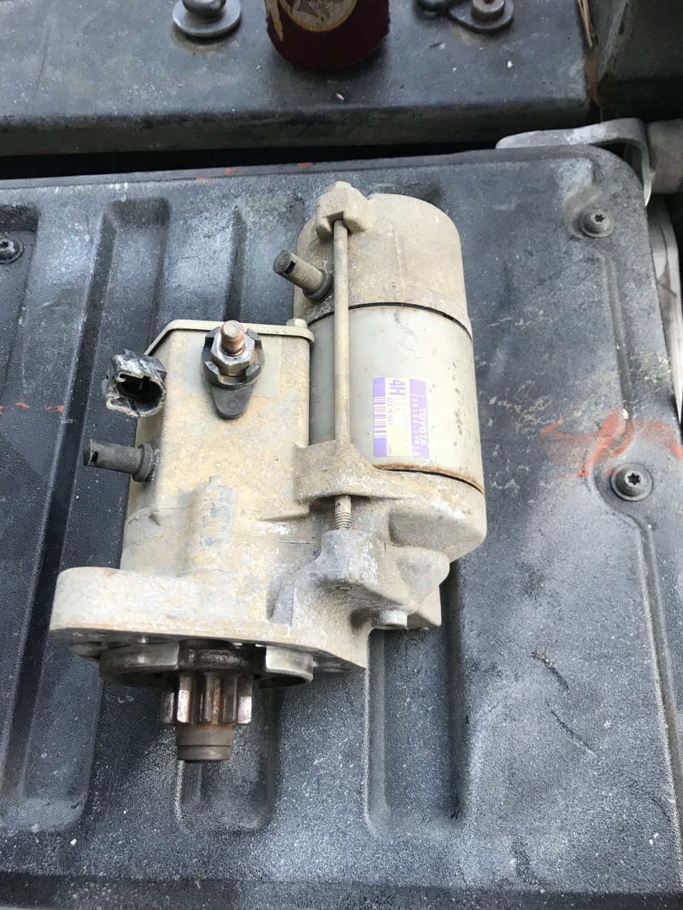

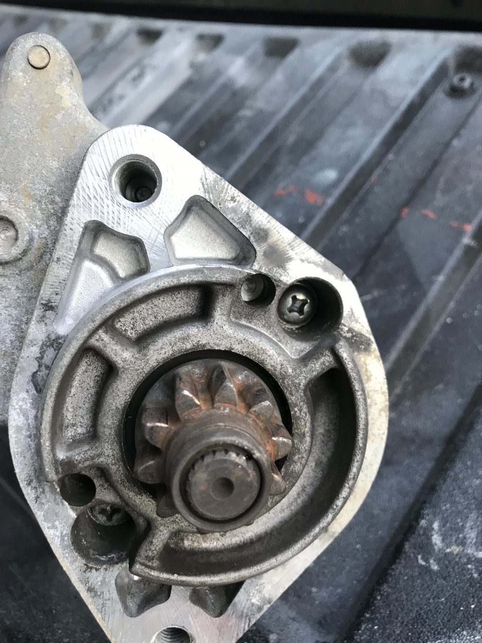

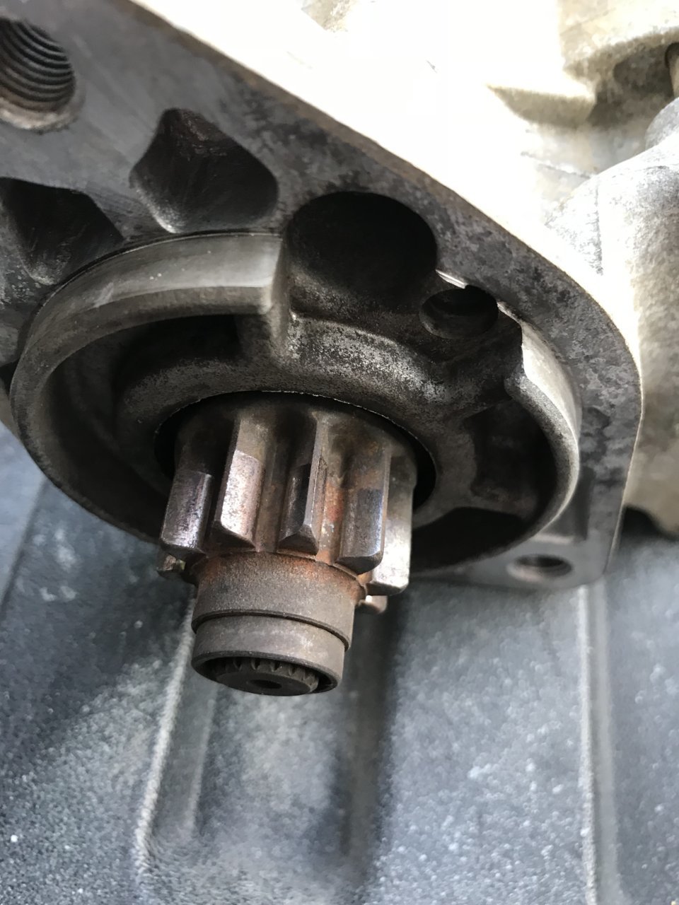

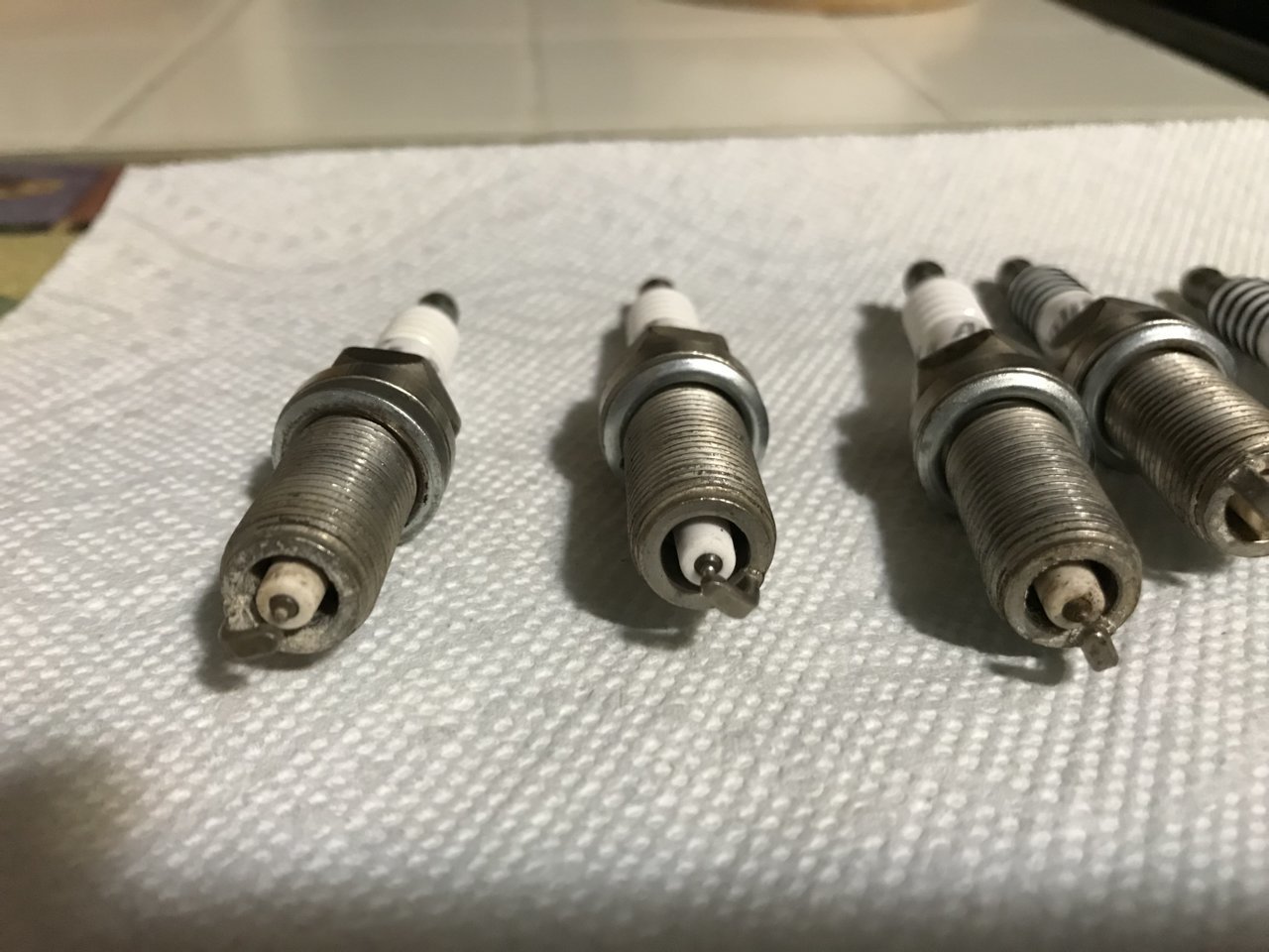

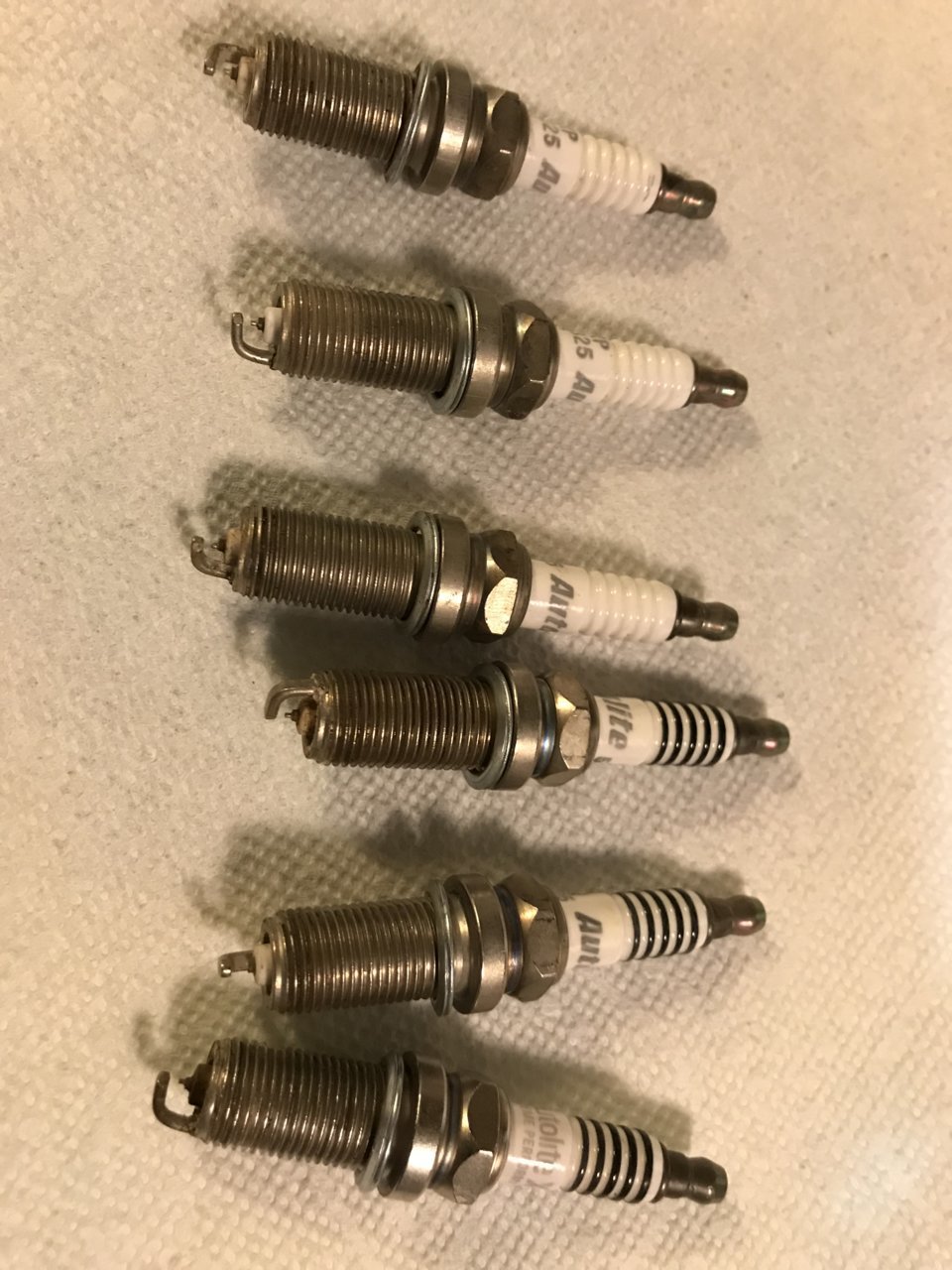

    I took the belt of today. All pulleys spine free accept the crank. Here are pics of the old starter and spark plugs1E86DF2B-D4D7-4284-AABC-F5F3F22F3BC3.jpgA5271928-FAB0-47B5-9CE7-3A6C8FB06284.jpgA5AE8086-F215-43FB-B2C3-FF931B245768.jpg36C5A4BF-D0F8-4F84-8101-DA273039D6D3.jpg56CDF064-0AE8-4F98-BAC9-46D2B4E68433.jpgB9C9485A-48B3-4735-9B01-D80CC9510268.jpg

    "no i didnt fill the cylinder with the oil."
    It's time.
    Well, it's past time.......

    I really could only make out 1 cylinder bottom and it looked good. No reason to think the top was any worse.
    Were the 3 bad looking plugs from the same side?
    If it doesn't free up easily with marvel or the like now, I guess it's time to pull a head.

    I think two plugs where on the right side one on the left. I can pull the head it’s the timing chain that I worry about. I can do a lot to cars but to be honest when it comes to the Internals of a motor I’m a rookie at.

    Some of those plugs definitely show signs of corrosion from water and or coolant. I wouldn't think highly of the previous owner who stated it was running fine also. Those plugs didn't come from a well running engine.

    I think someone mentioned some of the plugs looked like they had coolant/water on them or something
