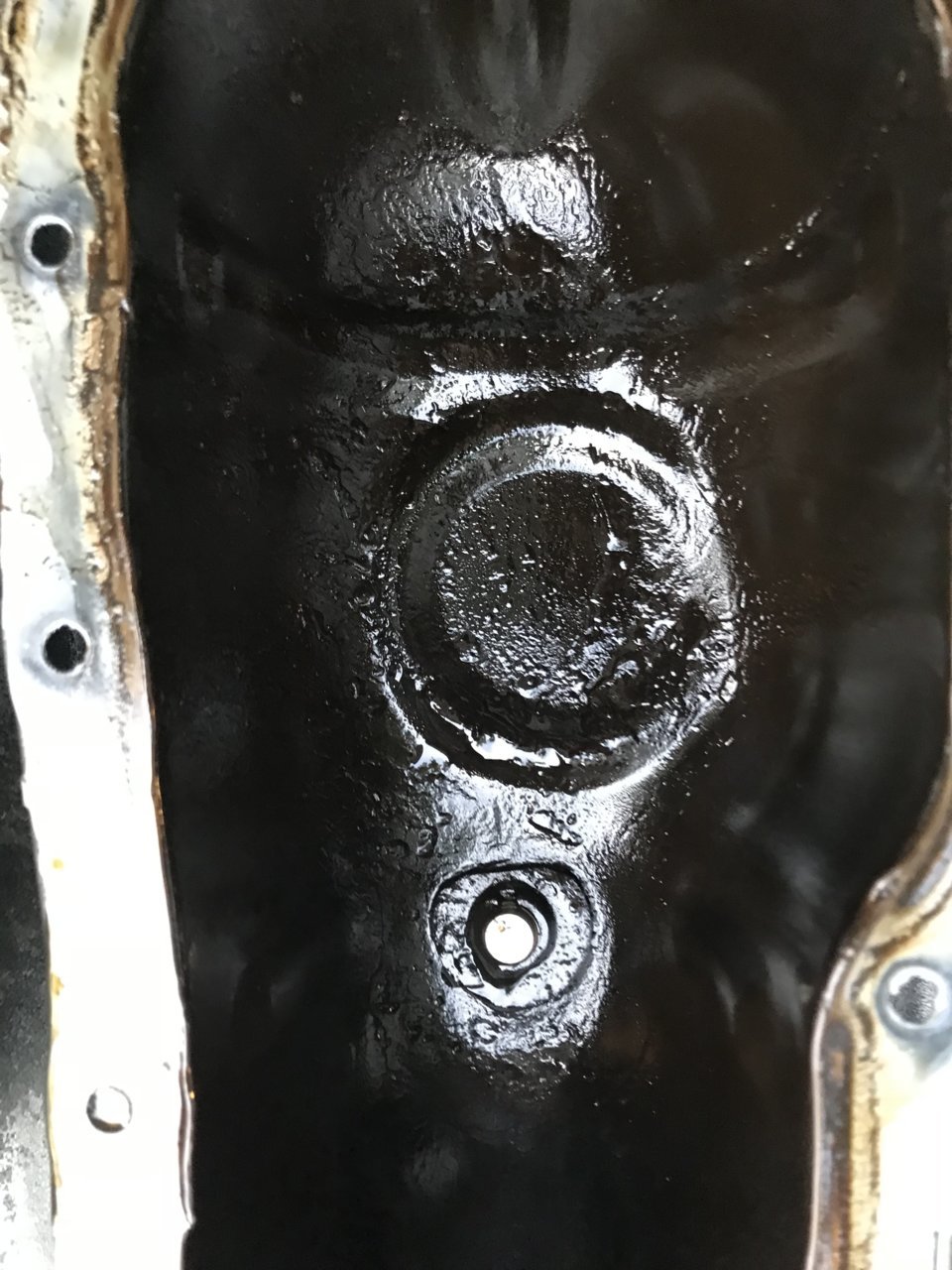

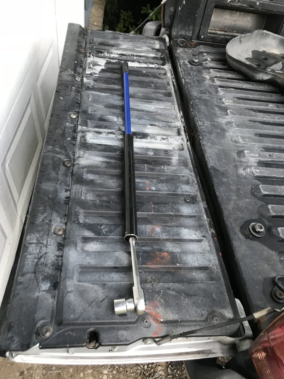

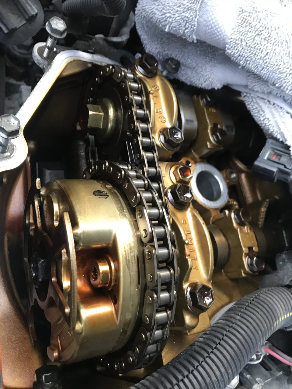

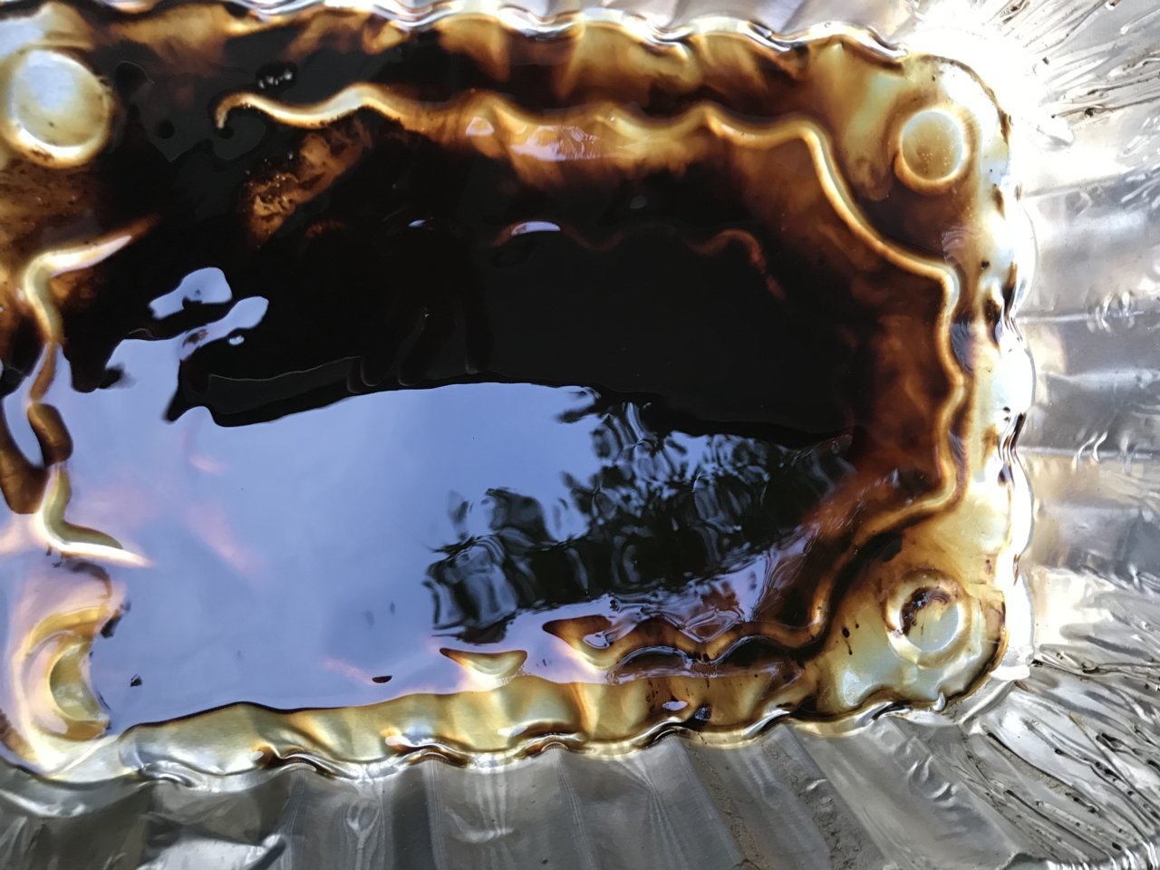

    Here are some other pics. The timing chain. My breaker bar set up. The bottom inside of the oil pan and the last bit of oil in the pan when I took it off AC6A1C88-F82C-4695-A1C9-AA1944B1D2C6.jpg82366C6C-FF5B-4394-BEFD-0296E2FC338A.jpg1FB6D39E-FC80-49DF-96DF-7450643DF13C.jpg06BE6EF8-40BE-48BC-BC6B-282D61CF951B.jpg08B24A16-9AE6-4ADB-BFD1-6BCFD290EC0A.jpg

    If you still have any, send out the oil for analysis...might give you some idea of what's happening..
    And, you need a beefier bar:muscleflexing:

    There is a chance then someone (or the kid) did switch out his oil with......something not oil.

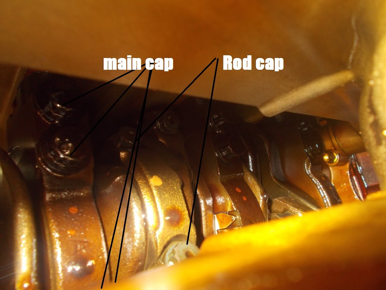

    Heck, pull a bearing cap. If it's wiped out, mystery solved.
    Edit: It's sooo clean inside that engine I'm kind of incredulous the kid changed oil that religiously. I mean it looks like every Sunday he changed it. Suspicious if he did add moonshine. (Turpentine)

    I’m not sure how to pull that cap.what do you guys think the next step is? Fill the cylinder with oil? Pull the head? Or... keep in mind this motor is still in the truck. I have a chery picker but my garage space is limited right now. I don’t mind digging in to it to solve this mystery. A used motor my cost from LKQ is $2250. So cheaper is better for me that seems a bit high for a engine.

    hmm, 4 bolt mains.

    OP didn't you mention not seeing metal in the oil though when you drained it? (don't want to re read all this)
    That would kind of rule out all the bearings being wiped out.
    Man, I don't know what happened to this poor thing. Like you, I don't think flood though. The interior would stink.......and you would see debris all over the undercarriage. I've been under quite a few of those too. They're easy to spot underneath.

    I didn’t see any metal in the oil. Just what I say as watered down or a bit runny for oil. I agree with the flood thing interior is clean well clean as no water damage and the undercarriage doesn’t have any signs of water ie debrie or water lines from sitting in water. I just did a car that had a water leak (back glass wasn’t sealed right) car smelled bad really bad! Pulled the interior had mold under the carpet it was bad. This truck doesn’t show any signs of water damage interior or exterior.
