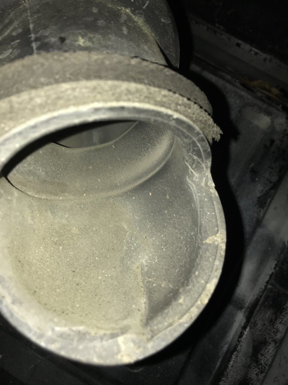

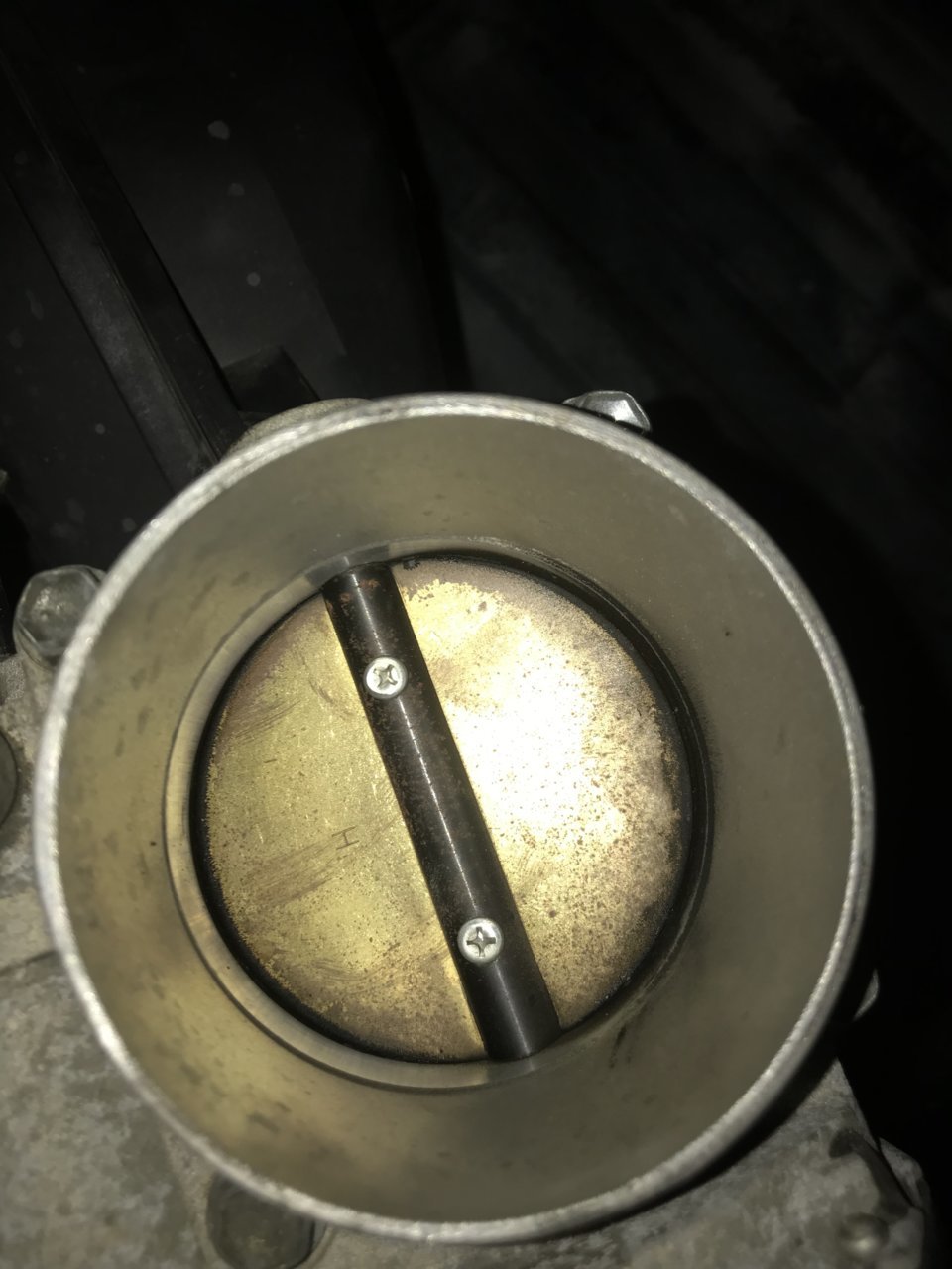

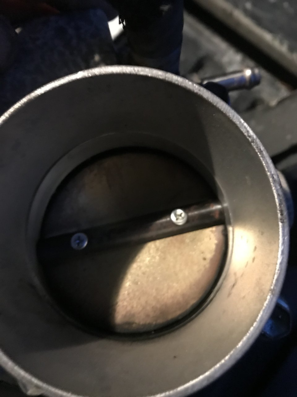

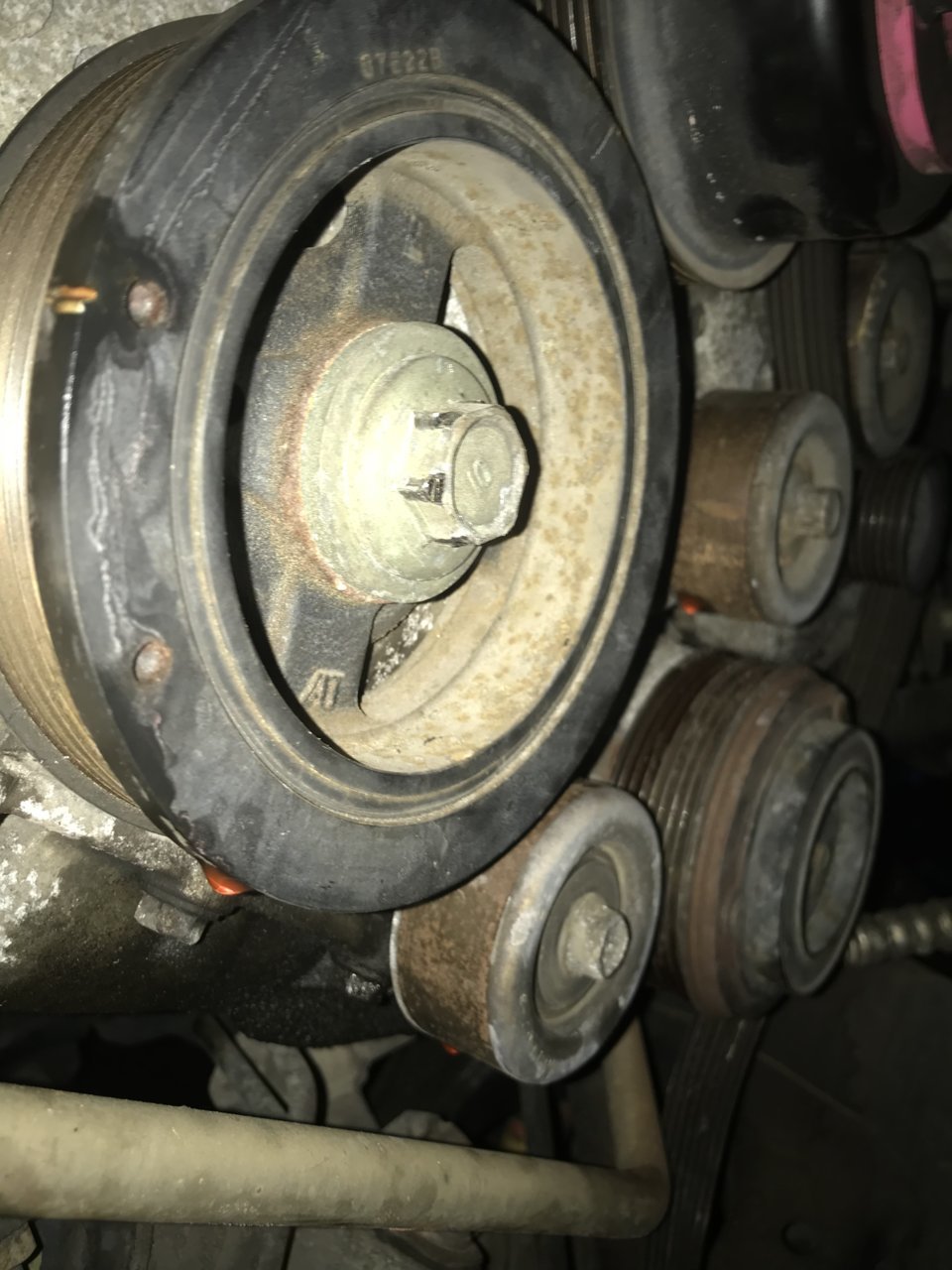

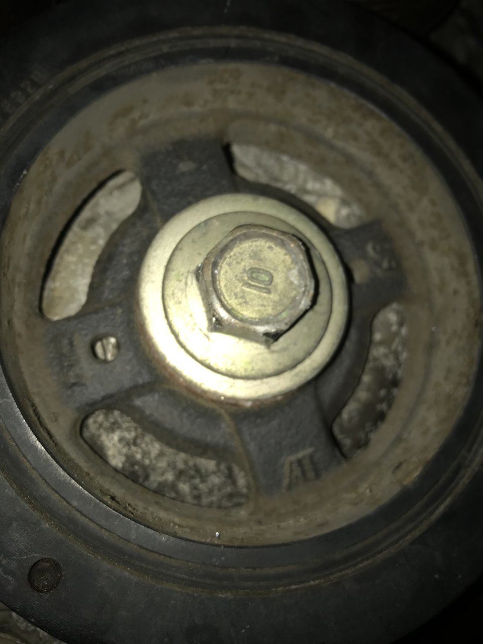

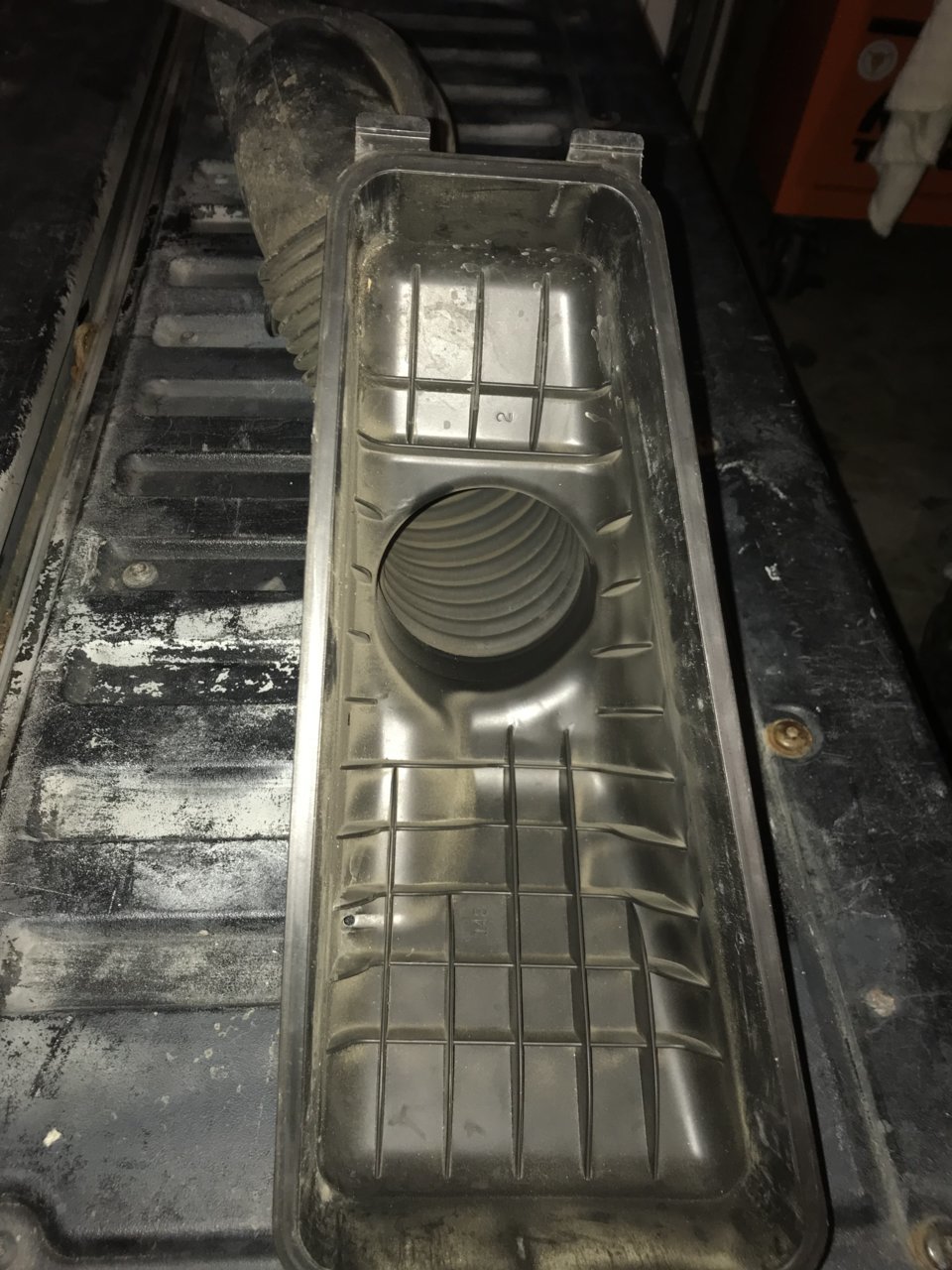

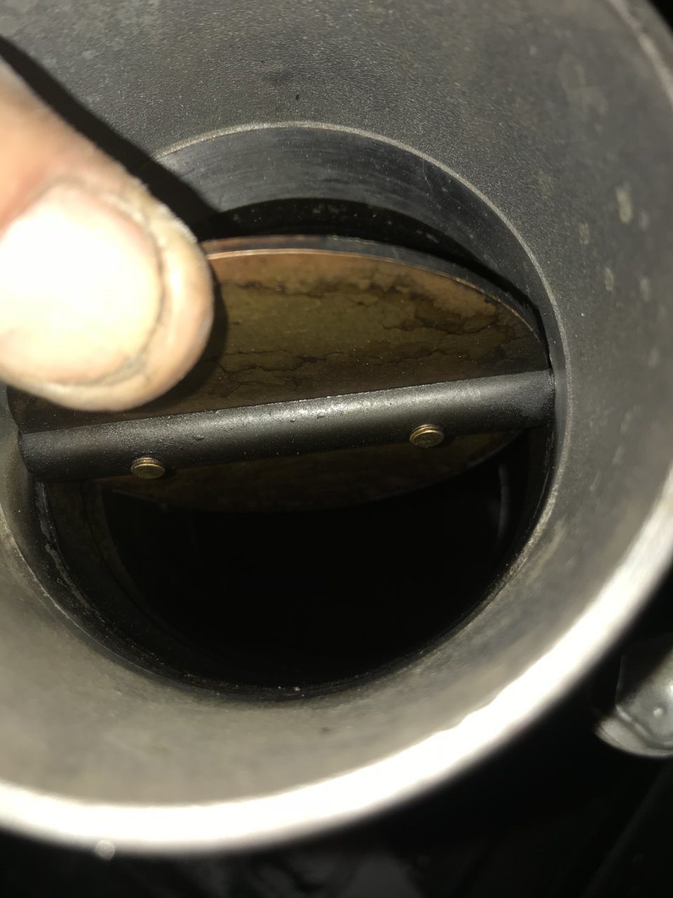

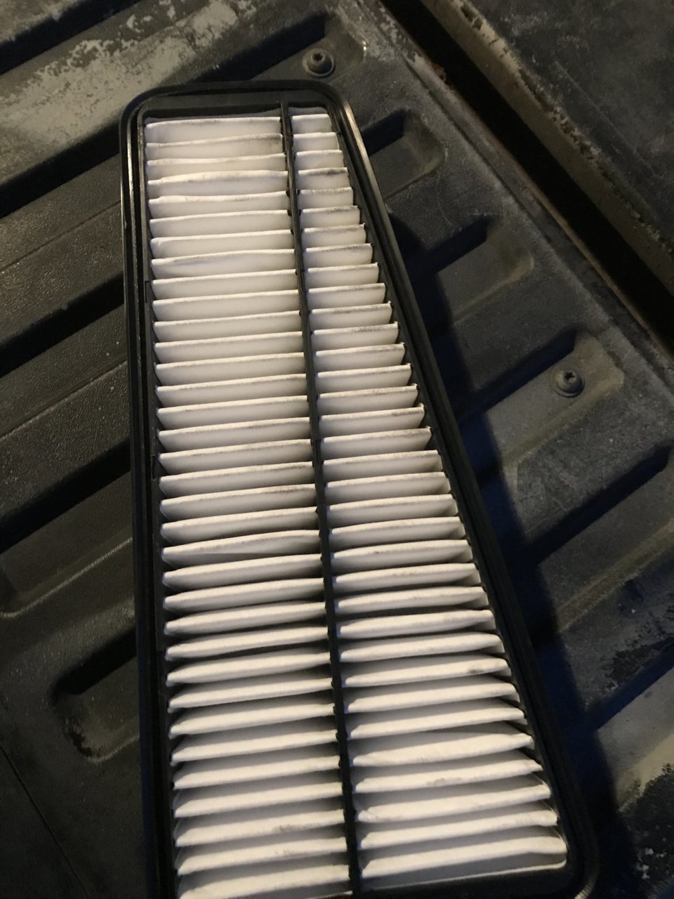

    More pics. The crack pully I have the bar on.the crank picture is from the bottom side of the truck looking up. The belt is off and I can spin all other pulleys by hand except the crank. The fluid on it is coolant from the intake being off and the radiator being full and still in the truck. The air filter (looks new). And intake pipe. I don’t see and signs of water. The throttle as a small amount of rust but could be from sitting. E5C83F30-F983-42B8-83E3-BFAF0886F25D.jpgEE48F690-A952-4293-BD03-7C700C8E9AF6.jpg0D6C79B2-0782-4E70-8258-6EEF0D396DD4.jpg2F79460D-C215-49DC-B76B-F5FD03549453.jpg13D9A802-B018-49BA-A938-57AE8BCD6620.jpgA8743061-AD49-4080-8E07-34956F9FE051.jpg8F2C778B-E4F1-4114-AED7-04B805965214.jpgCB25A8F7-65C6-4E24-BAF4-17F13DDDF9EB.jpg

    Will it even wiggle? Can you try spinning it the other way?

    Just a thought, any chance you have it in gear with the e-brake on while trying to turn the crank? Just something easy to forget:notsure:

    Won’t move clock wise or counter clock wise. It’s in neutral. Just have the e-brake on

    Another way to try is put it in 2nd gear with e-brake off. Have some help you try to rock it back and forth while you watch the crank pulley .

    That wimpy combination breaker bar is your first problem. Get a 3' to 4' length of pipe to fit over your ratchet, get that sucker snug on crank and give it a heave!

    If the breaker bar hasn't folded over yet, then it seems to be handling all the torque he has put onto it.

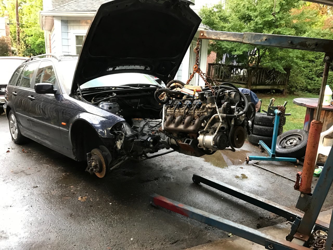

    I have an LS1 sitting in the engine bay of my E46 wagon. The motor is good, it's perfect. No issues. But since the project has been on hiatus for the school year, I thought I should walk over and rotate the crank. Good thing I did as the serpentine belt was becoming rusted to the crank pulley.
    I think I used a 12" rachet to rotate it by hand?
    If this motor don't turn over with a 18"-24" breaker bar, using 60" is just being immature for entertainment purposes. A seized motor can't resist someone putting all their might into a 2' breaker bar. A seized piston or or welded rod bearings will give way immediately. There's something jammed somewhere here. I'm betting a bent rod at this point.IMG_2367.jpg
