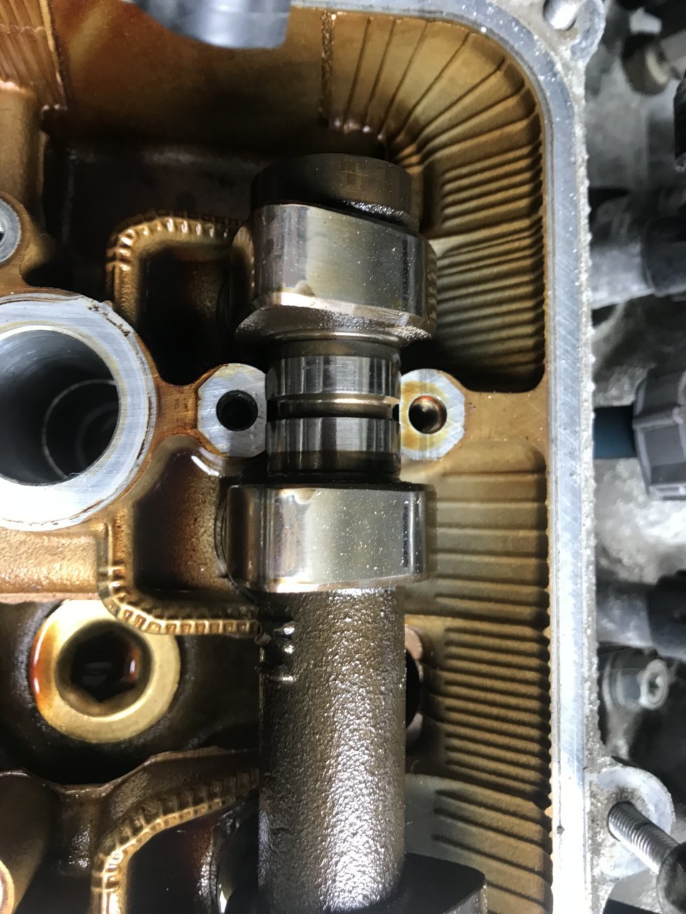

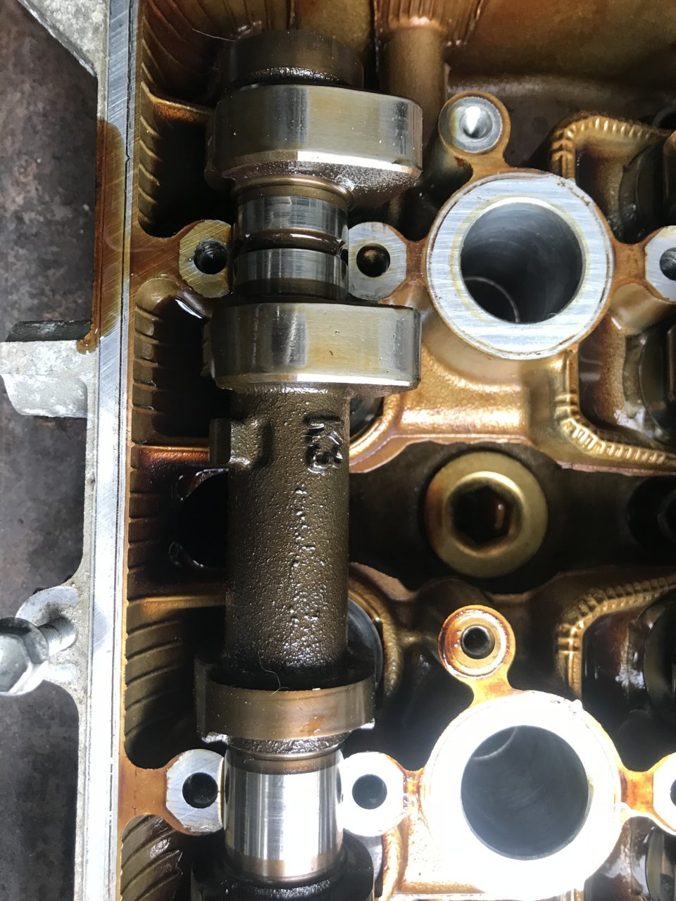

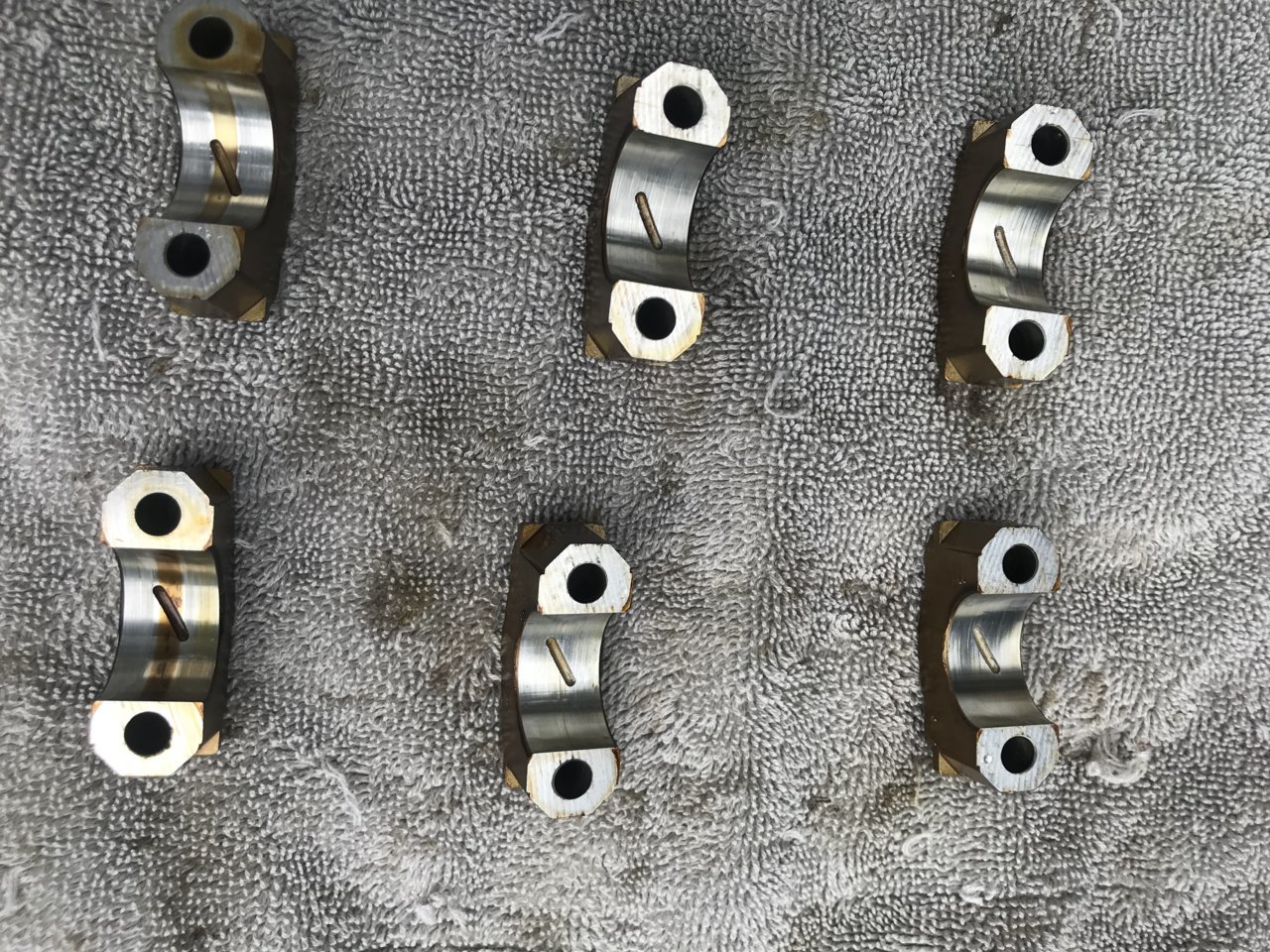

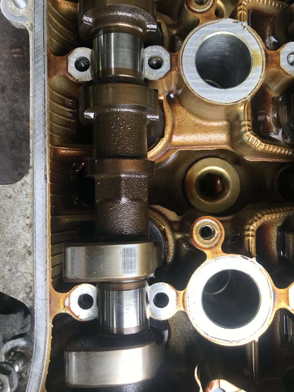

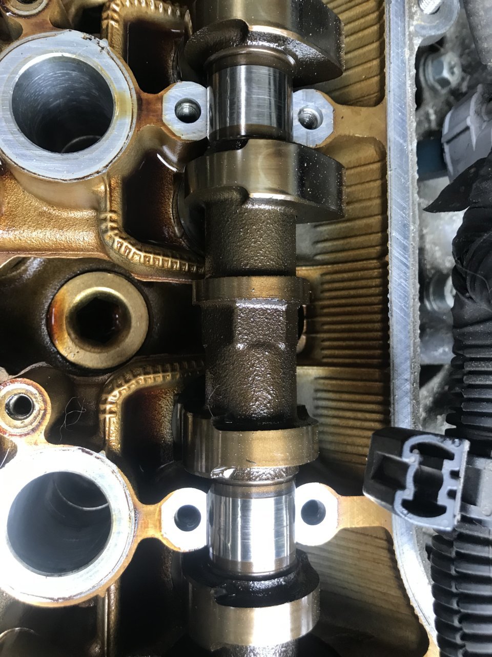

    Pull a camshaft bearing cap off and see if it's scored. If the engine was run out of oil the first bearings to get starved of lubrication would be the ones at the top of the engine.

    04C675E4-50F8-47D4-8332-F512FACF7C8B.jpg C717B560-C62A-4D38-BCB7-1DF7D28DCA44.jpg 8C59A7F2-5BB9-4AC8-BFA0-F0C357BFEE8A.jpg 9055EA7E-87D6-4E08-B9F5-684F29EB5ABE.jpg 36148274-0C1A-48D4-ABEE-849B66C4F943.jpg

    Small grooves but not too bad. How many miles?
