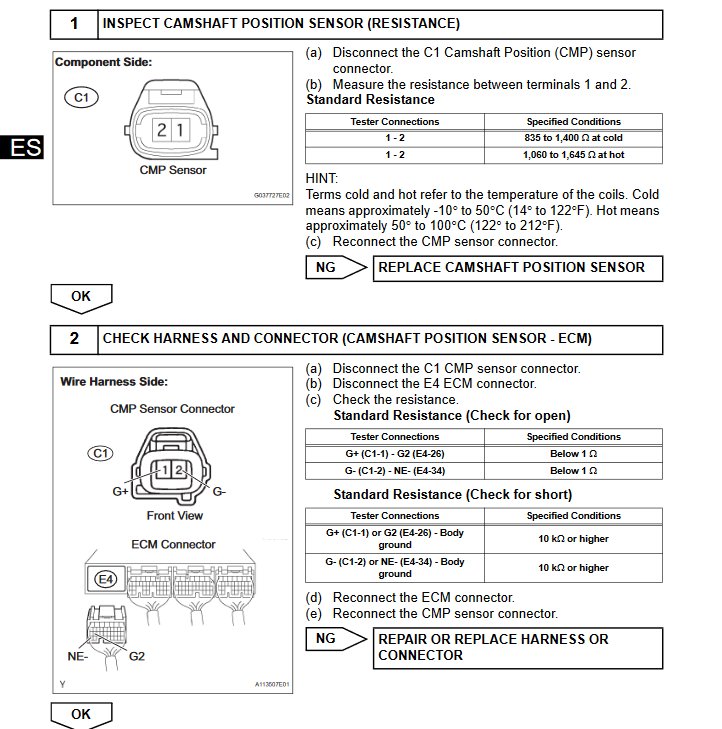

    So I towed it to a buddy’s shop We hooked up his snap on scanner and eliminated a bunch of possibilities including the crank position sensor It showed that it was operating but the cam position sensor on the VVTi was not showing it was working checked power at the connector and it has power going into it can someone with the 2.7l take off their cam position sensor and see if it beeps on an ohms tester because I’ve bought 3 from a parts house and they are not showing resistance

    are you sure your meter is set right? leads in proper place for ohms reading? ohms reading is supposed to be 1060-1645

    Yeah my friend who’s shop I took it to did it

    Here:

    Bit of a long shot, but could the OP be checking the harness side resistance rather than the sensor side? According to the sheet @Jimmyh posted, that is <1ohm, which would likely read as '0', especially on a cheap meter.

    I have now got a reading on a cam sensor but still won’t start
