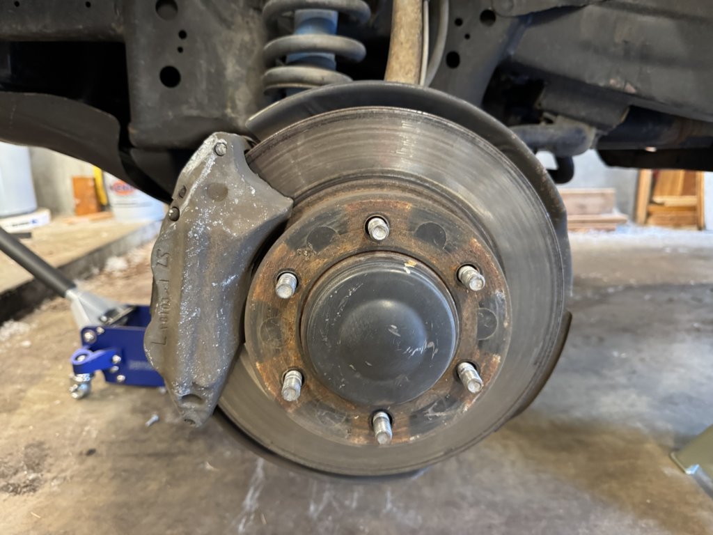

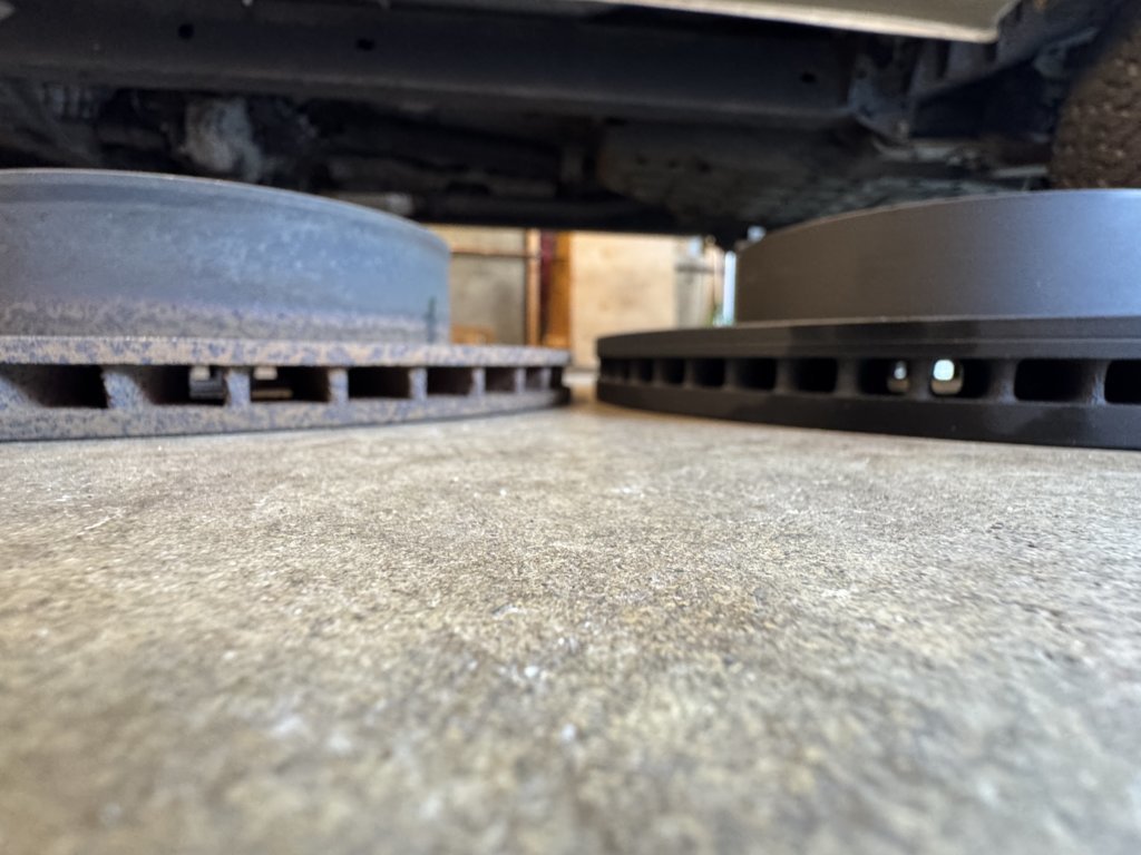

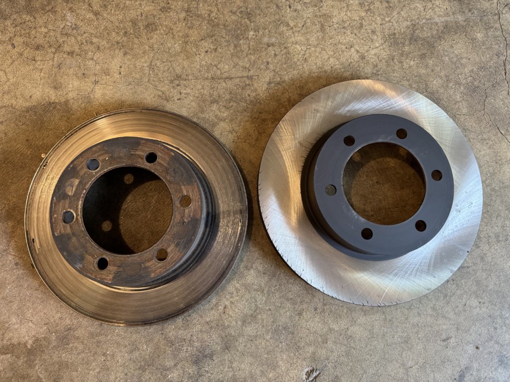

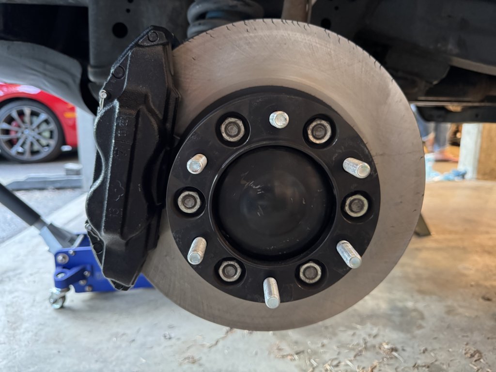

    Installed the Tundra front brake upgrade on Sunday.
    The Tundra brake upgrade is basically an OEM big brake kit available at a very reasonable price compared to aftermarket big brake kits. Adventure Taco aka @turbodb has a great writeup here, so I won't reinvent the wheel with the exhaustive info and keep it to the highlights. I recommend following his writeup.
    On my previous Tacoma I used StopTech slotted rotors which are also available for this Tundra upgrade, however the StopTechs are made in China and the OEM Toyota rotors are made in the USA. OEM USA vs Aftermarket Chinese, I decided to stick to OEM and forgo the slotting. (OEM Tundra rotor L/R pn: 43512-0C01)

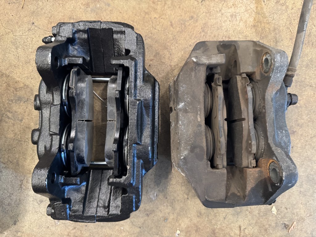

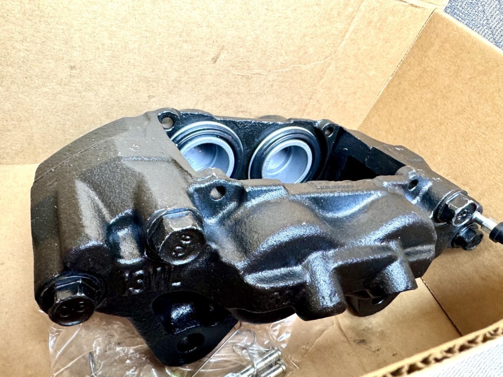

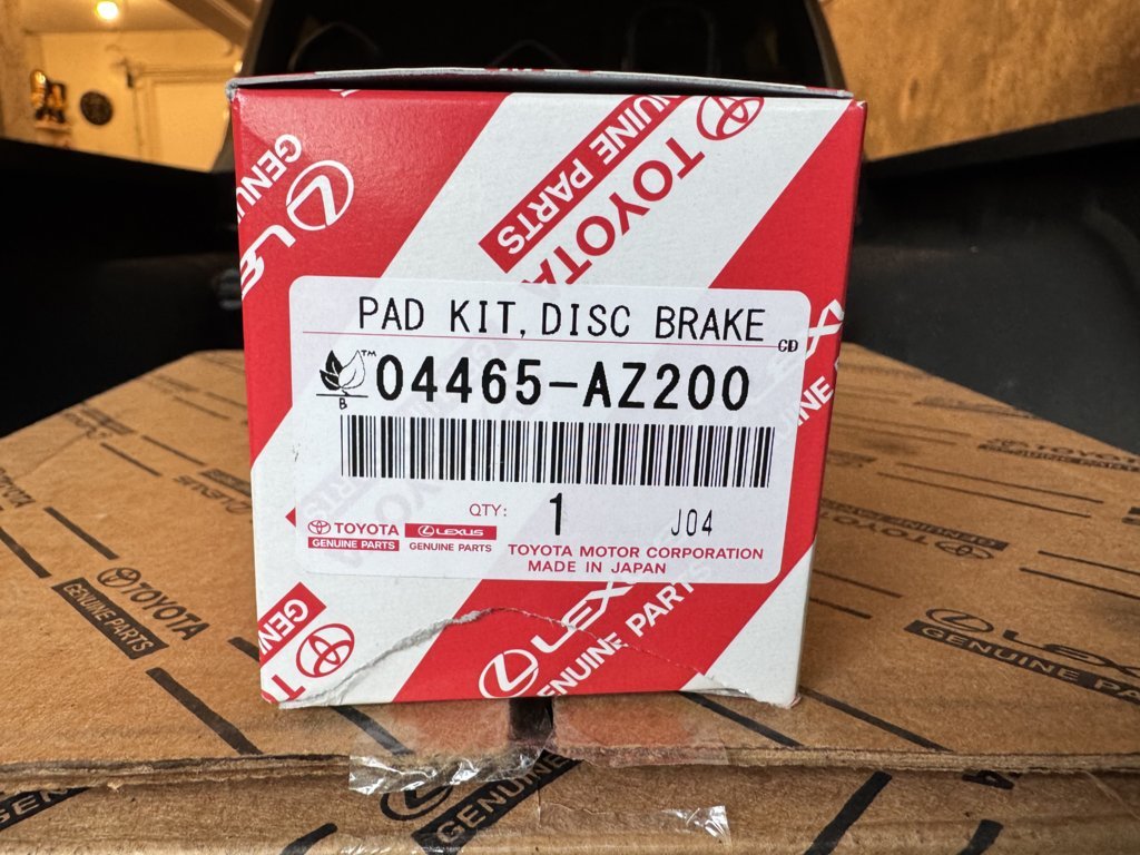

    The Gen 1 Tundra calipers are slightly confusing. The Gen 1 Tundra came 13WE calipers which were recalled and later replaced with the larger 13WL calipers, both fitting the same rotor size but taking different pads. So you may not be able to trust systems based on year/make/model for parts and need to go by part number. The larger 13WL calipers are the ones to get. Many reman caliper options are available for the 13WLs, I went with the Napa Adaptive Ones (L: ADC 1766XA) (R: ADC 1766XB) mainly due to documentation thoroughness of what had been done and was included vs the competition and Napa's premium products are going to be relatively decent quality.
    For pads the usual suggested pad is the OEM Tundra pads (pn 04465-35290). I went and picked up my parts from the dealership since Amazon delivery was too far out for my desired timeline. In talking to the parts guy, who happened to own a Gen 1 Tundra with 13WL brakes, he instead advised the made in Japan Land Cruiser pads that are interchangeable and according to him 'superior in every way, especially bite' over the Tundra pads, saying he's used both and significantly prefers the Japanese Land Cruiser pads (pn 04465-AZ200) which are also slightly cheaper.
    So Japanese Land Cruiser pads it is.
    While the rotors, calipers and pads all directly bolt up between the Tundra and Tacoma, the brake lines do not. You need an adapter kit to mount the lines to the tundra calipers. AdventureTaco sells a kit to swap Tacoma-to-Tundra Hard Brake Lines. There are other kits out there too that are more expensive.

    Stock brakes
    Tundra 13WL caliper left vs Tacoma right
    Tacoma rotor left vs Tundra rotor right

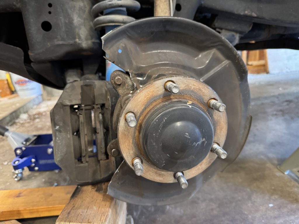

    The stock dust shield will need trimming to fit the larger tundra calipers, I'd recommend a Dremel with a cut off wheel. Not pictured, but I painted all my cut surfaces with high temp Rustoleum paint to inhibit corrosion. Cutting the shield will likely be inadequate. Test fit with the Tundra rotor and spin the rotor. I had contact in multiple places. Using a BFH adjust the dust shield back away from the rotor till you have adequate clearance for free spin.

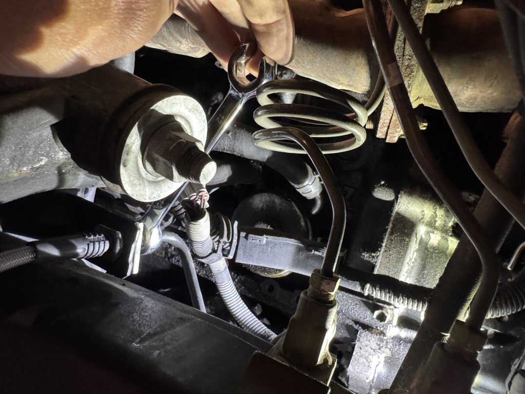

    The most difficult part of the swap is the cramped brake line flare nut removal/install on the inside of the frame rail to swap the new stainless lines. Limited space for hands and movement.
    Pic bleeding the brakes but only one I took that shows the new lower Tundra caliper hardline to stainless hose conversion. The cheap bleed kits are really nice when you are bleeding brakes and does allow you to do it solo. I was sure to flush out all the old fluid till we had new clear fluid come through. I used 12oz of fluid to do both sides, but that was just perfectly enough. Had there been any issues I would have been short. Note that DOT4 and DOT3 are compatible. The 1st Gen Tacoma specs older DOT3, DOT4 has a higher boiling point and is better, it can be used in DOT3 systems. So I'd recommend always going with DOT4 on DOT3 specs when possible.
    In the above photo it looks like the hardline interfaces at the bracket perfectly with the stainless line. That was not the case out of the box. The hardline had to be manually bent in order to have a correctly oriented connection to thread together. The suppled brackets also put the stainless line right into the base of the spring with very minimal clearance, way to close for comfort. I took vice grips and bent the mounted bracket to angle the lines away from the spring.
    Finished product with 1" Bora spacers installed
    During the install process, brake fluid ended up being spilled on the calipers. Brake fluid is highly caustic. On my 2nd Gen Tacoma StopTech BBK, when brake fluid spilled on the calipers it ate the powder coat right off the ~$1700 brakes. In the case of the NAPA calipers, the coating was completely unphased by the brake fluid, excellent durability.
    After checking everything for clearance, ensuring free spin and buttoning everything back up I did a brake break-in run consisting of many 60-15mph hard braking sessions in rapid succession. That first hard brake nearly caught me off guard, the heavy E-load 285 KO2s shrieked resisting the pavement at near lock up from 60 as the truck decelerated hard. Very impressive and a huge improvement over the stock brakes.
    After repeated hard stops trying to heat soak the system, I heard a foreign noise. Distinct metal on meal sound. The dust shield was contacting the rotor again. Heat cycling must have caused it to flex in a way that is now problematic. After investigation, the contact point was near the center of the caliper. Arg. Fortunately I was able to use a screwdriver and bend the shield away from the rotor without removing the caliper proving adequate clearance.
    In looking at the dust shield and rotor clearance, I realized with the lower hardline conversion going to a fixed mount on the spindle, the caliper will no longer swing away freely when unbolted from the hub like it would running soft lines as the lower hard line is fixed on both ends. It will make the next brake change a bit more work, but that's a future issue for another day.

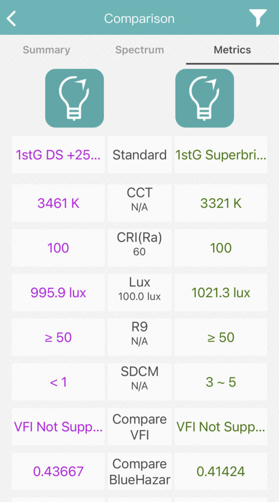

    I've been curious how the best performing DS +250 H4 bulbs (covered in post #5460) would perform in the smaller 1st Gen assemblies vs the 100/90 Osram Superbrights. In 2nd Gen the Superbrights outperform the stock wattage DS +250 bulbs by ~9% peak intensity on low beam (impressive for a stock wattage bulb vs a high wattage bulb). However, high wattage bulbs have larger filaments which are generally more forgiving in larger assemblies, as the assembly gets smaller with everything else being equal, those larger filaments start to reduce performance. So would the smaller 1st Gen assemblies perform better with the ultra high efficiency DS +250 over the larger 100/90w Superbrights? Only one way to find out.
    I don't have spare 1st Gen assemblies for bench testing like the rest of my tests, so this is a driveway test with the truck running (imperfect due to voltage flux).
    DS+250 left vs Osram Superbright right, both run on HS HD harness + HKB voltage booster
    Laser measured test distance, 21' 1"
    DS+250 vs Osram Superbrights
    The Osram Superbrights come in at 9.7% higher output intensity, extremely similar results to 2nd Gen. The Superbrights are a fraction of the price of the DS+250s, though they do require the HD harness. The results favored the Superbrights more than I expected. Based on the empirical evidence I will continue to run the Osram Superbrights.

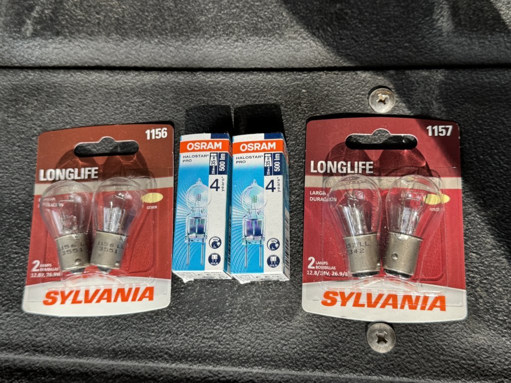

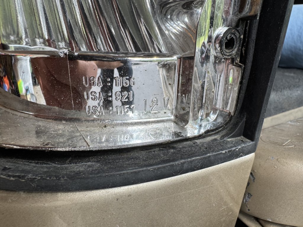

    One of the things I like doing on used vehicle purchases is replacing all the exterior lights with fresh bulbs. Automotive incandescent bulbs (except headlights) have exceptionally long life, so if you replace them all up front, you really don't have to worry about it again for many years vs being nagged by a failure here and a failure there. I had purchased these when I bought the truck and just never got around to the install.
    Turn, reverse (using gy6.35 bulbs from the HIR upgrade) and tail/brake.
    In taking apart the rear assembly, I didn't like how small the reverse (center) portion of the lamp was for running the hot halogen IR gy6.35s.
    I purchased lower power 25w IR gy6.35s (vs the 30w and 35w bulbs I used in my 2nd Gen from the 921 gy6.35 thread). The 25w IRs still have an impressive 500 lumen output vs stock 264 lumens from the 921 bulb and will be cooler, but seeing how small that space is still gave me some pause, even with the lower power. The gy6.35 bulbs are not only higher power than stock, but also halogen IR vs incandescent. I've got some ideas though, I didn't install the reverse lights yet, but I'll come back to these.
    I did like the detail of how Toyota labeled the lamp with the bulb specs, though a little late if you need to pull the lens to get the info.

    Only 01+ tail lights got a mirror finish. Earlier trucks were just silver paint.
    Unfortunately the newer lights aren't a drop-in replacement. The newer housings need to be rewired to work in an older truck.
    The older lenses also don't fit on the newer housings, so the newer aesthetic (or maybe some surgical Dremel work) is required to get the shiny housings.

    Did you have the full 01-04 tail light assembly, or just the lenses? New lenses fit old housings, but not the other way around.
    Apart from the paint differences, older housings have a smoother reflector, a removable divider around the reverse light, and they use an 1156 reverse bulb (newer trucks use 921).
    Pic of older housing I took from another thread. The divider around the reverse light has been removed.

    @crashnburn80 Something I just noticed after reading your earlier post and looking more closely at this picture. The older housing is labeled "USA: 1157", implying that it should have an 1157 (dual-filament) bulb in all 3 locations.
    Would an 1157 (dual-filament) bulb produce in the reverse spot produce more light output than an 1156 (single-filament)?

    I don't think it would hit the contact in the center of the socket, 1157 have dual contacts on the bottom and 1156 have a single centered one

    Interesting, I wonder if the wiring differences are for an even narrower range of years then. From what I've read on here, some years (I assumed 01-04, but maybe it's more like 03-04) will do funky things in older trucks--like they'll mostly work but brake lights will be fully illuminated all the time, as if the brakes are always on.

    Looks like the individual reflector compartment is labeled with pn’s vs stacked on bottom.
