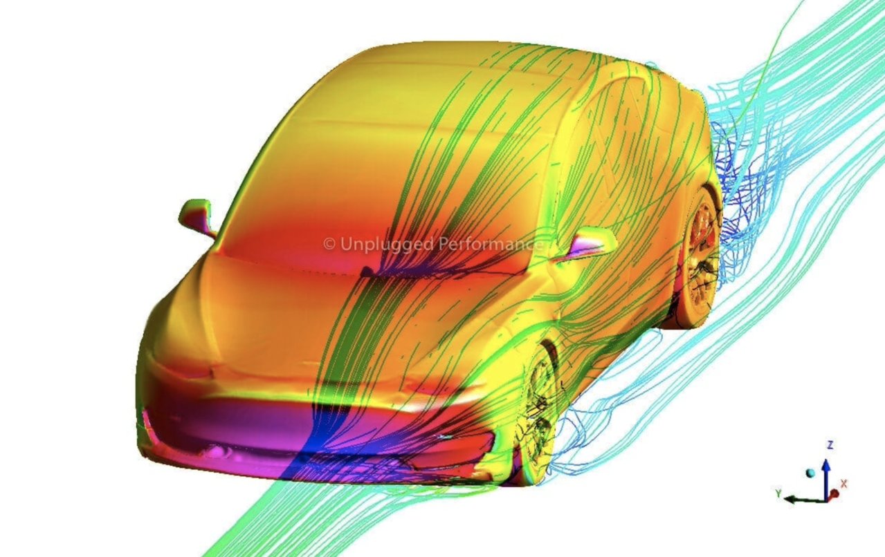

    Modding an EV for performance is a little different. Performance is often measured in power/weight ratios. In a conventional ICE vehicle, the focus is typically on adding power with various engine modifications. In an EV power is largely fixed, so instead weight reduction or efficiency improvements are key. If a vehicle is X-amount more efficient, that also means it is using that amount less power for a given speed and therefore has that much more power available on tap.
    The key to building a high performance EV is maximizing efficiency for power, performance and range. And if you are stuck in the past thinking efficiency is boring, you should ride in a sub-3 second car. EV mods require far more attention to detail and if you are like me, that makes it all the more interesting.
    The stock Performance 20" uberturbine wheels are heavy, not aerodynamically efficient and they also come with summer only tires. Far less than ideal. They were chosen for the low profile giving good cornering on summer performance tires.

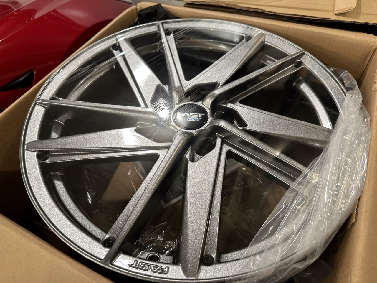

    Enter the FastEV EV01 flow formed wheels. Aftermarket Aero wheels designed to fit the Performance model while being even lighter than Tesla's aero wheels. 21lbs EV01 vs 23lbs for Tesla Aeros. The EV01 triangular covers are removable, FastEV claims a 4.4% efficiency improvement with the covers, similar to Tesla with the Aero covers. Wheels are also available in solid black. Additional article available here, manufacture site here. Long story short, range losses from the Performance models heavy non-aero wheels can be recovered to some extent with lighter more efficient wheels, which should also translate into even better performance.
    EV01s on a Model 3 Performance

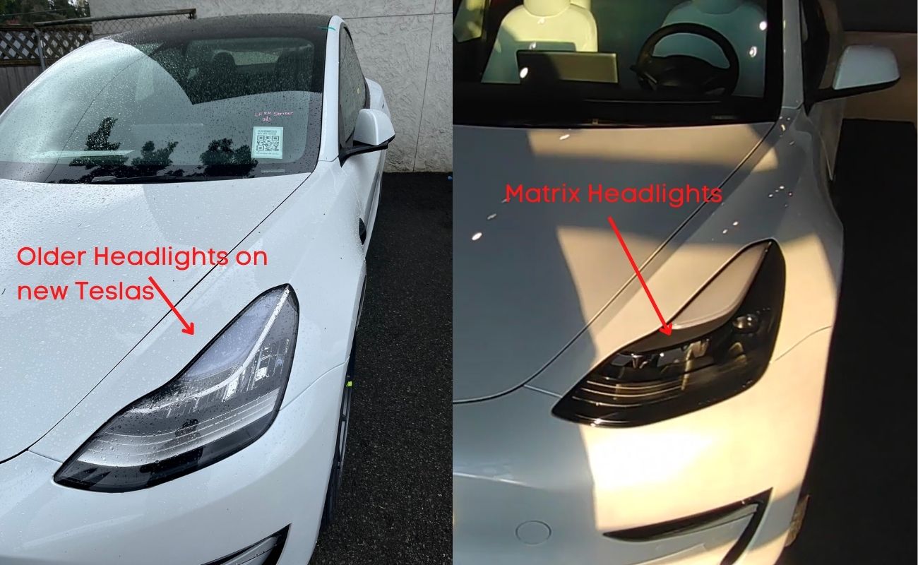

    The headlights
    In the 2021 refresh the Model 3 was equipped with Global Matrix LED headlights, previous models were equipped with reflector LED headlights. Matrix LED headlights were not approved by the NHTSA in the US until Feb of 2022. The cars had them prior to approval, but the matrix function was simply not enabled. The cars now just require a software update to enable the functionality. Matrix LED headlights allow full time high beams without blinding other motorists, making it one of the safest headlight technologies to date.
    https://youtu.be/xYSix5r38qY
    Mega thread on parts shortage causing the old reflector headlights to be subbed for the newer Matrix LED headlights in new cars.
    https://teslamotorsclub.com/tmc/threads/2022-q2-production-model-3-missing-matrix-headlights.265630/
    New has matrix projector on the outer edge
    Matrix headlight ability. Because.

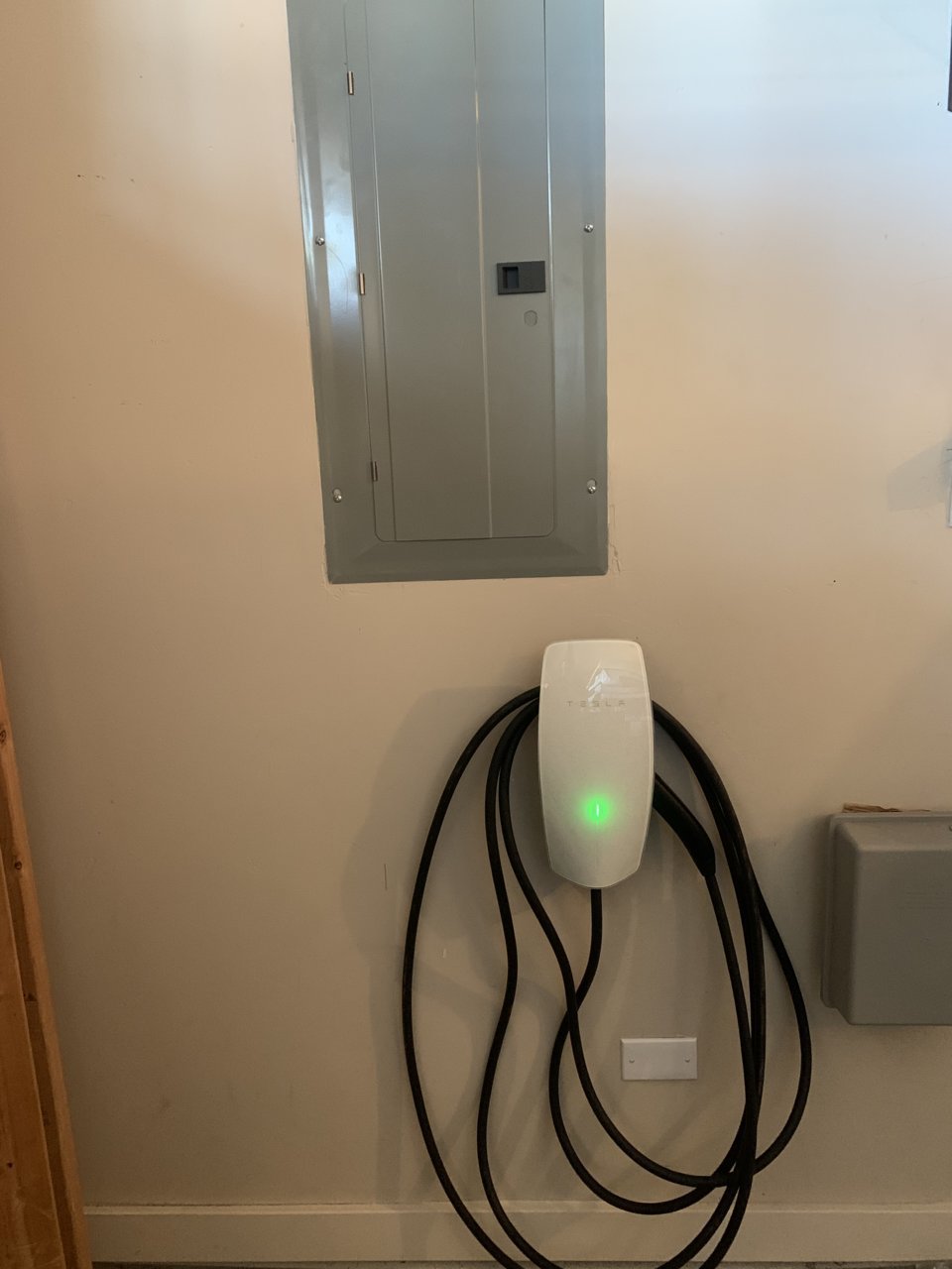

    The home wall charger is the highest speed form of at-home charging, permanently installed and mounted on your wall at home. It offers a 48A charge rate if you can have enough breakers in your box to supply it with a 60A circuit, otherwise is able to run at lower current levels. It offers a best in class 44 miles range in one hour of charging.

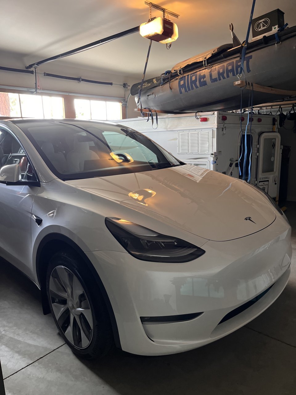

    Hells yah! Future car!
    We took delivery of a Model Y Long Range today. Test drove one in April, and it was like: this is a no-brainer….order one!
    Order date got pushed around a lot but once we got close I pulled the trigger on installing a wall charger. Took about an hour but was straightforward as I put it directly below the panel.
    Matrix headlights are wild! Pretty surprised when I saw they were packaged into our build. Was not expecting that.

    Are the matrix LEDs active? Last thing I heard (it's been awhile), the hardware was there but the software was yet to be released making them just regular headlights.

    Ultra efficient Fast EV01 wheels, 11lbs lighter than stock performance wheels (per wheel) and also more aerodynamically efficient with the aero plates installed. The color actually looks better than expected, but I'm going to get them refinished in a dark gunmetal to go with the black filler plates on the black and red themed Tesla.

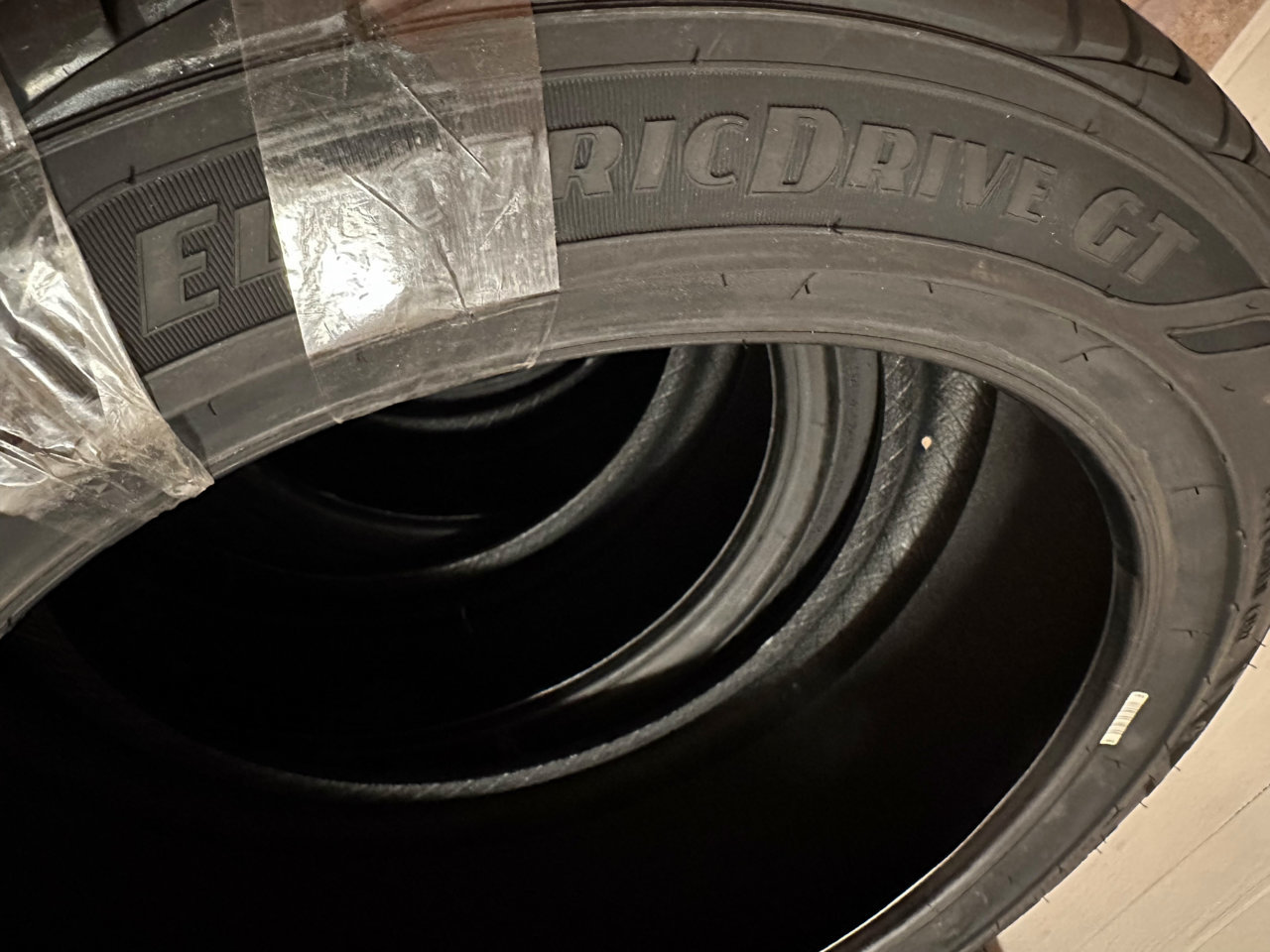

    The latest ultra high performance all season EV tire, Goodyears Electric Drive GT. The tire promises higher performance than the stock long range tires and better all season performance than the stock Performance model summer only tires that may crack under 45 degrees, while offering longer life without adding weight.

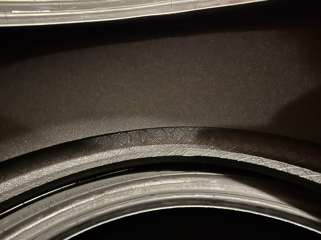

    The tires also have the OEM style noise reducing foam insulation inside the tire just like the stock long range tires. Because EVs are so quiet, many use OEM tires with road noise suppressing foam insulation. These tires promise all the performance benefits, while maintaining OEM or better design characteristics.

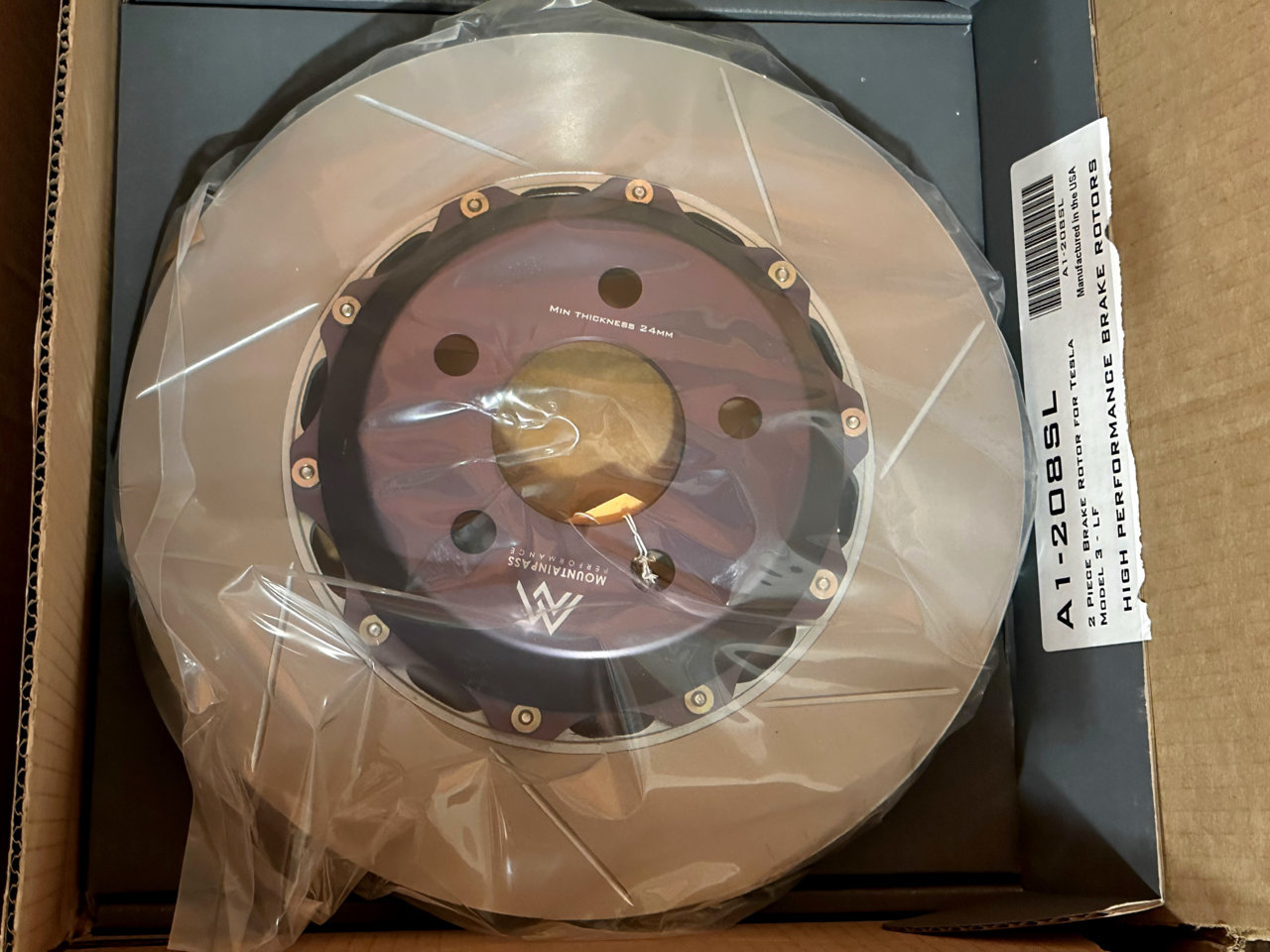

    New Mountain Pass Performance 2 piece slotted rotors with aluminum hats. These rotors reduce rotating mass 1.3lb per corner and increase braking capacity by 30% by using directional veins for greater thermal cooling capacity vs the stock straight vein rotor with steel hats. Performance rotors for front and rear, which will also add +4mm offset due to the thicker rotor hat.

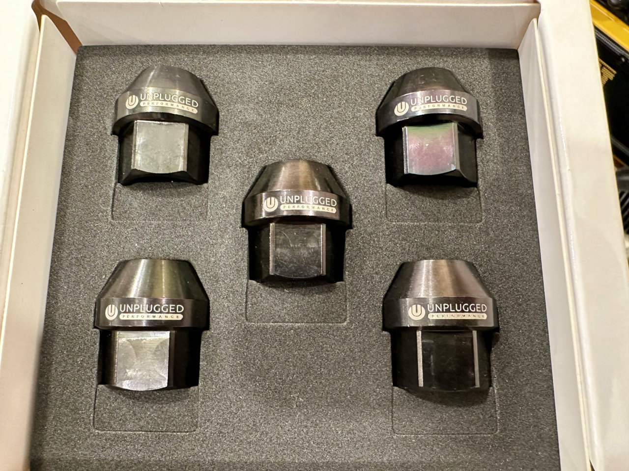

    Unplugged performance titanium lug nuts. Saves 0.5lb per corner.
    Since it isn't practically possible to add power to an EV, the next best thing is to remove weight. Rotating weight is by far the best type for removal, but it is very quickly a diminishing returns game in weight removal vs cost. For wheels, aerodynamic properties also matter if looking at range vs just acceleration.
    For the Model 3 Performance specifically, in the case of EV01 wheels, the wheels are different for the Performance model vs other models due to clearances on the brakes. The OEM performance rotors require extra clearance for mounting bolts to clear the wheels, so EV01 makes a high clearance version with more offset. However, if changing out the OEM brake discs later to new units that don't require that clearance and the rotors add even more offset, you may have to buy new wheels to pull them back in again, as you don't want the wheels sticking out in the airstream. Long story short, the brake rotor decision and wheel decision is really a package deal in this case, hence pulling the trigger on both vs staggering them.

    The matrix features are not yet active for road use. Tesla was installing matrix lights well before matrix functionality was approved for use in the US by the NHSTA, which happened this year. A couple other manufactures did the same. It should just need an over the air update to enable them. I am not aware of any other companies that have them enabled yet in the US either, traditional car companies would likely need to visit a dealer for an ECU update. I'd bet there is some regulatory compliance regulations they are jumping through.

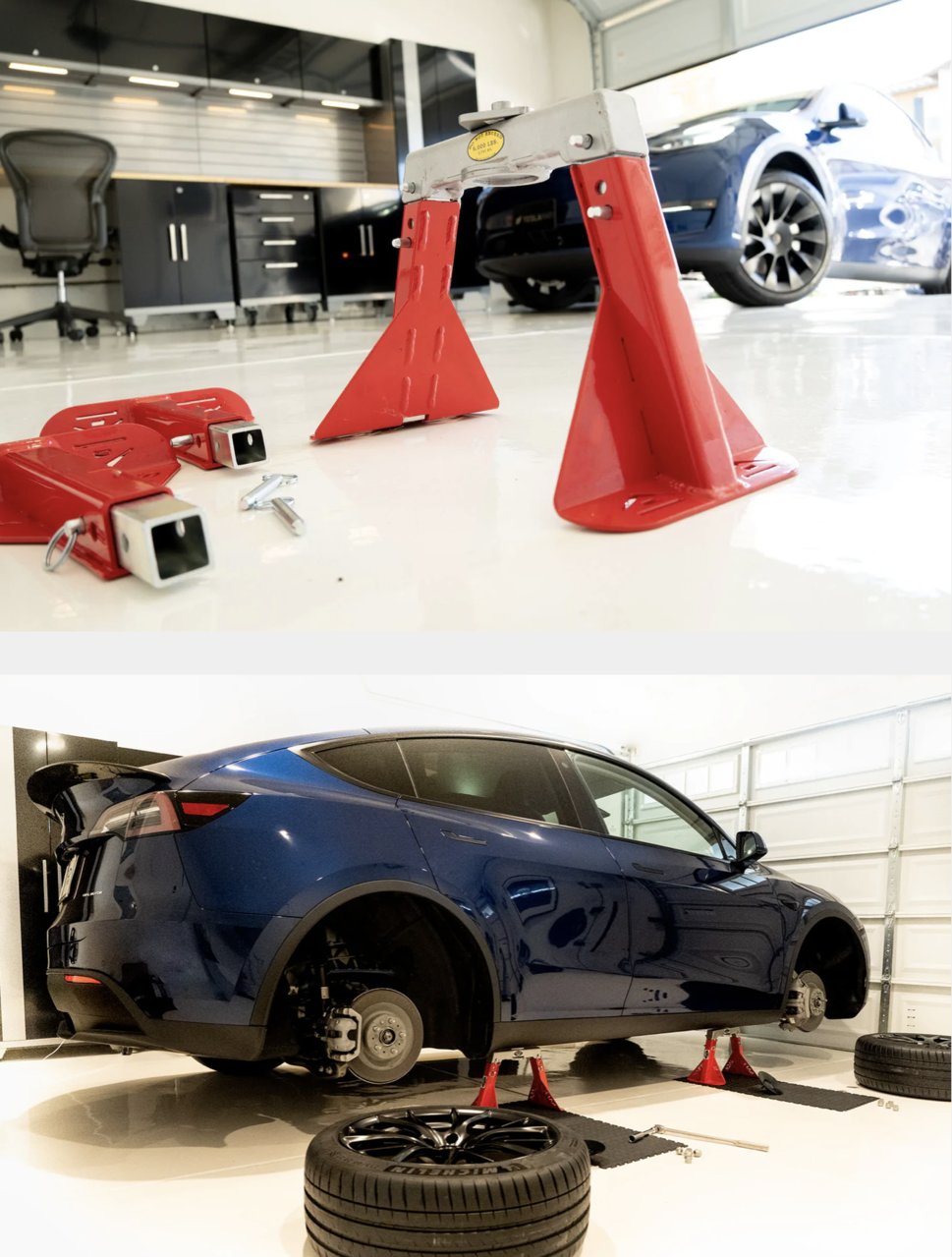

    Teslas have some quirks. From an engineering standpoint they are often impressively well thought out on par with aerospace tech, but from a practicality standpoint sometimes it gives pause. Case and point, lifting and supporting a Tesla. Being that the underside of the car is completely flat and a giant battery tray, you are only supposed to lift and support from 4 very specific jack points. Traditional jack stands designed for pinch welds are not usable. But this the begs the problem, how are you supposed to lift the car and then place a jack under the car at the exact same point?
    Specialty designed collapsible jacks of course. Jack the car up using the crossbar and then add the legs once up to height. Apparently Porsche uses the same ones.
    Video:
    https://www.youtube.com/watch?v=Pje1TQGJpyw&t=44s
    These are not free. There are a couple brands and designs out there, but I found these to be the best price and value IMO and also made in the USA.
    https://shop.teslarati.com/products...ABwRNARwJQ0TpsycHUZ0II1DmGCTn_wkaAgwYEALw_wcB
    Using a coupon code: I1TESLA also saved me a few dollars. No idea where that is from, just some google-foo.
    Of course seems completely ridiculous in cost vs the jack stands I use for my Tacoma. However if you are going to do it, do it right. Don't take shortcuts to save minor amounts of money relative to the risk of damaging your super expensive purchase.

    Foam is noise suppression only. Agreed that if you are regularly in the mountains, picking up a spare might not be a bad idea for peace of mind. The jack issue isn't an issue for a jack, it is an issue for jack stands when you want to transfer the car off the jack to a jack stand, which you wouldn't do on a roadside tire swap. You will need lift pucks to plug into the jack point to use a standard jack with. I plan on getting a set to keep in the car. The jack point is a hole, you need a puck to inset into the hole and provide a lift puck surface to use as a jack point.
