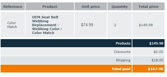

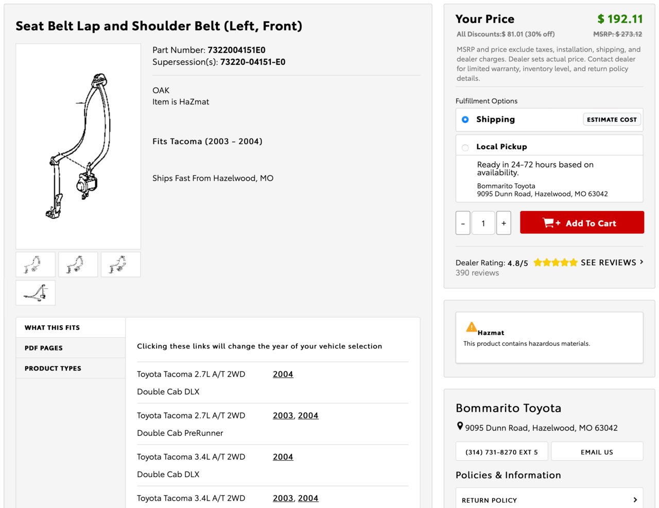

    My front driver seatbelt is badly frayed on the lower belt edge making sliding the belt buckle not smooth and the belt doesn't retract well, sometimes getting closed hanging out the door. I finally got around to ordering a new one. Somewhat tricky to locate the correct part number as different years of 1st Gens have different part numbers as well as different cab configurations and different colors. Even the same 01-04 facelift doesn't have the same part number, 03-04 is different per Toyota than 01-02. The belts are also labeled as containing hazardous materials, so many places charge a hefty surcharge on the shipping. This dealer did not, and had a coupon for free shipping.
    I ordered from here.
    03-04 Double cab, front left, in Oak
    PN: 7322004151E0

    A bit too late but you do know about safetyrestore, yes?
    I had my '02 Tundra belts done, very nice now.
  5. Jun 15, 2022 at 4:14 PM

    Interesting, I had not. However between having to replace the frayed webbing and fix the retractor, it looks like the cost is about the same as a new OEM part.

    Cost for me for 2 belts was less than what I see above, though maybe I skimmed too fast?

    Hmm, when I clicked though it, it was $99 for the belt replacement plus $99 for the retractor replacement. Even if the belt was $75 for replacement and retractors were $99, I'd still pay a little more for a new OEM Toyota part.

    I got pretty confusing replies from those guys on these details but from what I was able to decipher, pay once and they fix everything?
    The belts on mind did not retract well either but I think some/most/all of that is the webbing itself rather than the retractor mechanism? And/or they can just replace a spring or some internal piece to refurbish that?
    I agree new is always nice and if the other 3 belts are good then you're set but if you needed to do 4 belts it would get spendy. Also kind of fun to have the option of changing colors, but I wimped out and went color match on mine.

    I did find those OEM belts almost $10 cheaper, but it was east coast vs west coast and I didn't want to wait on the extra shipping time.

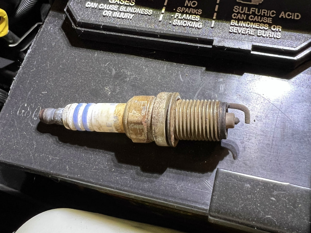

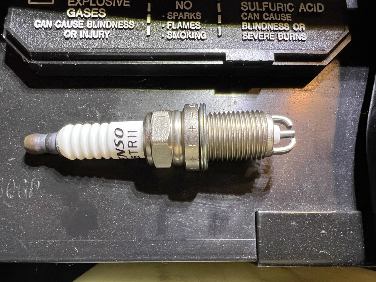

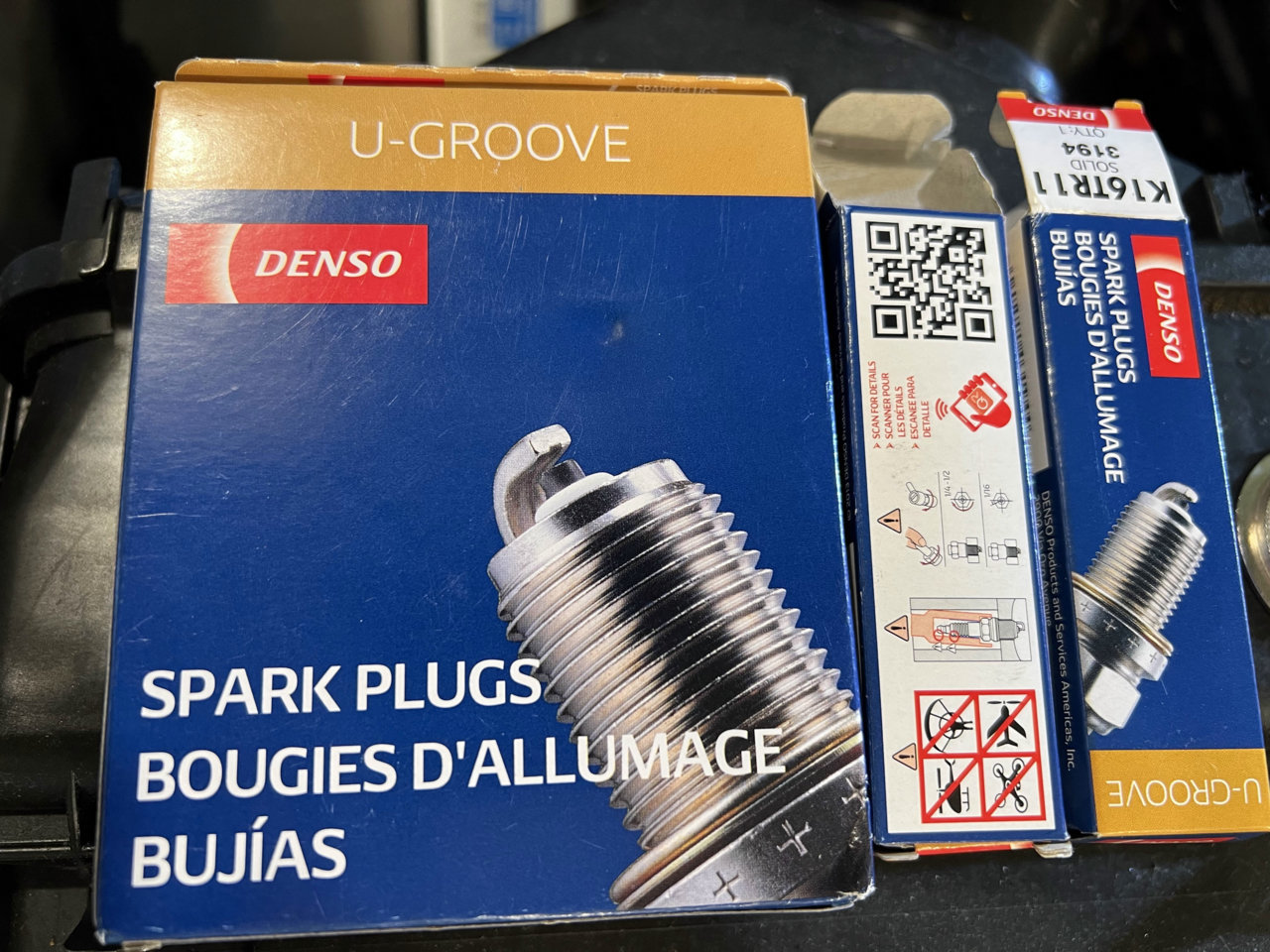

    Swapped the plugs today and changed the oil. The 1st Gen 3.4s came with both Denso and NGK plugs. Toyota seems to have favored the Denso K16TR11 as the preferred replacement plug, so I went that route for replacement. With over 200k on the truck, I figured plug replacement was needed to set a known baseline. I ordered my Denso K16TR11 through my local autoparts store for next day pickup.
    The plug is a dual prong pre-gapped .044" plug. It is worth noting the 3.4L operates on a wasted spark system, meaning with only 3 coils the plug fire in both the ignition cycle and also in the exhaust cycle. So the plugs fire 2x that over a standard plug, hence it would make sense to have 2x the ground electrodes to last twice as long, since the plug will see 2x the wear with how the system is designed.
    New OEM Denso K16TR11
    This is what was removed from the truck, Bosch Platinum singles.

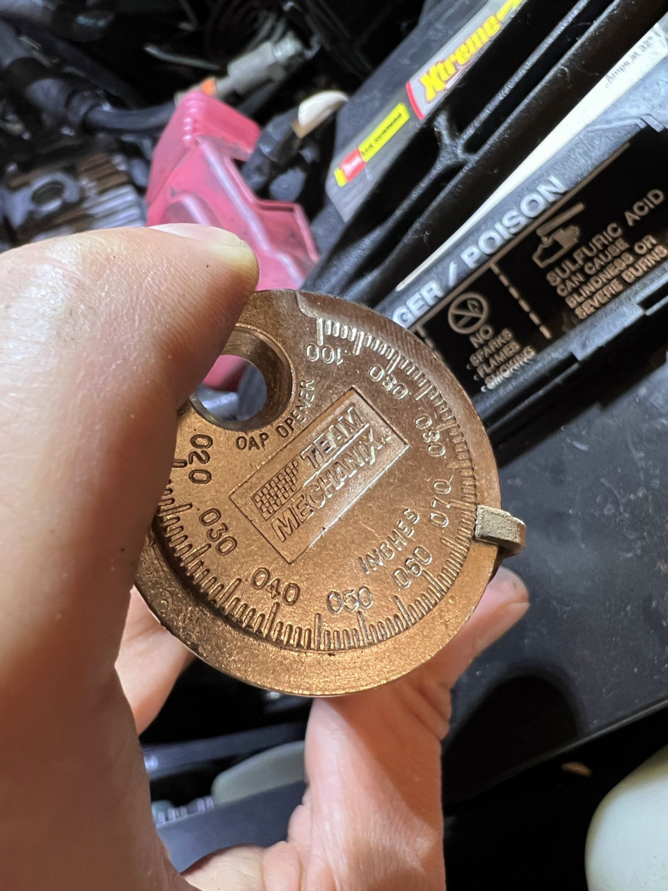

    Checking the Bosch gap vs the .044 spec
    Wow. Nearly .070. So horrifically off spec. And yet the Tacoma idled flawlessly. After seeing how bad these plugs were I am just amazed the truck ran as well as it did.

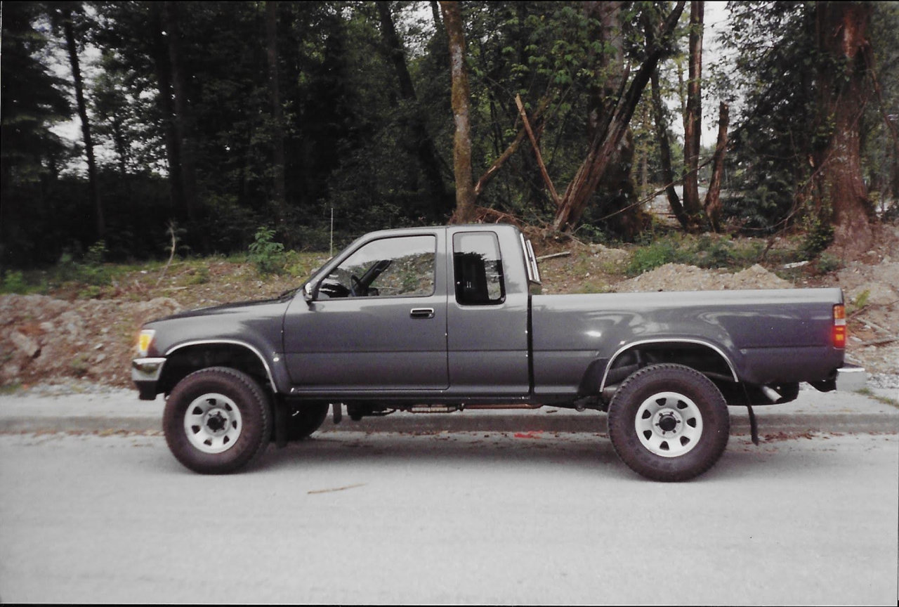

    The 3.0s were not great, in that generation you definitely wanted the 2.4. I had a mint 94 22re manual that I loved where everything was manual (hubs, windows, locks), the truck was great. I liked the old wing windows. Bought it with less than 100k miles from the original owner who was too old to drive it anymore. It fell victim to the same cause as yours, couldn't fit a carseat in the back.

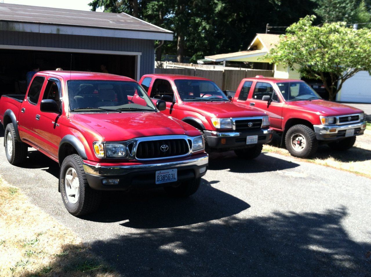

    One more for nostalgia. My 2003, brother’s 1998 and my 1994, all in red for a moving party.

    The seatbelt I had ordered could not be shipped due to hazardous materials (aka explosive charge) so I reordered through a local dealer and picked that up today in person as well.
