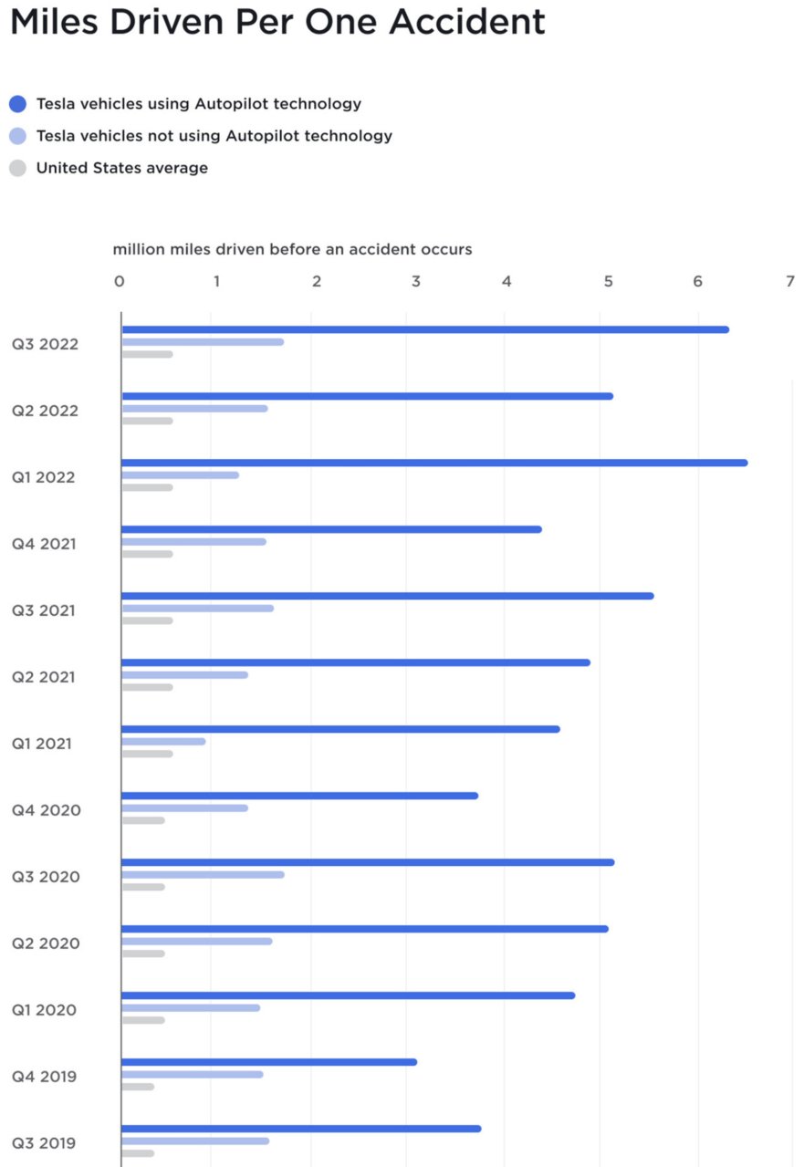

    As much as people might not want to hear it, Tesla's autonomous driving is statistically far safer than people driving, by a huge margin. Autonomous technology doesn't get tired, it doesn't get distracted, it doesn't have delayed reaction time, it is looking in 8+ directions all at once at all times vs your limited ability to look one. There are certainly still areas for improvement but data overwhelmingly supports autonomous driving.
    https://www.tesla.com/VehicleSafetyReport
    To put that in perspective, 6 million miles per accident with autonomous driving divided by the pre-covid average of 15k miles driven per year means the average driver would experience an accident once every 400 years.

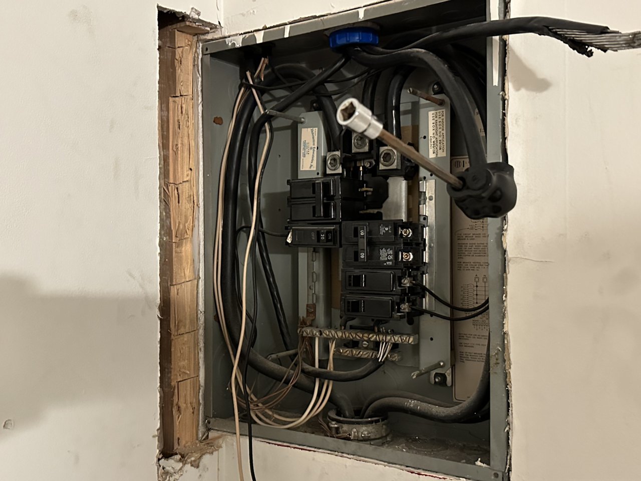

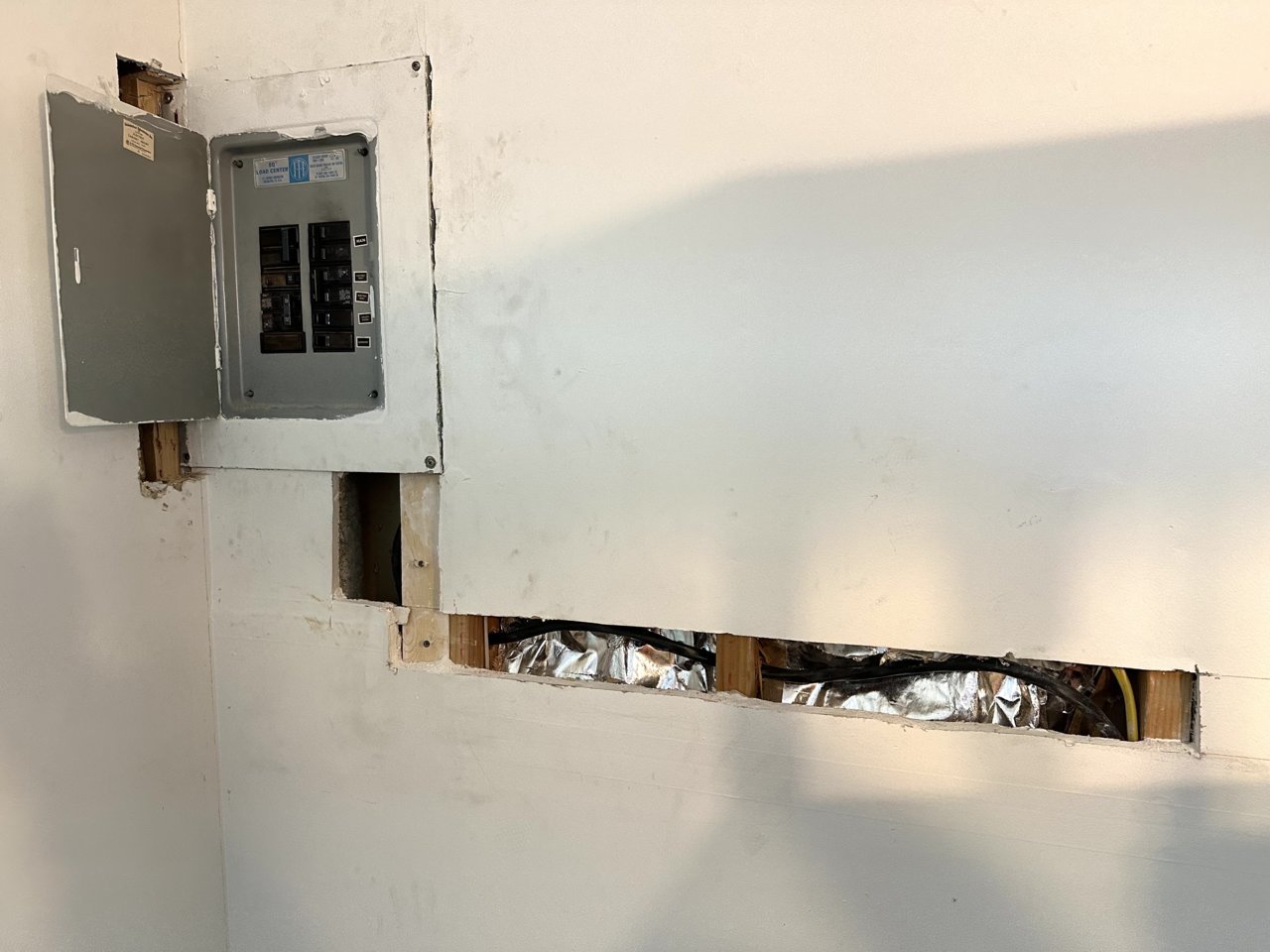

    First the breaker panel cannot be removed to access the internals required to add the new charge circuit because the panel is drywalled into place on one side. The panel is in a large 5'x10' storage closet. When I bought the house, the outer wall of the storage closet was unfinished and there was no lighting or electrical in the closet. I finished the outer wall and ran electrical off a line from the unfinished wall. So I thought to myself, I'm am idiot for drywalling this panel into place 13+ years ago. So I cut out the drywall thinking it would be a quick fix to access the panel screws and remove it. But it wasn't. It was framed into place as well with a stud blocking access to the panel screws. I did not frame the outer wall as it already had framing and insulation, so I didn't feel as bad about the situation, but now it was still more of a PITA. Ended up using a multi-tool to cut and chisel enough of the stud away to free the panel.
    Ok, the panel is free.

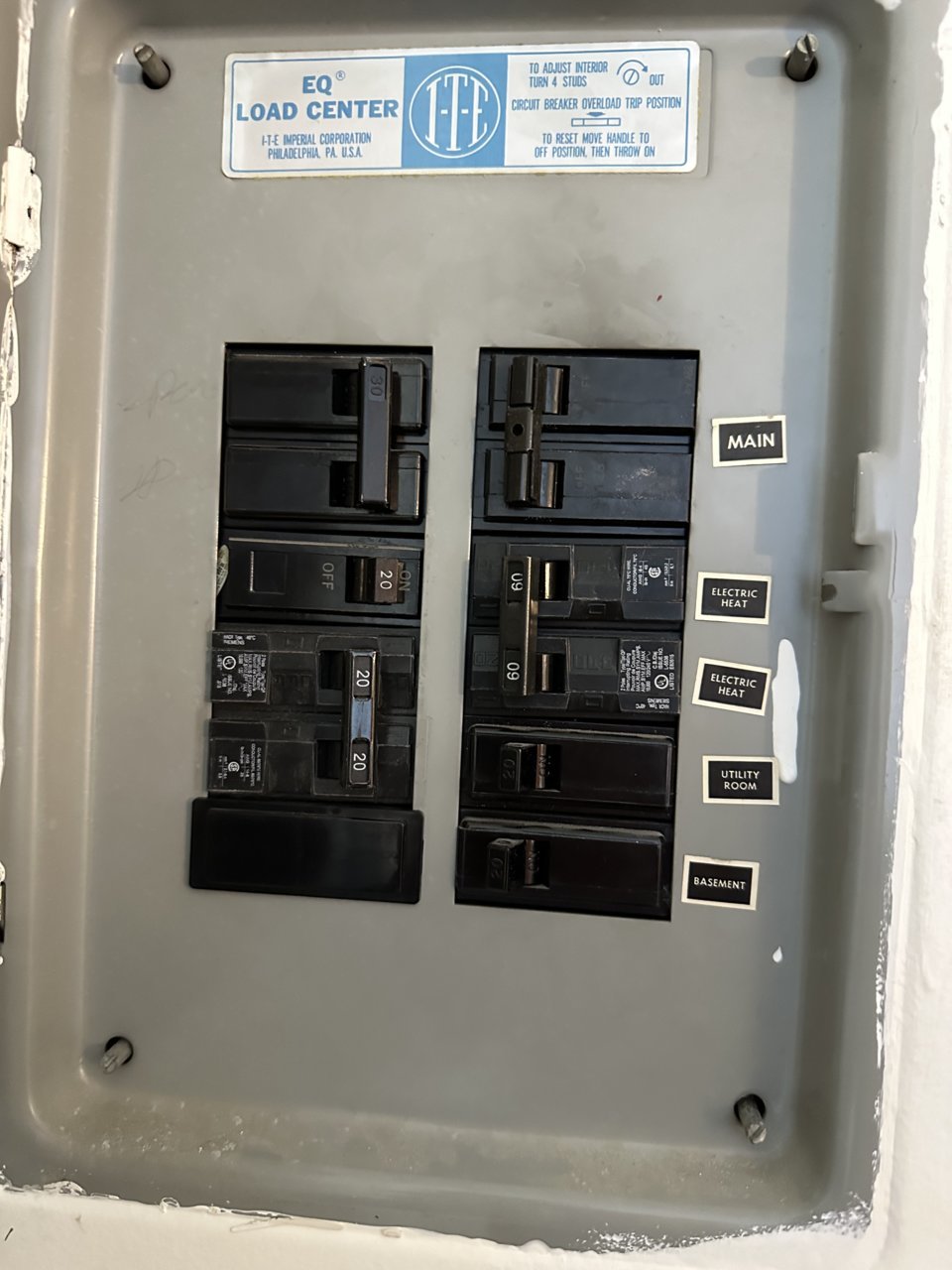

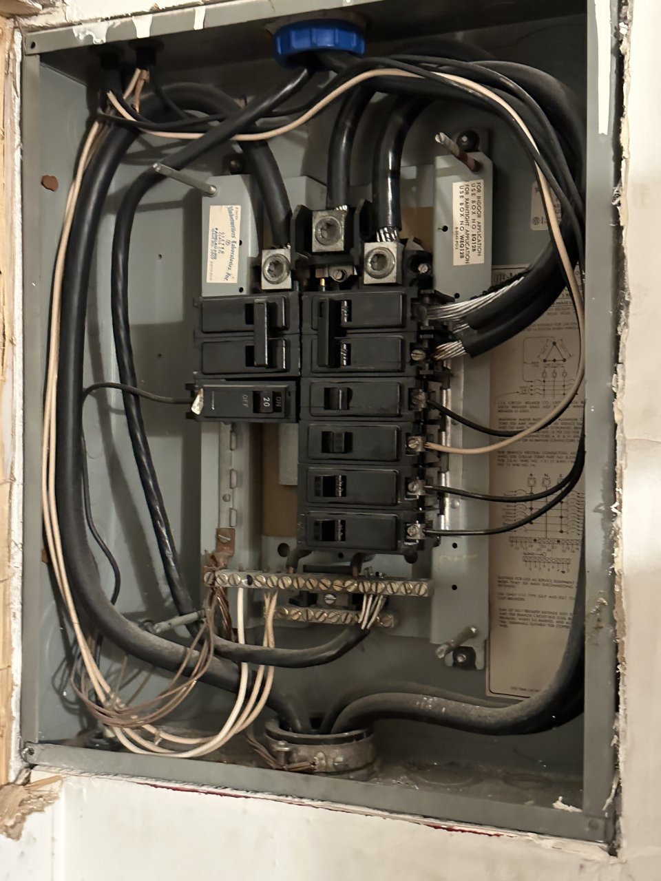

    Open it up and the first words out of the electricians mouth... "Holy Shit!"

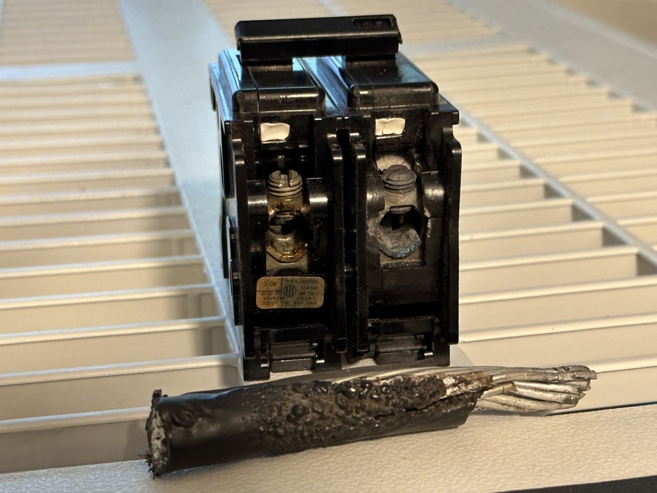

    While the 1972 house is copper wired, the panel used aluminum to go from the main with a 125A breaker to a sub-panel. Aluminum wiring does not do well with high heat, and expands and contracts more than copper. The aluminum sub-mains to the sub panel had expanded and contracted enough they were physically lose and had burned through the protective sheathing, burned though multiple strands causing the wires to separate and nearly arc the positive and negative wires on a 125A breaker, separated only by millimeters.
    So the damaged breaker and wires were removed.
    The fix is to cut off the damaged portion of the wire and put it into an aluminum to copper conversion coupler, the coupler then feeds copper into the breaker. Aluminum isn't as much of an issue with a very strong connection point, stronger than a breaker can provide. So by using a strong coupler and then having the coupler feed copper into the weaker breaker, the problem is eliminated. Shown with the 60A breaker installed, but not yet connected to the coupler copper feeds.

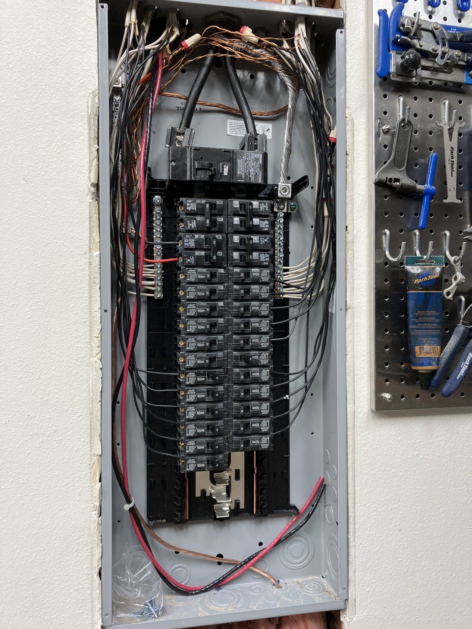

    Panel buttoned up with 60A breaker installed. The L2 60A circuit is installed where my electric heat (unused basement baseboards) were previously installed. The 3 story house has a gas forced air furnace on the main floor, but doesn't do so well blowing heat to the basement where the baseboards are installed. The broken 2 25A switches for electric heat were replaced with a double 20A.

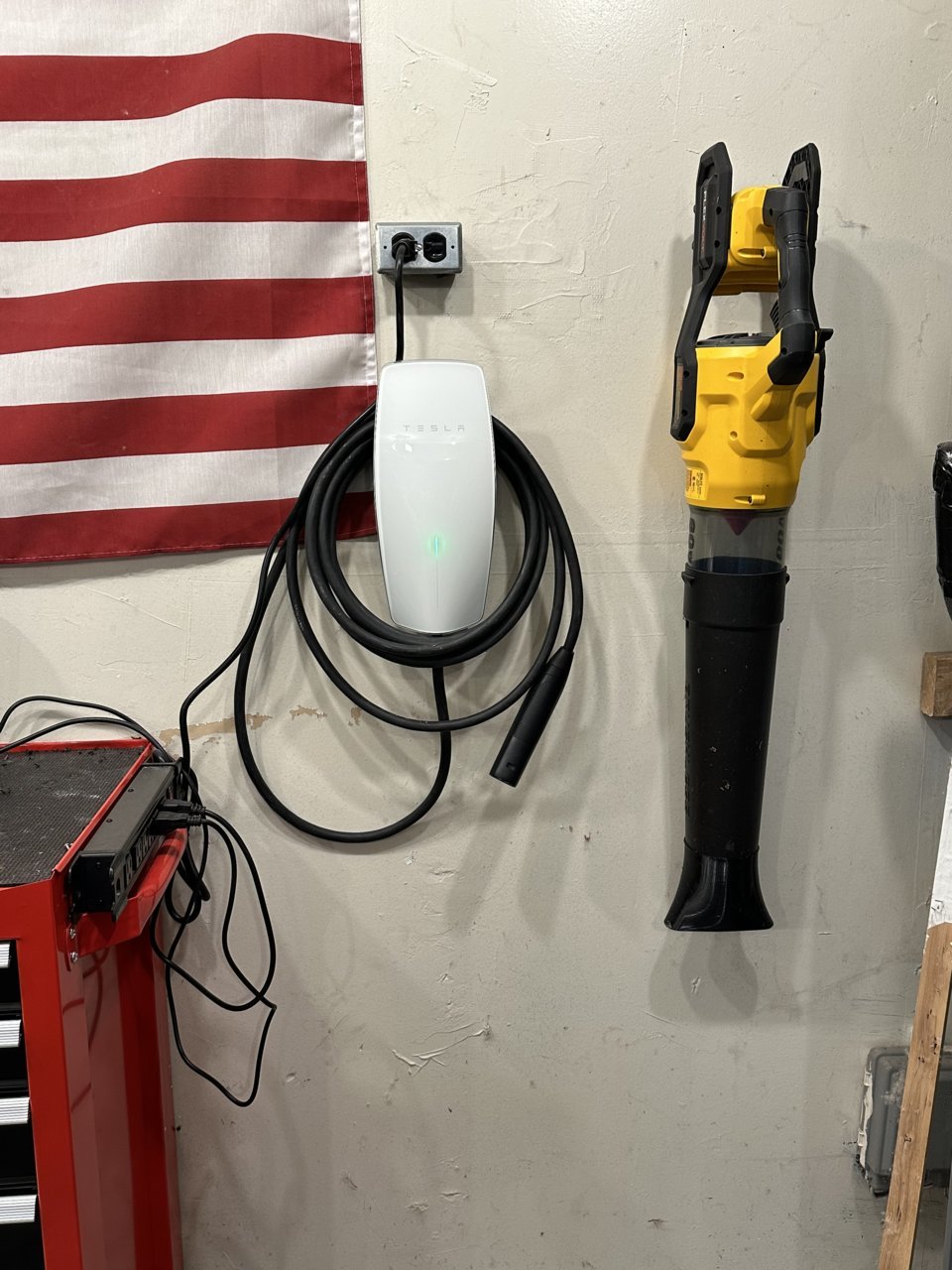

    The panel is on the back side of the garage wall, making for a pretty short wiring run.IMG_0910.jpg

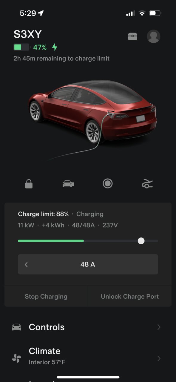

    48A charge speed at 11kW+ is incredible compared to the 1-2kW 110v mobile charger. There is a fixed base overhead in heating the battery for charging, so while the 48A charge is 3x of my 16A mobile charge you end up with substantially quicker and more efficient charging at the higher charge rates.
    While I certainly felt some minor home charging pain points using standard 110v outlets and having to think ahead for charging and use needs (which were completely manageable), these charge speeds are downright comical for home use. In total I paid $700 for install from a licensed electrician via family connection, as a cash side-gig. The charger was $400 ordered in 9/22. The install was supposed to be simpler, but ended up being more complex with panel repairs replacing unplanned parts.

    It is actually 4/3 to the wall charger. 4 adds a nice buffer in capacity well over the max of the 60A circuit breaker, even though the Tesla charger will peak at 48A. It was wired with 3 pole, even though the Tesla charger only requires 2 pole, as future proofing. Other EV chargers like Ford's require 3 pole, or if it were desired to be changed out to a NEMA 14-50 240v plug in the future it would require a 3 pole. I of course do not plan on these things, but the electrician said he always likes to do his installs to allow for flexibility in the future vs people having to do lots of electrical rework. Good for resale I suppose as it can handle any EV charger now vs possibly just Tesla if installed with 2 pole. I appreciate the approach as I didn't specify any of these things.
    Agreed on the contractor commissioning. This was actually my 4th one. First 2 never showed, I text pictures of the panel and what not. One gave me a $1700 quote without seeing it in person. One contractor came and looked, then basically said a ball park figure I should expect to pay but the job was small and he didn't have the time to do it. As much as I am a DIYer and have run electrical off existing circuits in the past, I'll admit this was over my head. Definitely fortunate for the family friend hook-up with how things ended up playing out, very happy with the results.
