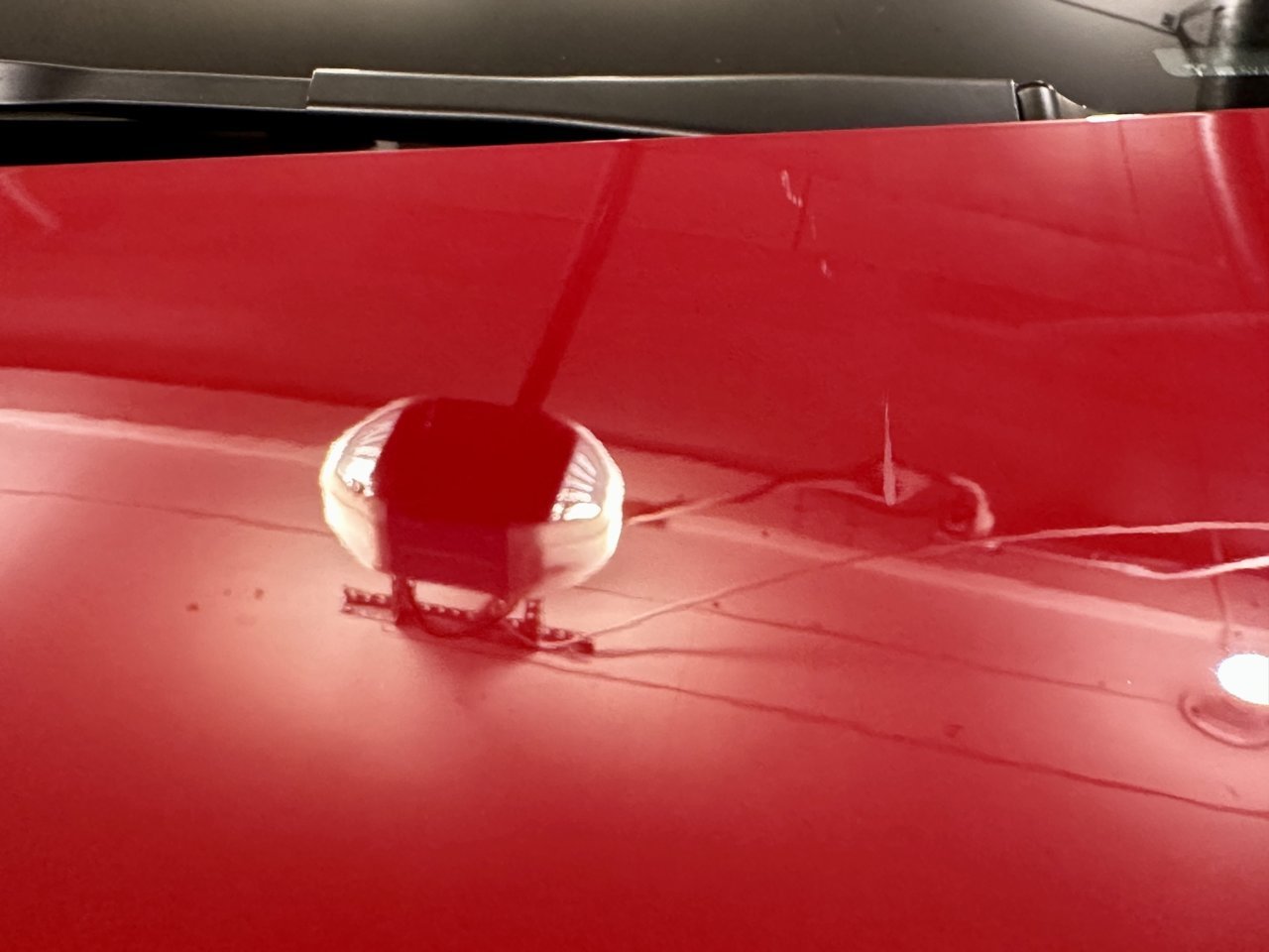

    It is dented. Small, but visibly dented and viewable from the driver seat. I will never be able to un-see it.

    The paint appears damaged too. I tried to wash it on the way home but car washes are closed with the recent below freezing temps. I spot cleaned it to evaluate. I’m pretty good at buffing out scratches, but IDK, it’s not light. Seems like one of those things that is going to be boarder-line to claim. Pretty annoyed by the series of events.

    I heated the garage overnight to a nice 65 degrees F and attempted to buff the damage out/down this morning. It’s not gonna happen. This is definitely a paint repair. Sigh. I’ll take it by the body shop I used for repairs on the Gladiator (with the crunched bedside and dented hood) next week for an estimate. Their work was impressive and reasonably priced.

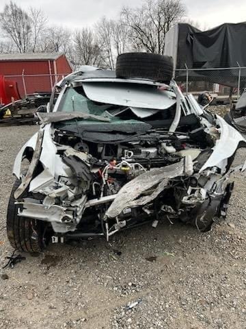

    Shared in another model 3 group. 85mph crash and roll after a truck lost a piece of equipment off the back on the highway, driver swerved hit a drainage ditch flipped and rolled. The driver had to be cut out of the wreckage. He survived with a few broken ribs and a pelvis injury and shared the photos.
    Looking at the impact to the B-pillar, the structural battery pack was no doubt a literal life saver.

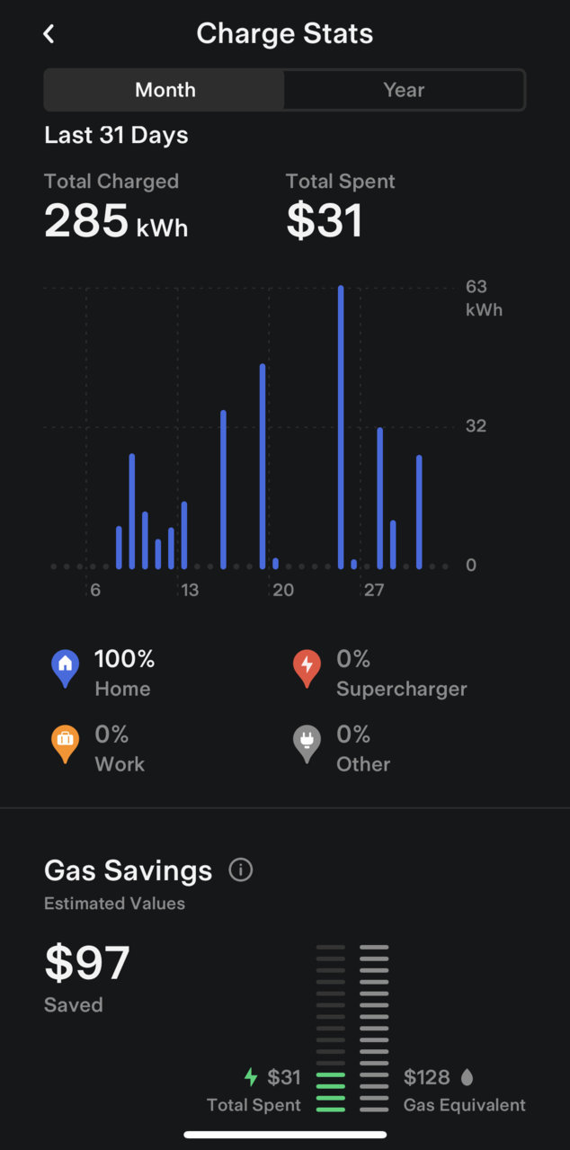

    I am a complete data junkie. I always want all the raw measured data, it is far better than any anecdotal opinion. Admittedly I obsess over data way too much (fault of an engineer), but. Just look how cool this is!
    Here is my Tesla app charge data for the last 31 days. What is interesting is the wall charger was installed on the 16th, at which point you can see I go from nearly daily charging on 110v to much longer breaks between charging as I am able to comfortably run the battery lower and very rapidly recharge it in a matter of a few hours with the wall charger, allowing less frequent charging. I was out of town ~30 days ago with the Tacoma hence the no charge data at the beginning of the chart.
    For most users this data is plenty.

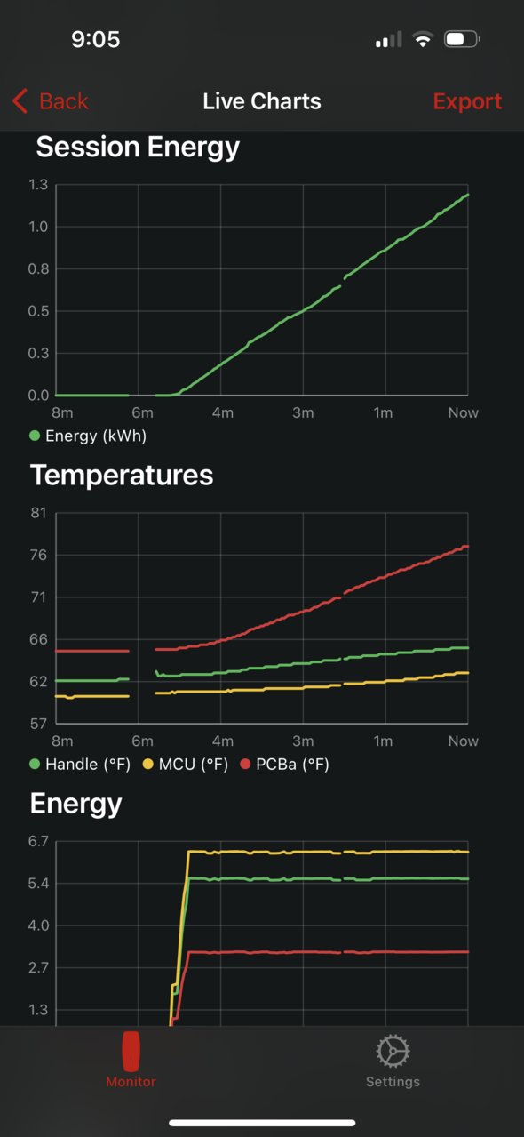

    But. What if you had access to ALL the raw data? Enter the Wall Monitor app that links to the Wall Charger and provides the raw data.
    Way easier to monitor the wall charger than using the IP address for access as well. The app provides ridiculous amounts of data, though admittedly most won't find it useful. Live data charts cost a one time $9 purchase price. Raw charger data also shows the charger pulls more than the Tesla app specifies. I also like that you can export the data to a .csv file. You can also check the firmware version, version adoption rates, release notes and more. It makes many features and raw data easily accessible, that otherwise would be very limited by going to a specific IP address to access the charger for only the most basic info.
    If should be noted when setting up in the Wall Monitor app, it will ask for the local IP. This is not the wifi IP used in setup, but the IP assigned on your local network. You should look for the wall charger in your router connections to find the IP address for the app.

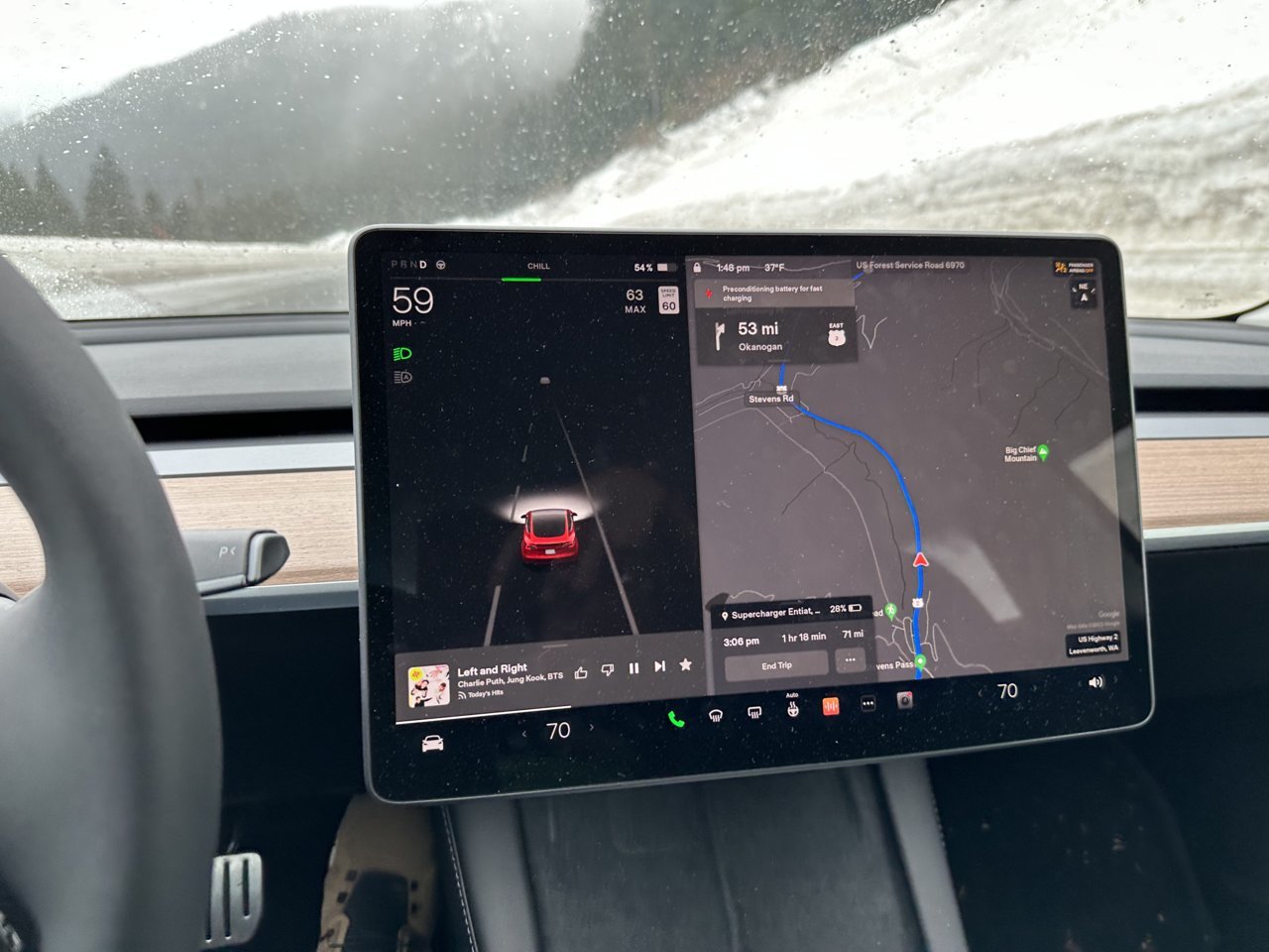

    Took the Tesla on a week long trip with no dedicated charge point outside the first two nights at the parents place using a 12A plug. Hit up the supercharger in Entiat outside of Chelan to charge for 30% to 65% then top off with 110v at the parents place. Surprisingly the supercharger started preconditioning turned on about 1 hour 25 minutes before reaching the supercharger. it later switched off and switched on again closer to the supercharger destination.
    I can of course hit up the supercharger leaving town, but my goal will be to use all the free chargers on ChargePoint to leave with a full 90% charge on the way out for a trip back over the pass without supercharging.

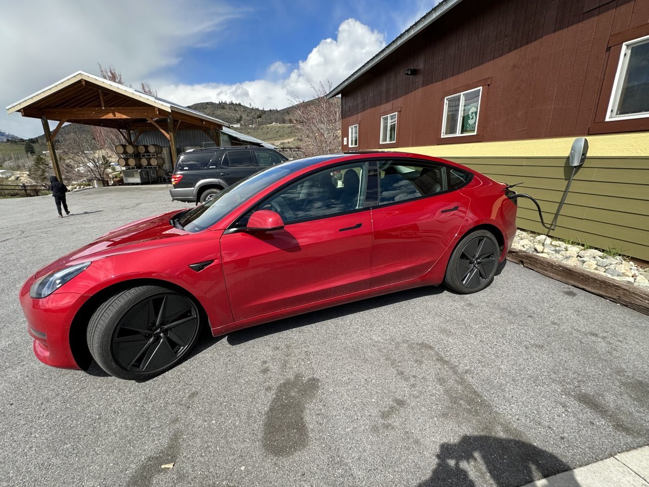

    Free 11kw charging at Hard Row to Hoe winery.

    Came back home across the passes on Sunday, left with the car at 88% and made it home with 28%. Always fun to go down the passes and see the cars battery percentage pick up a few points from regen as you go. Saw a model Y towing a small RV trailer at the supercharger station as we drove by but did not stop. Relying primarily on free charging was all a non-issue on the trip, even with the car parked outside in the mid-30s for the week with Sentry mode left on.
    Tesla also just recently pushed an update bringing back the option to vent windows from the app or auto close when locking the car. This feature existed before but was removed due to the NHSTA forcing a recall over the safety of the feature. I haven't seen anything from Tesla stating what the safety improvements changes were that allowed for the features return, but it will be nice to have going into summer.
