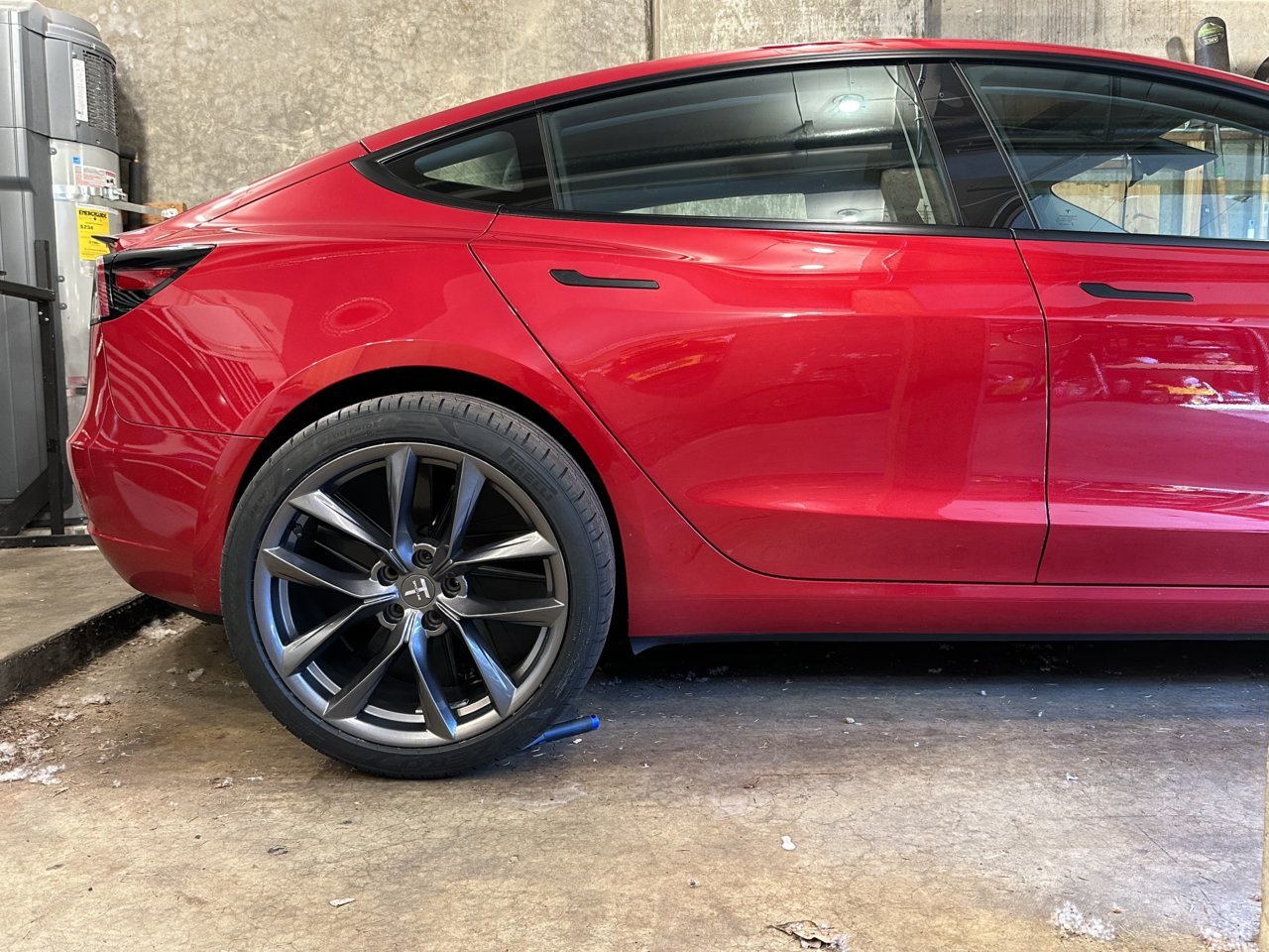

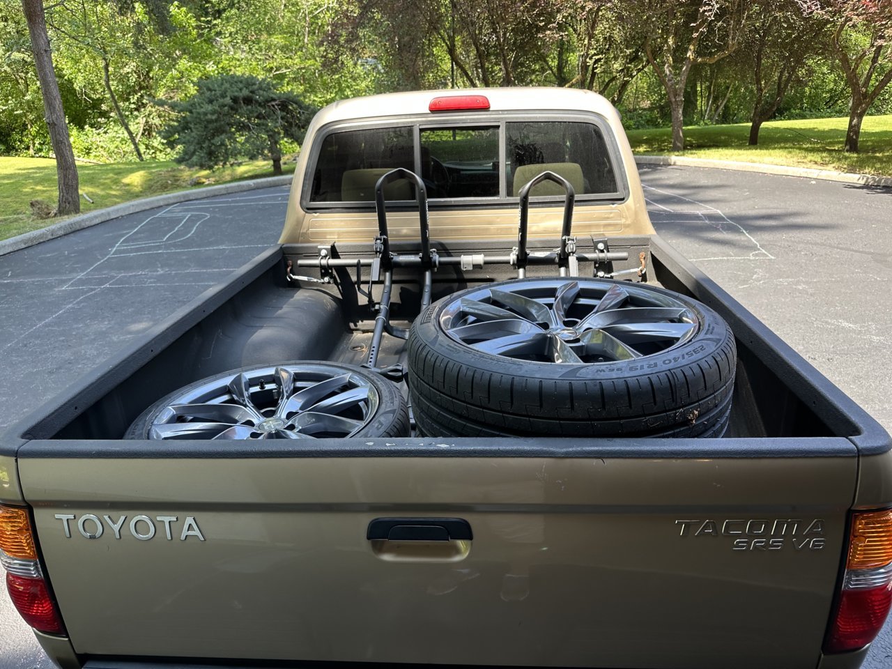

    Got the new wheel tire combo mounted and balanced today. Waiting to hear from Tesla on body repair estimates before mounting. Looking forward to seeing how this looks.

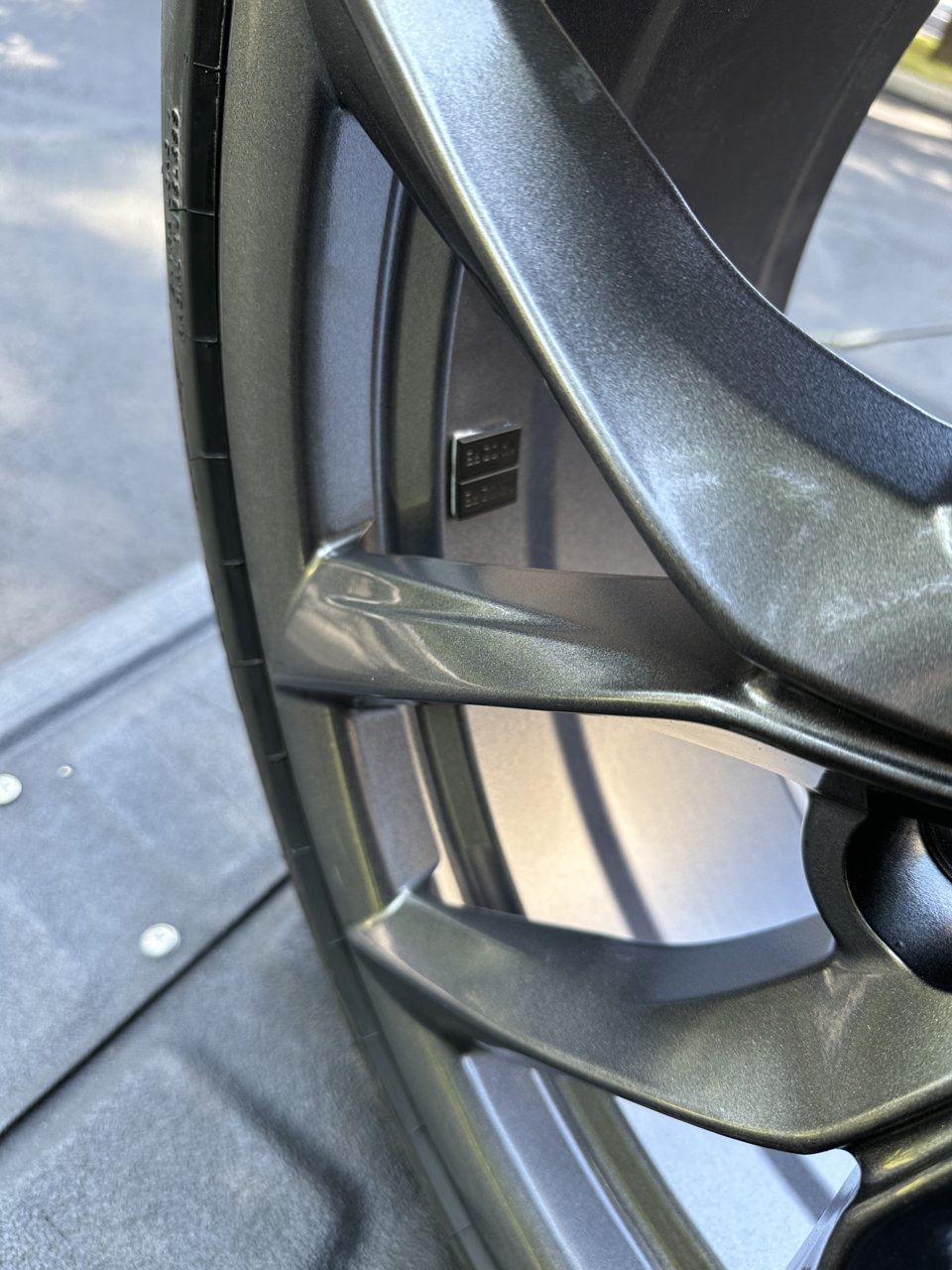

    Umm, no. These are going back to the tire shop Monday. On 3 of the 4 wheels they put the weights on the outer face of the wheel, in between the spokes. And on 2 wheels they used bright chrome weights, 2 they used black. Unacceptable.

    I was a Karen today and took the wheels back to the tire shop. Chrome wheel weights were replaced with a much more subtle black. Still no word from Tesla on the repair estimate, and I'm pretty antsy to get these on so I may just mount them later today.

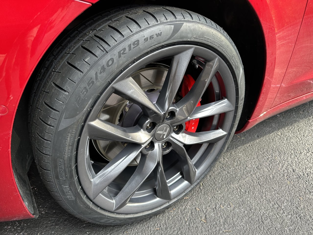

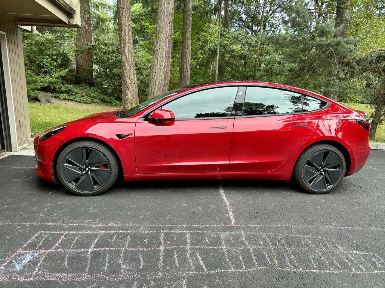

    Before
    After
    New wheels push out +5mm, which looks better.
    Specs:
    23.7lb 19x8.5” +35 Tsportline wheels
    24lb 235/40R19 Pirelli Pzero PX4 elect tires
    47.7 lbs combined
    Stock
    32lb 20x9” +34 Uberturbines
    23lb 235/35R20 Pirelli Pzero PX4 elect tires
    55lbs combined
    Previous setup
    26lb 19x8.5” +40 Fast EV01 wheels
    27lb 235/40R19 Goodyear Electric Drive GT
    53lbs combined
    Plus 2lbs savings from Gyro Disc 2 piece rotors.
    1.2lb savings from Unplugged Performance titanium lug nuts.
    46.9lb/corner average with brakes/lugs on new setup.
    32.4lbs of rotating weight removed.
    8.1lbs/corner savings vs stock.
    I chose these because they look stock-like for Tesla and are light weight. Many lighter wheel options look very pencil like with thin spokes, which doesn’t look right on a Tesla IMO. These wheels are replicas of the Model S Arachnid wheels, but in a smaller size for the 3, meaning it is a Tesla cosmetic design. The wheels are Flow Forged, which provides added strength over basic casting and allows for reduced weight without the high cost of Forging (also not as light or strong as forging). The wheels are space grey, I do wish they were a touch darker like the Uberturbines, but it is acceptable. The Tsportsline center caps will be replaced.
    19” size was chosen to balance looks, performance, weight and durability. Pothole flats on the 35 sidewall of the 20s are common, which is really inconvenient on a car with no spare. 18s had diminishing weight savings, don’t like the look as much and these Pirellis are not available in the 18” size in the Elect tire version, just the standard version.

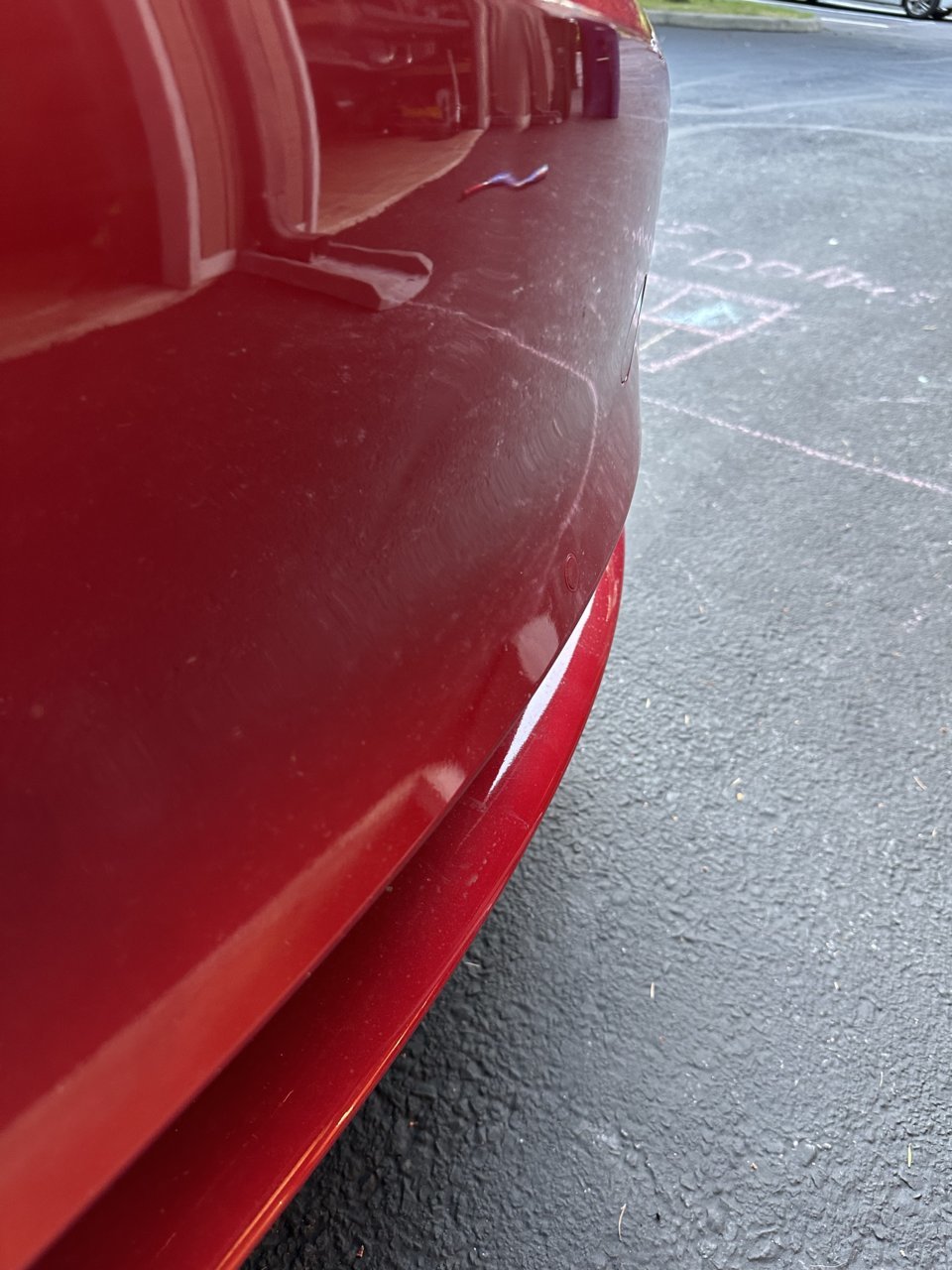

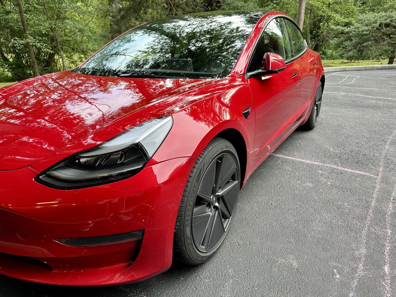

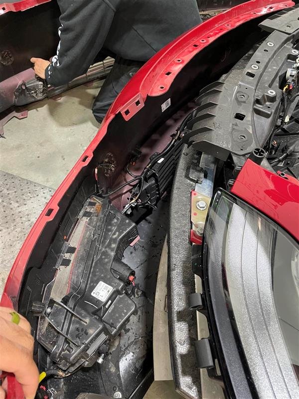

    Estimate for the bumper repair came back from Tesla for $2029, which includes a new bumper. The estimate includes a bunch of photos, I thought this was interesting, that foam bumper piece is so small.
    I asked for the hood repair to be separated, since I’ll be paying for that one, I’m still waiting to receive the hood estimate.
    The Tesla also has an unrelated passenger side DRL failure, where part of the DRL is now reduced output and color shifted to ~3500k instead of ~6000k. Talking to the Tesla rep they said it could be warrantied out at the same time as the body repair, which is convenient vs making a separate warranty apt.
    You can see the dent/crease in the bumper from the impact. It is really hard to photograph, but look at the distortion in the little league bat.

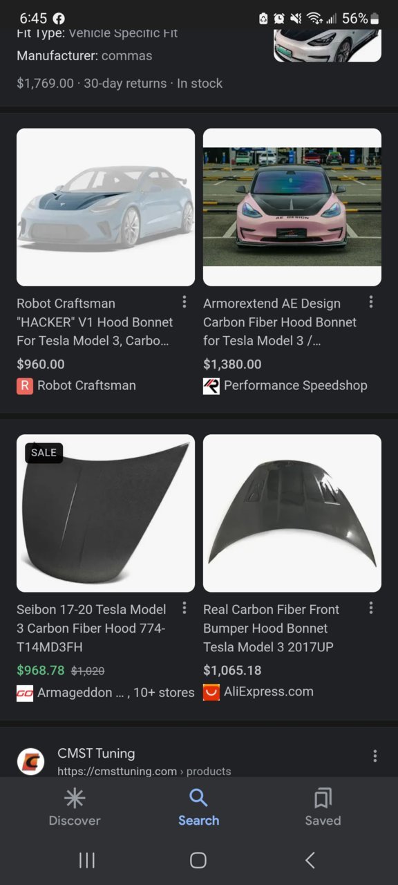

    The bumper itself was about $500, the rest is paint and install. I'm also not buying car parts from AliExpress. Chances are that with cheap carbon it would weigh similar to stock, which is actually really easy to do. In my advanced composites class years ago, our team produced carbon fiber hoods. Our wet carbon products realized little weight savings, despite being carbon fiber. For significant carbon weight savings it really requires manufacturing skill and most importantly a dry carbon implementation which is far more expensive.

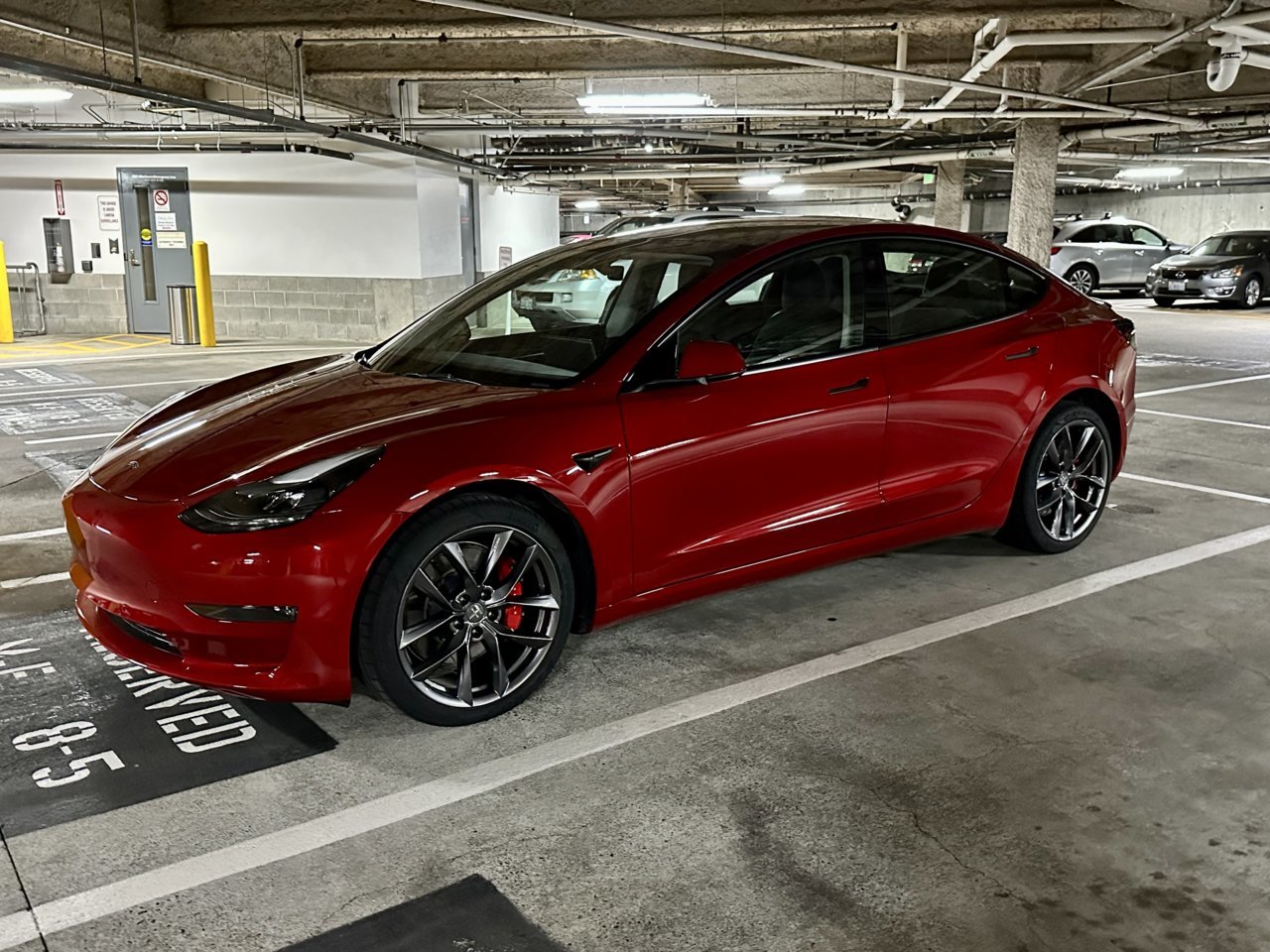

    Hand washed today and thought it looked great in the corporate garage.
