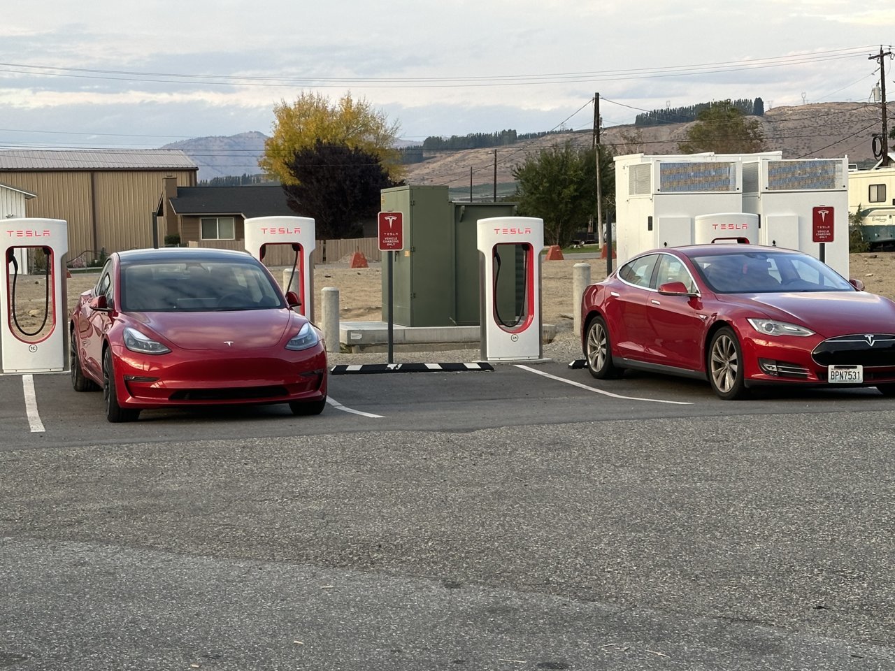

    First time supercharging. Tried to grab a beer while the car charging from 19%, but the supercharger was too fast and service too slow, fully recharged accidentally and unnecessarily in just over 30 min. Got a notice that the car was full and I was going to get charged for loitering. Really only needed 5-10 minutes at most on the charger, then could finish with 120v 15A at my destination. Total cost for the 3+ hour road trip charging was $19.

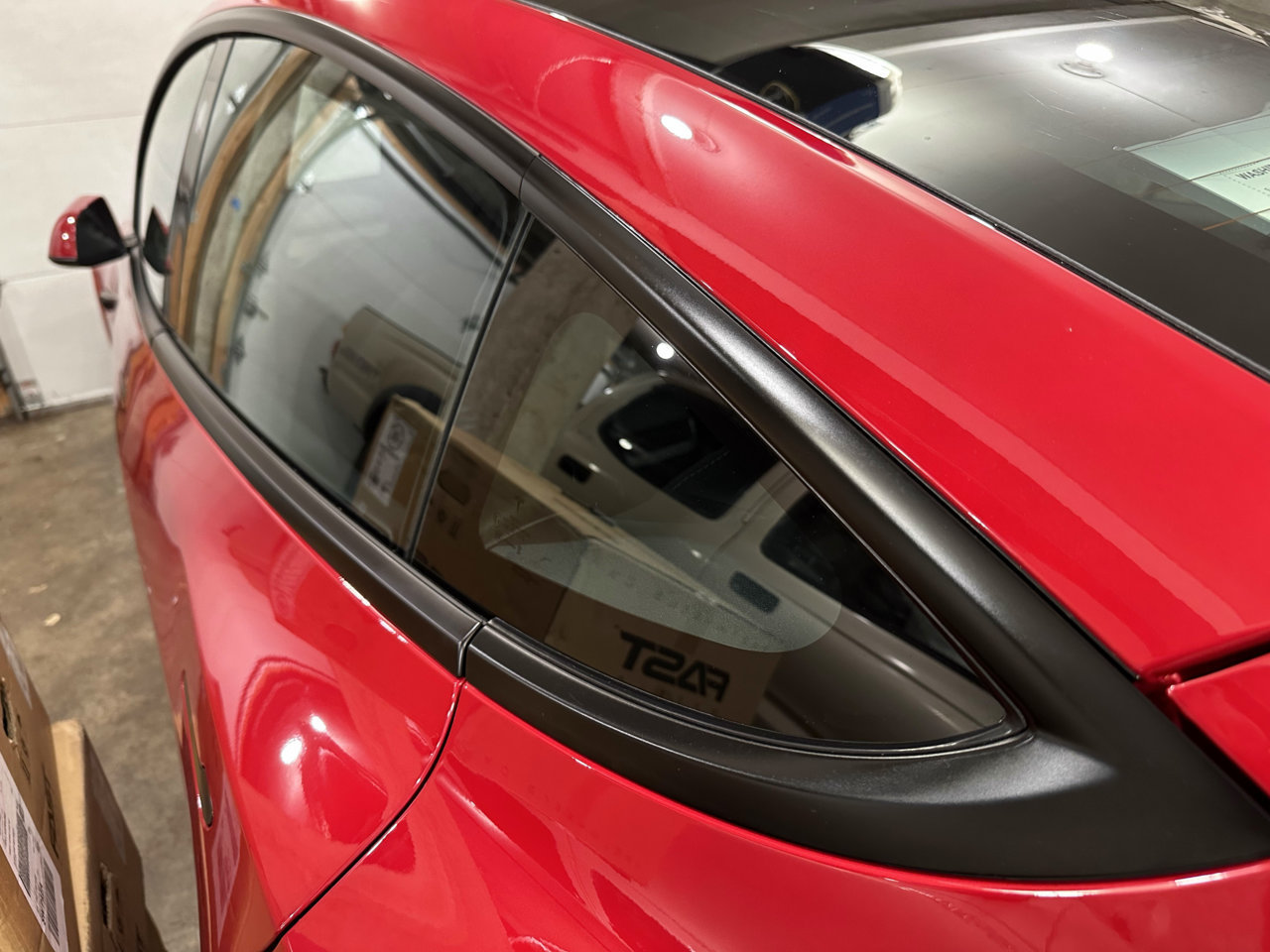

    New Fast EV01 19" wheels showed up yesterday, didn't bother opening the boxes before taking them down to the powdercoater today. Turns out they are missing the aero filler plates. Sigh. I'll need to contact the vendor. Although I did get to check out my 18" wheels they still had, they were 'scuffed' in prep for powder coat, and all that really means is the finish is now dull. The wheels don't look bad at all to flip.

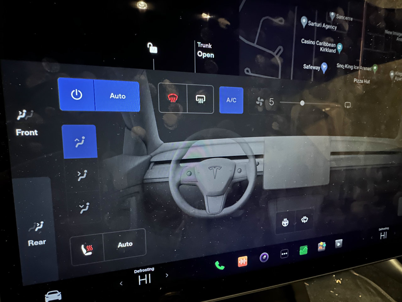

    Important into: Figured out how to emergency defrost, double tap the defrost button. Single tap on defrost activates the AC to dehumidify the air and blows cold air slowly on the window which removes moisture from the cabin air and is the best way to defrost if urgency is not an issue. But it is slower. Double tapping the defrost button activates max heat and max fan (which turns the icon from blue to red) for the most rapid defrost possible, but will not ultimately remove the moisture from the cabin. However, should you be blind with a fogged over windshield on a windy 2 lane mountain highway, it will very rapidly clear the fogged windshield, unlike standard defrost mode. There is a lot to the car that is a learning curve.
    Double tap max defrost - icon red

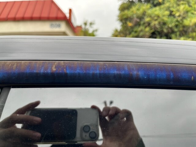

    I had this rainbow appearance issue on the trim of my new model 3. It was on the car since day 1. Initially I didn't think anything of it, just some annoying residue of whatever protective film was on the car and would need to be cleaned off. So I washed the car, but it didn't come off. Odd. So I used some exterior plastic detailer, and it appeared to go away until that dried and it actually didn't. Hmm. Many people on Tesla forums/groups get accused of washing their car with something wrong to cause the issue, but my car looked this way from the moment of taking possession brand new, clearly not related to washing.
    Not my car, pics lifted off the internet, but my trim looked identical.
    Found a post on the subject that said to wipe the trim down with WD-40 in a rag and it would remove the rainbow causing residue. A couple days later and the fix looks to hold.

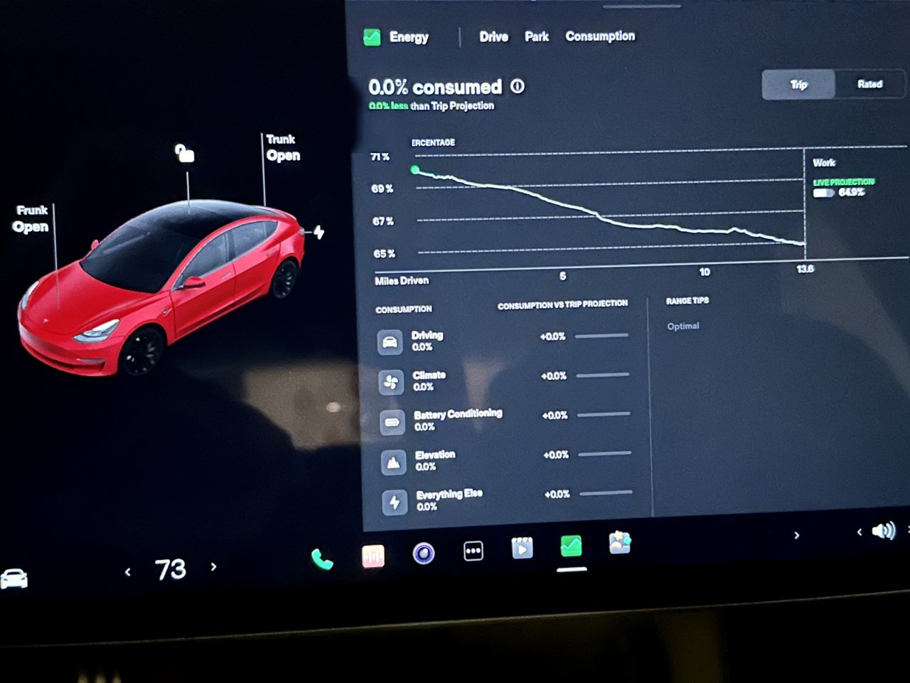

    Yes! Got the 2022.36.6 car software update before installing the new aero wheels. This update includes a far more advanced and comprehensive energy app, including the ability to specify how much energy is spent on driving vs other vehicle functions.
    For versioning convention, Tesla versions their updates as year, week number, and minor revision. So 2022.36.6, means released in week 36 of 2022 and is the 6th minor update of this release.

    I'm guessing keeping the battery at optimal temperature when parked falls under Battery Conditioning. What type of battery usage would fall under Elevation?
  20. Nov 2, 2022 at 9:42 AM
    #100
    907rx7
    907rx7 Well-Known Member
    Jul 1, 2019
    #298028
    1,695
    James
    '20 Tacoma DCSB SR 4x4
    I'm guessing it tells you how much elevation changes along driven routes have positively or negatively impacted range? Just guessing here.
