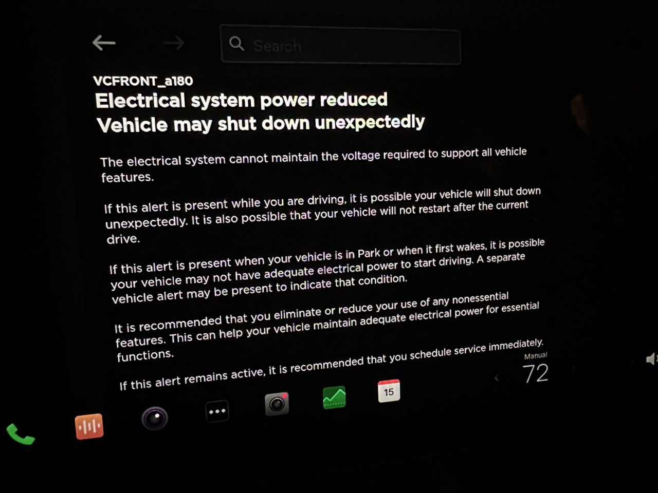

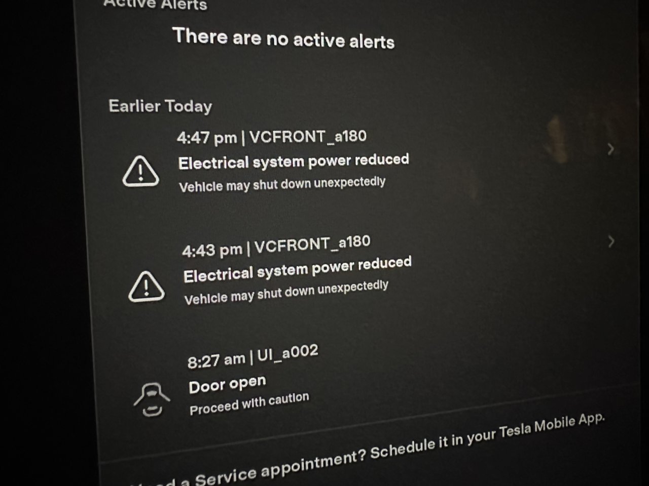

    Right as I was getting on the highway for an hour long drive this evening, the car threw multiple errors it may randomly shut off unexpectedly and be unable to restart.
    With an important evening on the line, a rigid timeline, temps in the high 30s, heading out on a limited access 2 lane highway and still being right next to home, I chose to abort. The errors cleared and systems were green as we exited the highway, but we continued to circle back for the Tacoma.
    We’ll see if the errors repeat, some indications point to a possible 12v battery failure which is semi-common (not unlike Tacoma’s) or a high voltage regulator. Annoyed.
    You can pull up error history under:
    Controls->Service->Notifications

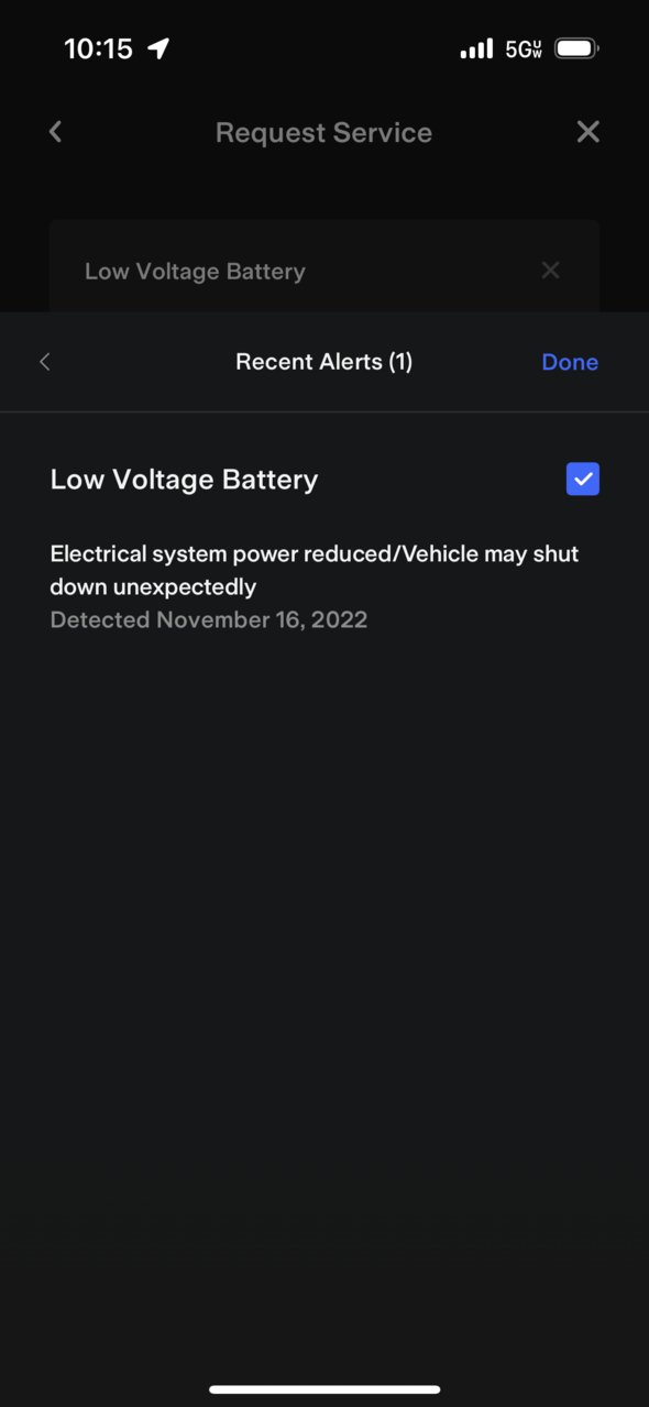

    This seems like a system fault I want to have looked at, vs a software bug to send off to Tesla.
    It occurred again on the way to work this morning, so I again circled back and grabbed the Tacoma. The app made it super easy to schedule service and already had the error logged to you just needed to check the toggle for what the service is for. Interestingly the app listed the fault with the 12v battery, whereas the car and manual did not explicitly state that. So hopefully it is just a defective 12v battery and simple fix. Service scheduled for Monday.

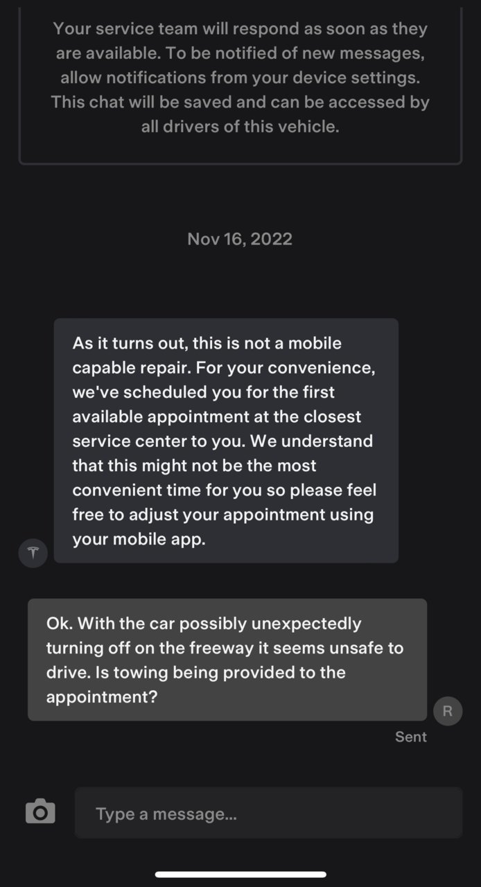

    Now I'm beginning to get annoyed. The car has only 2k miles, showing errors that it could shut down without warning and issuing warnings to stop driving immediately and I'm being asked to bring the car to a service appointment 20 miles away via freeway. Google searching shows it is often less than 15 minutes from receiving this warning to a full system brick failure. So if they say no to towing, do I drive it till it bricks, then call in a road side service call that is fully covered under warranty? TBD on how Tesla responds, but there is only one correct answer.

    Tesla's are supposed to be flat-bedded like any AWD vehicle, you cannot traditionally dolly tow like a 2wd. Weight of the proper tow equipment plus the car would likely put the tow rating at/over capacity for the 1st Gen. Regardless, I should not be forced to put my truck in harms way to warranty a 1 month old car. If they deny towing, I will drive the car continually around the block till the fault occurs again, which is typically ~10min, park on the street and hit the road side assistance emergency button for a tow.

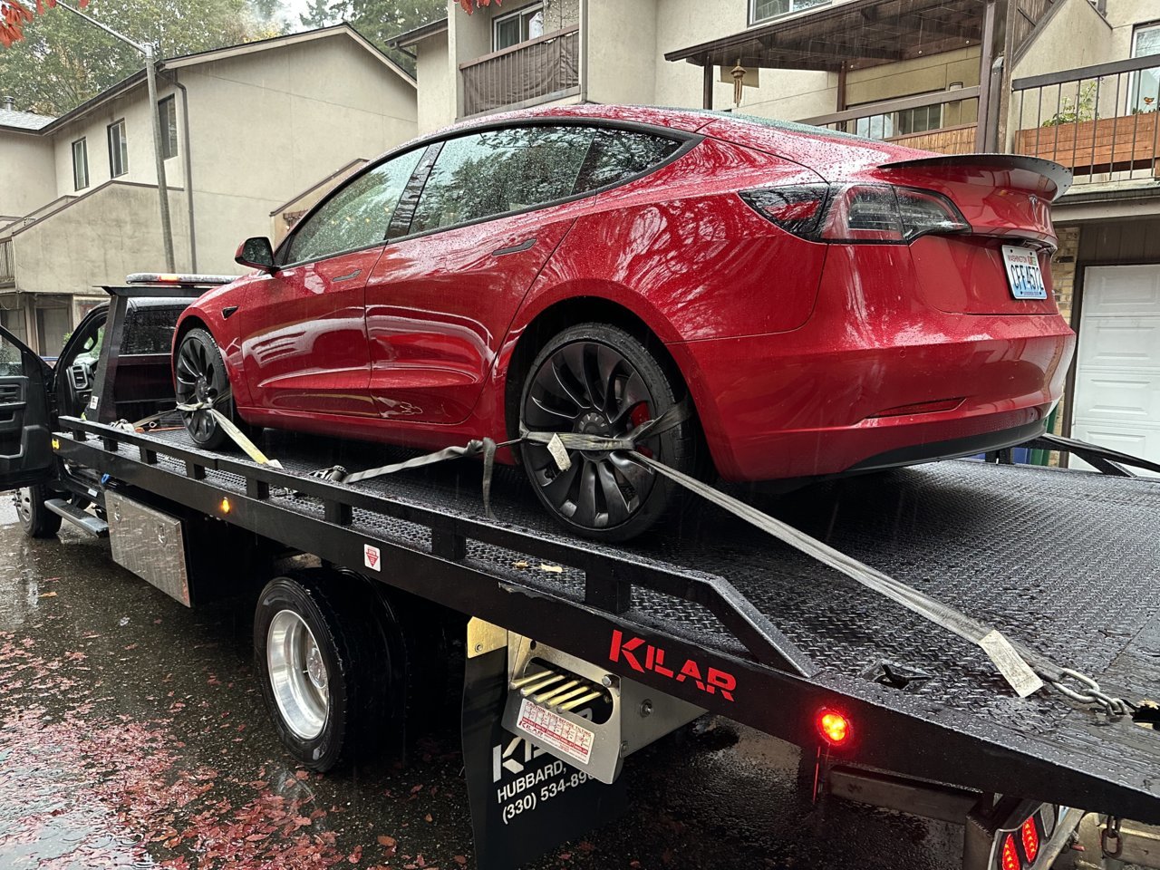

    Yep. Service team got back to me today and said to just request a road side assistance tow in the app.
  20. Nov 22, 2022 at 10:55 AM

    Off to service it goes.
