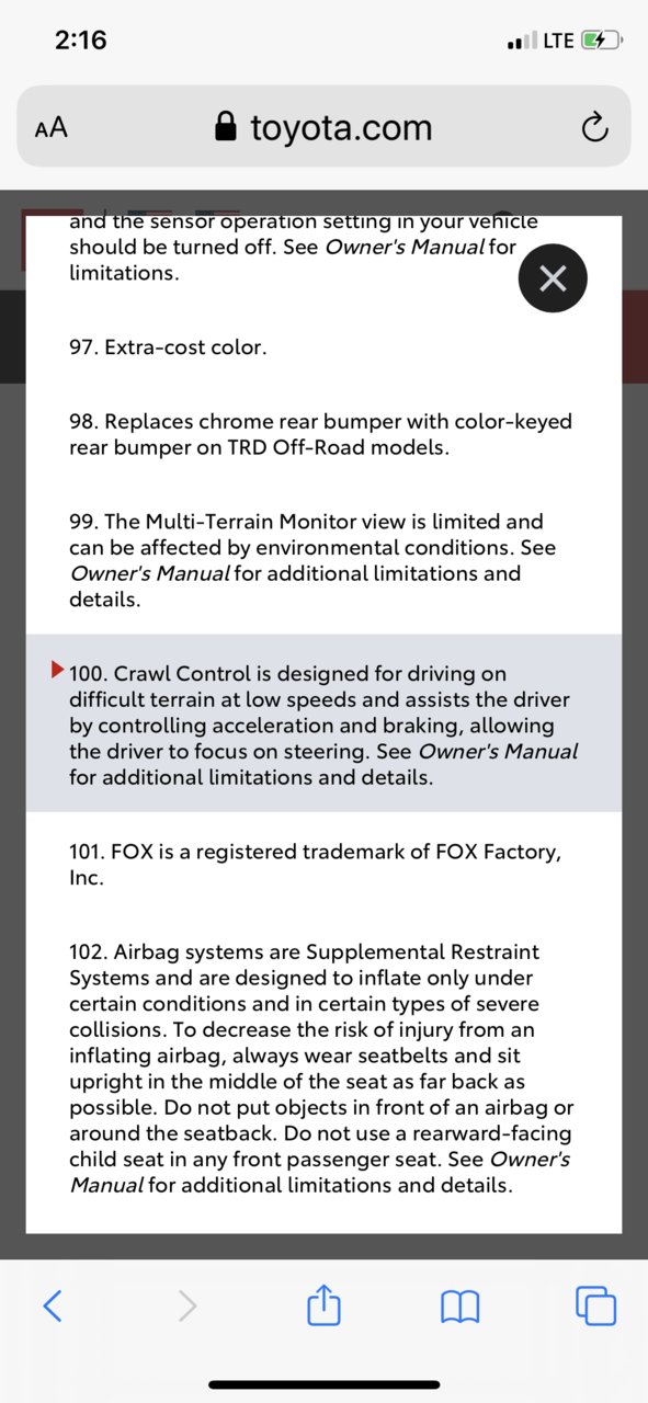

    From Toyota’s website. It’s a sub note from the features page about crawl control. 3D5947B4-1665-4110-B142-6483D56E2D28.jpg

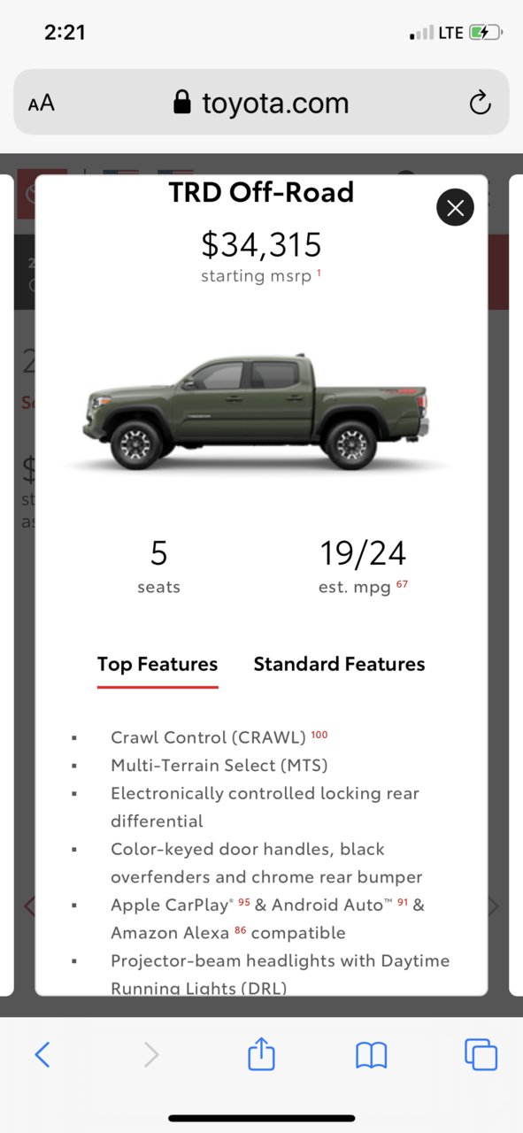

    Also notice how it’s the first feature mentioned in the top features. 75521E67-D698-45C1-99EF-0BB91C5EB394.jpg

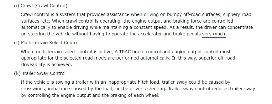

    I really do empathize with you guys having this problem...
    That said, I noticed something, I had not noticed previously, from the service manual.
    Anton338, Junkhead and BigWhiteTRD like this.

    I'm luckily not having this problem, but I'd like to point out that even with the manual saying that it shouldn't give Toyota a pass on changing the feature. You could always operate the brakes and accelerator using CC; I'd argue they HAVE to put that in the manual since operating the brakes is pretty important.
    RedWings44 likes this.

    I'm not saying it absolves them...
    I don't think it's working like it should...
    It is often said crawl control is off road cruise control. People still use their brake and gas when using cruise control.
    I just thought the wording was...interesting. Maybe the system is not, or was never meant to be as autonomous as people expect it to be.
